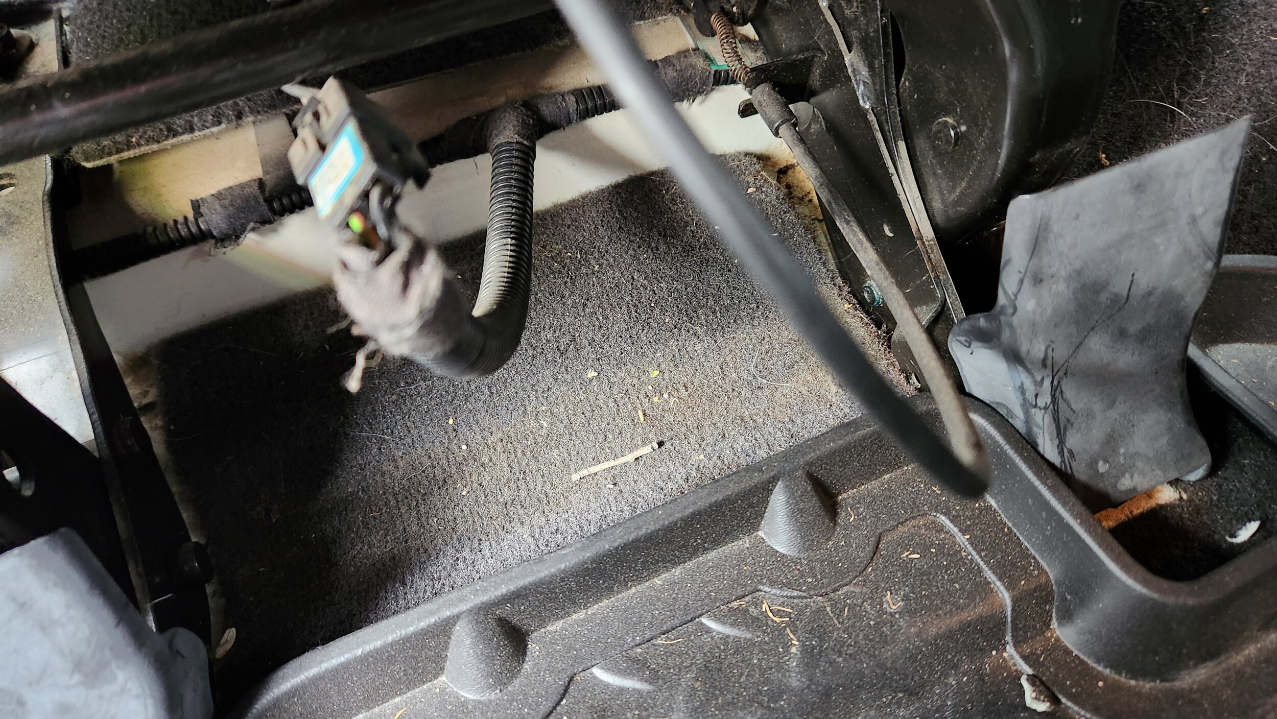

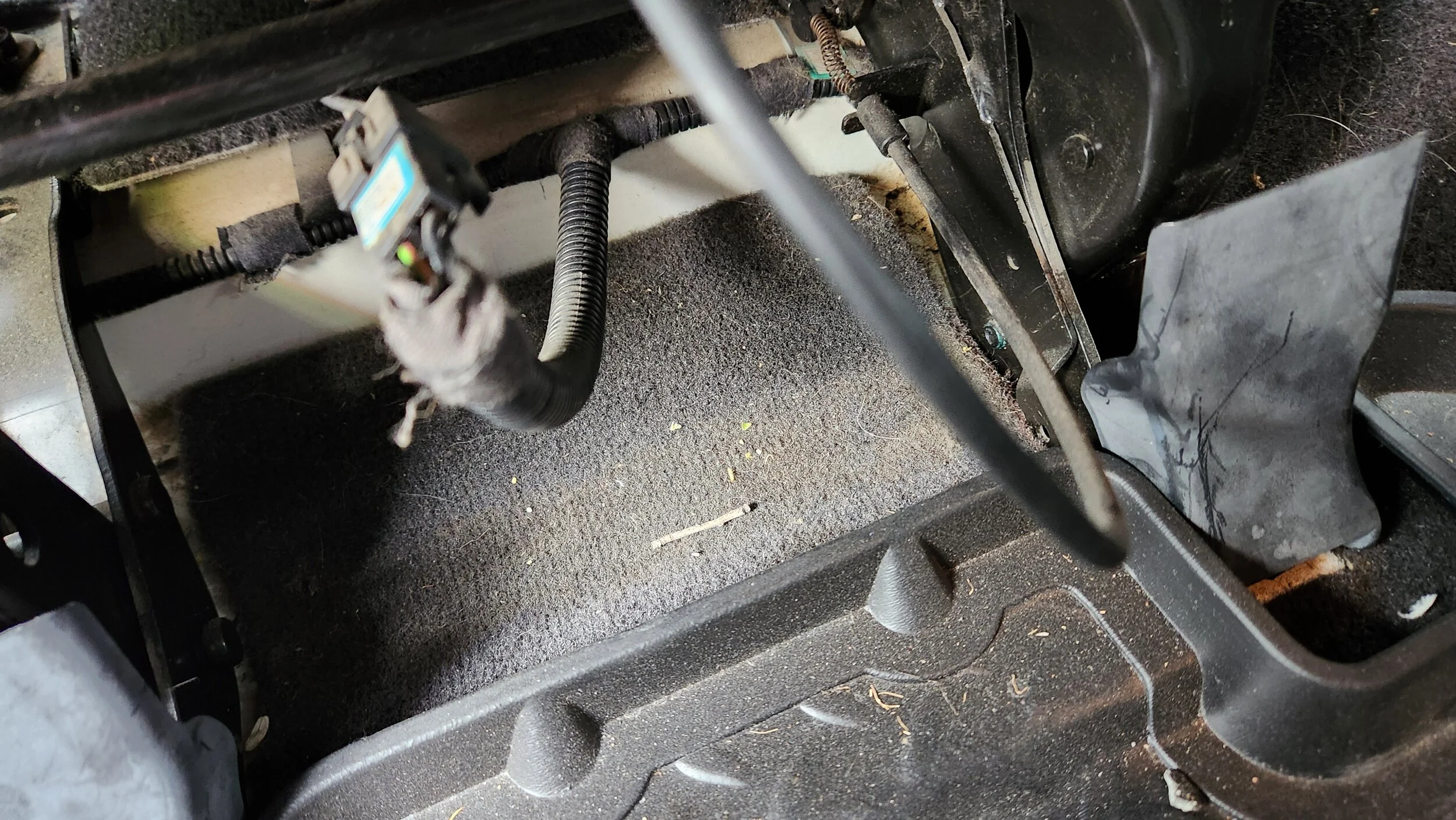

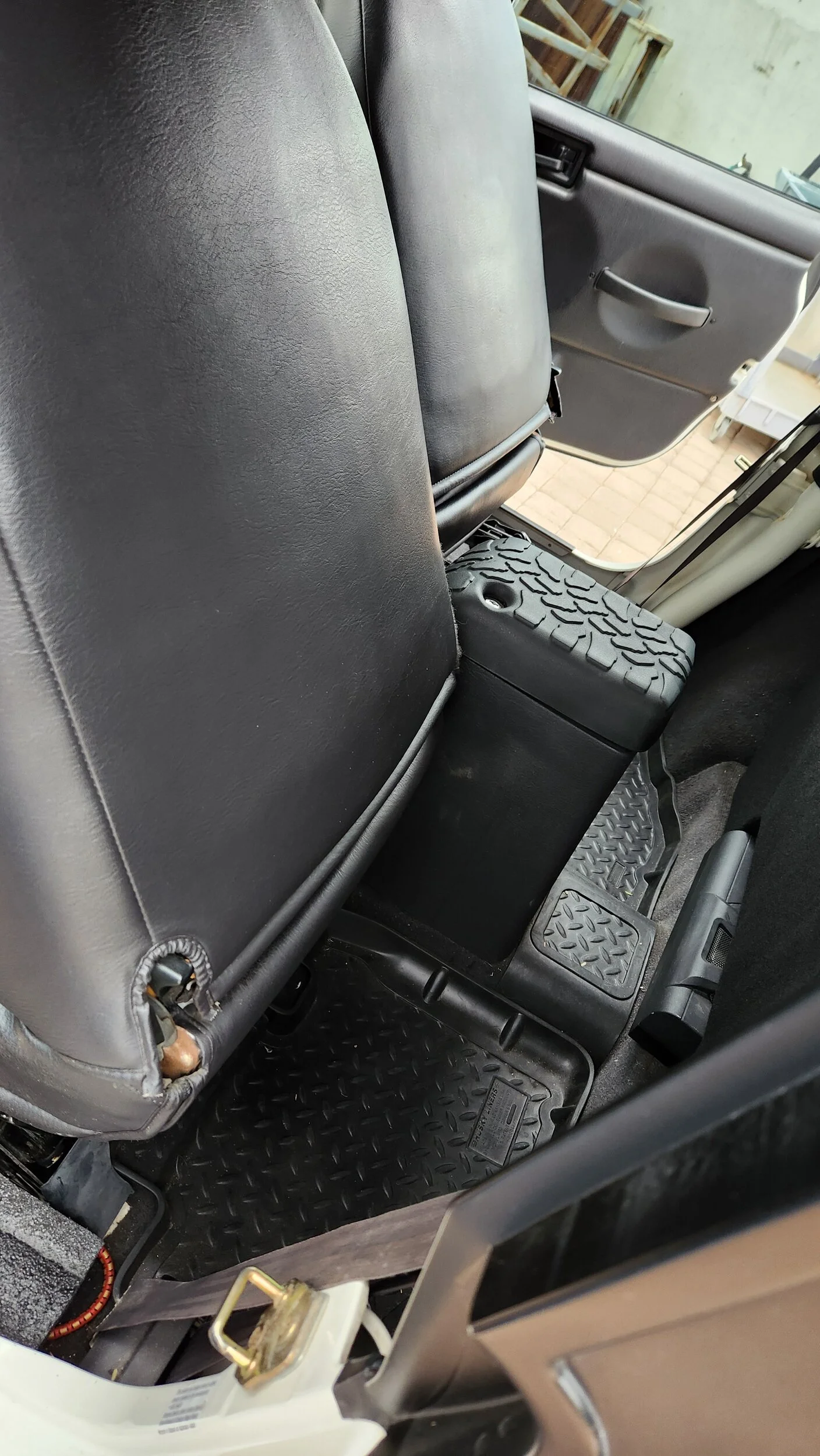

Installing the Tuffy safety box is tight and you need to position the box perfectly so you can still slide the seat forward and backward.
I installed one in my 01 with fold and tumble in both seats.
