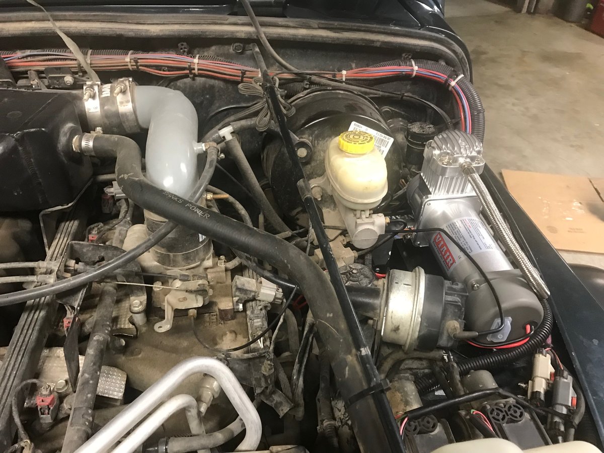

I personally would move them yourself. If you can figure out how to extend a 3 wire(?) harness you will be fine. I mounted mine in the engine compartment and extended the harness and moved the air hoses all in maybe 2 hours. I for sure wouldn't pay anyone over $100 to do this. You can do this prior to the tuck. You may have $5 into doing this.

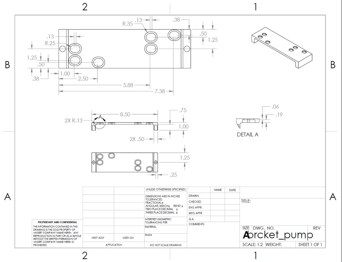

I went with the Savvy Under Armor TT and made a bracket to hold the locker pumps (still mounted on their OEM bracket). No re-routing of anything required.
My custom bracket is just a piece of aluminum angle and a piece of aluminum square tubing. The angle is bolted to the brace that runs across the rear of the Savvy skid. The square tubing is used as a spacer under 1 end of the OEM compressor mounting bracket.
If you want a picture, I'll post one when I get home from work.

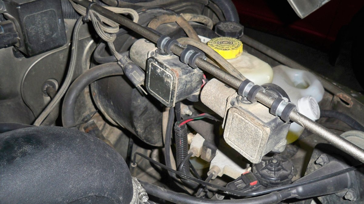

With a little trimming you can use the OE compressor mounting bracket to mount them to the driver's side fender well. Especially nice is you can retain the rubber isolators between the compressors and mounting bracket. That's where I mounted mine ten years ago and it's been a great location.
ABS tray for mine as well. Wanted to get them up and away from the bottom of the Jeep. As far as heat with the proximity to the main Cat under the Jeep, not sure the heat under the hood is going to cause them any issues.

I would much rather work on my locker pumps under the hood then drop all the savvy armor to work on them. Once you install a TT you realize there's little to no room to work on things without dropping the skid. I like to make things more practical.
Thanks, everyone! Good to know I wasn't going nuts. I'll be installing the TT next month, so I'll look to see what location is most practical for my LJR at that time. :)
