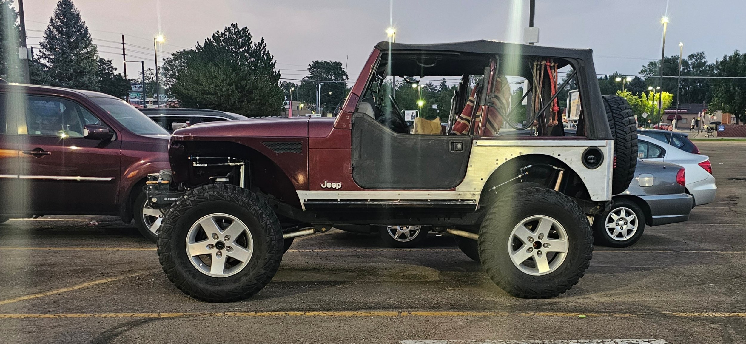

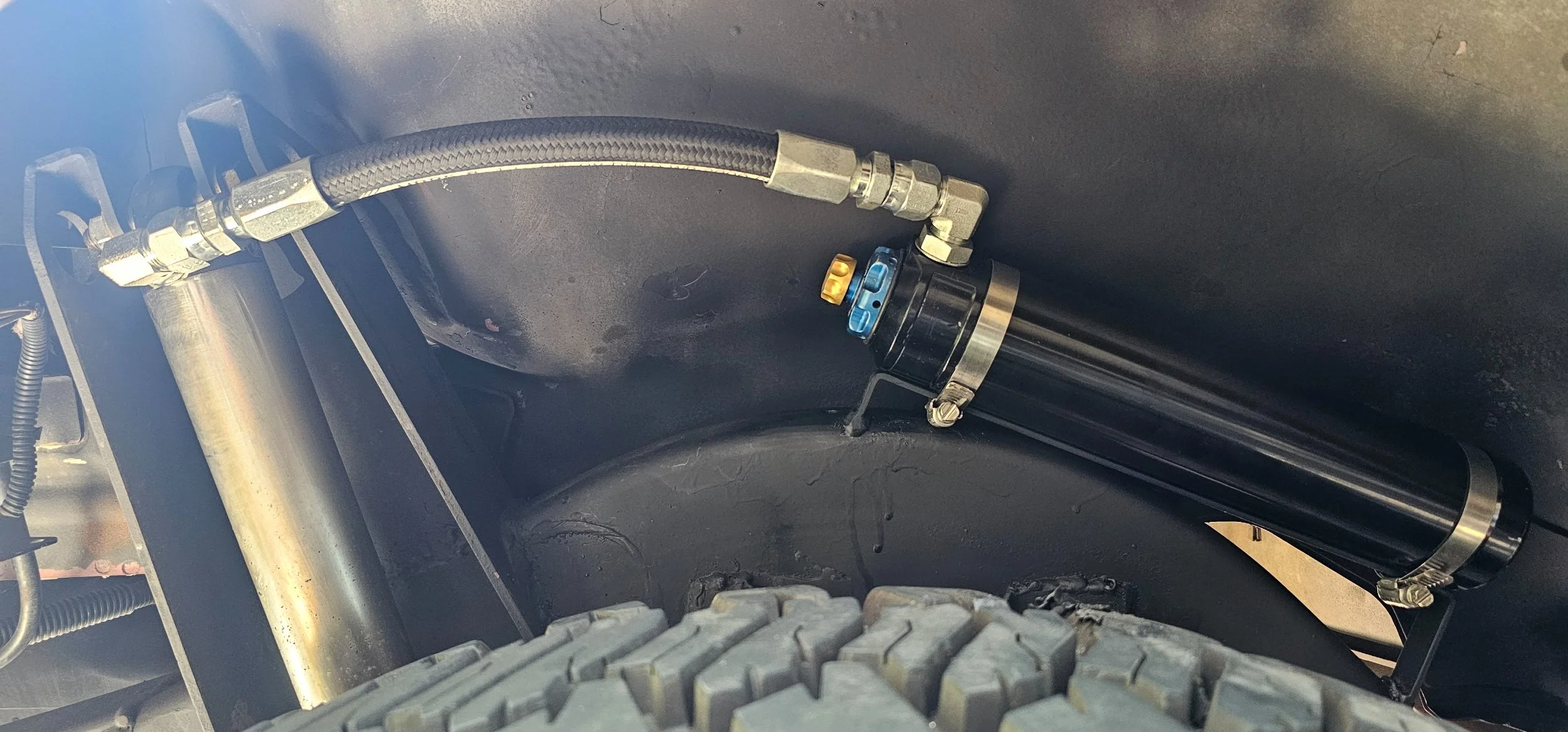

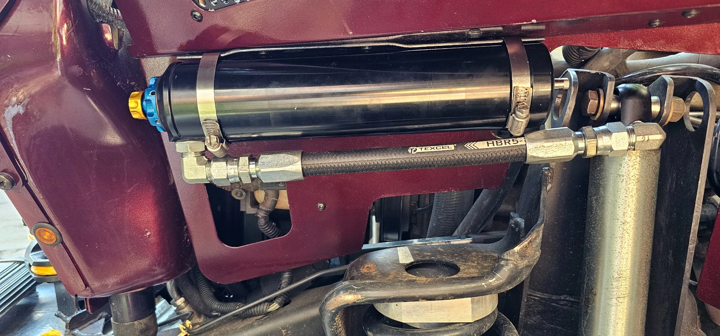

These have been as good, if not better than anything else I have done to the Jeep.

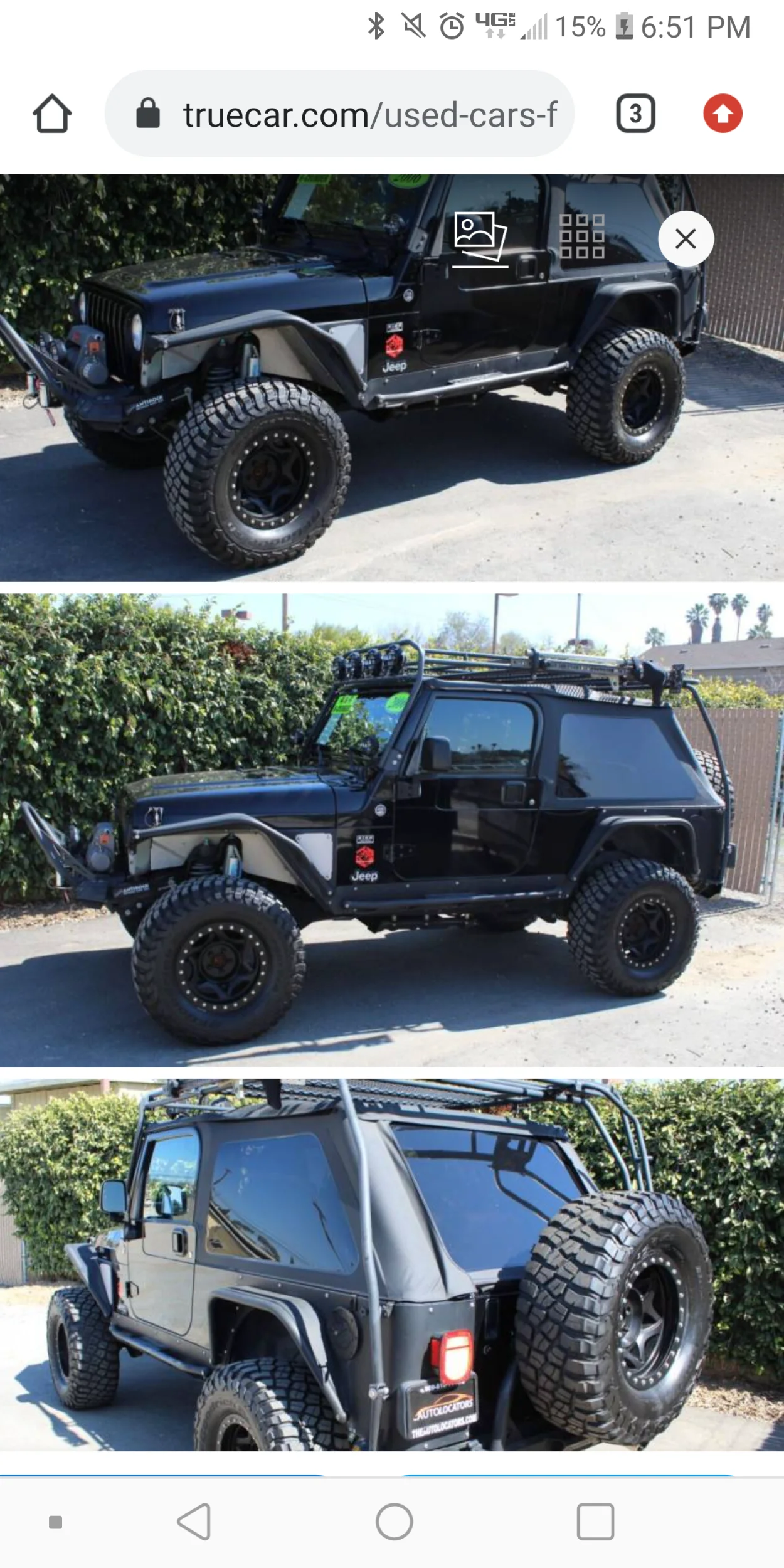

By the way, heres the Jeep I saw for sale years ago, out in Redlands, CA if I recall. Maybe @mrblaine knows of this guy, it's his neck of the woods!
