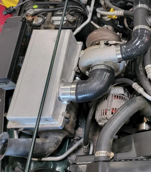

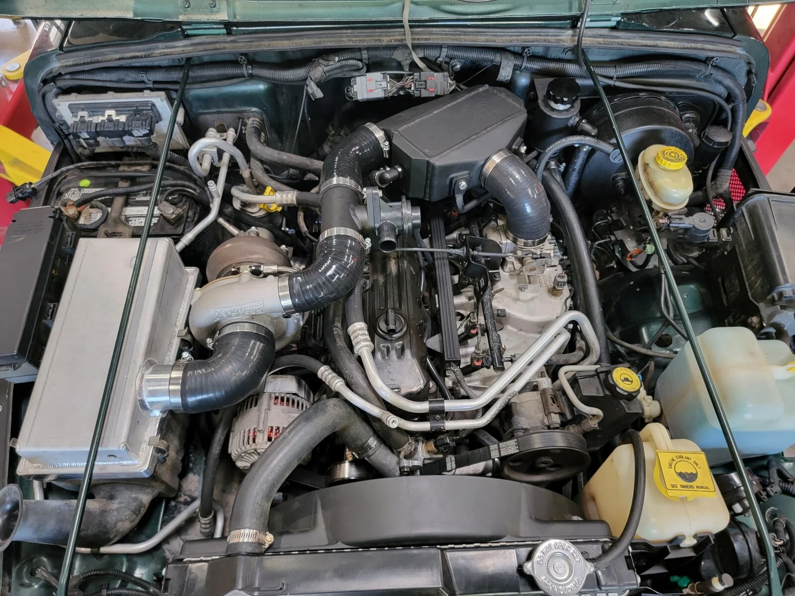

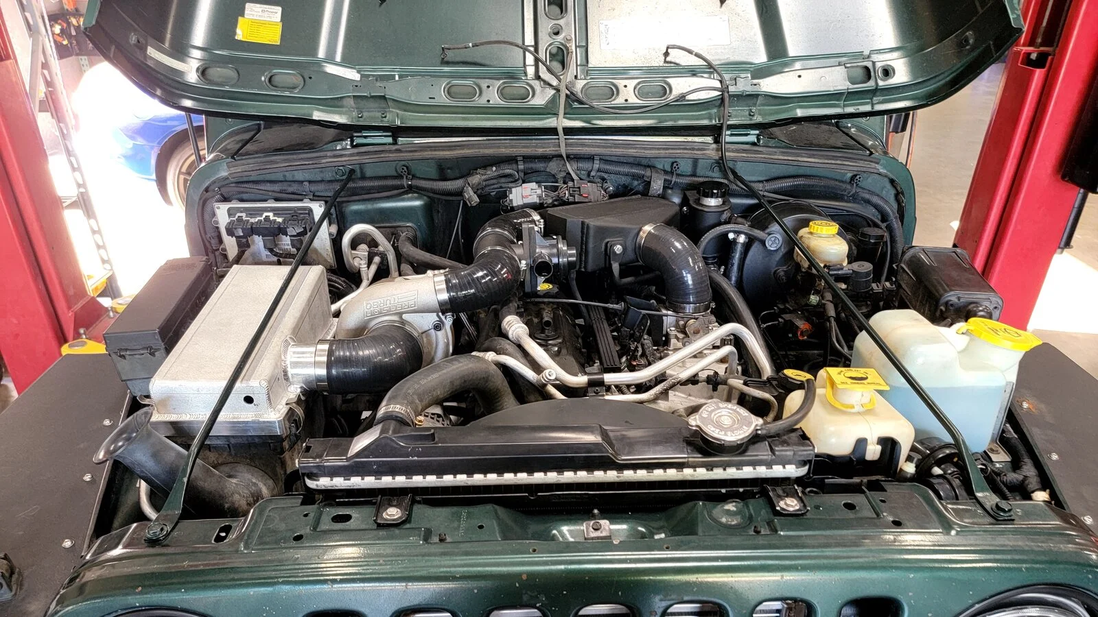

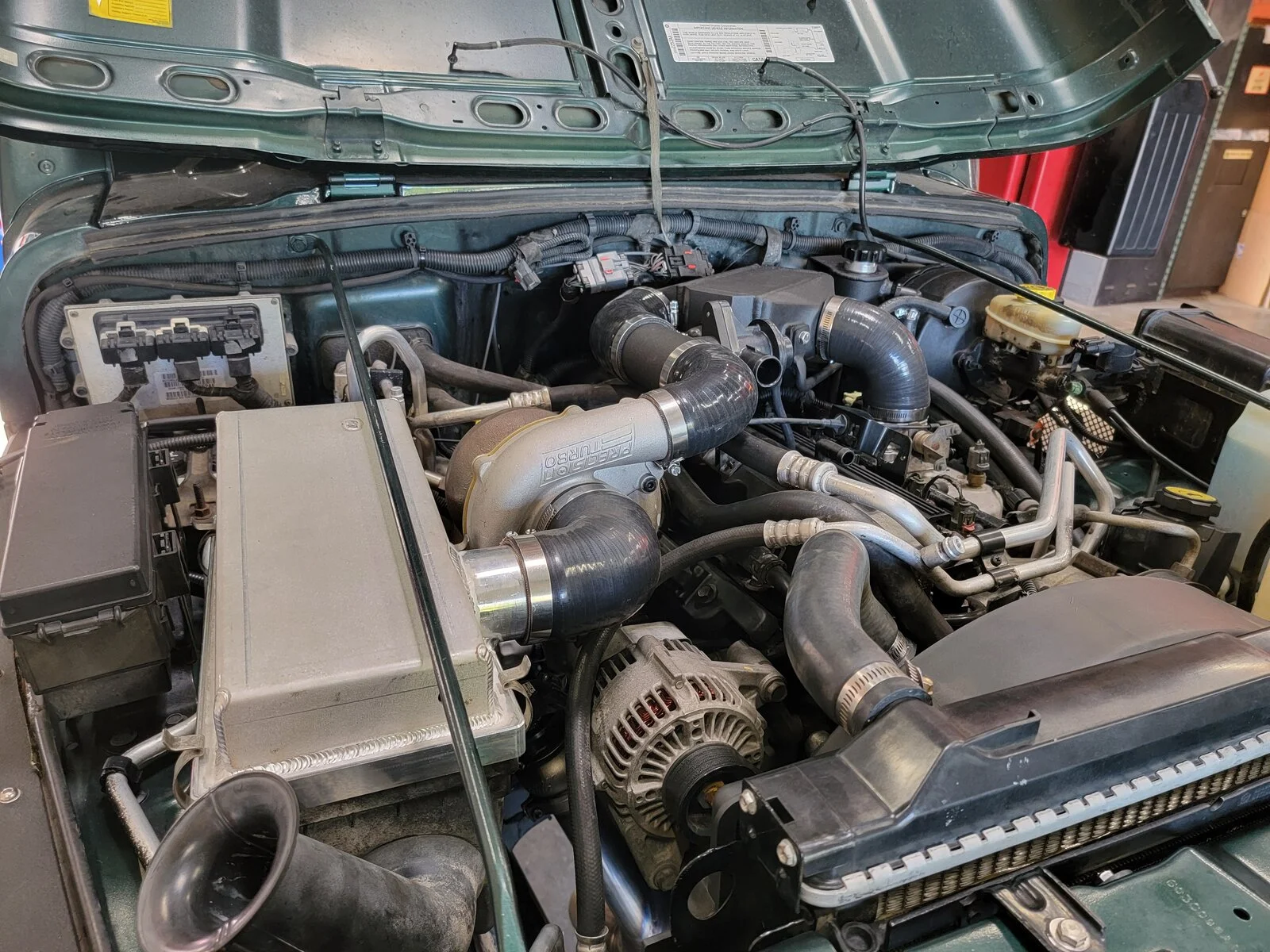

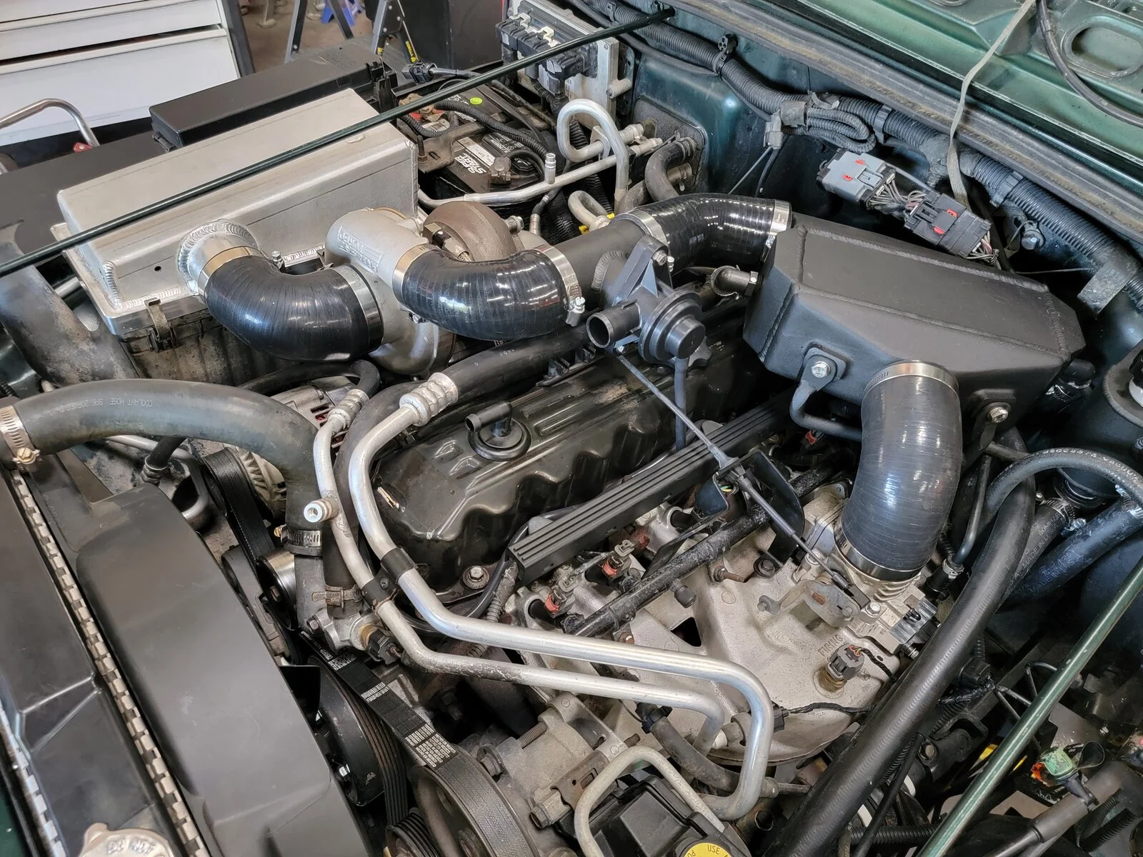

I thought I should post a little project progress update since it has been a bit. The kit is coming together nicely and is in the finishing stages. Physically there are only a few small details to wrap up. On the administrative side I need to finish a final parts list and install manual. After that I can nail down the pricing and lead times. For the tuning I have been in contact with @Flyin' Ryan Performance about offering custom tuning to those who want it. I don't believe that a one size fits all tune would give the best results and meet the expectations of each user.

Where did you situate the water tank for that air-to-water intercooler?
It's just to the right of the intercooler in the pictures. It's more of a fill and not a storage or ice tank like on a drag car.

I love how you incorporated the factory air box & filter instead of just slapping on an open filter element. (y)
Do you plan on having all tops fabricated aluminum, or are you looking into having plastic pieces made?
They will be fabricated aluminum. I don't anticipate enough production to justify the setup costs of a plastic part.
