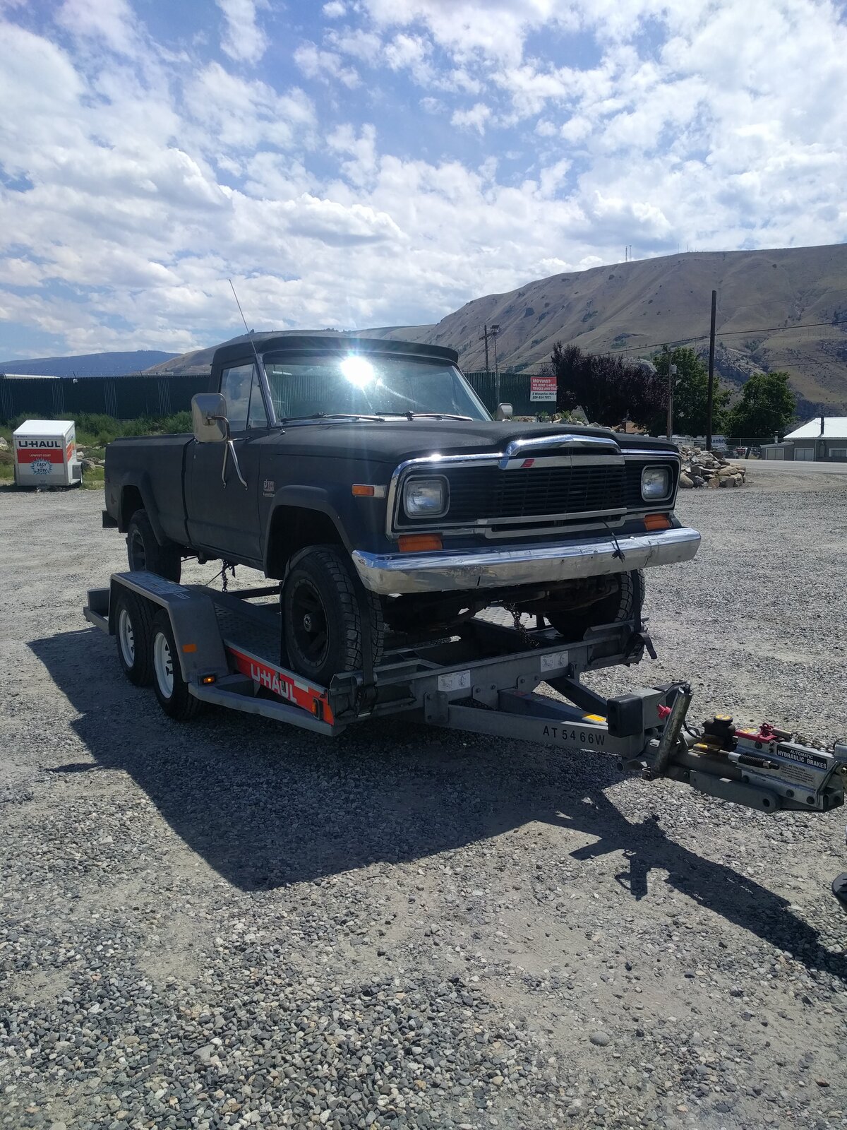

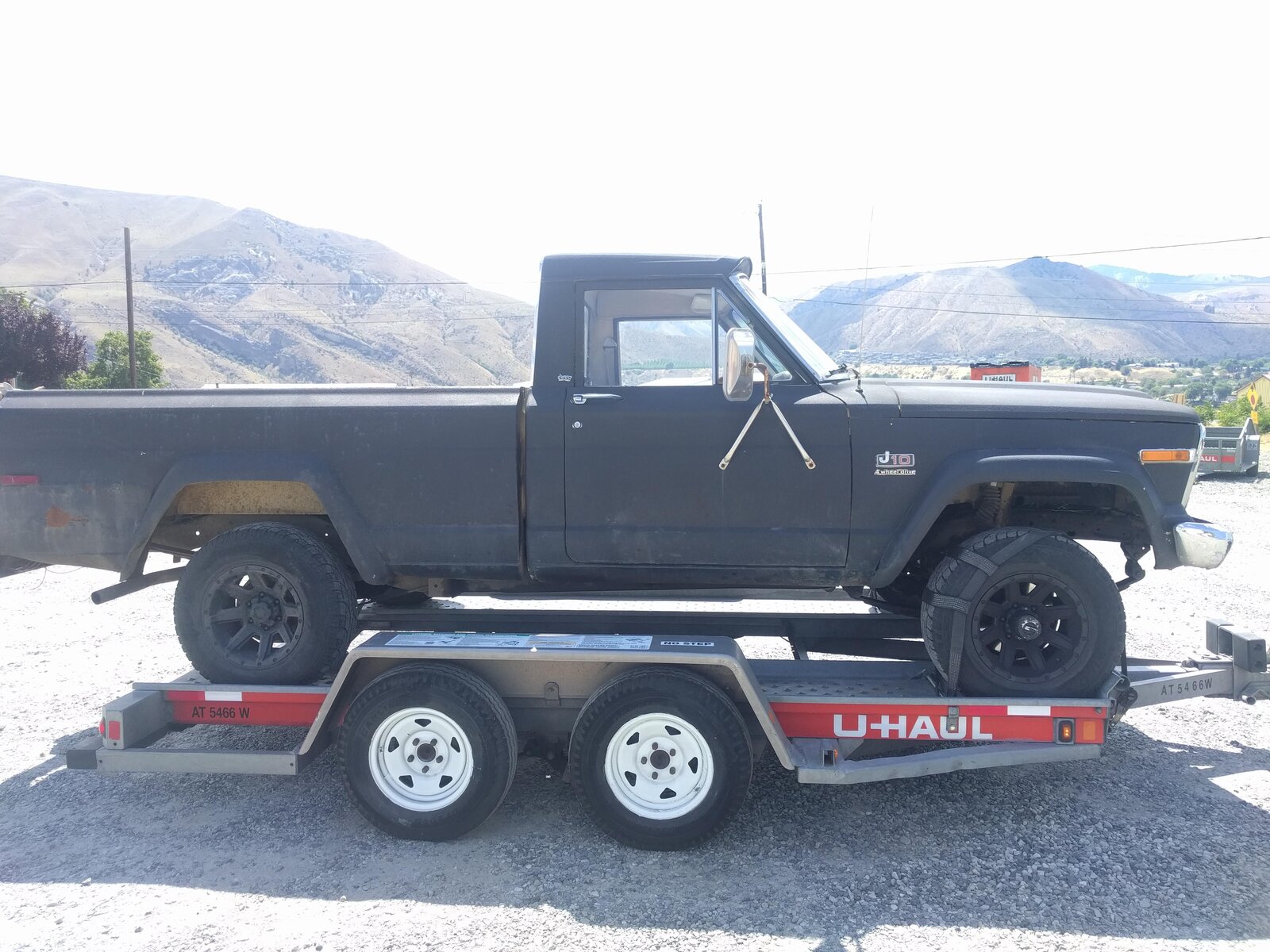

Hello everyone, some of you might remember me from Jeepforum and my Wingnut Build, I kind of stopped updating it after a while and lost interest in that forum. Trying to get back into the swing of things and figured this might help keep me a little motivated to get my projects done. It’s good to be back.

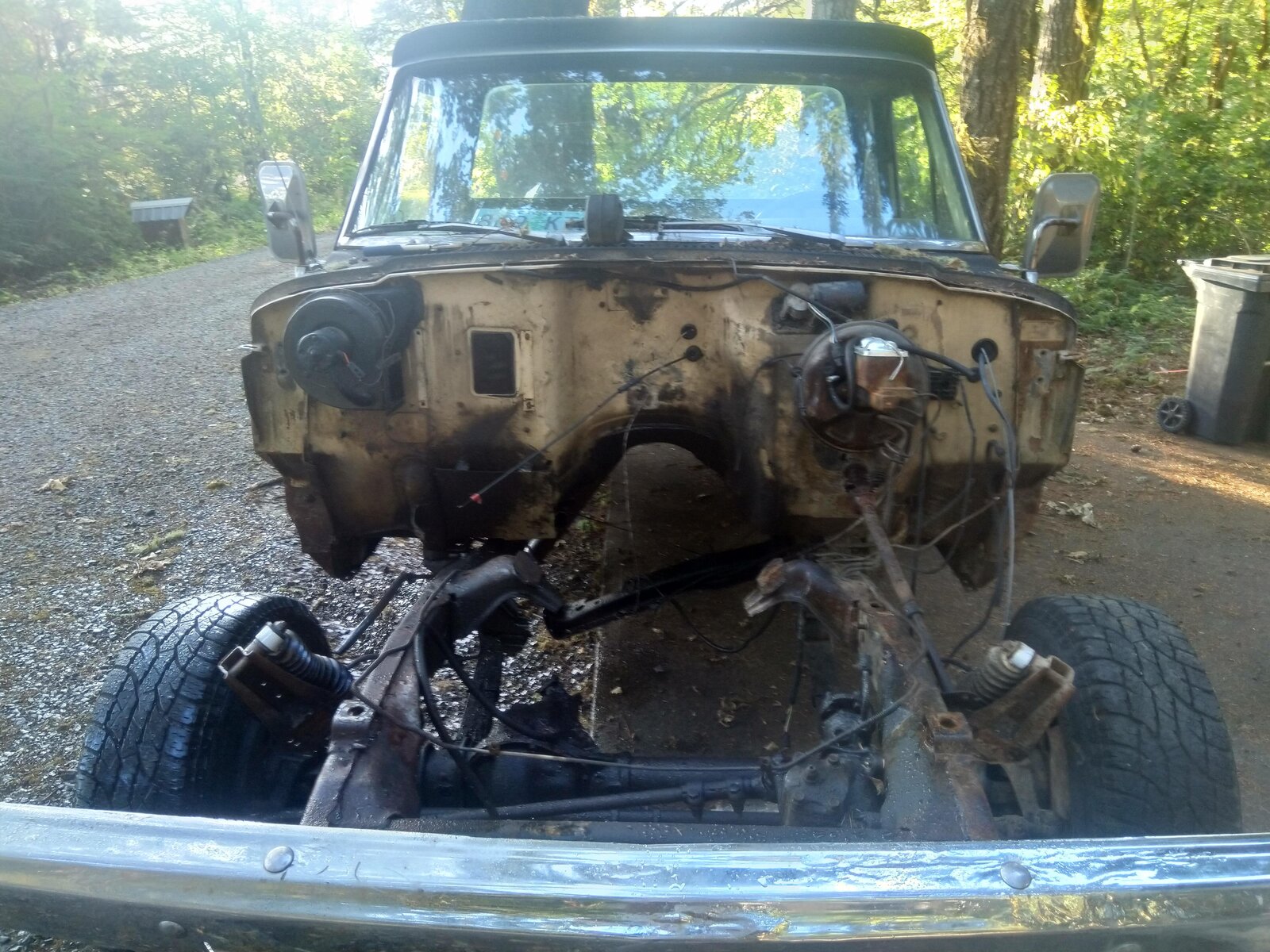

I never stopped working on the Jeep though, in fact I bought a second one. A 1979 J10 that was running when I hauled it home, the plan being to drive it around while I worked on the TJ, though things never seem to go according to plan. I drove it around for a little bit, getting to know the good and bad of my biggest purchase ever. Originally I replaced the main and rod bearings, the oil pump, fixed all the leaky gaskets, rebuilt the carb and with the help of my grandpa got everything running really well, nice quiet idle, very smooth even if it only had 80hp.
Then I learned what blow by is, and why I should’ve investigated that before fixing everything else. After sealing up all of the engines oil leaks, it began to come up and out of the dipstick tube, after riggin up a hose to a catch can from the junk yard, I was able to drive about 15 miles or so before needing to stop and dump 2 quarts of oil from the catch can back into the motor, not a very long term solution.

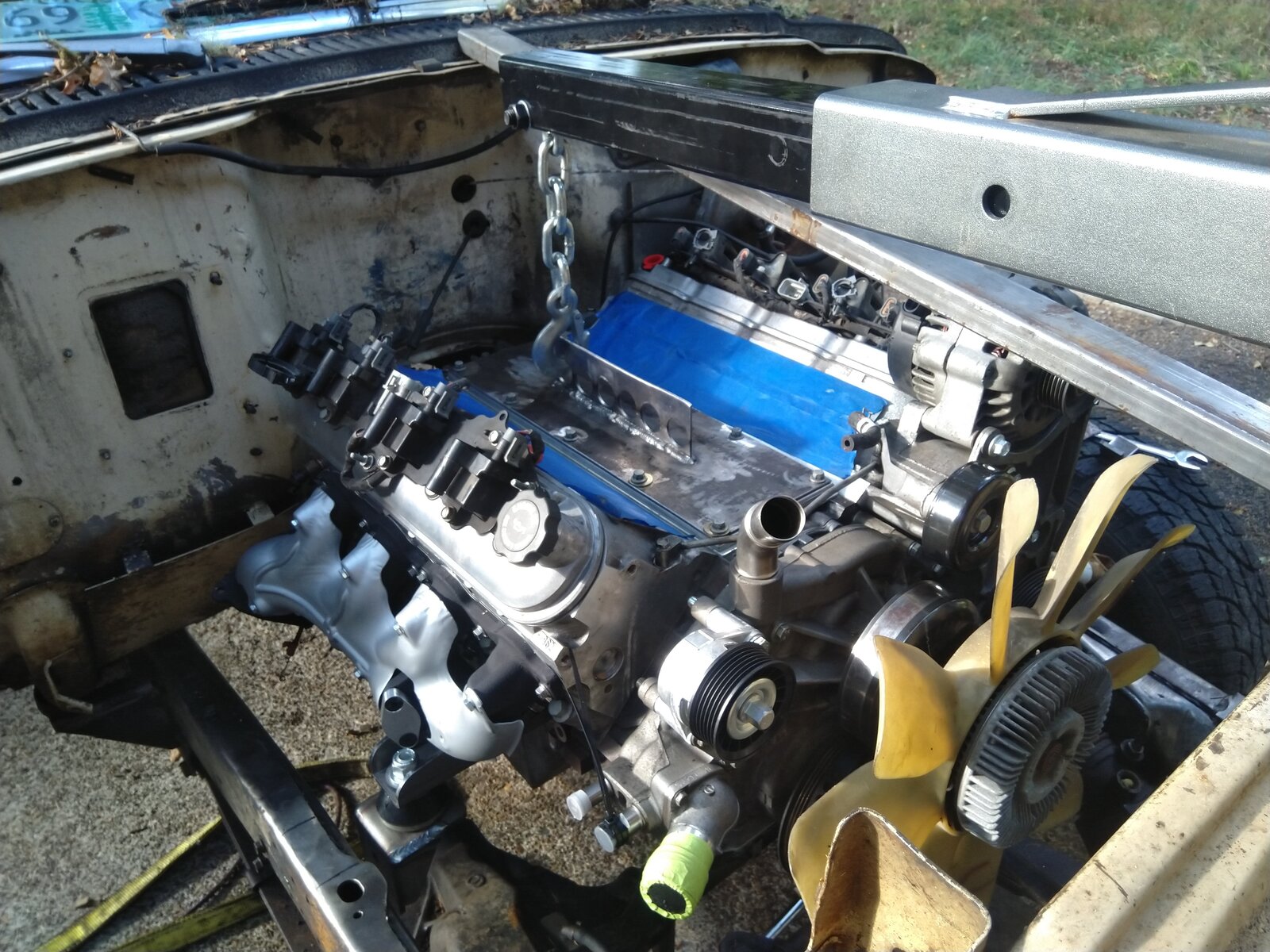

So I scrapped that plan, bought a gen 3 4.8 LS, 2wd 4l60e, harness and all the necessary swap parts off of craigslist with about 180k miles. New plan, rebuild the motor and swap everything into the truck. Blew the motor apart down to the bare block, bagged and tagged everything, and began to realize the motor needed a decent amount of machine work, and that I wasn’t going to convince myself to put it back together without a fair amount of new parts and machine work. I still have my spreadsheet of parts for a bored out 5.1, totalling a couple grand in parts, tucked away here on my laptop.
New plan, found another 4.8 on CL, 90k miles, pulled from a running chevelle in favor or a new 6.0. Drove 5 hours down and hauled it back home in the back of the TJ for just $500. It is currently sitting in the truck with a 2wd 4l60e that may or may not work. Got it mounted with some Advanced Adapter Motor mounts for a CJ I think, they were for a frame width an inch narrower than mine, stacked some plates on the inside of my frame rails and milled out the slots at work a bit to get my some extra width.
That was about a year ago, I’ve made some progress on the fuel system, wiring harness, exhaust and some other parts of the swap since then, I’ll detail those in future posts. It’s a long project, but I’m finally setup to start working on it again here shortly, for now here’s some pics of the truck when I bought it a few years ago. Yes that’s black bedliner, yes I absolutely hate it, and yes it’s a giant PITA to remove.

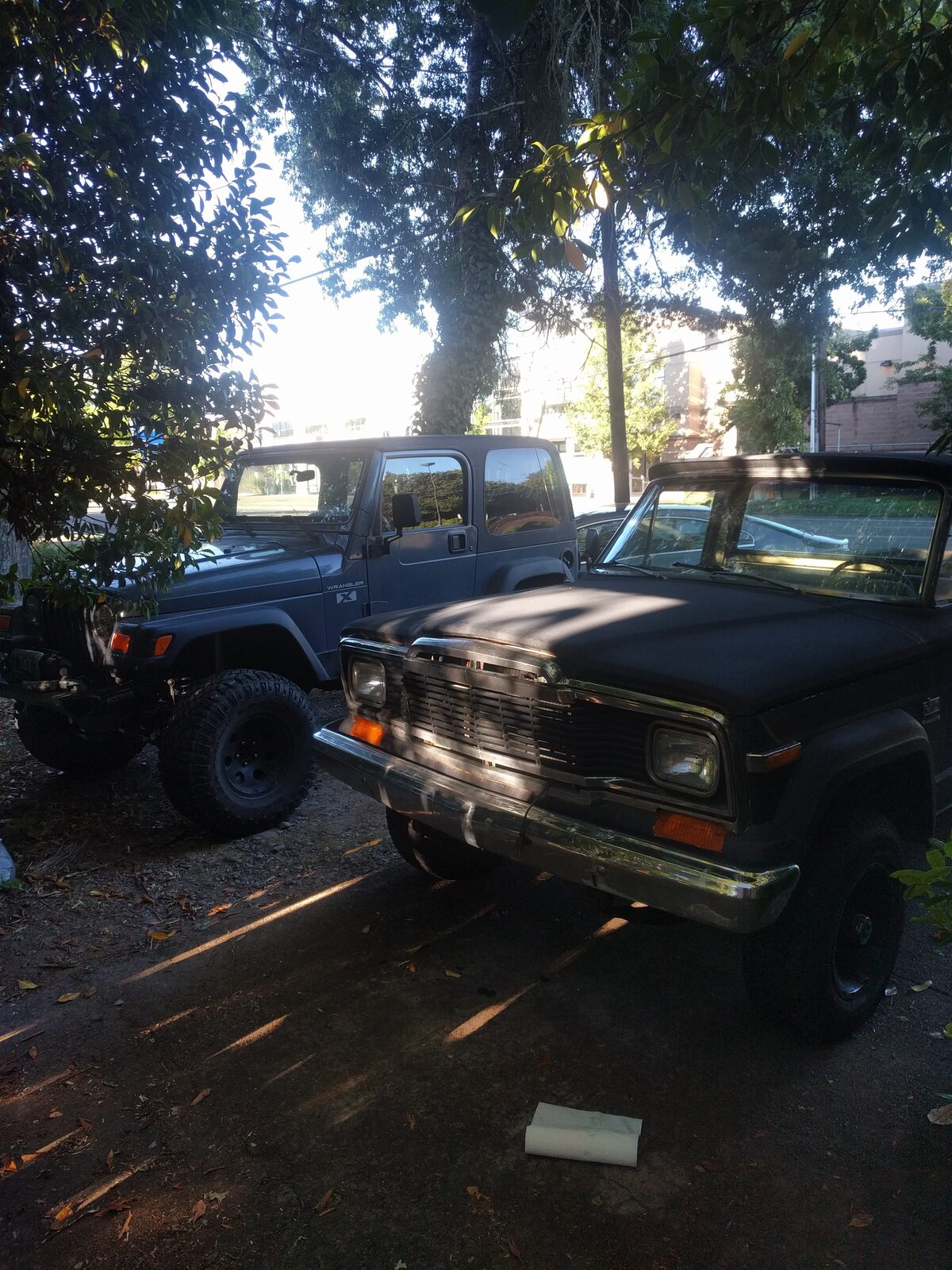

As far as the TJ is concerned, it’s a pretty long story. It was my first vehicle courtesy of my parents when I was 15, almost 23 now and 100k miles later it has changed quite a bit. I will link my old thread from JF if anyone is interested, but there’s a lot of talking and not much building going on, hopefully this one will be different. If you have any questions about it, feel free to ask. I’ll just list it’s current setup for now.
  • 4.0 straight six, 142k miles
  • Savvy 1.25” BL and JKS 1” MML
  • 32rh with an NP231 and JB Conversions SS SYE
  • Tom Woods Double Cardan 1310 Rear shaft clearanced for 35* of maximum angle. Currently at 21* operating angle, lasts about 6 months before the centering ball falls out lol
  • Ford 8.8 with the Yukon Ultimate 88 Kit, Artec bracket swap kit, 4.56 gears, a leaky ARB and Riddler Cover
  • Bent Rubicon 44 front axle, used Nitro Chromo axles, 4.56 gears and an ARB, factory cover
  • Second set of 33” Duratracs, got 80k miles out of the first set, fingers crossed for these ones. 15” MB72 Wheels.
  • Currently no engine or tranny skid plates, I have a DIY tummy tuck with a shitty crossmember I made with a modified factory transmission mount to make it low profile. Need to redo the crossmember and make skids some time, but right now everything is tucked up above the bottom of the frame.
  • Savvy Aluminum gas tank skid
  • Currie Front Antirock stuck on the lowest setting for now. Have a rear antirock that I’ve been meaning to put on, but that project started a year and a half ago...
  • Savvy Mid arm suspension, Currie 4” coils in the front, the 21” free length ones or however long they are, the LJ Currie 4.5” coils in the back with relocated upper perches.
  • Fox 2.0x13 RR shocks in the front, about 6.5” up an down. Soon to be replaced with a set of 2.5x10 single comp tube bypasses that I can hopefully turn into 11’s
  • Fox 2.5x12 RR coilovers that I run as smooth bodies in the back. 8” of up travel and 4” down. Going to try grinding the frame soon so I can pull the spacers out of them and make them 13’s for an extra inch of down travel.
  • Recently replaced flowmaster Catalytic Converters with a 40 Series Delta flow muffler. Fighting exhaust leaks due to mounting it to rigidly to keep my driveshaft from putting a hole in the downpipe like the last one.
  • Old 33” duratrac spare with a recently installed exogate. Never extended the snubbers on my old 31” and bent the tailgate pretty good.
  • DIY sliders and front bumper I made in HS shop class. Smittybilt winch and Trucklite LED headlights up front.
  • Inside Audio - Powerbass 5 channel amp pushing 250w to a JL 8w3 in the Center console, and 100w to two Hertz HSK 5.25” in the dash and two Hertz MPK 6.5” in the sound bar with a Kenwood HU. Have a Pioneer DEH-80PRS that I’ve been meaning to swap in
I’m sure I missed some stuff, but that should help give an idea of where I’m at, but it’s no where near close to finished and probably never will be
That second picture is my last time out at KOH, immediately after I bent my front Dana 44. Was bombing down one of the roads out there that I hadn't run before, doing about 50mph when two other dirt roads crossed mine back to back, shocks kinda packed up after the first road, hit the second one and got probably at least 2 feet of air, landed all on the left front. Knocked a transmission cooler line loose, sprayed ATF everywhere and I smoked my way back to camp. The jumps I hit before that one, when I was planning on it, those were super cushy lol, I had the shocks dialed.
Last pic is the Jeep in my new shop I'm renting, it is now full of tools, most of which I'll try to highlight sometime later on

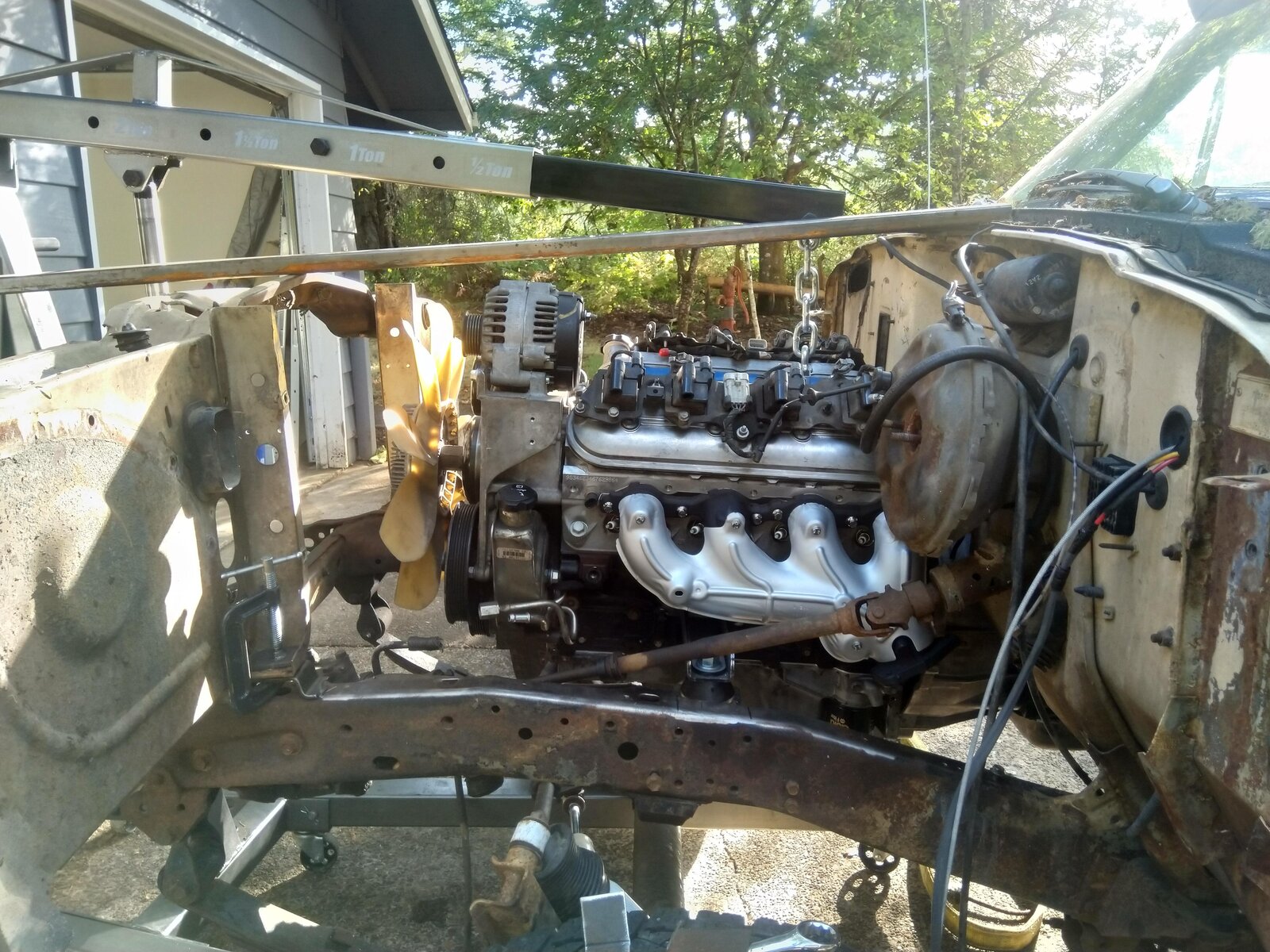

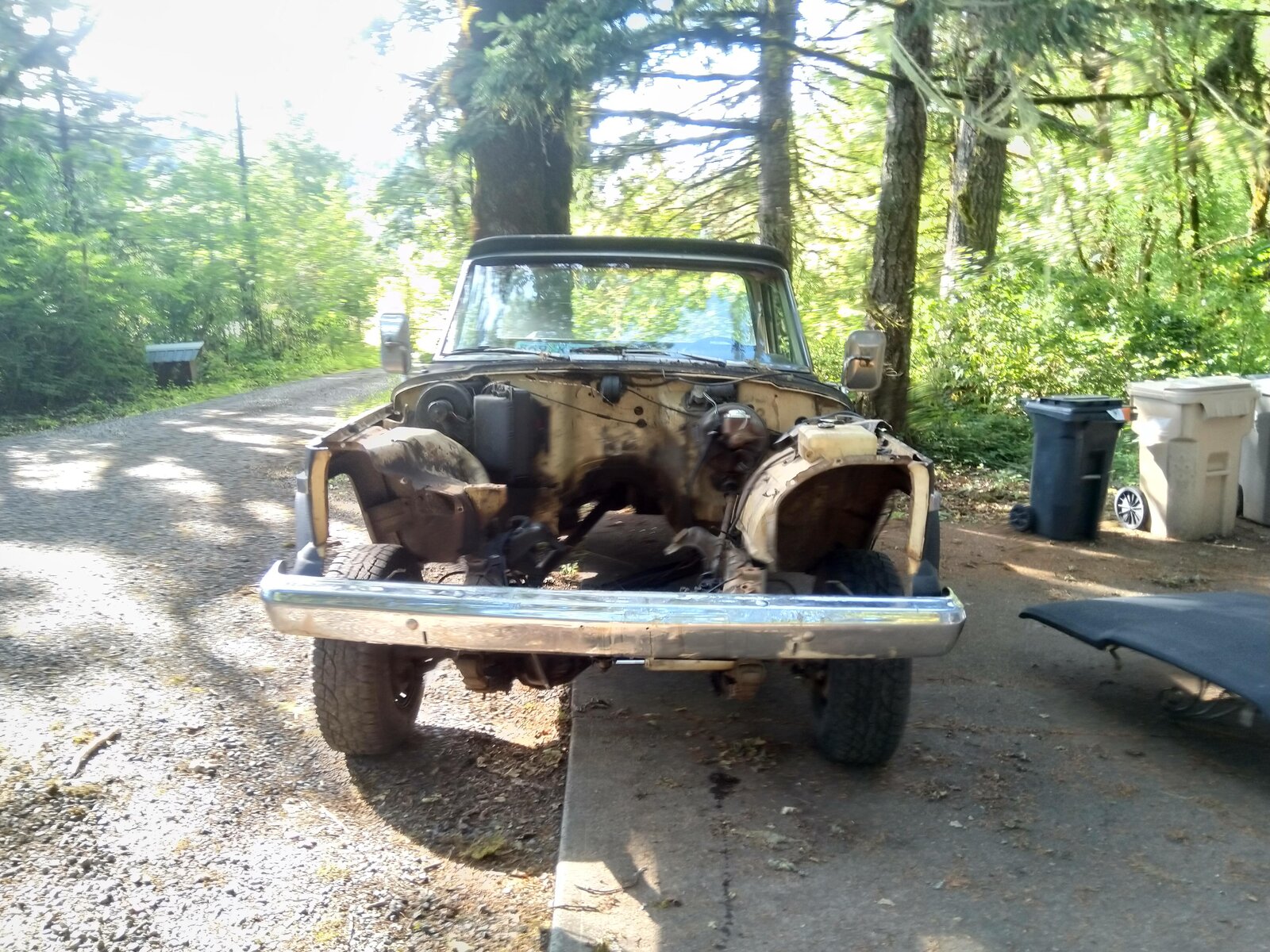

To start off, first thing I had to do was pull the bed off of the frame for easy access to everything. The truck's frame seems to be pretty solid, just some decent surface rust, although I did snap off most of the bolts holding the bed on. With all the bolts broken, and just one shitty harbor freight cherry picker I got to work.
Once I figured out how to arrange my limited selection of straps for an even pick, it started pretty smoothly. You can see in the background I had already removed most of the front body panels and started cleaning them up. Hooked the TJ up to the front of the truck and pulled it out from under the bed.
Turns out a maxed out shitty cherry picker sideways on a downward slope isn't very stable.
What you can't see are both inner and outer front fenders that are directly underneath the bed lol. Somehow I managed not to damage those to much. Both front lower corners of the bed are pretty bent to shit now, so I'll have some good body work practice ahead of me.
Either way, mission accomplished

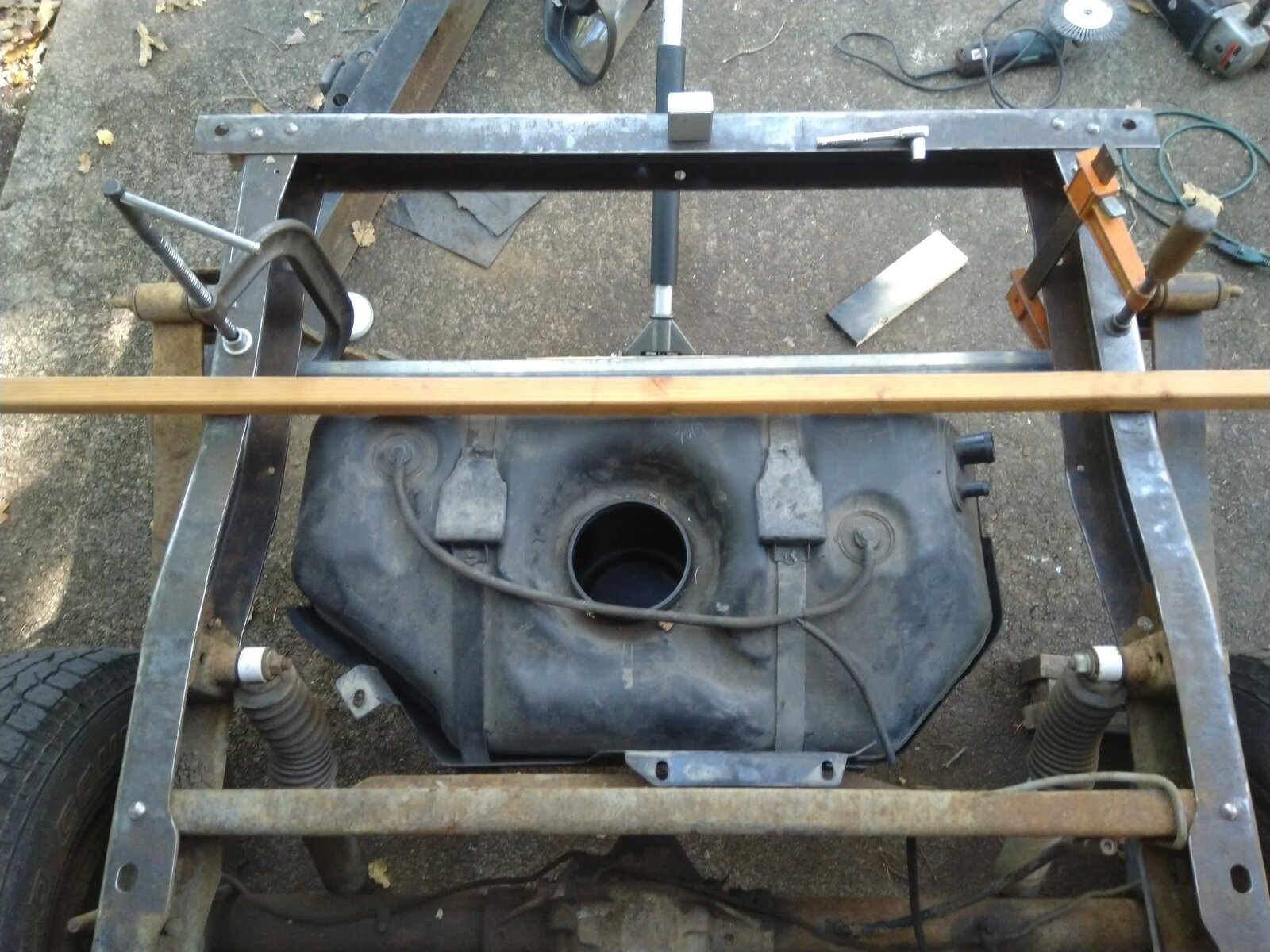

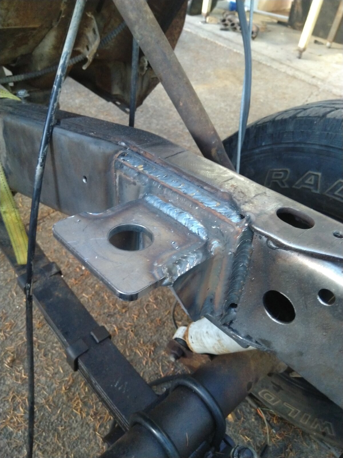

I whipped up a quick cross member for the TJ gas tank skid to bolt to in the rear, and mounted the front to the existing J truck cross member.
My Jerry rig drill press setup, actually worked a lot better than I expected to. This is one of my favorite drills, it's an old Black and Decker reversible drill I picked up off craigslist, had to search through this guy's entire back yard, basically a hoarder, completely stuffed to the brim with old stuff, tarps over everything. Picked this drill and some milwaukee hole hawgs up for cheap, along with my very first roper whitney hole punch, but more on those later
I got the extra TJ tank when I bought my Savvy TJ gas tank skid on craigslist, and just used my old factory skid with the extra tank. The tank didn't come with a pump though. From what I remember I don't think I found any aftermarket or replacement pumps that seemed to be as good as the factory one, or maybe I was just being cheap, but I picked one up off ebay for like $50. Hopefully it works.
