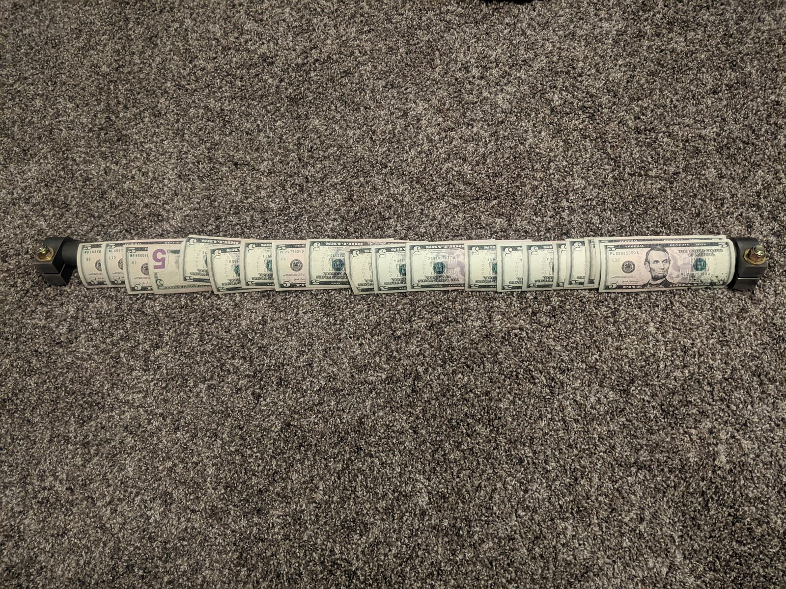

My new heat treated tie rod showed up since I won 2nd place in the Ride of the Year competition. Really thought a TJ flying through the air at 50 mph had that contest in the bag, but oh well.
Not really sure why there was an extra $100 taped to the tie rod. I guess @mrblaine just really must like me a lot. The girls at the club loved my fat stack of ones, they're gonna be all over me when I roll up with these big bills.
Thanks for putting on the competition @Chris I had a blast
Just shows that there are some folks who appreciate a good picture instead of an example ripped from a video of how to tear up your shit.
Whether or not I like anyone has exactly zero to do with fulfilling my promises.
And still after prompting, twice, you lack the courtesy to thank the prize supplier.
