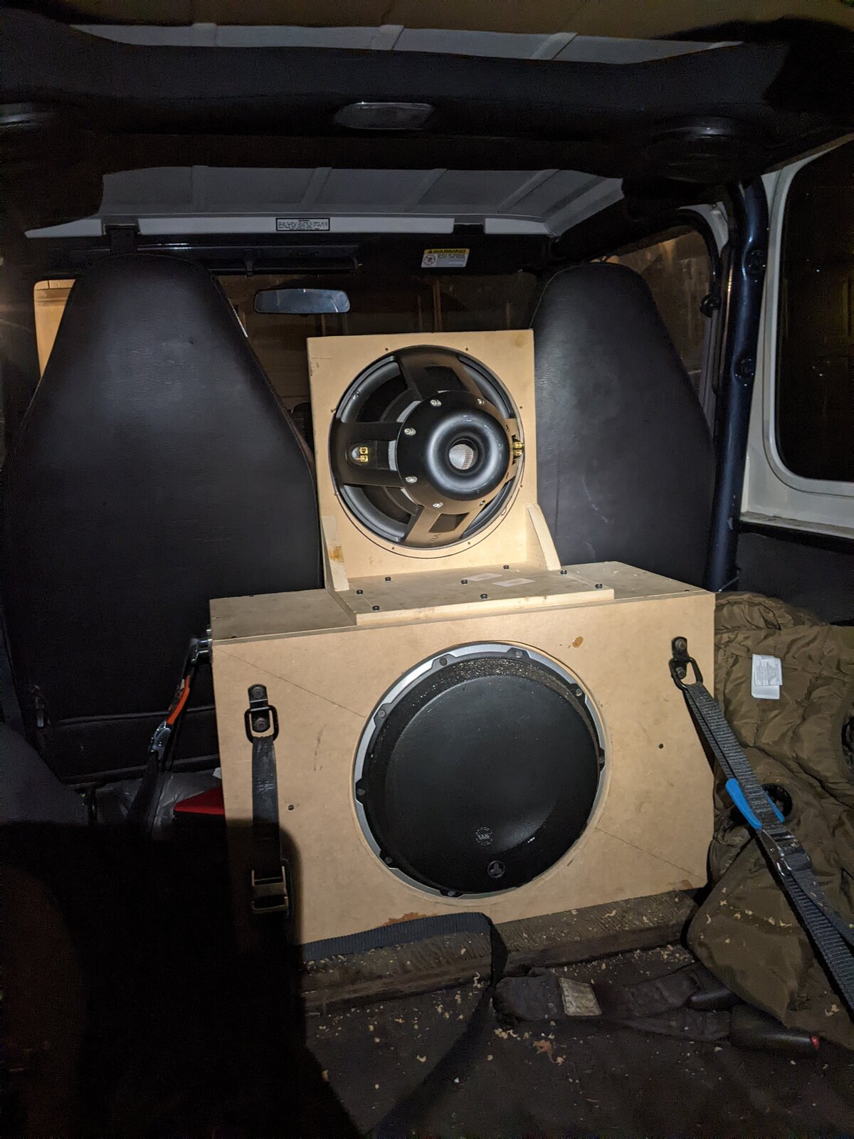

Well I got one of the pods in at 4:30am before I went up in the snow. Honestly not as much of a difference as I was hoping for, but it did sound a bit cleaner and the gains were still set for the stock mounts with the speakers in open air. I think I should be able to crank it up a bit once both pods are in due to the increase in power handling from the sealed enclosure.
I got some measurements the other day, they aren't the best as the near field measurements of the stock speaker mount was done a while ago, but I'm pretty sure I had all my settings the same. I'll get some better comparisons when I get the second pod made and can measure both setups in the same day.
This is a near field measurement with the mic 6" away from the speaker to try and just measure the speaker, not all of the reflections in the vehicle. Purple is the new pod and green is the stock mount. I had the LP filter set differently, so ignore everything above 3k hz.
This is an average of 8 measurements of each setup in my normal listening position.
Blue is the pod and red is the stock mount. This had a 63hz HP filter. The pod is definitely different lol. I'm still a pretty big noob with this stuff, but it seems to have helped out my low end a bit, I'm going to do some more testing with varying amounts of polyfill in the pods to see what I like best.
I think it's an improvement though, I was trying to improve the low end of the 5.25s so I can cross to the sub a bit lower since I'm only running 2 way active plus the sub right now, the sound bar is completely disconnected.
The response is still pretty rough though, not sure what's going on around 1200hz.
We'll see what the polyfill does. I'm just trying to see how good I can make a 2 way sound for now, then I'll switch to a 3 or 4 way plus sub. This guy showed up the other day though, should be a huge step up for processing power vs the 80PRS head unit.

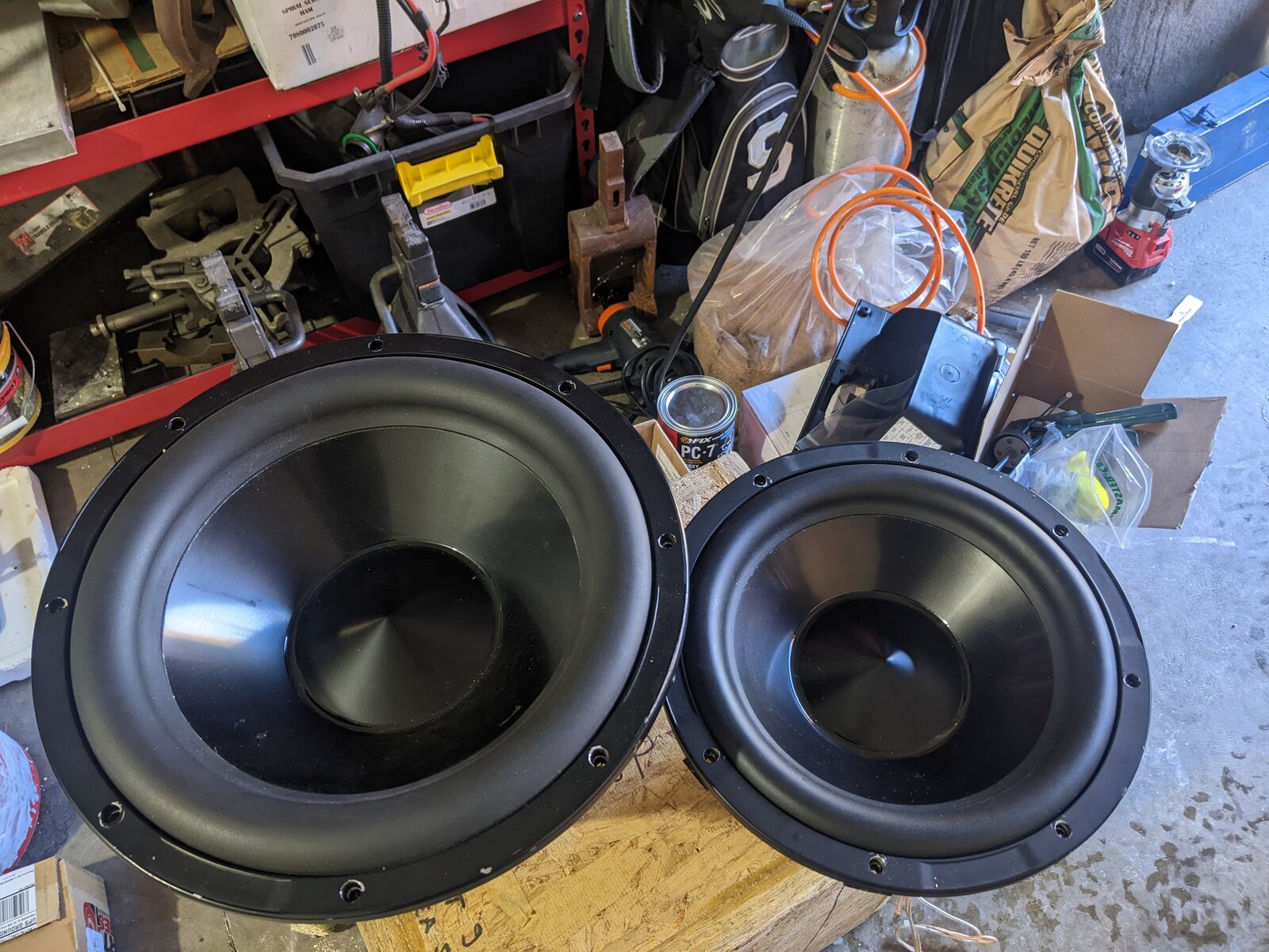

Found two tiny pinholes in the surround on the 12". Used some of the leftover glue from repairing the JL 12" to try and seal both sides of the holes. Hopefully they won't spread anymore
OP
Trevlaw
Trevlaw
Sketchy Machinist
Jan 8, 2021
678
Corvallis, OR

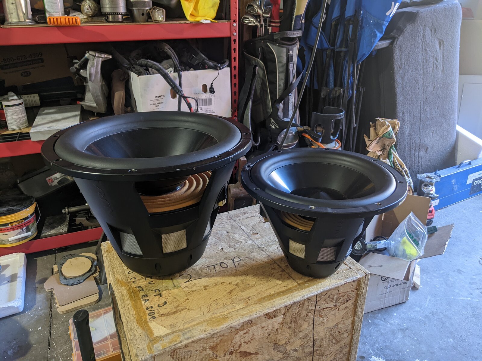

Side by side with the JL 12w6v2. Interesting how different they look and how much bigger the spider on the JL is.
I did test out the 12 today, swapped it into the JL's box. I think it sounds every bit as good as the JL after 30 minutes of listening, but my left ear is real fucked up right now, even more than it usually is.

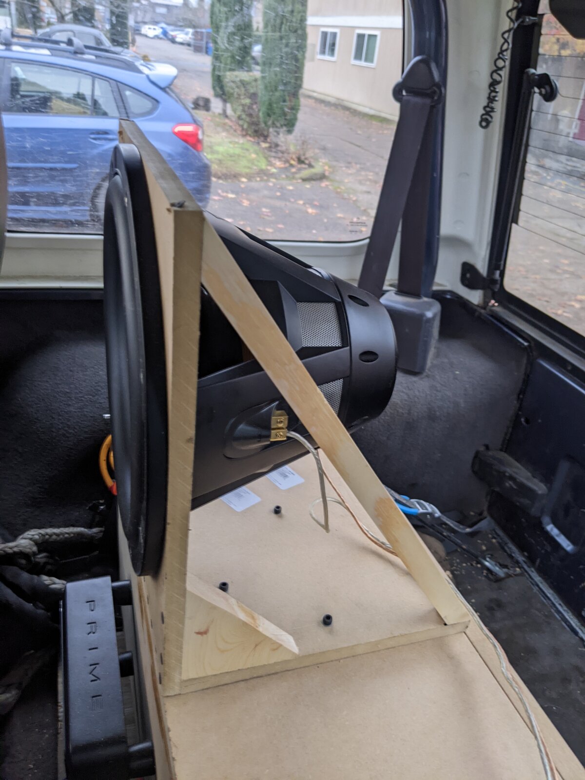

That orange line in the previous graph is the current experiment. A single mono dipole midbass in the form of the 12" Aurasound subwoofer mounted on a small baffle playing 60hz-150hz.
I was trying to get the gains set on it and found it makes an odd chirping noise when I get to a certain gain level.
I ruled out excursion as the issue, the baffle, and I'm pretty sure I'm not clipping. I disassembled the sub today and the voice coil and magnets looked great. These subs are known for the nickel plating on the magnets flaking off due to high temperatures when run at rated power. So it was nice to see they all still look brand new.
I'm going to try a different amp tomorrow, but I'm pretty stumped at this point.
Wondering if I'm just at the natural limit of the driver in this configuration, but I can't figure out what it is and nobody seems to be able to identify this noise. It's possible though, this dipole should start rolling off around 2k hz at 6db/oct, so I'd be about 24db down by 125hz which is quite a bit
