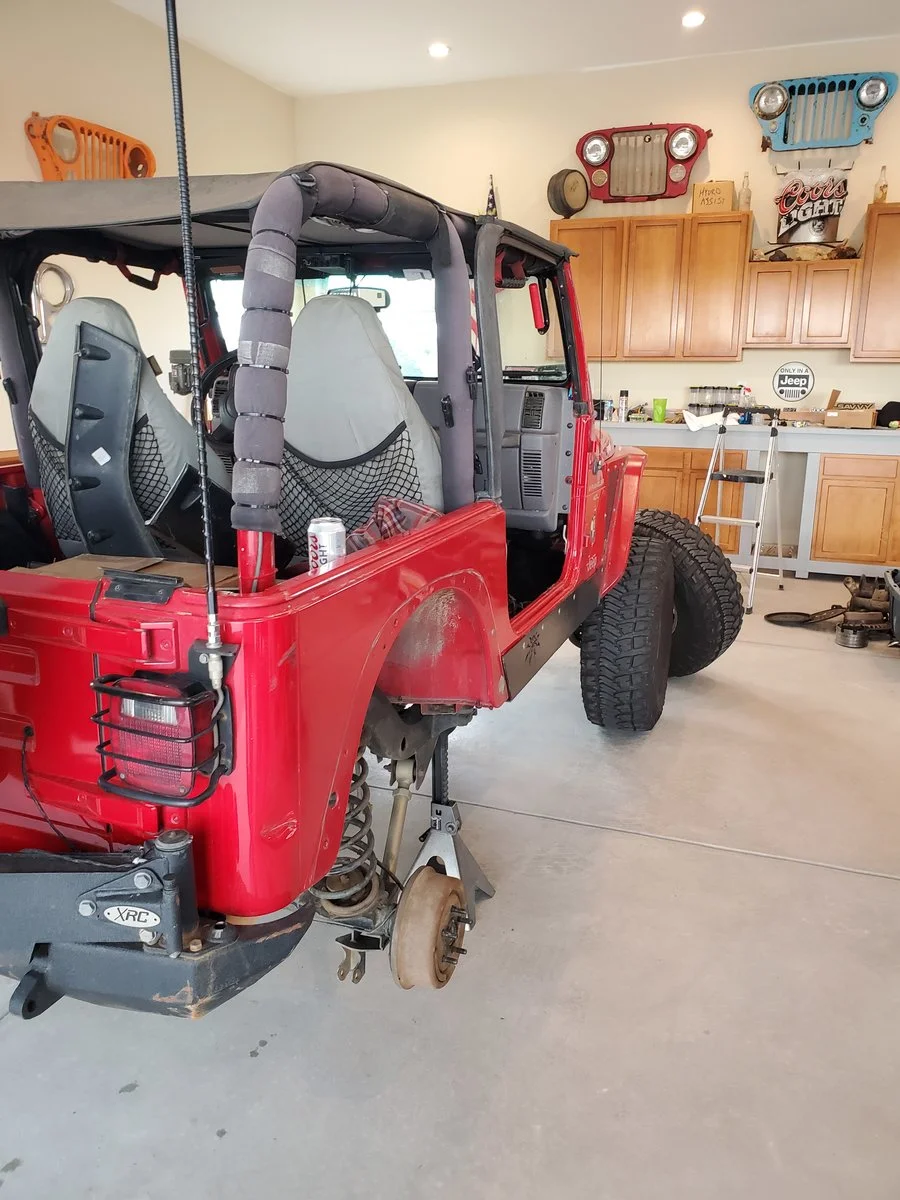

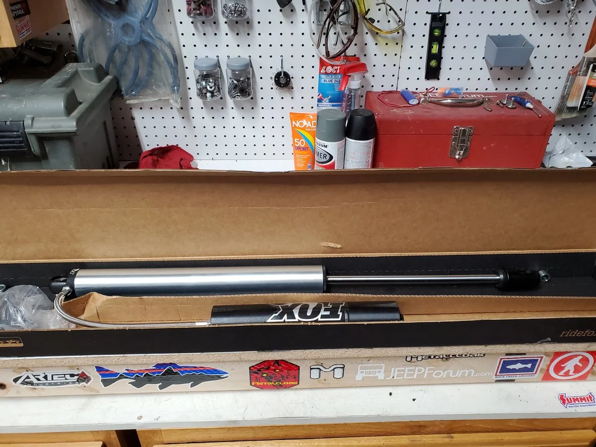

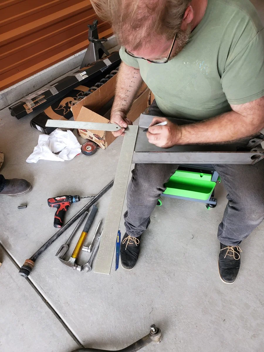

In preparation of the outboard this weekend I purchased a set of currie coils. Not sure how old my superlift coils are and their free length, or compressed length. So I am taking out the guesswork. Both front and rear should be here by Friday. Fronts will go in at a later date.

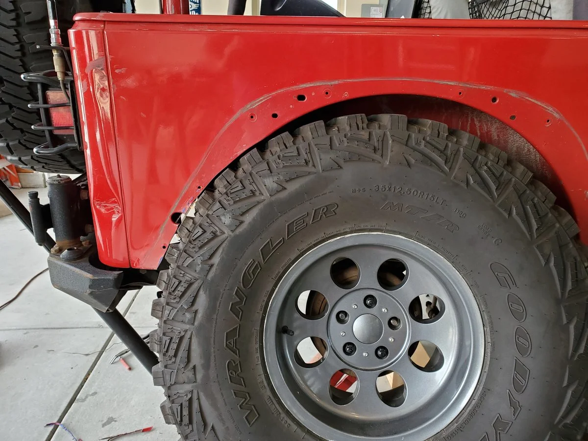

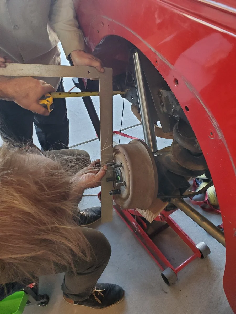

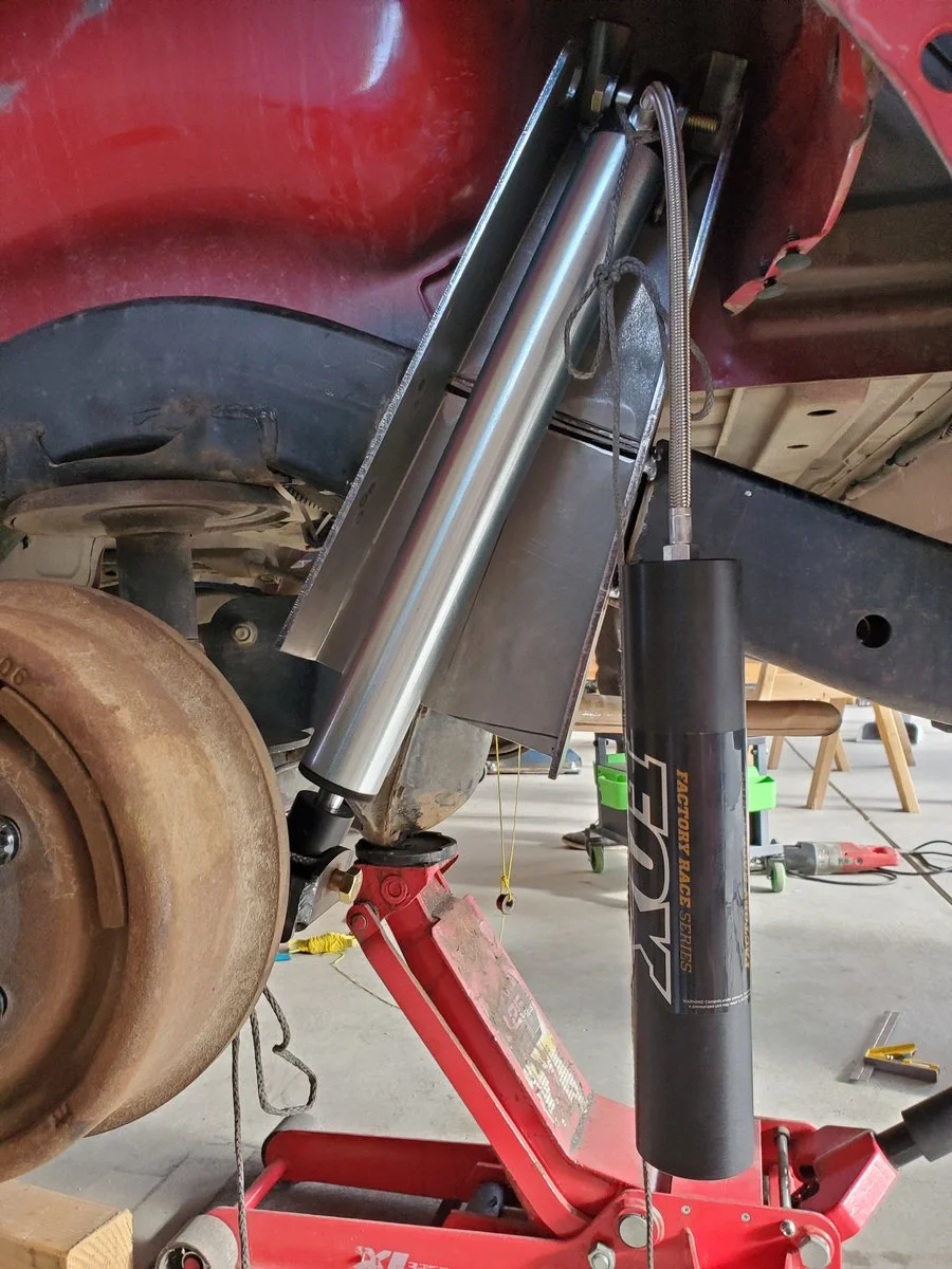

Full bump and clearing the body which happens to be in the way

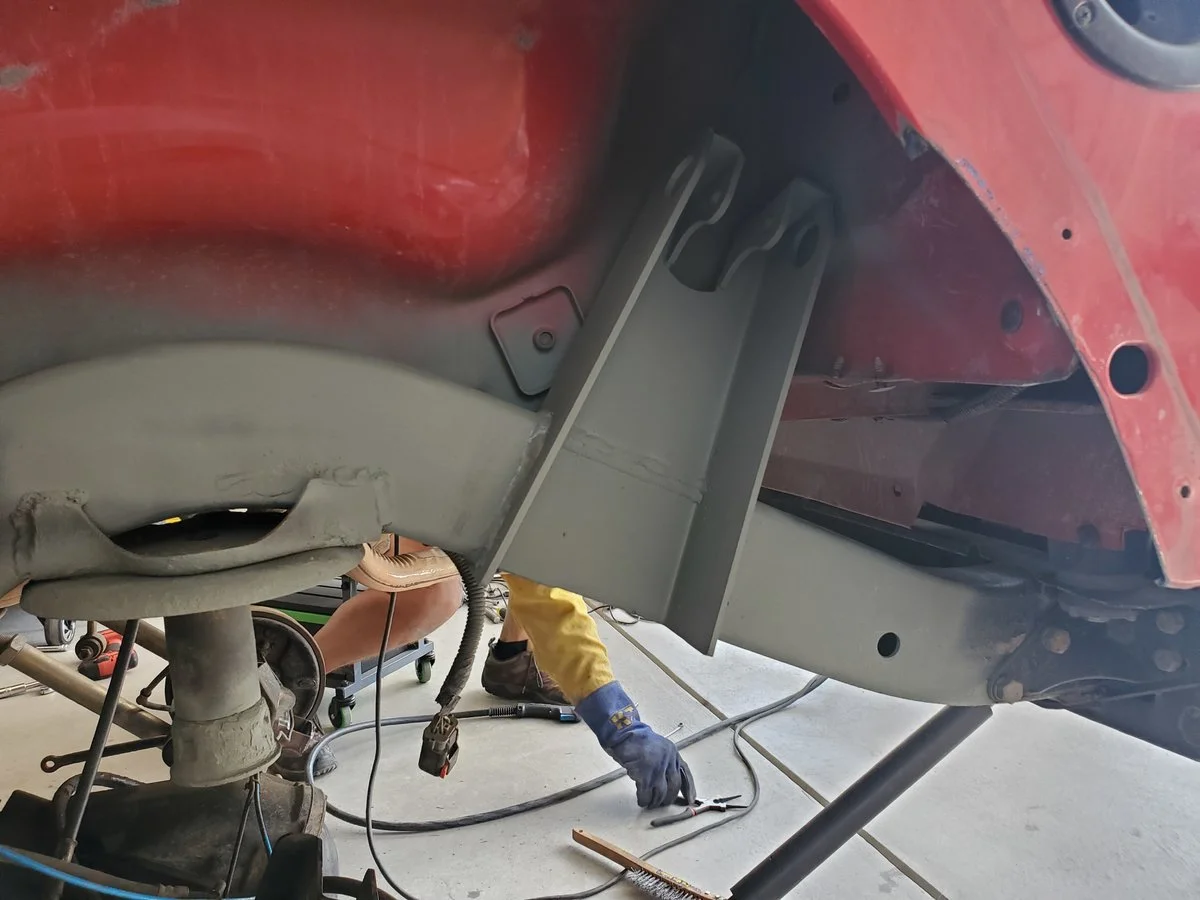

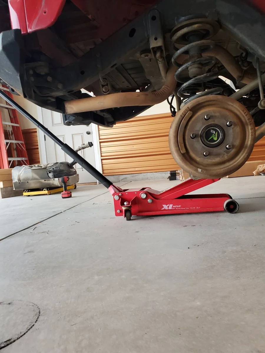

Finding center

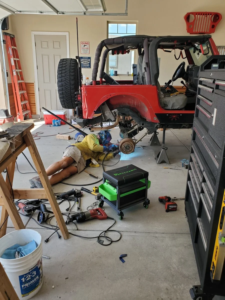

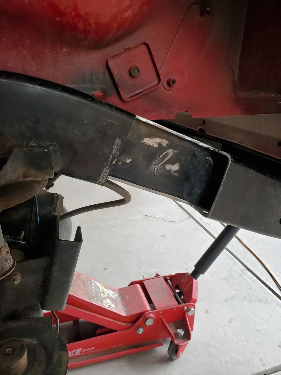

Setting tower placement based on collapsed length

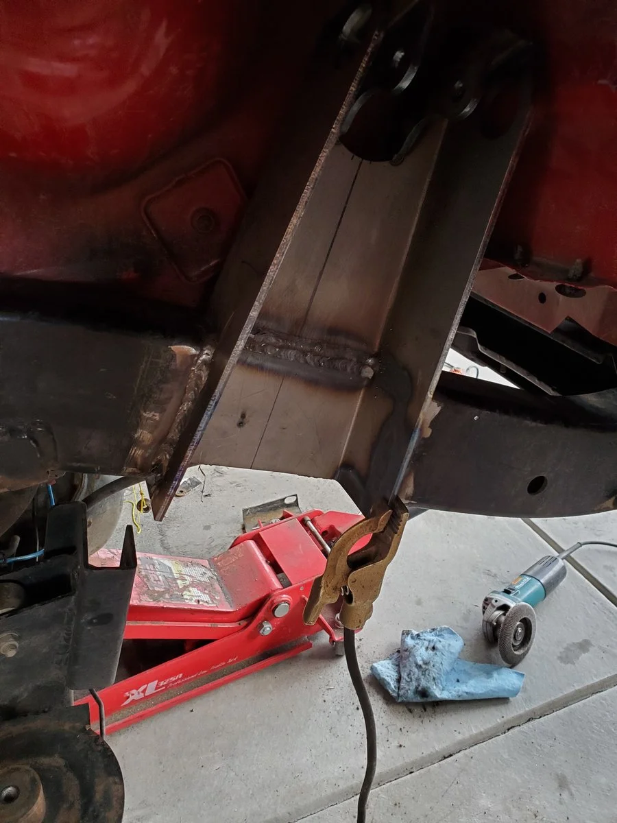

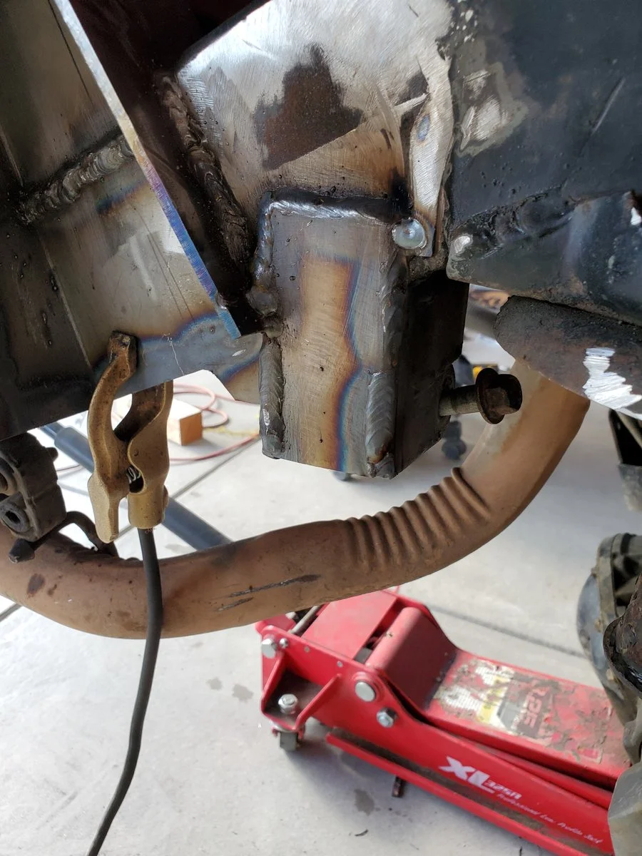

Burned into place

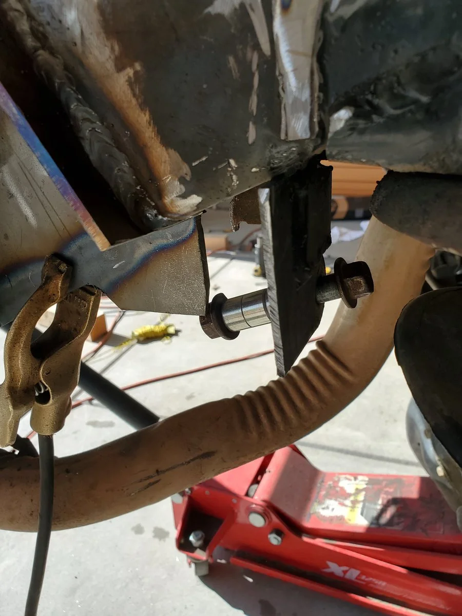

Minor setback, thinking the backspace of the wheels are causing contact. We were able to set the mount differently. At full bump my tire clears the shock body by about thr length of a tire whisker.
Track bar mount is rebuilt.

It's a long process. Most of it discussing what is going to work and what is not. I might have gotten impatient at one point but they all slowed me down and we got the clearance that was needed after some minor adjustments. I am headed on a work trip today and taking the jeep to try and get everything broken in and settled.
