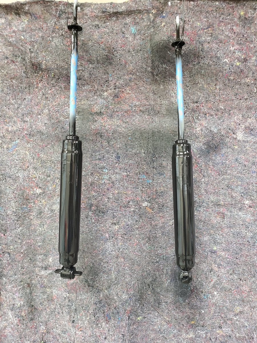

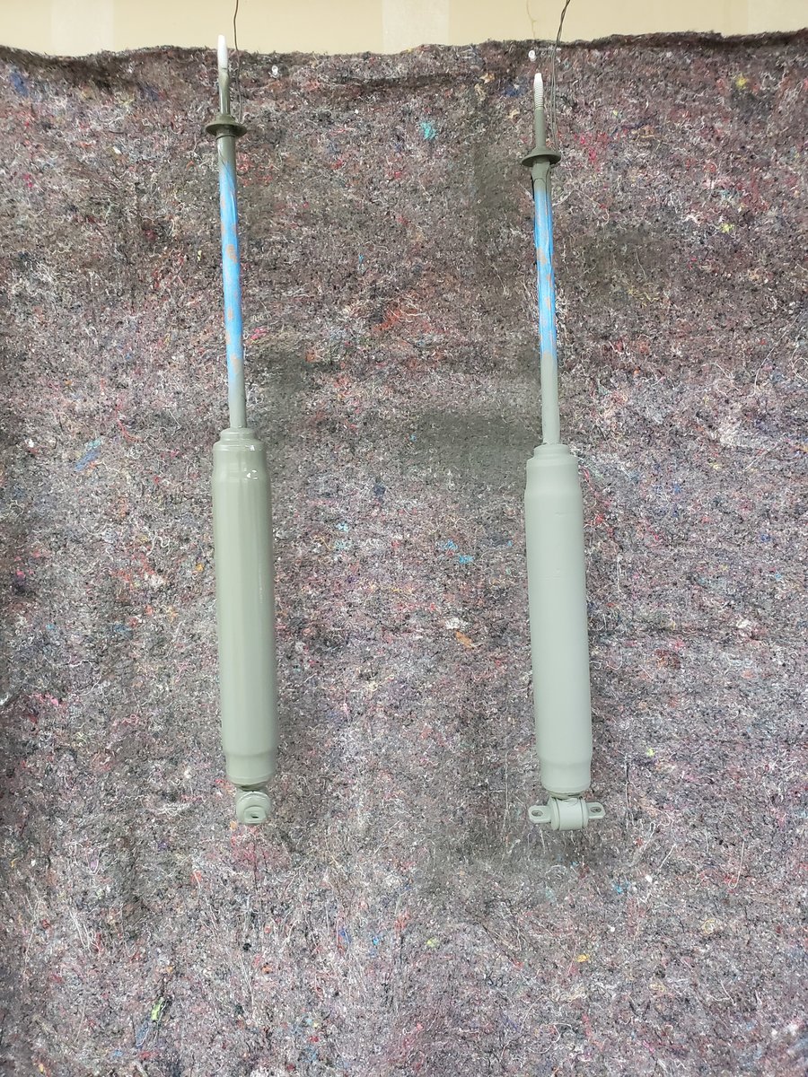

Shocks arrived on Saturday. I can see why these things rust quickly. One already has a scratch and the paint looks like it was applied haphazardly. Ill scuff them up and throw on additional primer and another coat of paint (probably black since I have a ton of it)
Reactions: T_Hase89 and jjvw
Scuffed, primed, and colored. There was maybe one, real light coat of white the way they came.

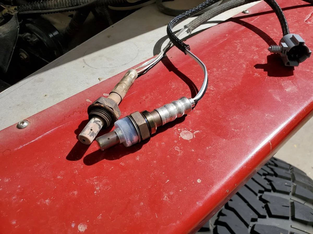

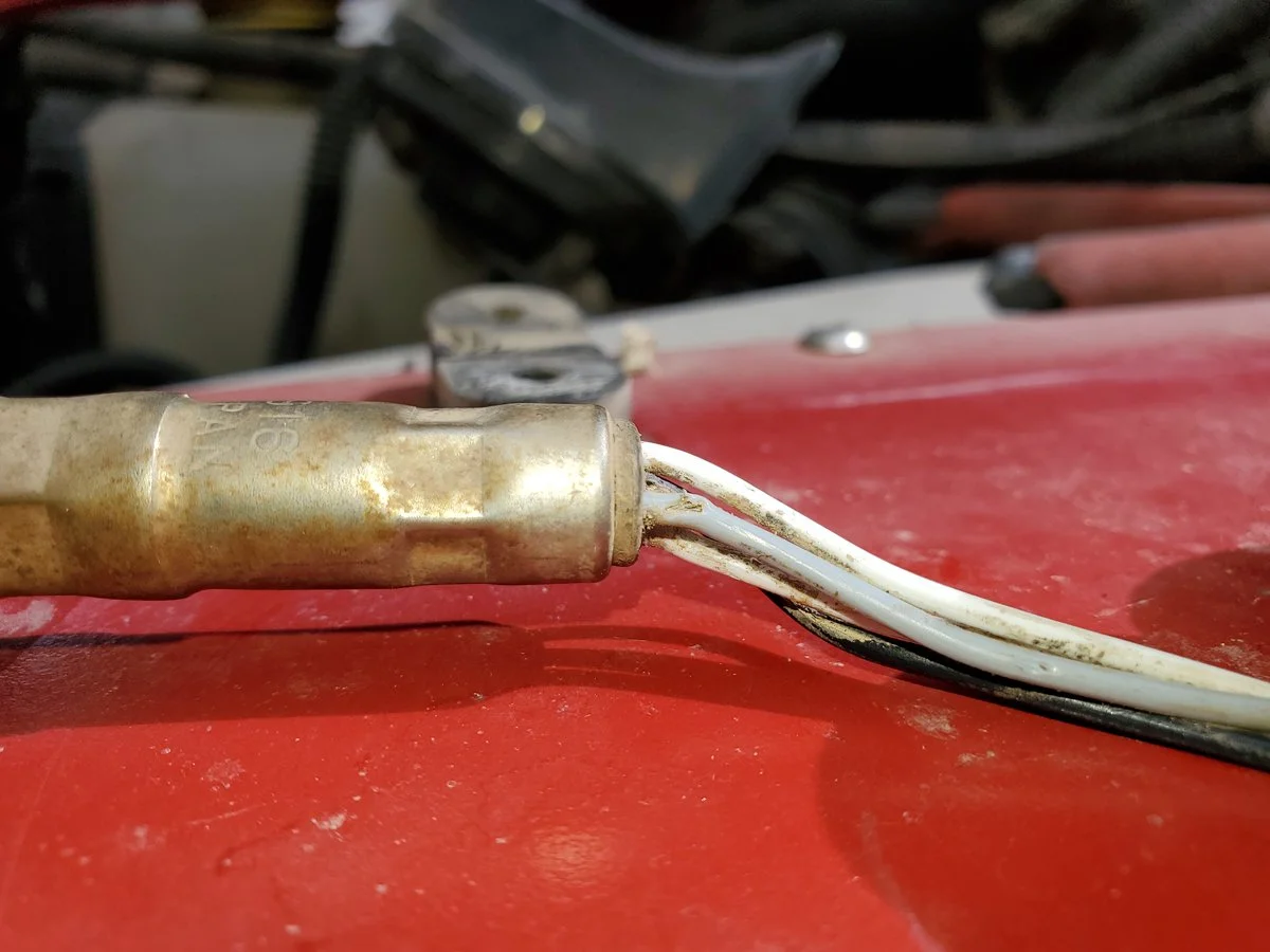

I swapped my 02 sensor today. I had no issues prior to do doing this, but it was one of those things that I didn't know if it was original or not. I pulled off an NTK sensor so I am assuming original. 127k miles. I inspected afterwards and found a small break in the insulation, had I not pulled it today I am sure I would have experienced an issue this winter.
Replaced with another NTK. 23151 according to the forum. The downstream was replaced three years ago when I replaced the cat.

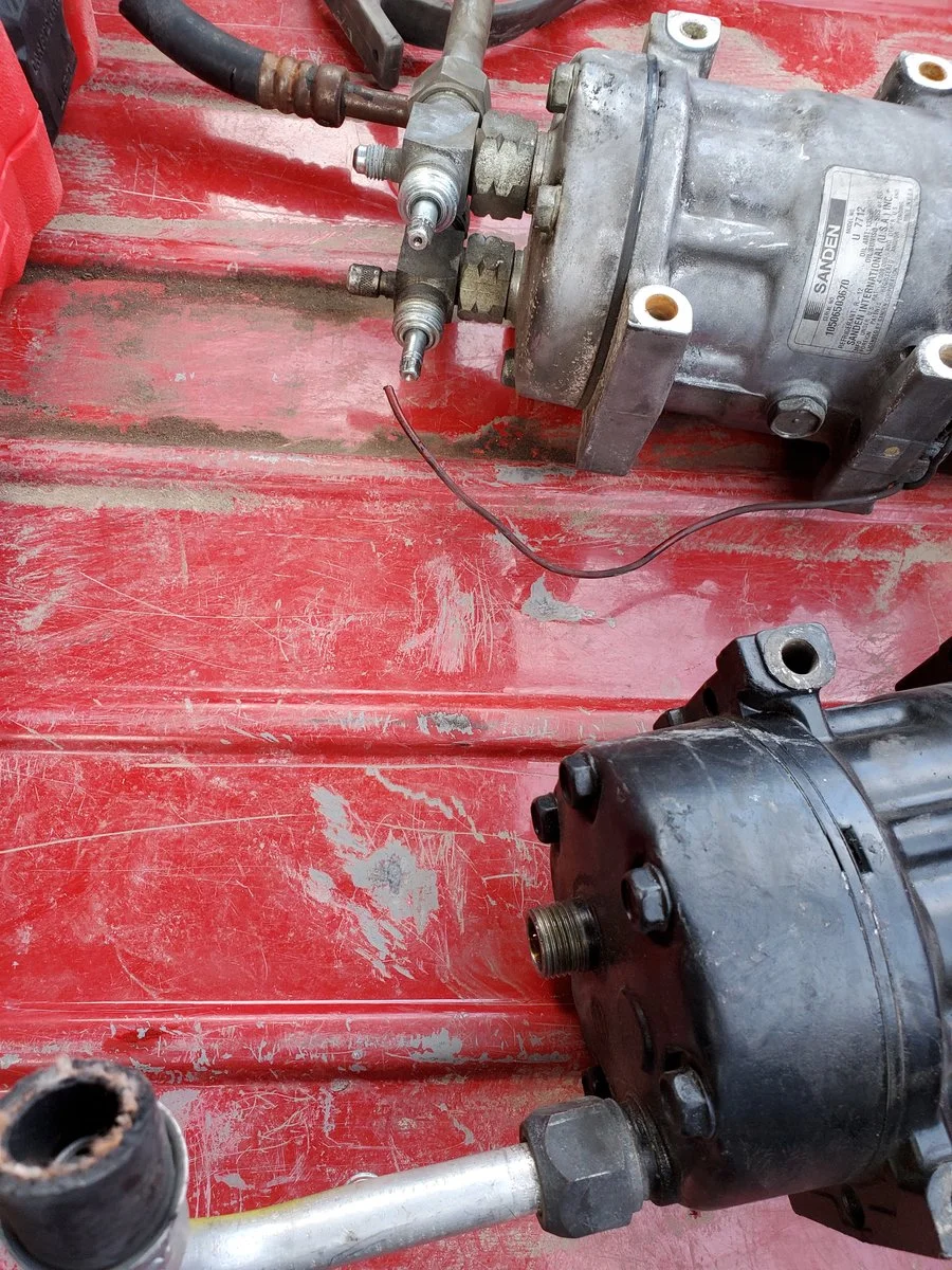

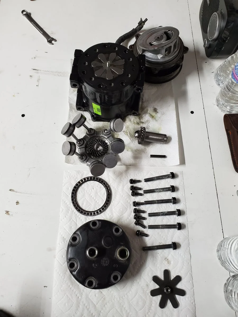

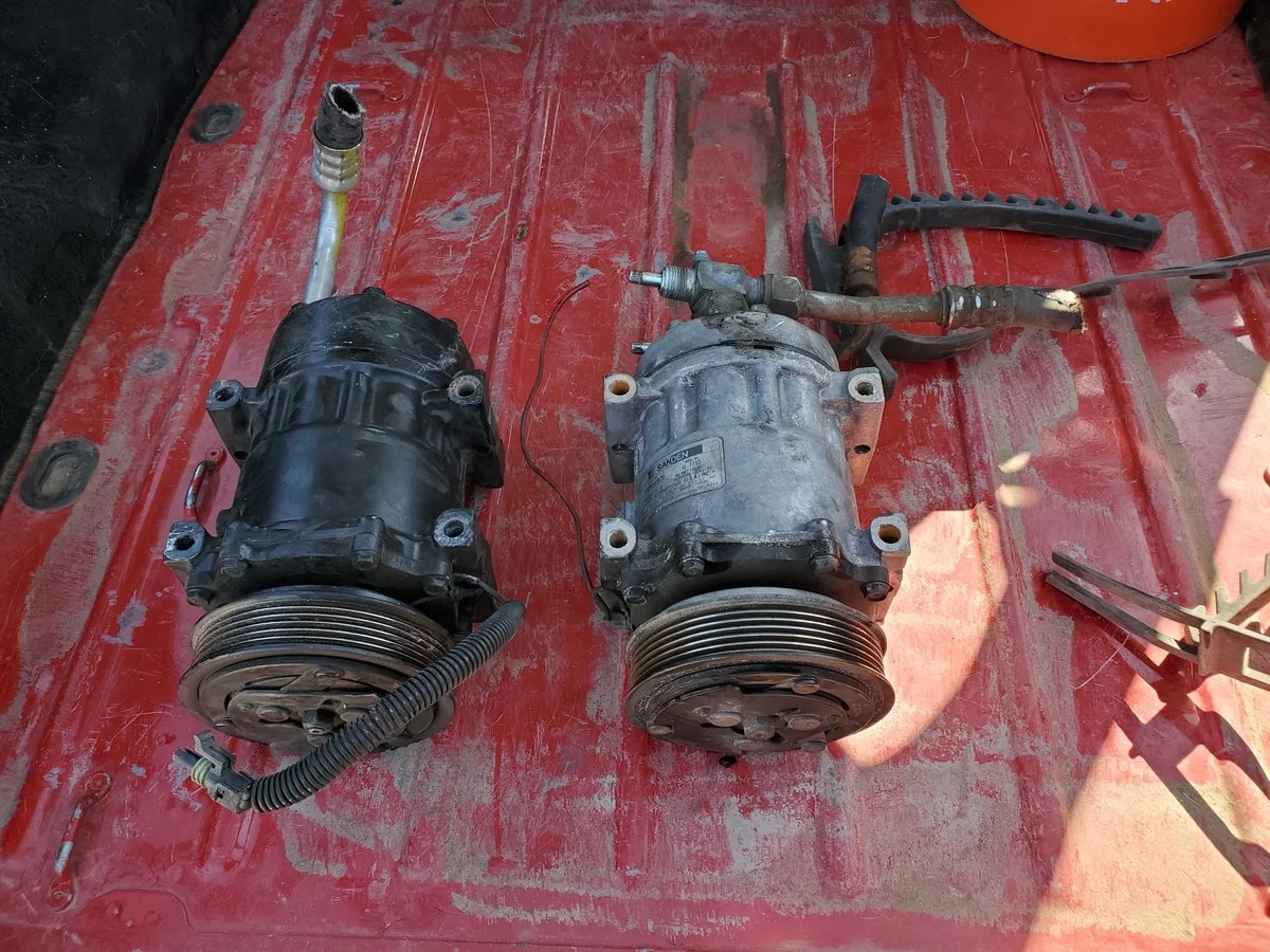

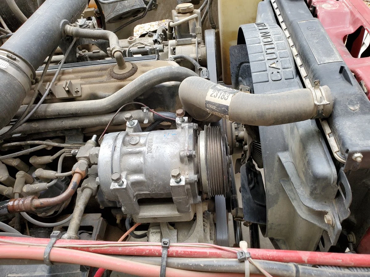

$99. I'll keep one as a spare. They both blow air when the clutch is turning. Both turn awfully smooth. One is stamped 709TA11 which I am still trying to decipher. The only difference I see between the two is the suction and discharge ports are horizontal vs vertical
Reactions: TJ Starting
Looks like the same fittings as my York. They are an unusually large flare fitting that needs to be transitioned into NPT. Commerce City Ace Hardware had what I needed.
These are actually already threaded. 3/4" (ish) by eyeballing it. My leatherman wasn't big enough to turn these to remove them.
The black one looks like it may have been a refurbished model (guessing) since it has been painted black. Its also missing the original sanden tag. The other one (709T11A) as far as I can tell just held a different type of refrigerant. These came out of a 93 and a 95 XJ.
