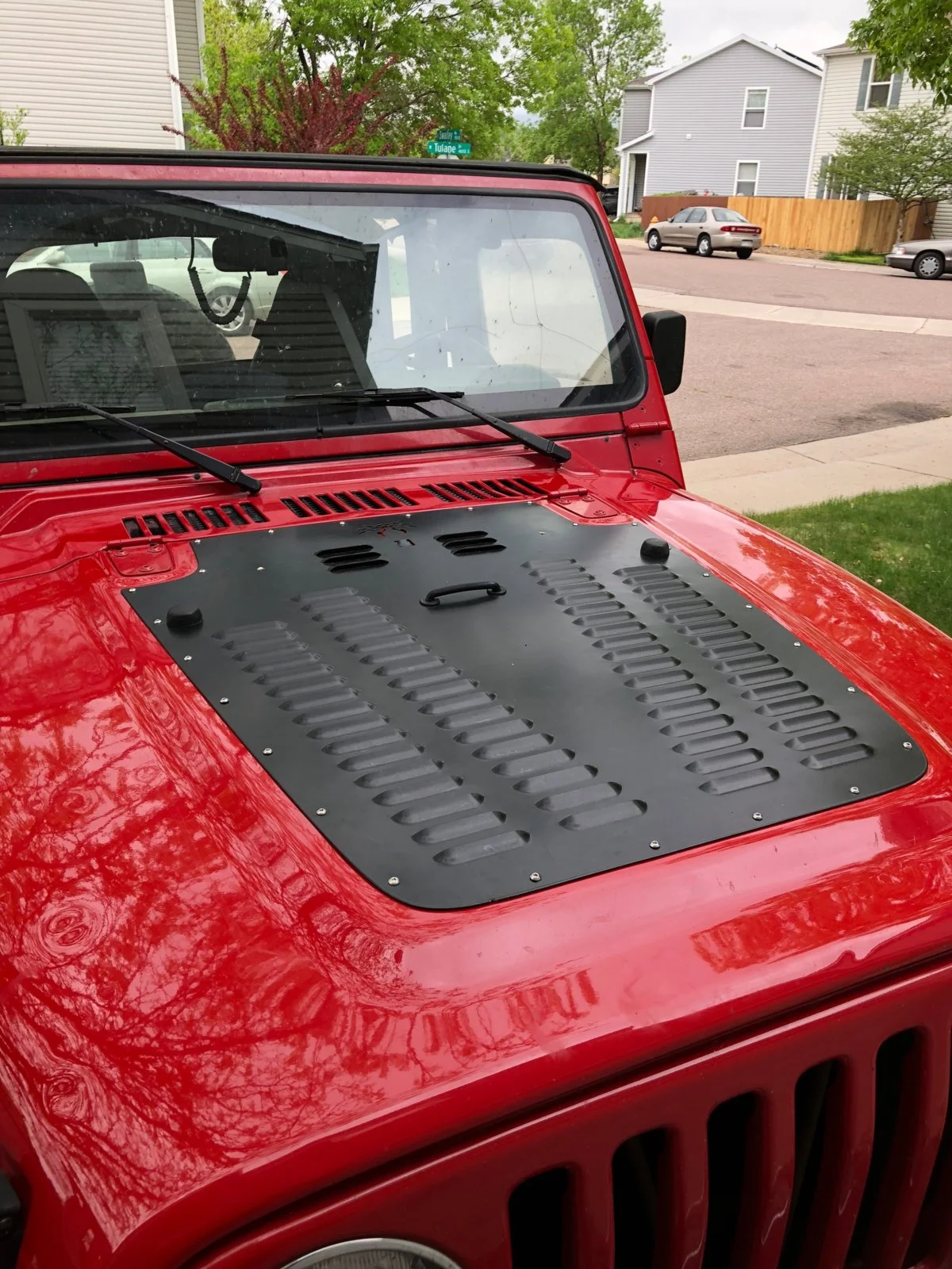

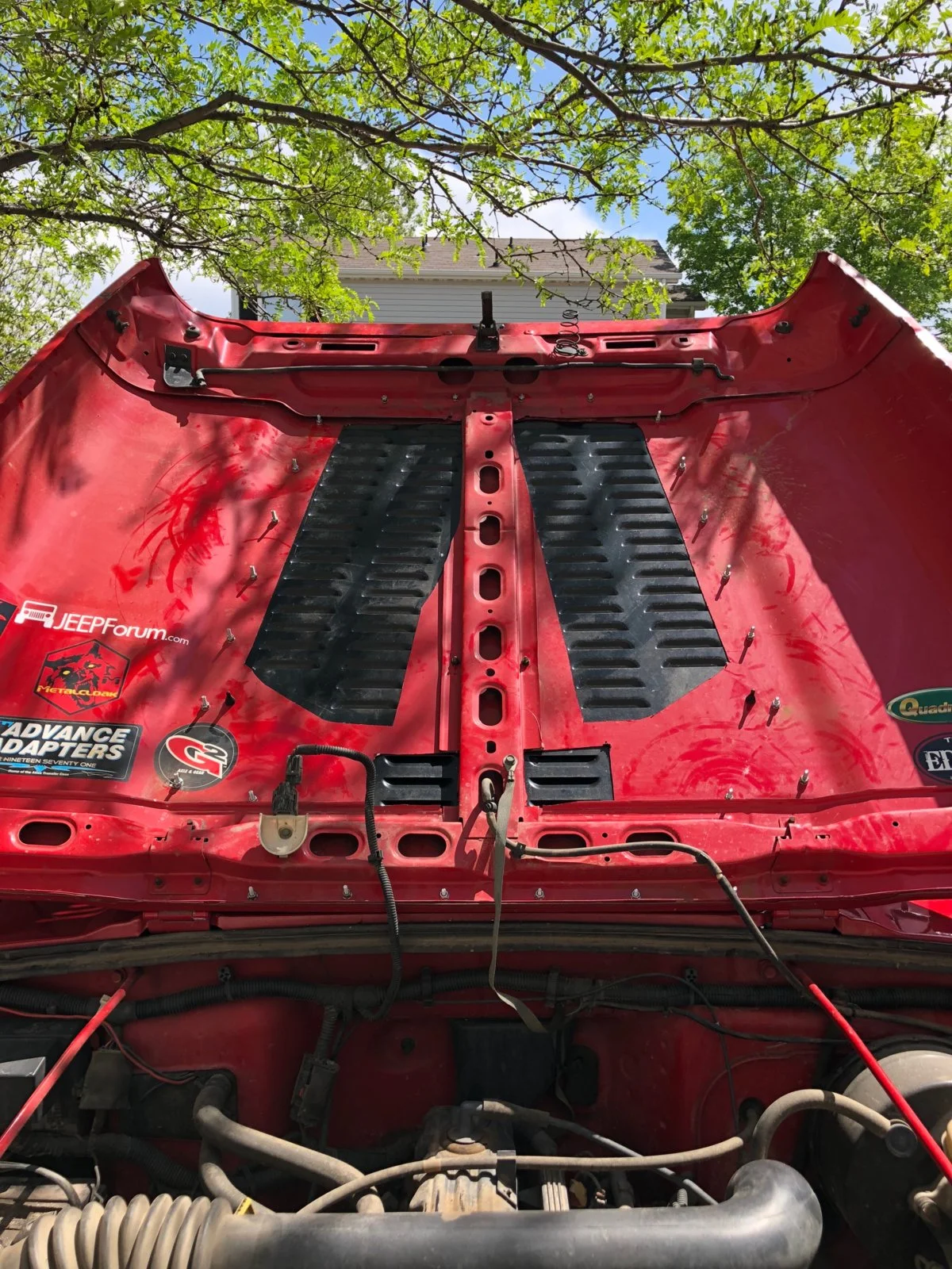

Slapped this Poison Spyder hood louvre on last week. 2nd hand and picked it up for free. Had no hardware or template so I had a lot of trial and error trying to get the cut outs correct. Not a difficult process but given my circumstances it took several hours to mount. Cuts were made with a fine tooth blade on a jig saw.

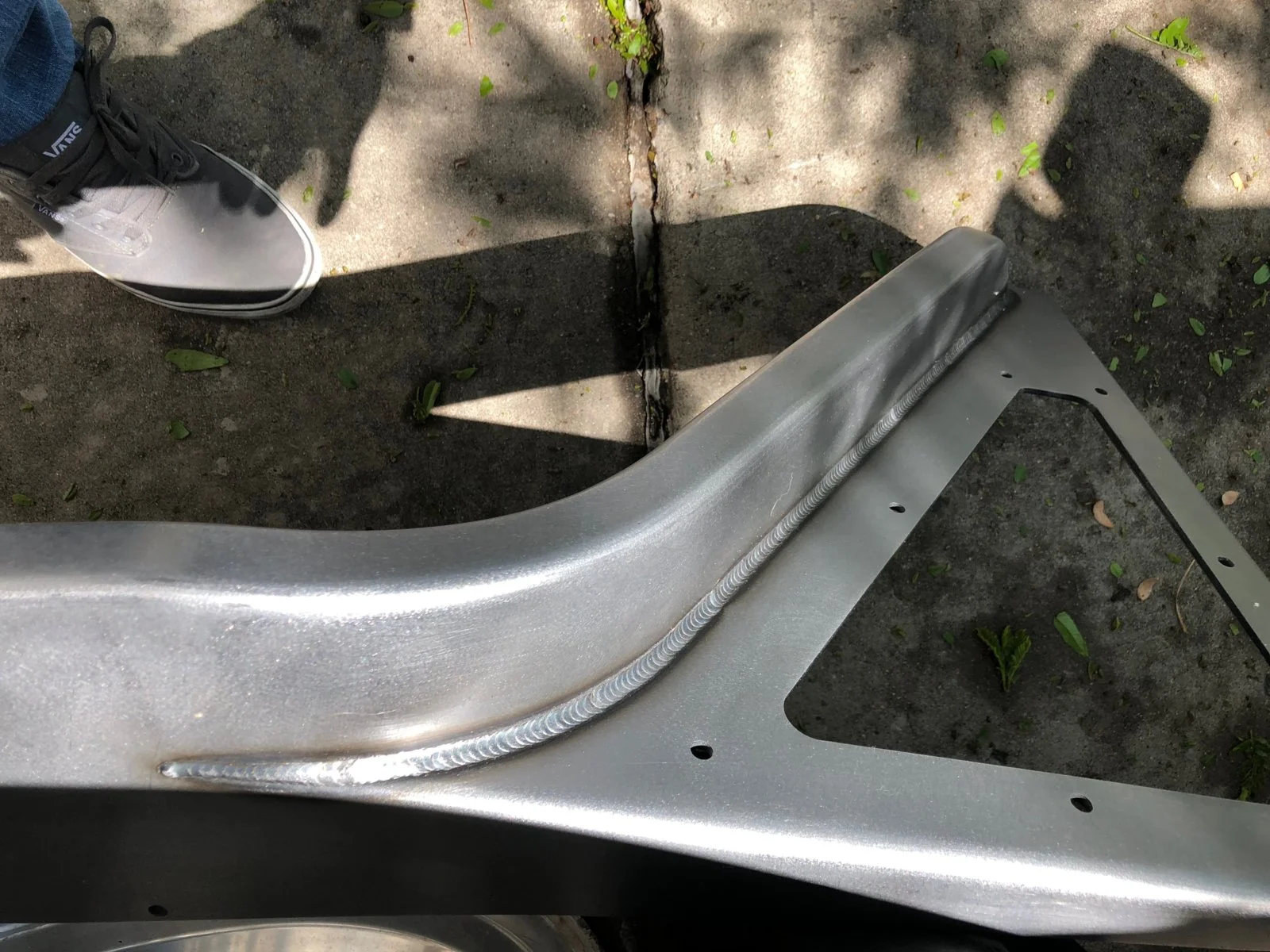

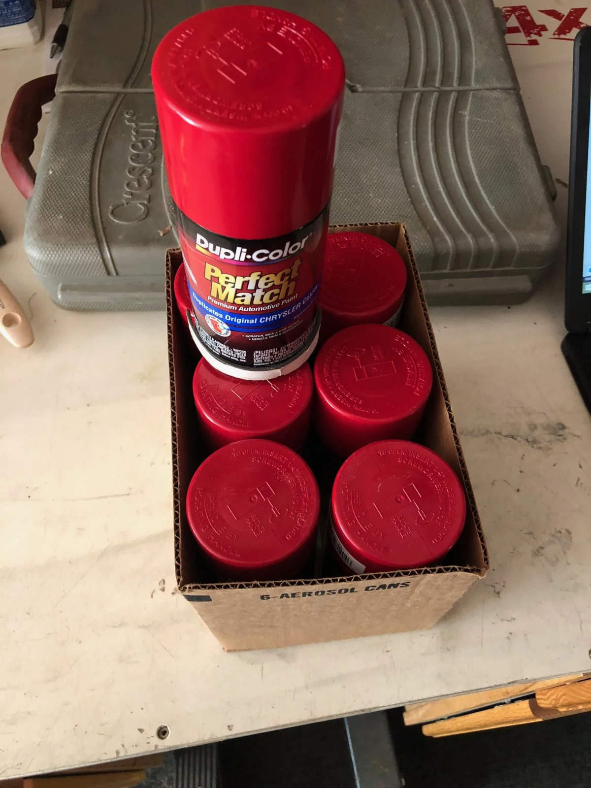

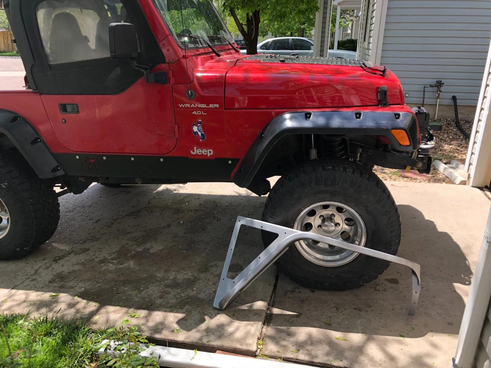

Also, picked up a set of Poison Spyder Defender XCs with a 3" tapered flare. I really wanted aluminum to keep things light, but the only one I could find was the negative flare version. Since this is still a daily driver I wanted a little bit of coverage. With this came a windstar intake, JK turn signals, and day star hood pins. I was also feeling weird and decided to pick up some PR4, Flame Red Chrysler Paint. These suckers are going to be color matched! I am going to do my best to get them test fitted this week, and hopefully prepped/painted by the weekend. We have some holiday plans that I just found out about so it may hinder my progress...

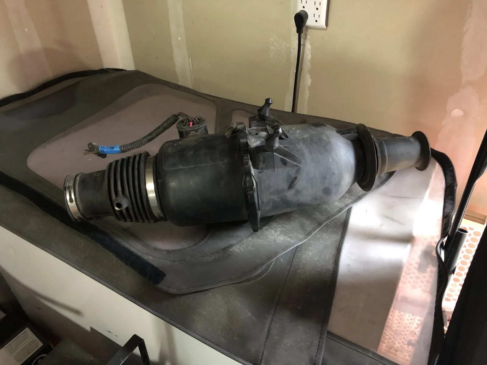

I started modding this last night, the tabs to keep it in place on the windstar have been removed, as well as the metal tab on the lock ring. I spoke with jjvw yesterday and compared his. I am going to copy his design and cut out the inner tube (technical term?) Its not restrictive by any means, but hey, why not?

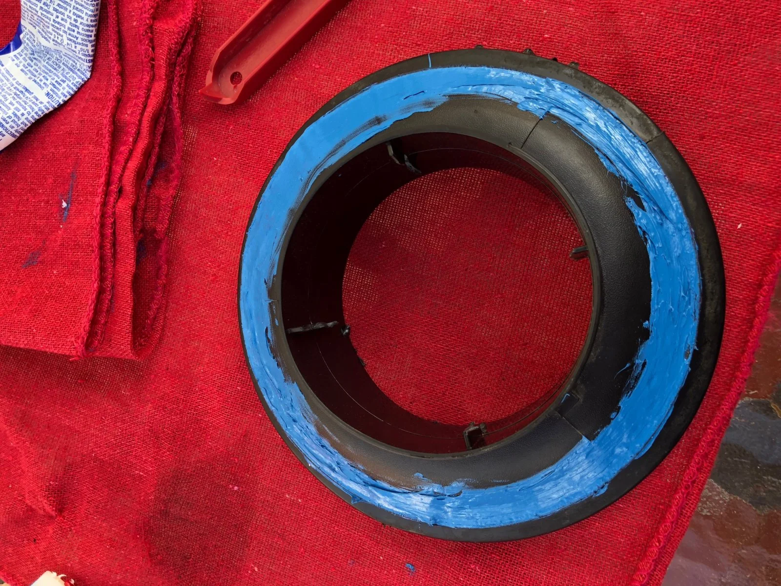

A little progress on the windstar intake was made. The section that housed the MAF was cut down to about an inch on either side, and mated together. Its not the cleanest RTV job but should hold. I am not going to win any shows with the hood popped open...
Test fitting of the hilines went well today.

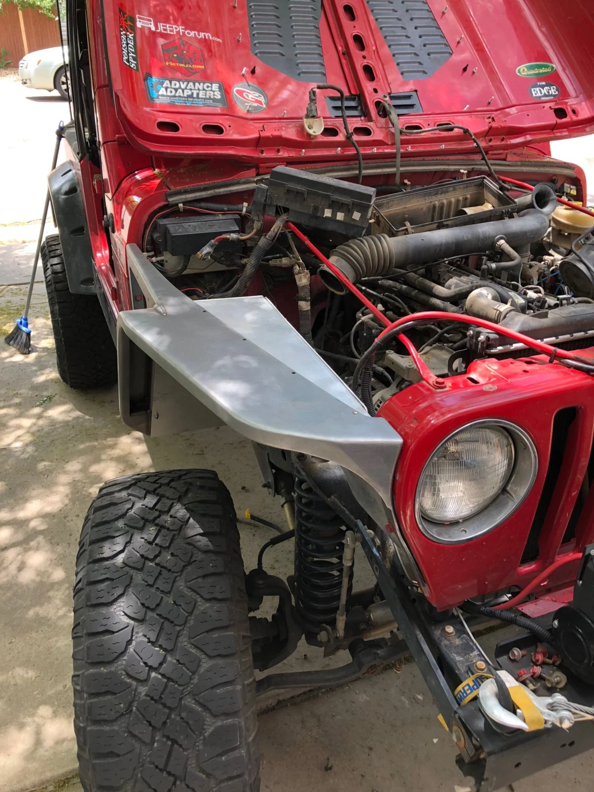

I started to panic earlier because the grill mounts were roughly 3/4" off. What I ended up doing to resolve it was loosen the grill supports and pull the grill out a bit, then muscled the fender into place, once a bolt was threaded in the rest lined up. Going to Prep and prime later this afternoon. I also spent a couple hours Friday looking for a 90 degree 3" to 4" silicone elbow but couldnt find one anywhere in Denver. I have one on order from ebay, hopefully its here by Wednesday and that will complete my windstar CAI.

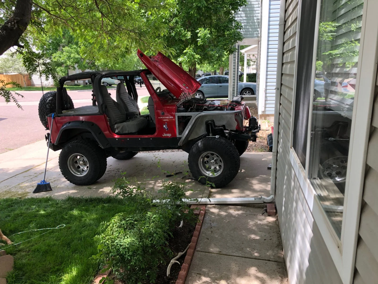

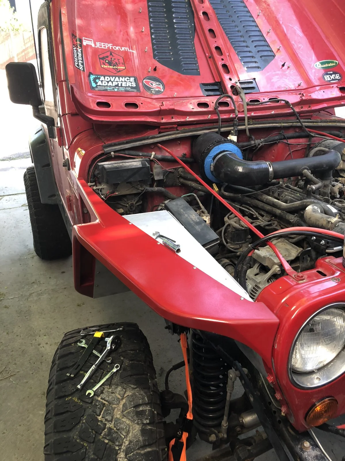

Sanded with 400 grit, cleaned well with mineral spirits, 5 coats self etching primer, and 5 coats of color. Throwing down 5 coats of clear tomorrow. I also received my 4-3" elbow for the Windstar intake. Went to drill the 3" hole in the firewall and my drill died. Should be ready to go later tonight. Hoping to have the intake finished tonight, fenders mounted Saturday, and spend the rest of Saturday remounting the fuse box, washer bottle, EVAP canister, and ARB compressor
Passenger side done. Still need to mount the fuse box, shouldn't be too difficult. The driver side tray where I have my ARB compressor needs shaved quite a bit which I'll finish up tomorrow. I think I'll have everything wrapped up tomorrow which includes mounted, equipment located in their new places, and hood cut.

Drove around about 40 miles yesterday. The windstar intake definitely has a "whoosh" to it, but performance wise I dont notice anything different. The day star hood pins hold the hood down tight too, though they will take a little bit to get used to, I keep thinking I left a tool on my hood.
