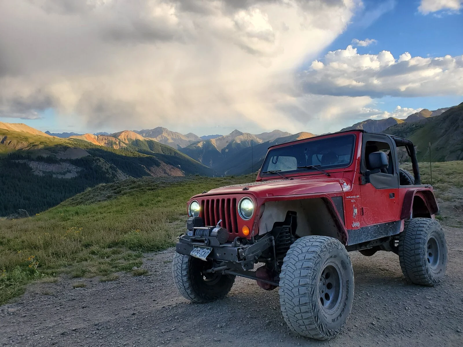

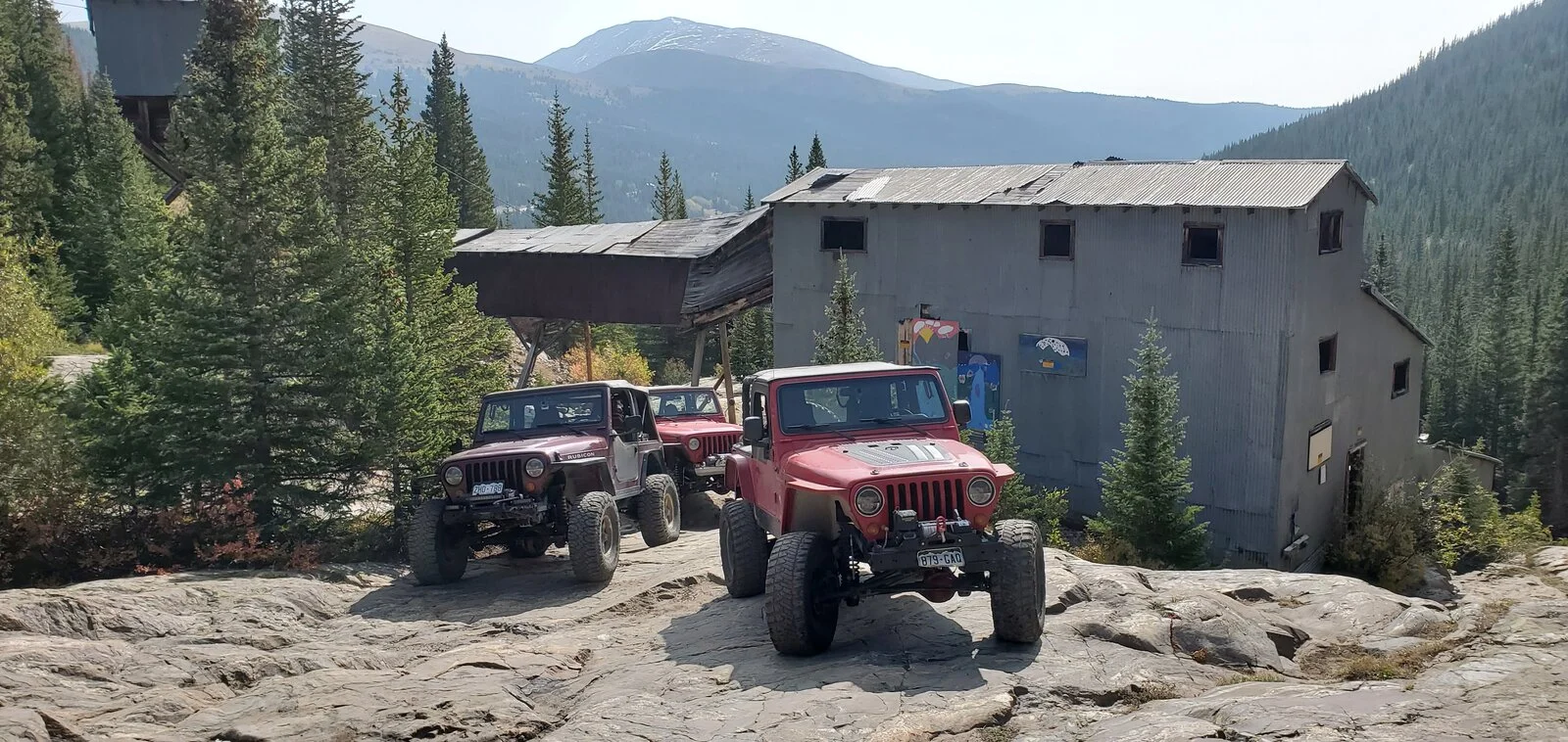

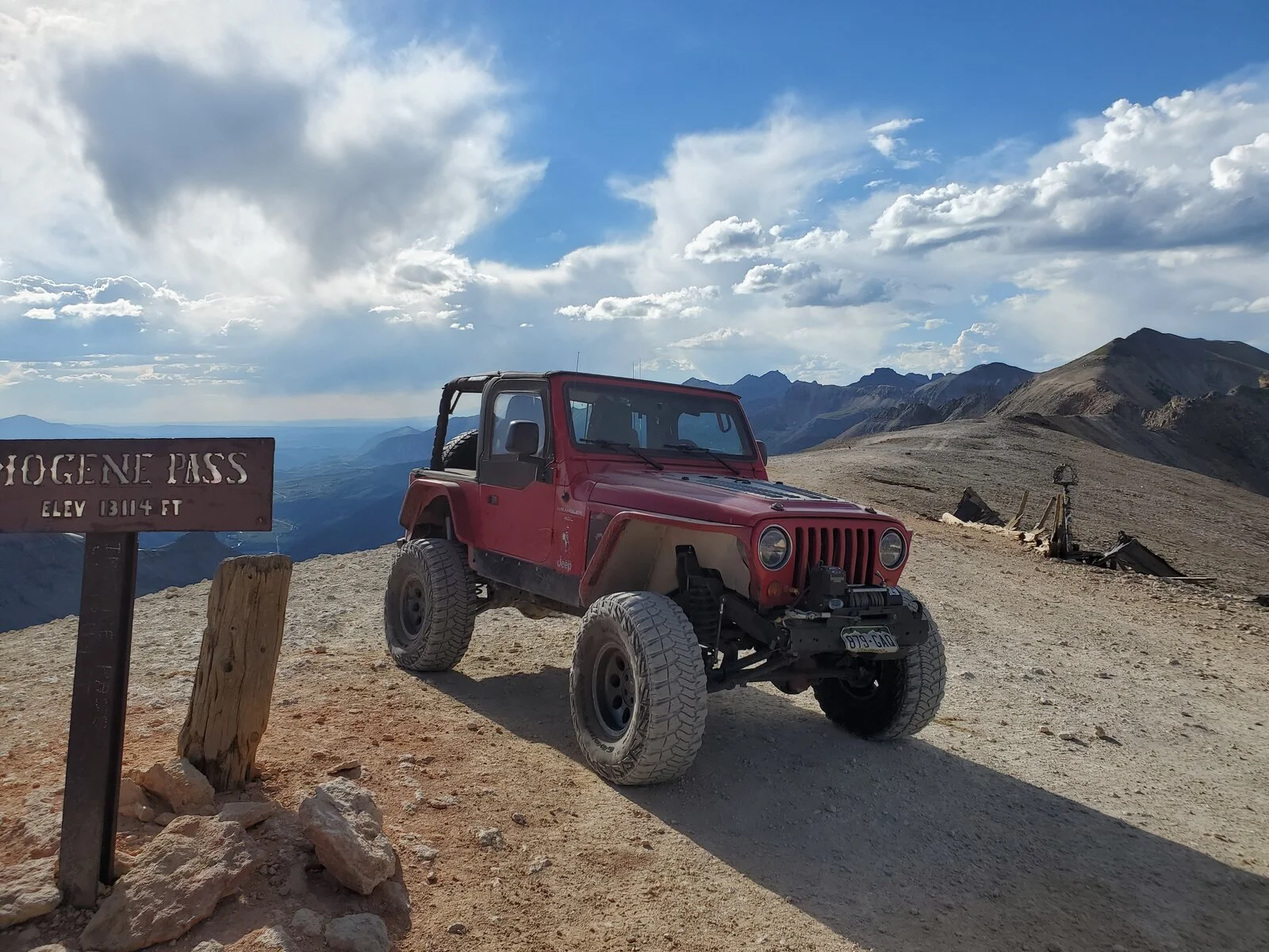

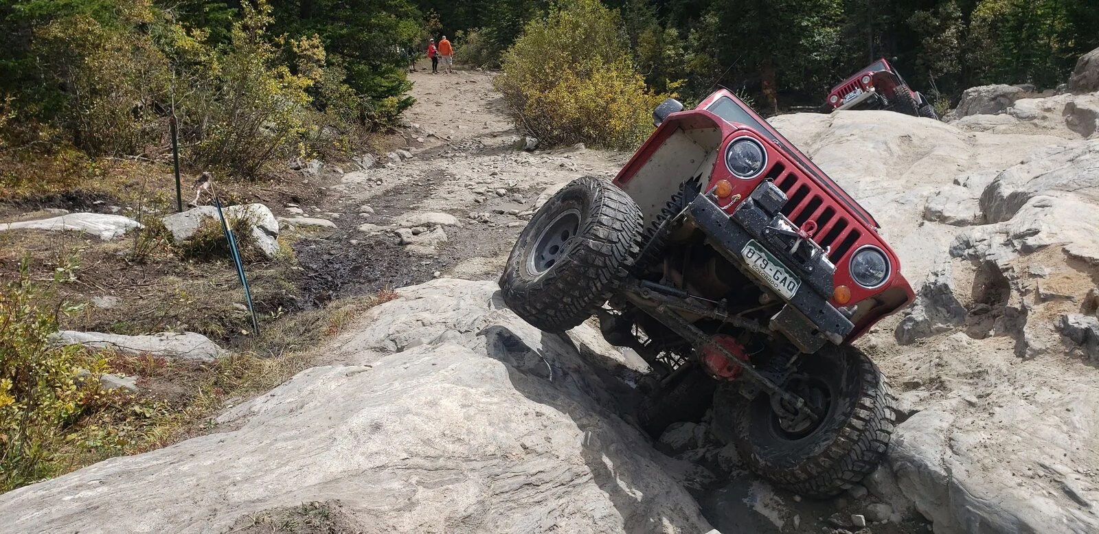

September was fun with Imogene, Black Bear, and Wheeler Lake

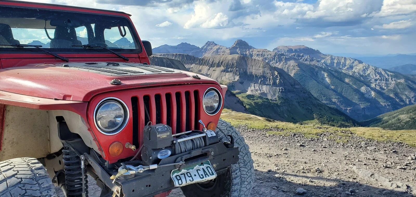

October with Engineer, Alpine Loop, Black Bear (again), and Spring Creek (again)
Love the pics, looks like you had a great year wheeling. My CB antenna is in the same place, I added the firestik spring mount after the trees kept trying to break that bitch off. not sure if yours gives you any issues there.
quick question about those wheels if you dont mind... do you have any issues with the backspacing and 35s? I plan to get those same wheels down the line
I am running their older version with 3.61" backspace. I do rub my control arms at full lock/stuff. The newer versions from what I understand are 3.75".
they are the Baja xtreme II correct? on quadratec they have 4.0" of backspacing and I was curious if they rub. And are you running 12.5s or wider? Because I plan to run those with 35/12.5/15 cooper STT Pro
Baja extremes, yes. Though mine are not the II. And you're correct, the newer versions are on qtec are 4", not 3.75 (my bad). On a 12.5" MTR I kiss the control arms

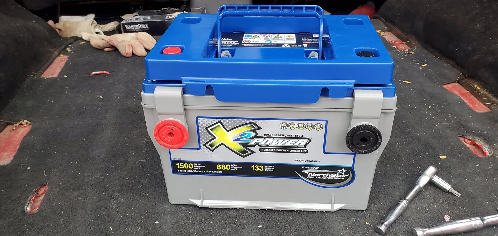

Jinxed myself! Havent driven the jeep since Tuesday and it barely started this morning. The superstart agm appears to have lasted only 5 years. Just picked up a Northstar. Leaving the store and I can tell the battery is really starting to struggle when cranking.
Parking outside definitely degrades them quicker too, batteries don’t like cold much. For the couple years we lived in the Midwest our batteries really suffered.
