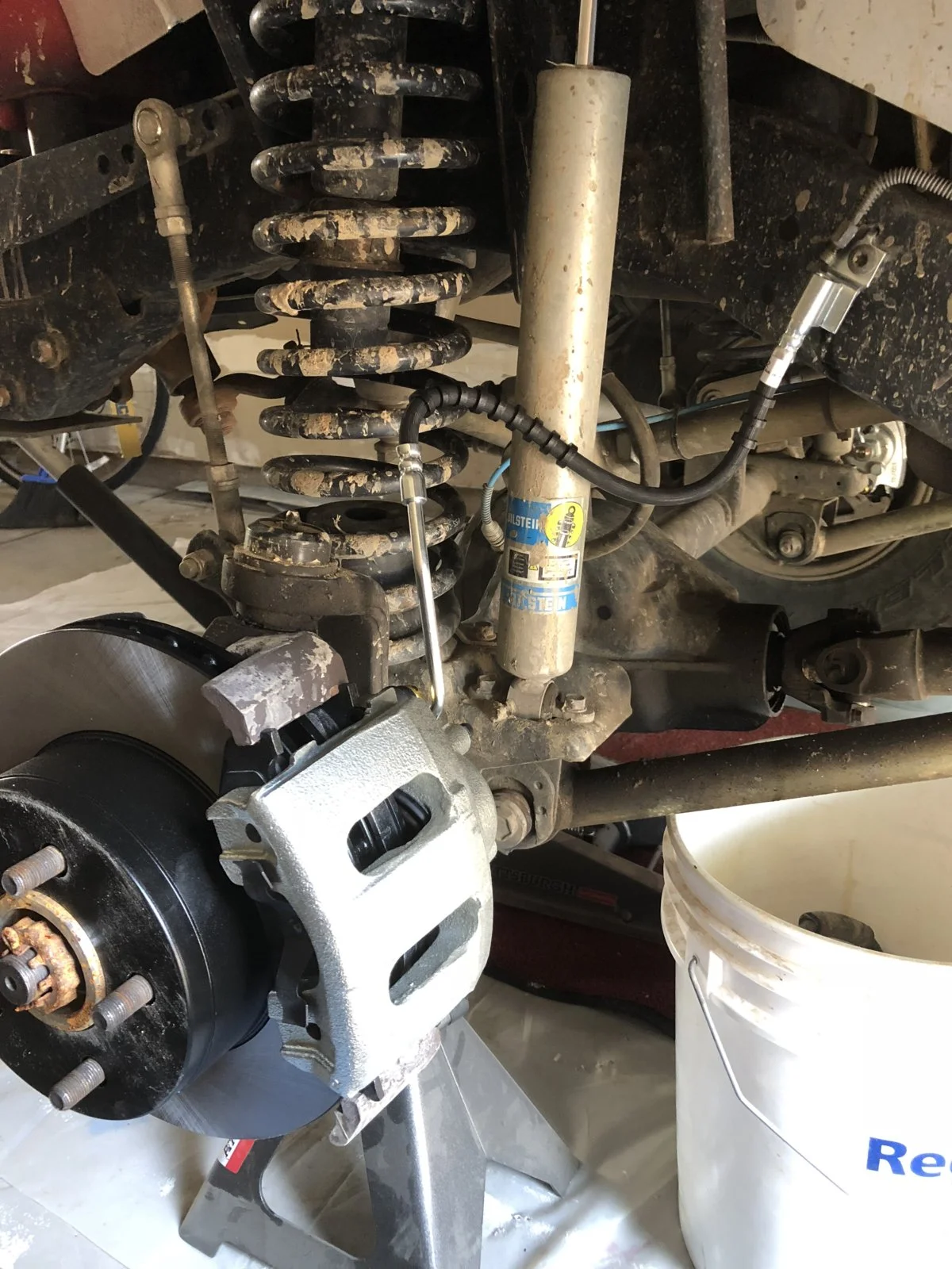

Some new, functional goodies coming next week. I went with YJ brake lines, vacuum pump, and copper washers to go along with the new BMB brakes.
Reactions: JMT
Finally got my BMB brakes on along with YJ brake lines. Just got done doing the initial break in test. After the cool down and on about the eighth 40mph moderately agressive stop I started to really feel them grab. I'll do 5 more stops in the morning on my way to work.

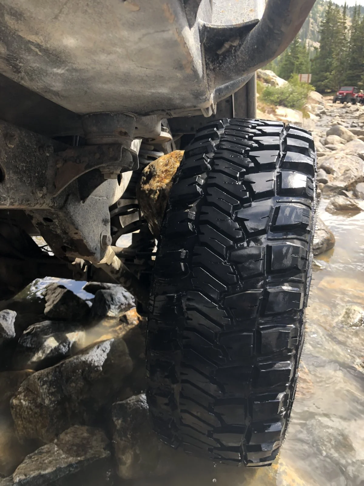

A trip to Holy Cross yesterday with a small group. Its an old mining town at 14k ft. They state the trail is a 7-9 out of 10. This is the hardest trail I have done but along with that it may be my new favorite. Great scenery, very fun obstacles, and historic to boot. We came across two fellows who, the night before, sheered the ears off his stock Dana 30 axle shaft and took out ball joints too. They were in a tough position but manged to make it up yesterday and repair it all. I came down hard on a rock and broke the bottom half of my fan shroud, we think the dynamic load may have caused the engine to move within its bushings which caused the fan to break it apart. My copilot was jjvw, he led me over Mosquito pass on the way home which was a great way to end the day.

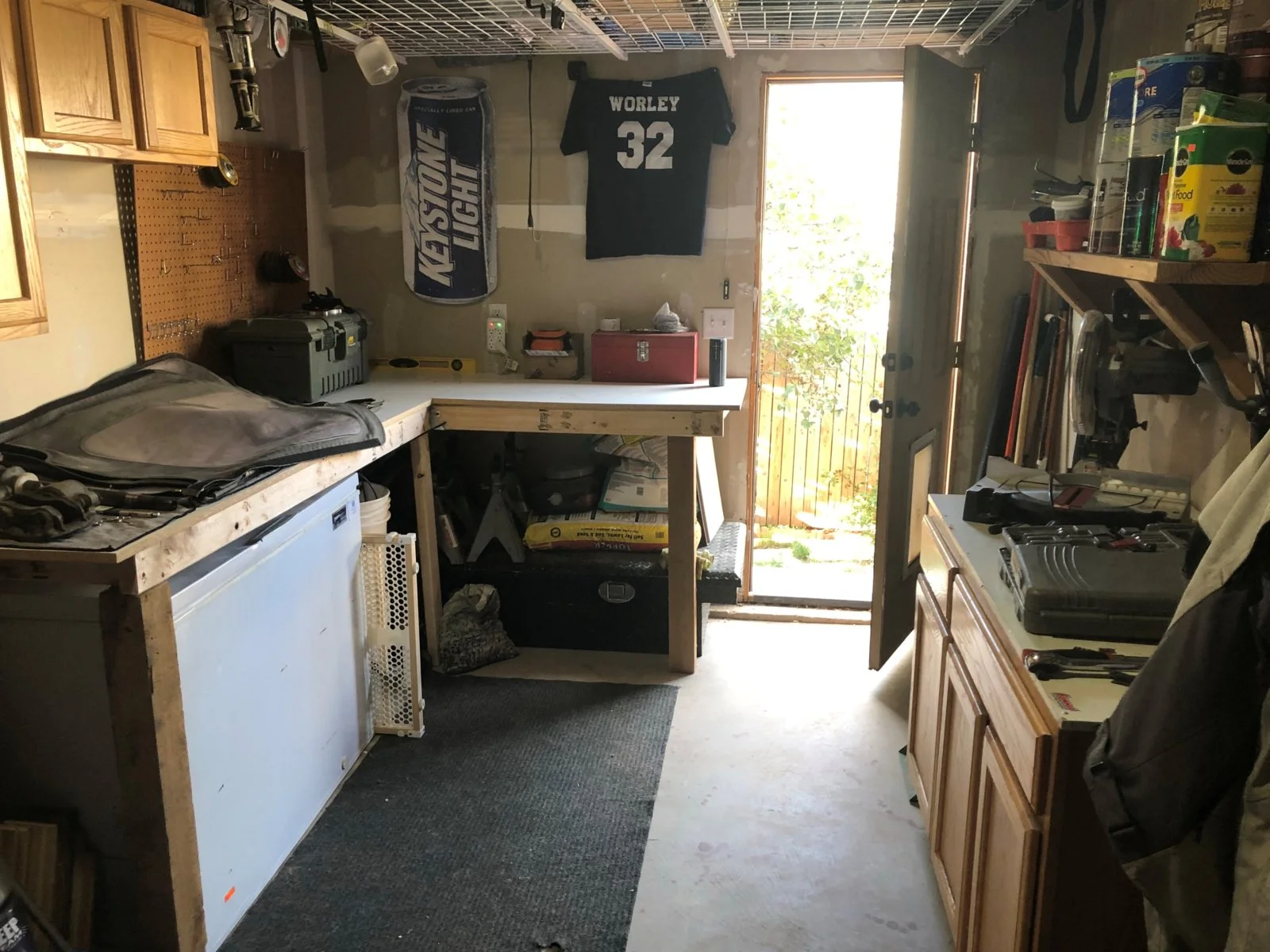

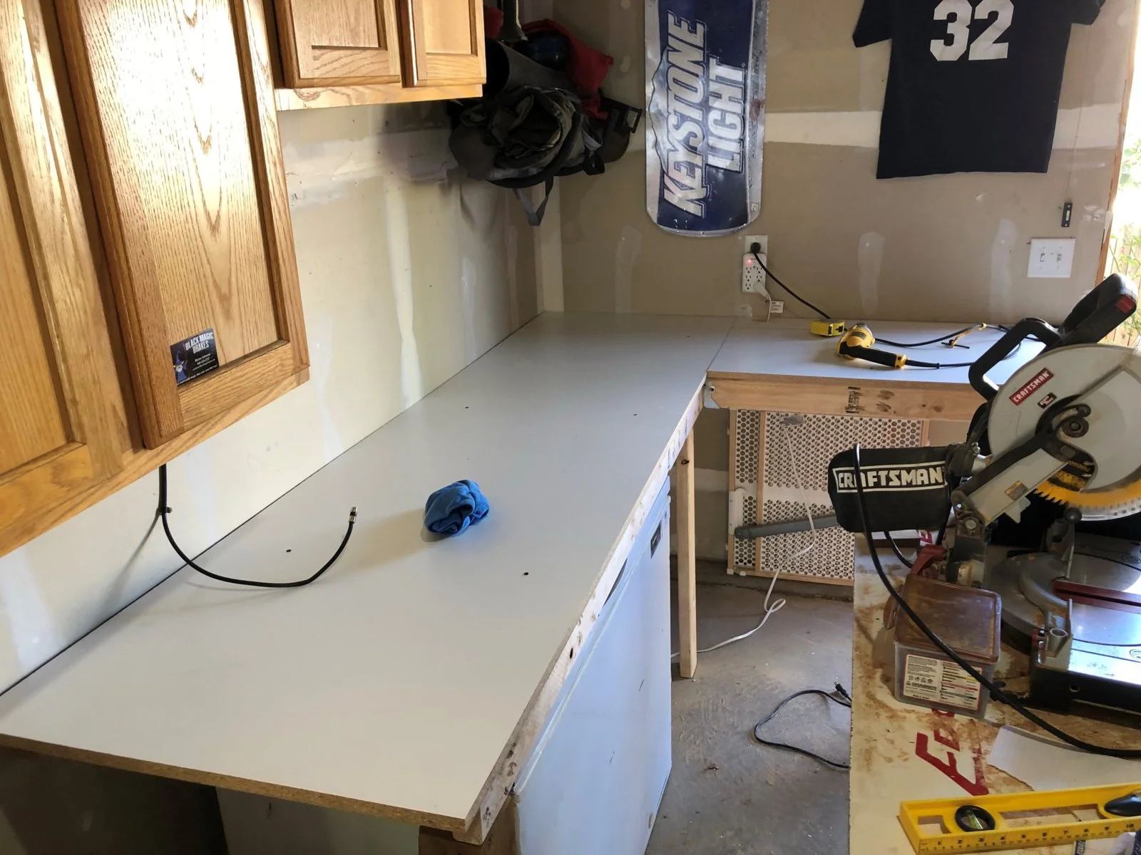

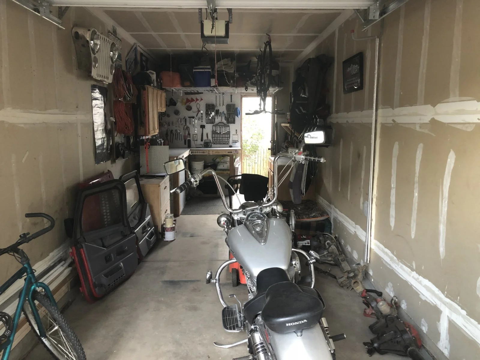

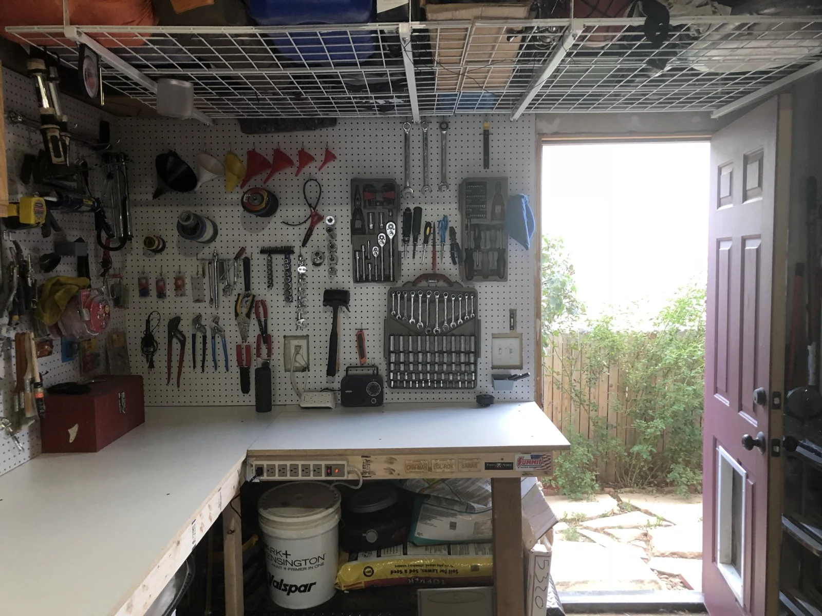

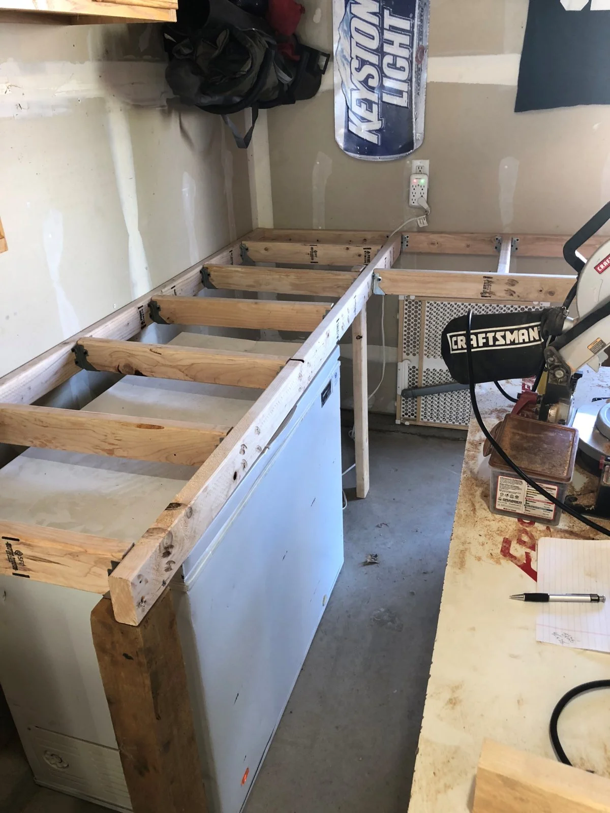

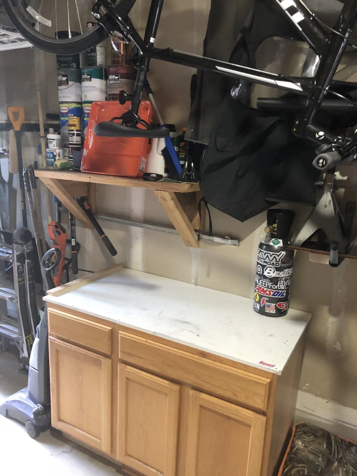

Not jeep related, but I was picking up the garage Friday evening and thought, "I need more space". I ended up pricing some lumber and figured the cost for an L-shaped counter top to be roughly $120. 9' on one wall, close to 6' on the short side, and 2' deep. I ended up spending $87 dollars and wound up with the long side being 8ft. Only because I thought adding a section of 1' would not be strong enough. Counter top is white melamine that I got for $15 due to one side being damaged. Support braces are mounted using face mount joist hangers. Next weekend I am picking up white pegboard (to brighten things up) to go above the entire bench, it will fit below the hung cabinets on the left, step up to the higher over head ones, and then cover the entire wall where my jersey and keystone can is. I also plan to build a low-profile roller for my deep freezer, this way I can keep it underneath the bench to save space. Hopefully this winter I can get a vehicle parked in here.
A little more progress. 1/4" white pegboard and pegs with tools mounted. Going to hang the leftover board tomorrow and place my extension cords on it, right now they are hung up by these 14" hooks and portrud quite a bit, I'm going to eliminate that!
I believe I am done...

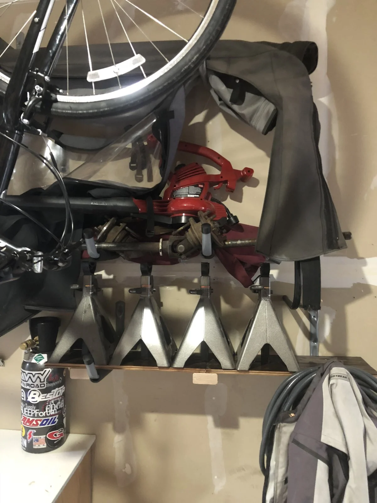

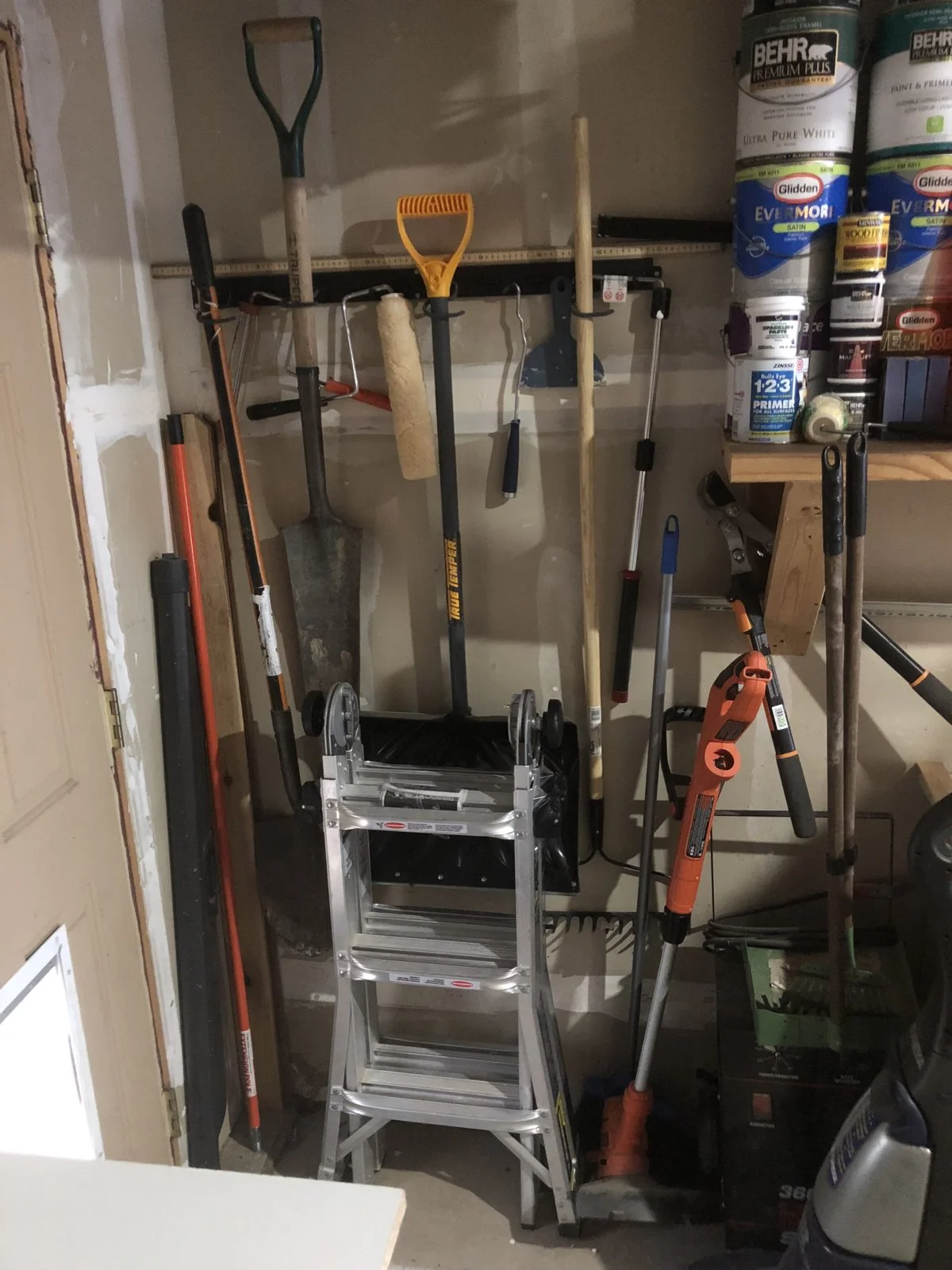

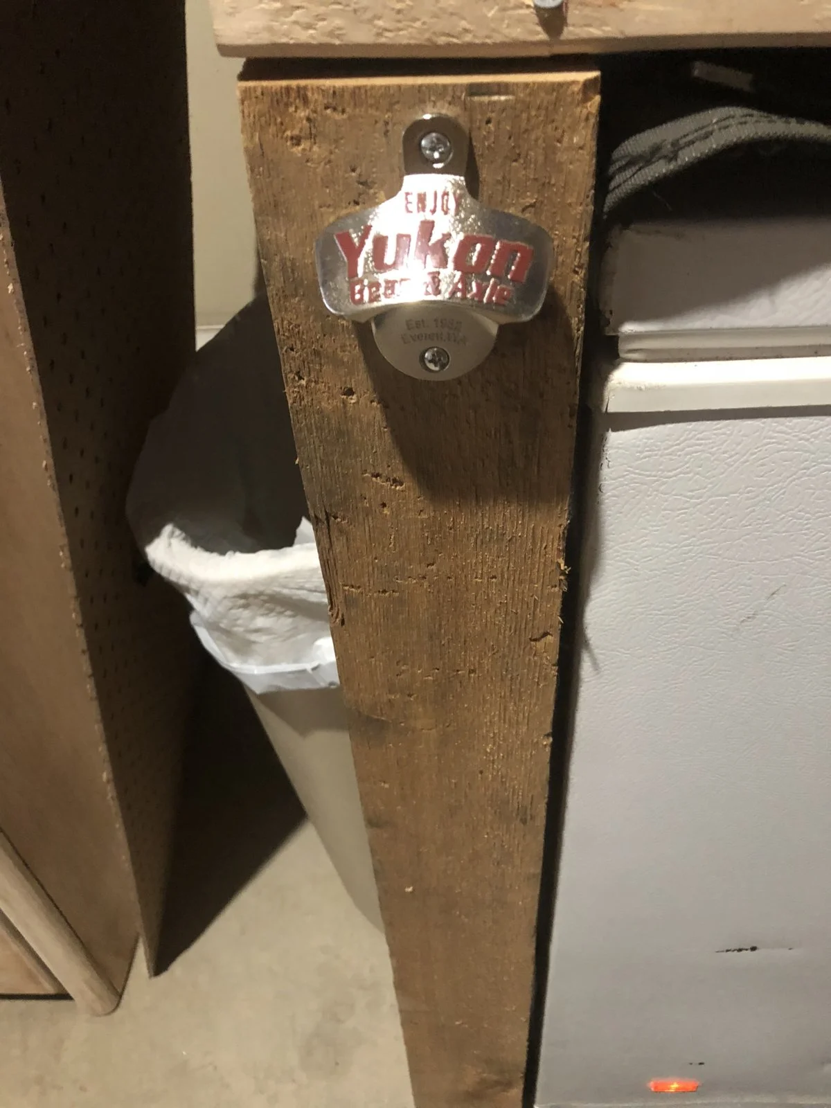

So far I am very happy with how it turned out. I have everything put away after two years of living here. I may swap the two floor cabinets for the freezer underneath the bench, I'm struggling finding a roller that will work with the freezer, it would be nice to have the small work area that I have available but time will tell. Made the shelving for my jackstands out of old wood floor slabs and the 14" hooks that were were mounted to the wall. And I can now open and close the back door easily since the shovels and paint brushes are now mounted to the wall. I can easily get my wife's Jetta or my Jeep in here this winter
