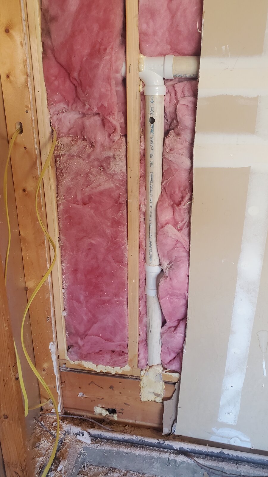

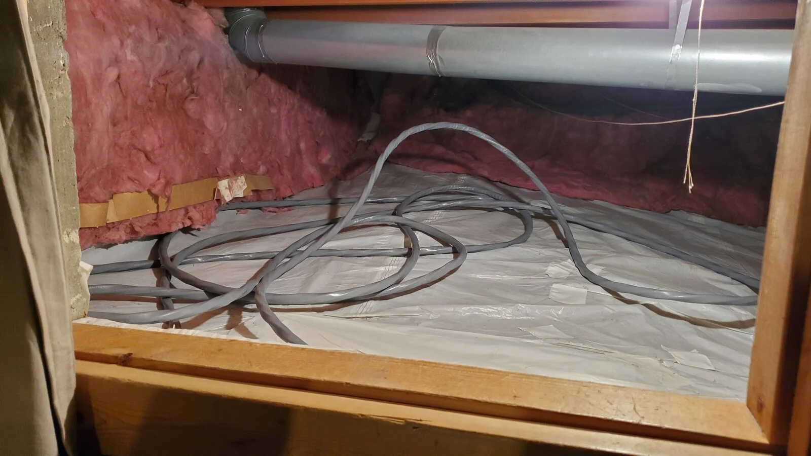

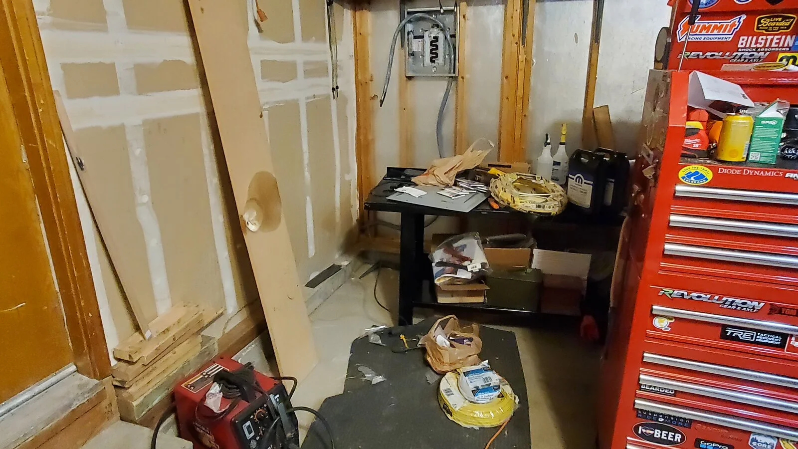

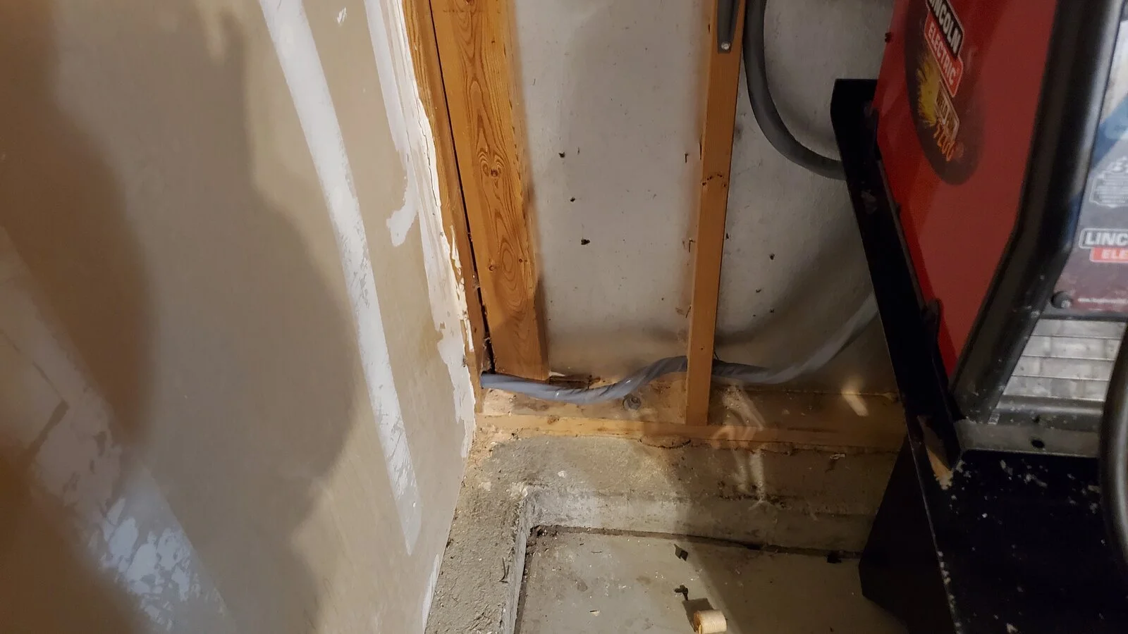

Fishing SER wire by yourself is no fun. I went thru the corner stud and down into the crawl space, its fished up to the point where I need to exit the crawlspace and back up to the main panel.
Its piled here for now until I can get it all stapled. With the routing I plan on doing, Ill likely end up using about 60' of the 100' I bought. I guess its better to have to much than not enough. It runs off into the abyss where it eventually meets the garage wall

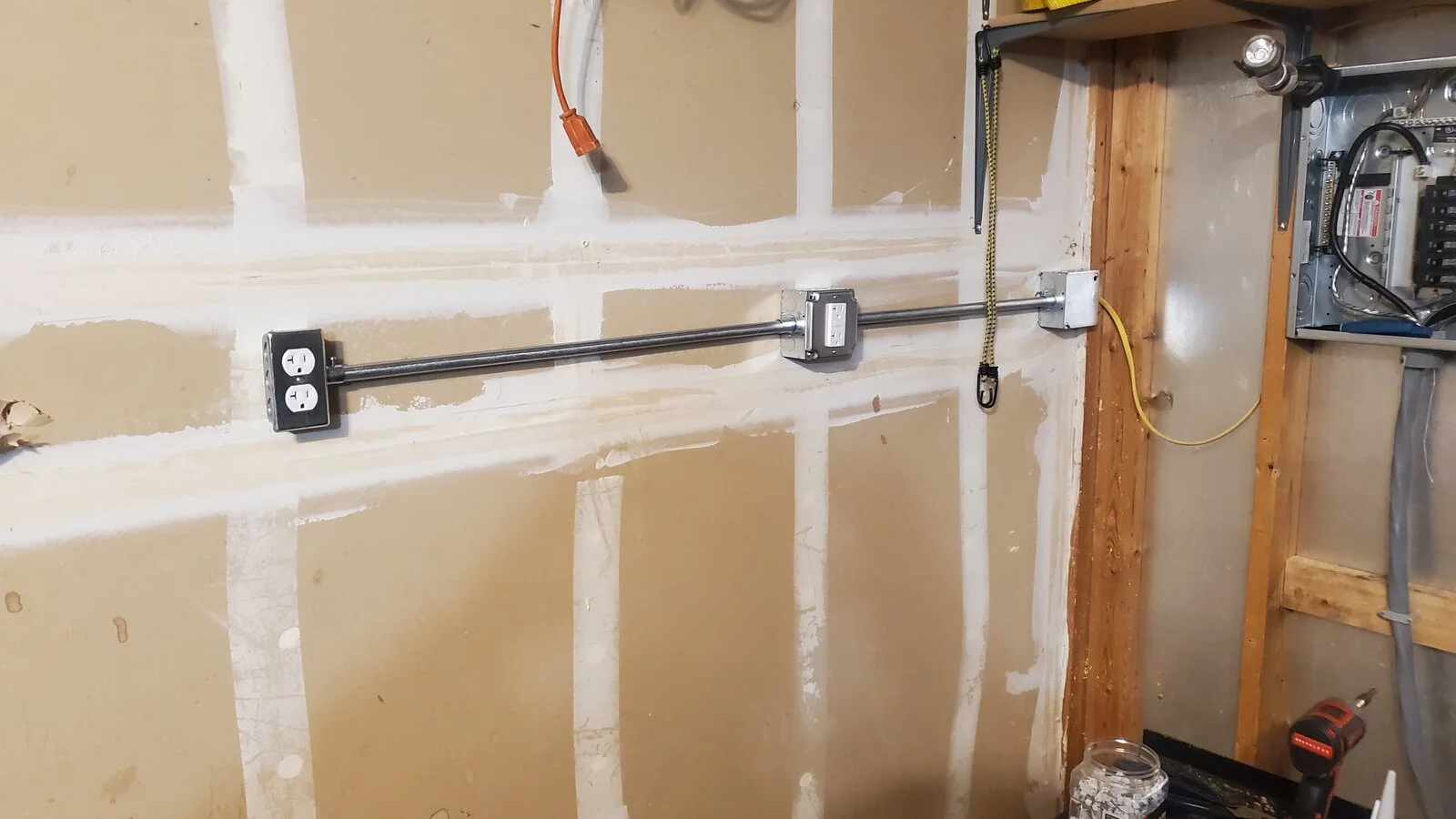

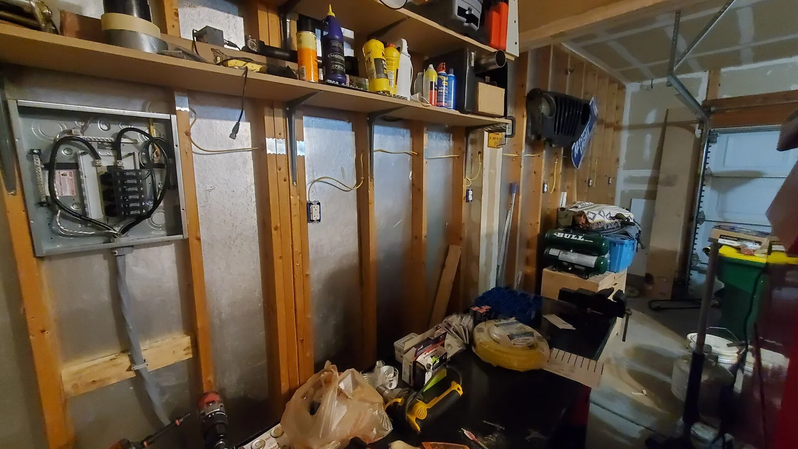

Subpanel will be mounted here. Its clear 30" on either side and about 6' in height. Still need to buy my staples to mount it to the floor joints. Next weekend my goal is to get everything else done; outlet boxes, light switch box, 12/2 wire ran for the outlets and 14/2 for the lighting, as well as conduit for the overhead lights.

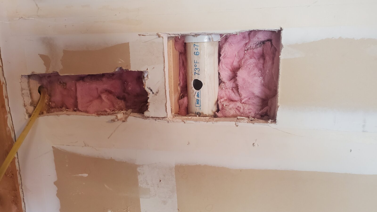

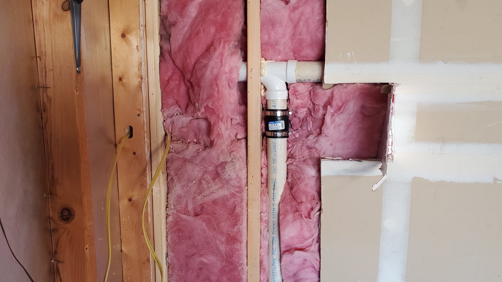

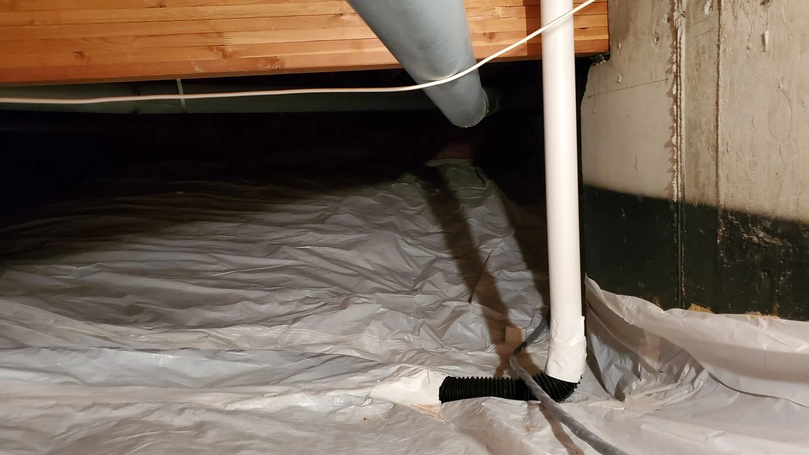

Also....double check what's behind your walls 🤦‍♂️

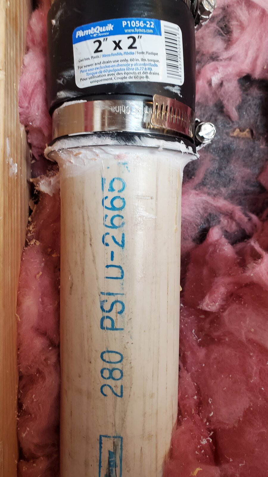

This was a big unanticipated screw up. I drilled thru a vent pipe while placing a junction box. I spoke with some of the guys and they recommended a fernco fitting with silicone. So..that's what I did. I'll watch this closely over the few weeks to make sure sewer gas isn't entering the garage.

Damn it! that's the worst. I hope it seals up for you. At least it was a vent line and not a pressure line or electrical!

No kidding! Really pissed me off. I ran everything in the house to make sure it wasn't a drain pipe, but no water ever came down

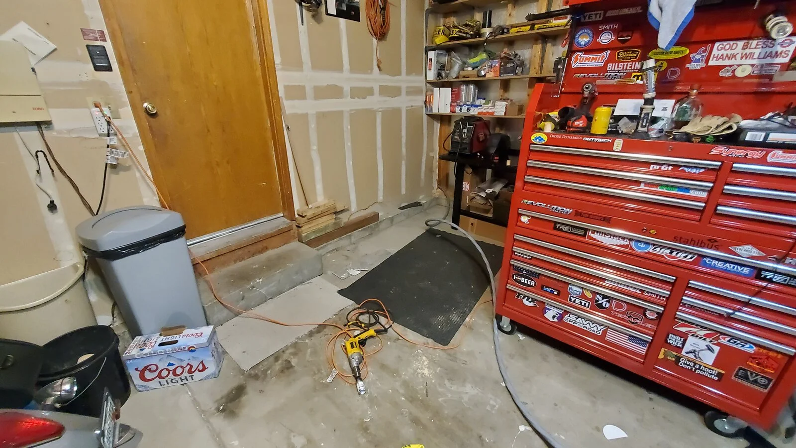

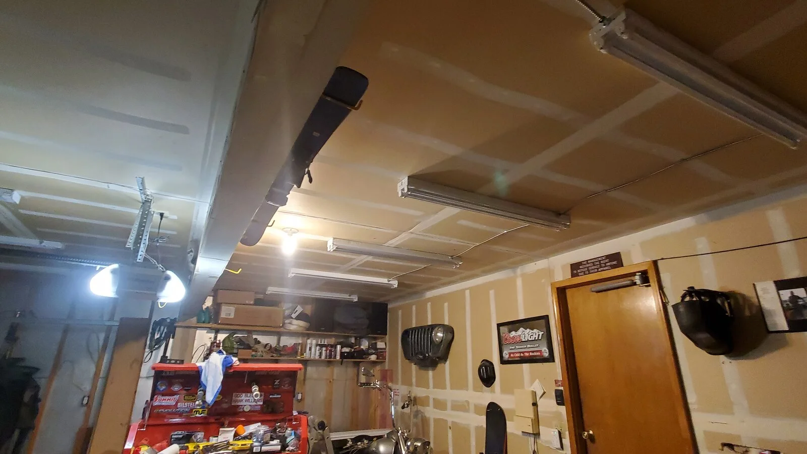

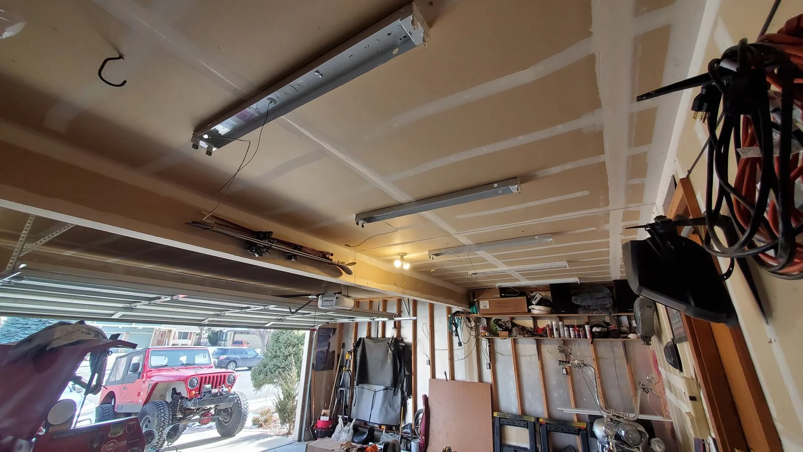

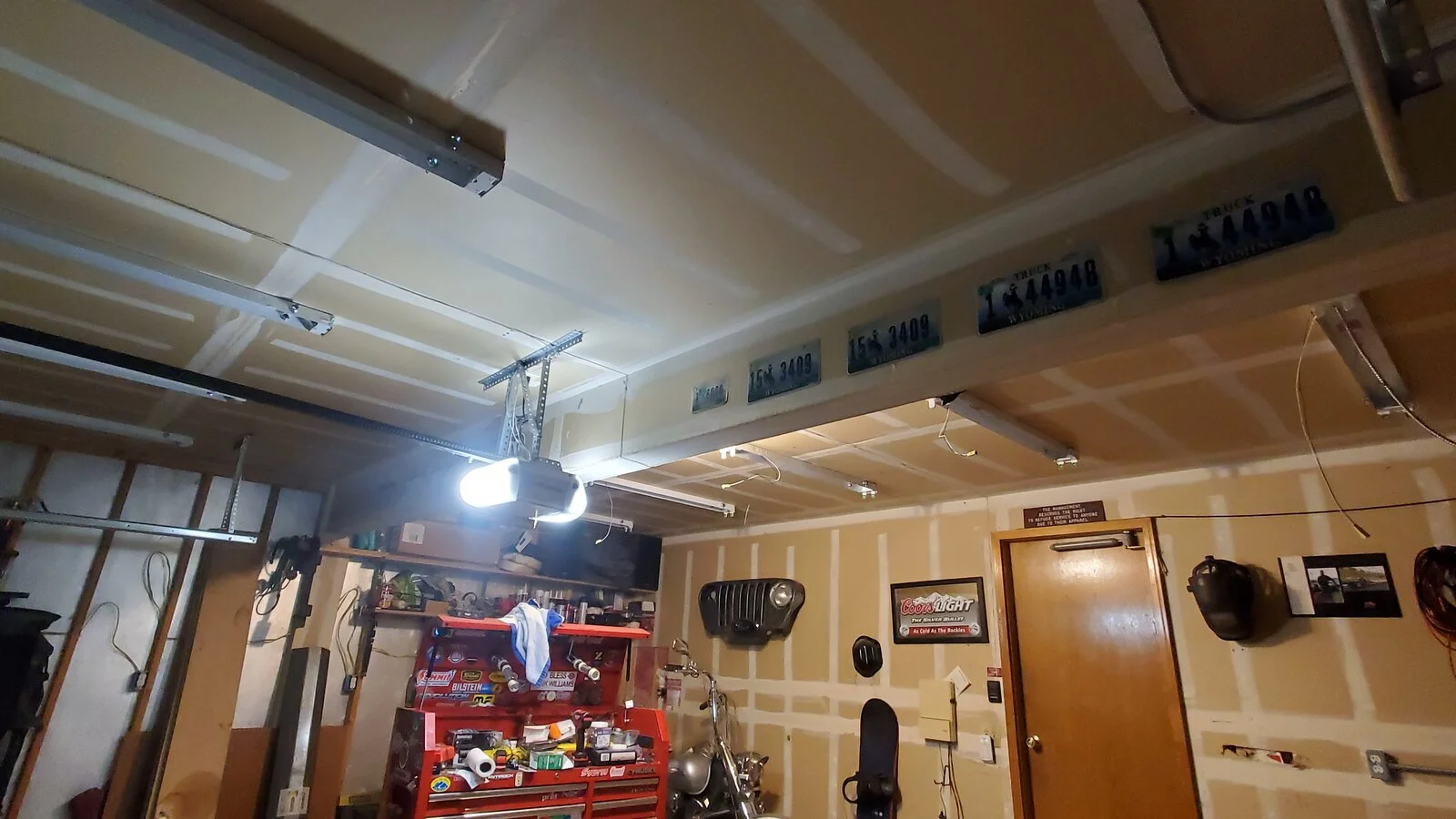

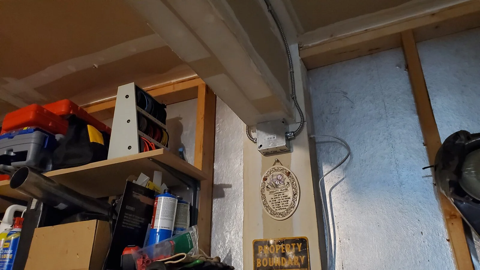

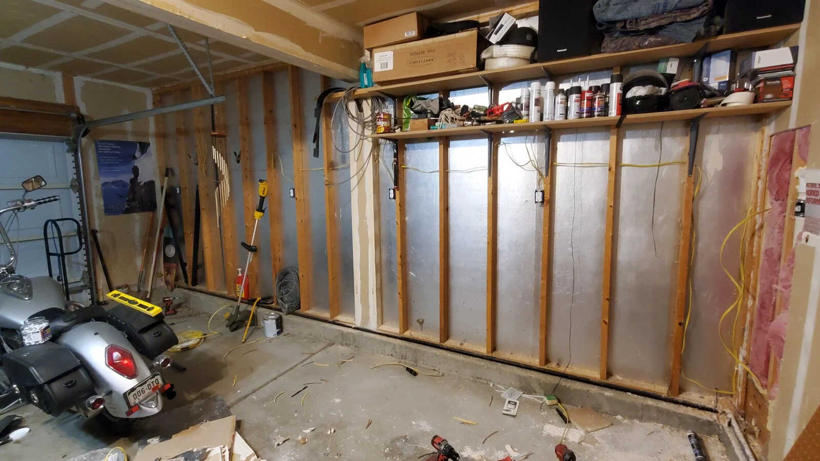

Another long day. All the lights are mounted. Half of them are wired. I think one more good day and I could get the remaining lights tied in, runs thru the basement stapled, and the subpanel wired to the main panel. I need to repair the west wall before I can wire my last circuit (3 outlets).
