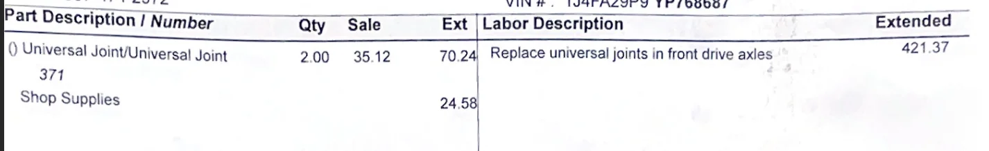

A shop quoted me on the ujoints. I wasn't there to ask which ujoints need to be replaced. I would like to take it on myself so I wanted to see if they mean the ujoints on the drive axle (front and rear) or they meant the ujoint on the front wheels (right and left)?

Based on that quote it would appear that is for replacing both front axle ujoints.
It says axles. See if you can shake them to check for play.
