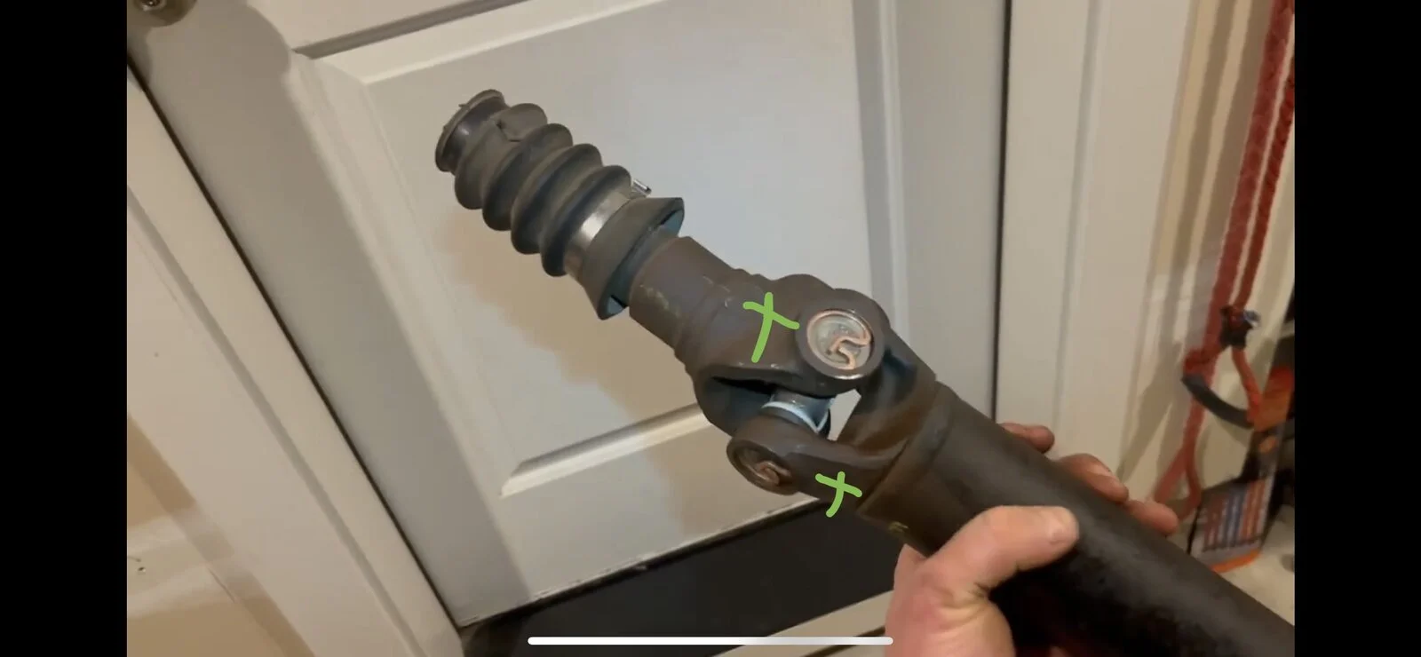

Alright, this was my first time ever replacing u-joints so take it easy on me. Stock rear driveshaft. Does this transfer case side u-joint look too tight? It isn’t difficult to move at all. It just feels snug. Ignore the mess…wait for the end of video.
I used the thinnest clips that were provided with these Spicer 5-1310x. The rear driveshaft is now back in the Jeep and my driveline vibrations are gone. So that’s a win.

You can give the yoke a good whack with a hammer on the meaty area to relieve any binding. It's really common if you pressed the cups in with a press or vise but I've still needed to do it on occasion when I've used the hammer and socket method.

Ok. Maybe hit it on these two areas?
I won’t know if it made any difference unless I remove the driveshaft first. Might be a good idea to remove it before whacking it anyway? On that note, are y’all replacing or reusing the straps and 8mm bolts?

Yeah I wouldn't do it installed.
I reuse the straps and bolts if they appear ok. I do put a drop of blue thread locker on each bolt.

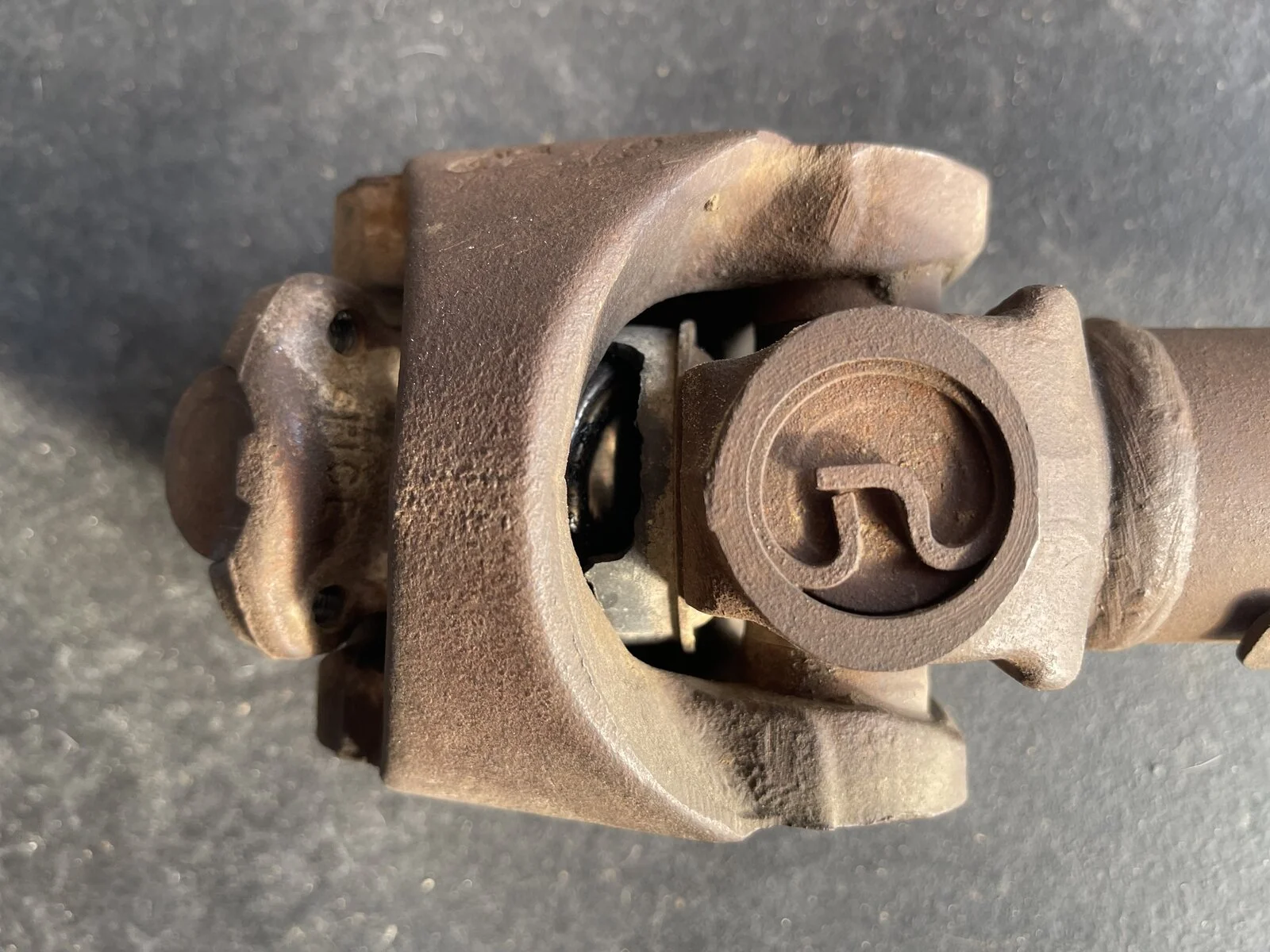

Here’s what the old one looks like.
I’m hoping this rebuild fixes the front driveline vibes. There are zero highway vibes with the front DS removed, but with it installed my seat feels like a massage chair.
