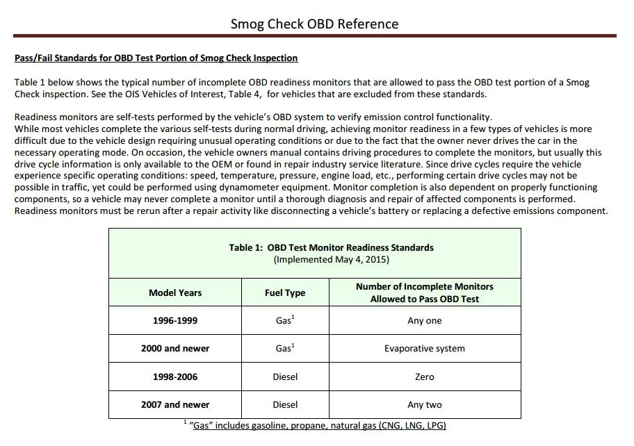

Well, I did a little research on the readiness and the rule of having an incomplete / not ready monitor. Here is the official word from BAR in the Smog Check OBD Reference. This information comes from the most current reference guide dates 3/11/2016. It is a 204 page PDF document. https://www.bar.ca.gov/pdf/Smog_Check_OBD_Reference_Guide.pdf
Looks like I need to print that and have a chat with my smog guy or at least explain to him that TJ's started in 97.
