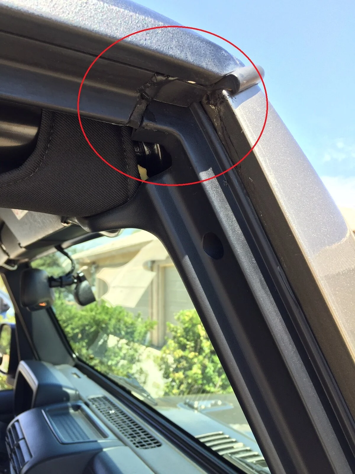

I'd say post some pics of where it is leaking. I have the factory Hard Top on my LJ and I get just the smallest amount of water on the inside of the passenger window when I wash the Jeep and that is hosing it off from all angles from 5' away. We drove through a pretty good rainstorm in Colorado and I don't recall getting much/any water inside the Jeep.
We do have some wind noise on the passenger side. I think it is from the transition from the windshield to the top. I installed some 1/4" weather stripping and it is better, but not completely gone.
My 06 TJ hard top leaks just slightly on the passenger side as well and also only when a hose or pressure washer is on it but doesn't leak during even heavy rain.
Where is the water actually puddling up inside the Jeep? Mine was doing it on the passengers side floor. As it turns out it was the cowl leaking water because the drains where clogged up.
I have a rally top as well; and my only leak is where the others have commented. I stuffed some foam there and only get leaks with direct, high pressure sprays. Granted it’s not been on in almost 2 years...
