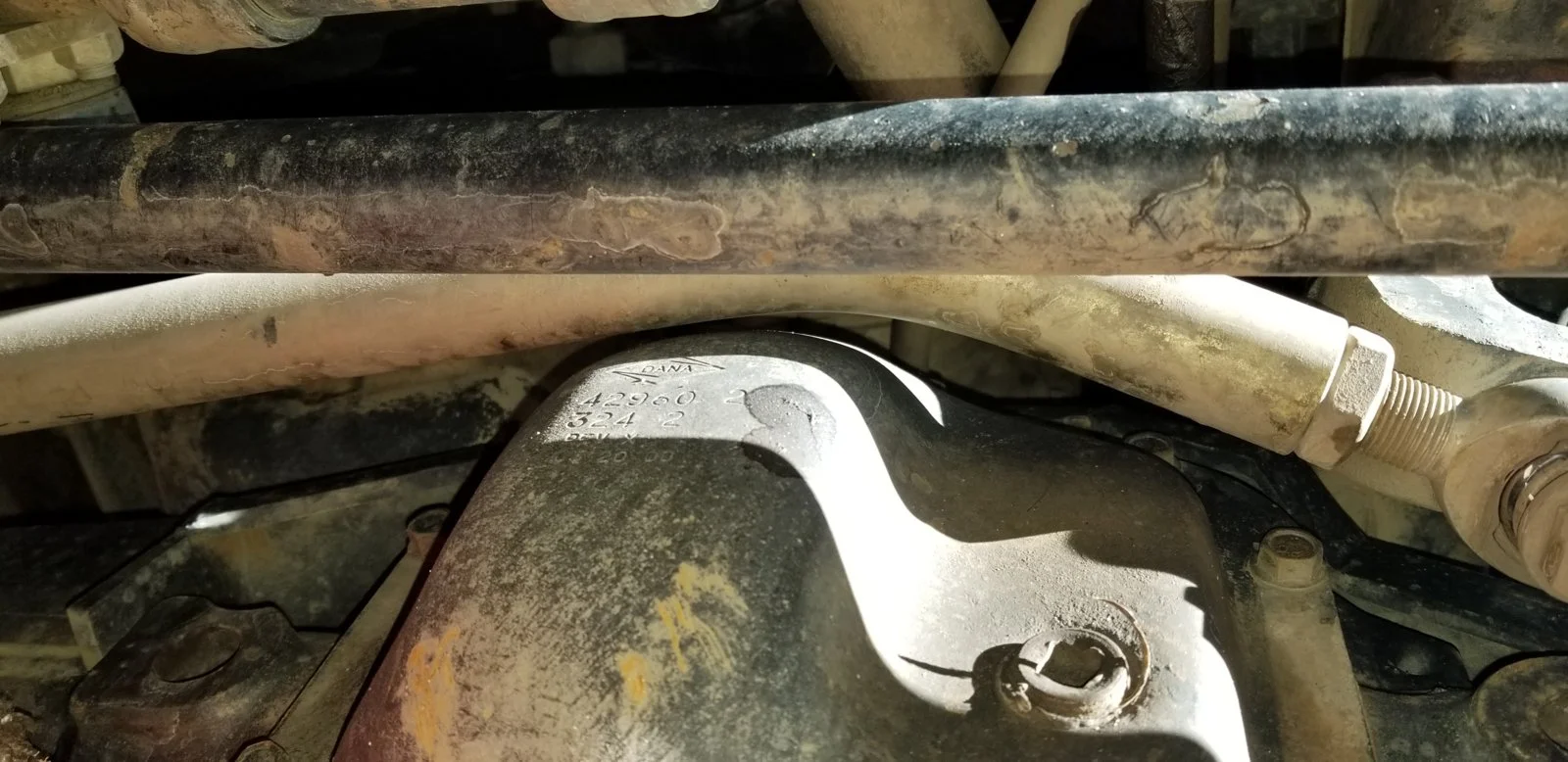

My current setup 3.5” SL 1.5” BL. Hi line fenders. 35” tires.
I currently have 4” uptravel in the front. That leaves 5.5” down. It has been this way for about a year. I do use all 4” on the road, although I never feel any jarring from bottoming out. My front springs unloaded are 20” and unseat 2” before shocks are fully extended.
I have 3-1/4” BS for shocks and track bar/diff clearance.
If I shorten my front arms more to clear TB and drop my BS to 2” my tires hit the rear fender well.
I could do something custom with track bar and or mount, then extend my shock mounts. Getting me to a 2” bump stop.
I reference 2” BS as a goal, as it seems less than that we start to see lots of steering related interference?
So is all the fab work worth 1” more of uptravel?
Or should I just install a longer spring that will not unseat at full droop and live with 4” of uptravel?

Stock diff cover. When I check tire clearance with 2” bumps the tire is very close to hitting rear fender. With new tires I believe it would rub. Especially if I move axle back any more.

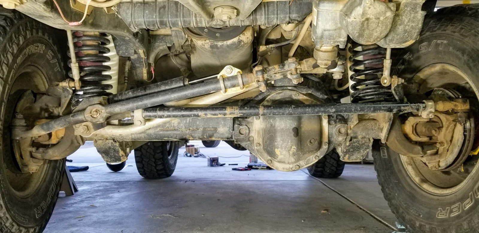

Sounds like an axle position problem.
This is mine with the MC track bar and flipped Currie steering. 1.5" bump stop extension. Everything fits at full bump.

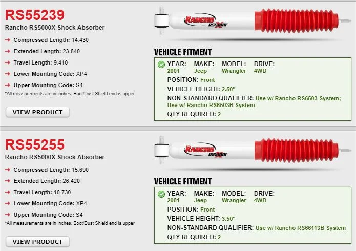

Easiest way to gain more uptravel would be to swap out your shocks. Here is what you have currently
82282
Compressed length is 16.1.
82283
As you can see the RS55255 with a .5 smaller compressed length would allow you to have more down-travel / up then your current shocks. If you swapped to the RS55239 you would lose about 2 inches of down-travel (the amount you unseat at anyways) but gain almost 2 inches of up.
Just another way at looking at the issue....

Sounds like you have a fairly similar set up to me dana 44 front, 35s, mc trackbar, and highlines. I found with cycling my suspension my tires will hit the rear of the wheel while the tires are turned well before the top lip of the fender. My axle is also pushed back due to TB clearance.
Easiest way to gain more uptravel would be to swap out your shocks. Here is what you have currently View attachment 82282
My TB is the limiting factor on uptravel right now. If I move the axle back my tires will hit before I gain 1” on bs. The shocks are irrelevant in this case as mounts will have to be changed accordingly. The 5000x shock does offer more travel vs compressed than the 9000x.
