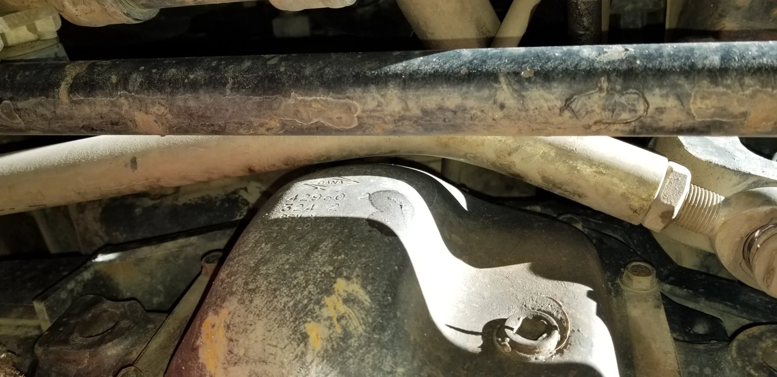

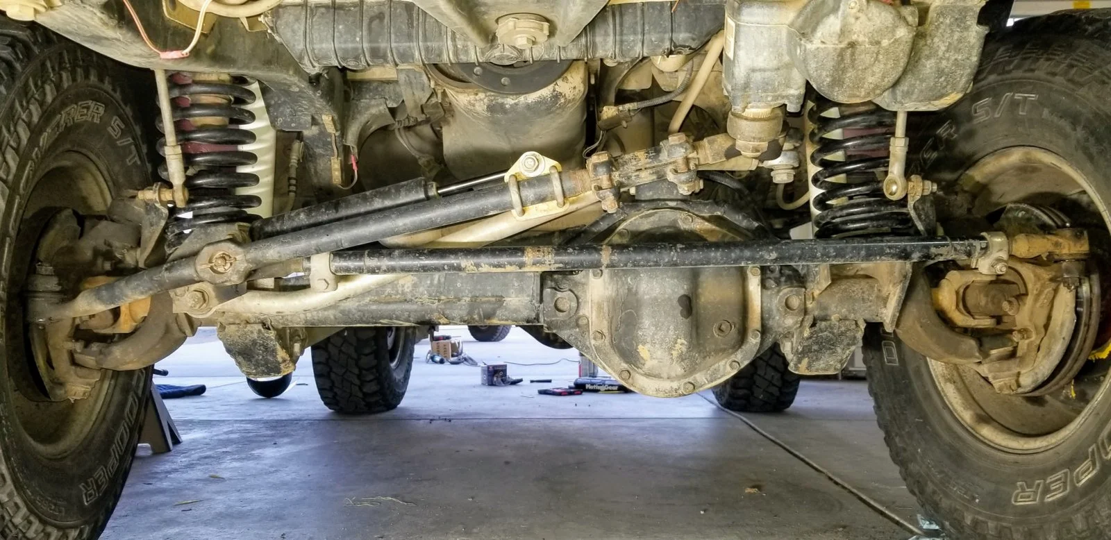

Sounds like an axle position problem.
This is mine with the MC track bar and flipped Currie steering. 1.5" bump stop extension. Everything fits at full bump.

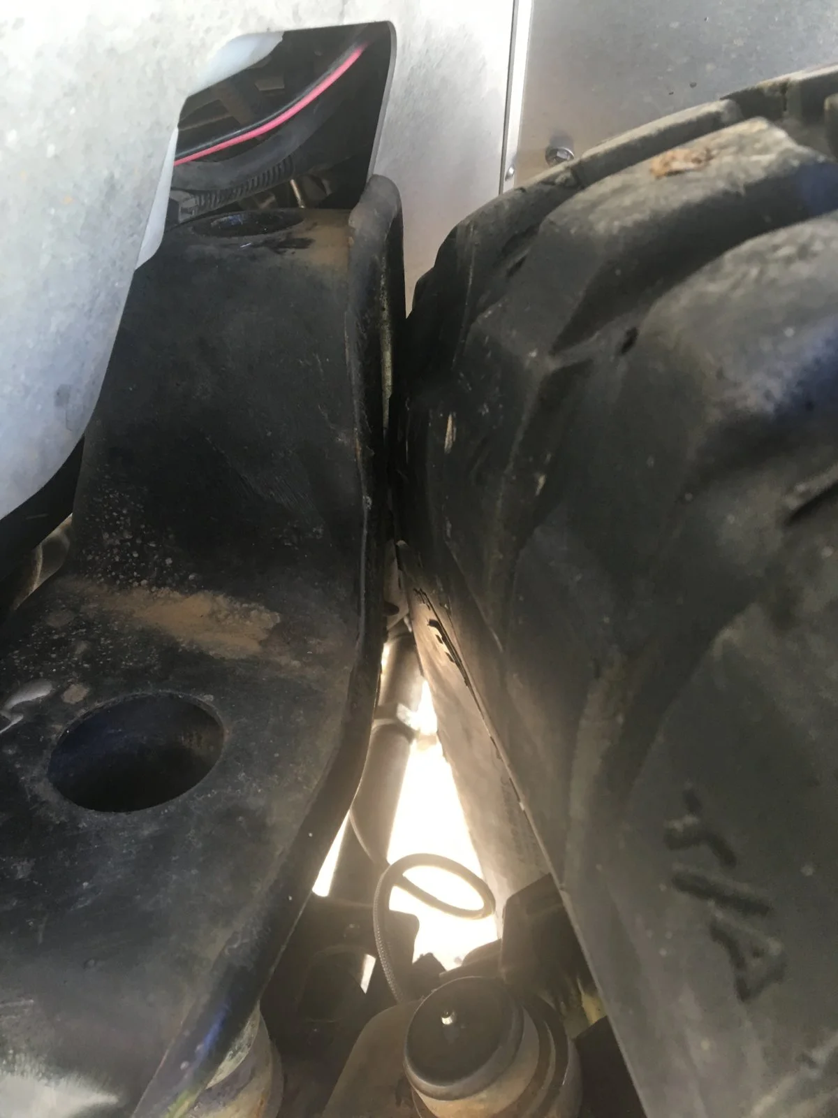

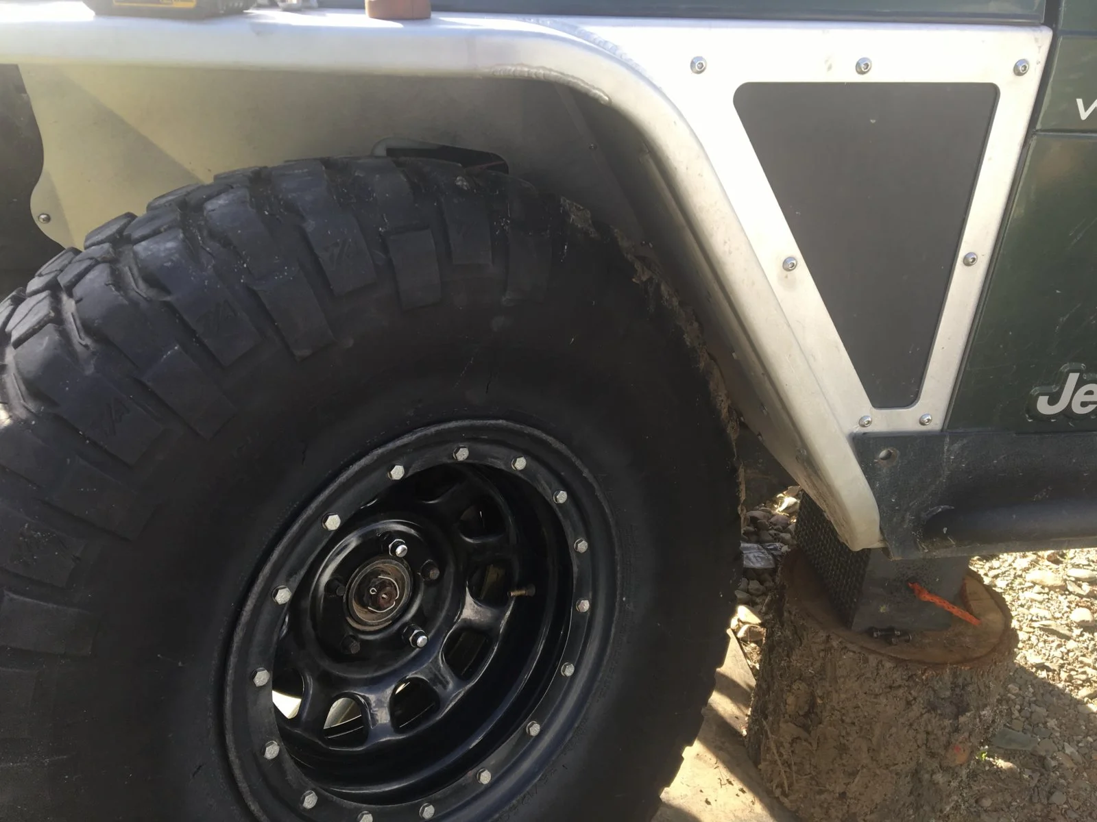

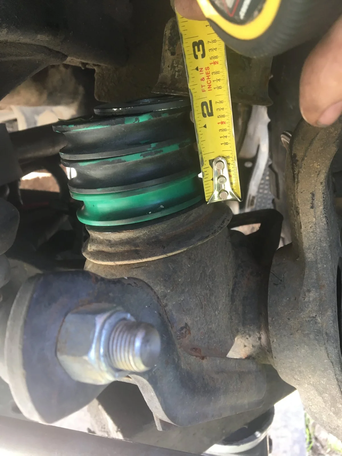

A1B6C209-F378-4C12-A006-DB41B4C917D5.jpegMr Blaine right now it is my track bar needs 3-1/4” of bs.
(Just checking to see if I can move my axle back)
When flexed with 2” BS I have 1/2” between my tire and rear fender when turned. Not much room to spare for a new tire and moving the axle back.
What do we do about tire rub on shock mount?
Yes this is with proper droop on opposite side. 94920422-97E1-4F7F-A110-157C08C6D9C6.jpegFA553884-E47C-40E2-A271-DBE897B5F8C1.jpeg
