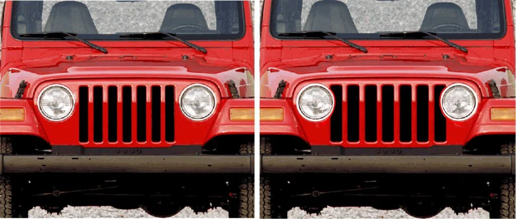

The JL grille design invokes the old CJ grille designs in that the headlights intrude into the outer slots. The JL doesn't have turn signals in the grille, and maybe for that reason it actually reminds me more of the TJ grille than the CJ grille. But the TJ's headlights don't intersect the outer slots.

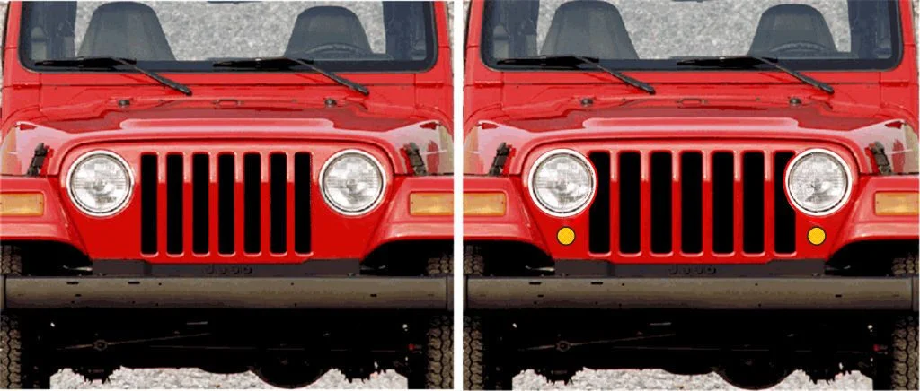

Wondering what this might look like on the TJ, I drew a concept image to compare to the factory TJ grille.
Going a step further, what if turn signals were mounted in this grille just like the CJ?

I definitely like the look of the bottom right picture. Of course it would look even better minus the stock rectangular fender turn signal assemblies.
Reactions: astjp2
Completely agree, I just didn't take the time to update the concept image to remove the factory turn signals.

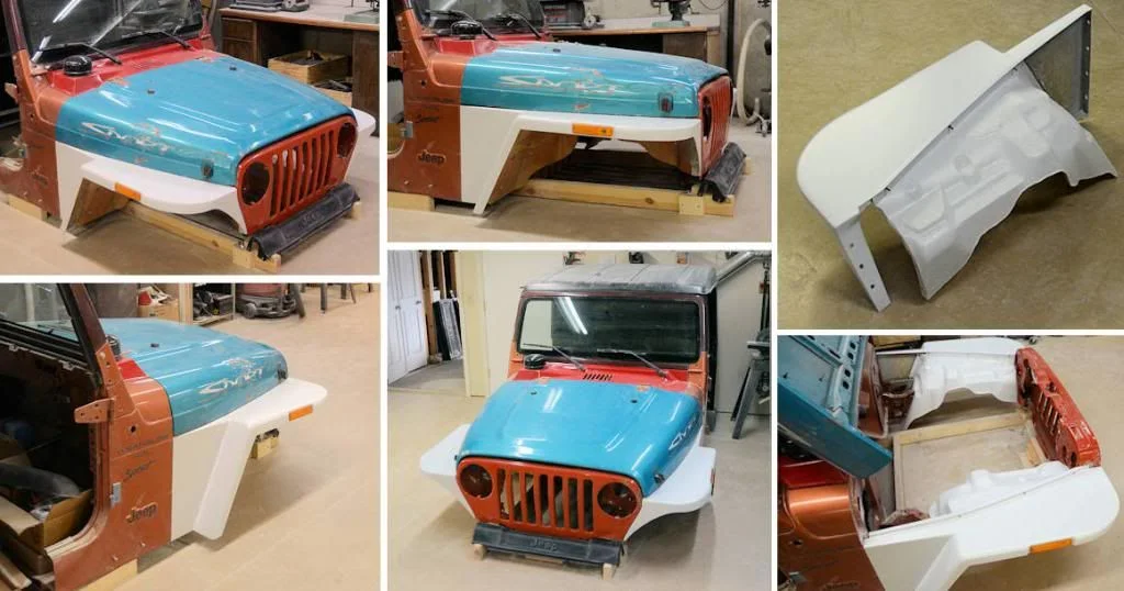

As part of my CJ Grille Kit for the TJ project, I made molds for fenders without turn signals, so these fenders would be perfect for use with the new grille with turn signals in it.

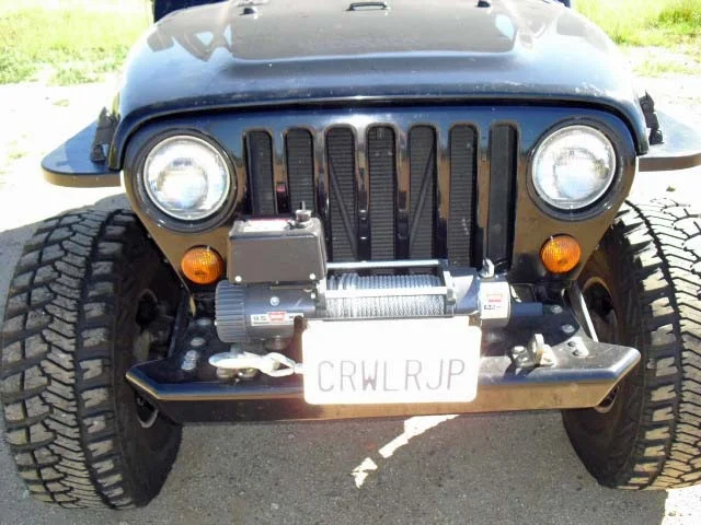

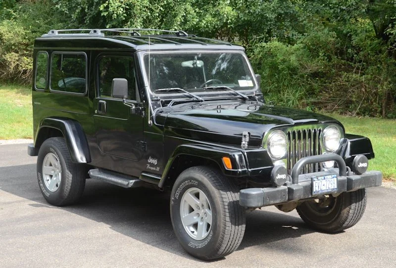

I am pretty sure that I've seen a TJ with flat fenders and turn signals on the grill. It does look good.

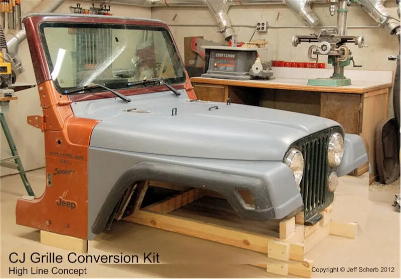

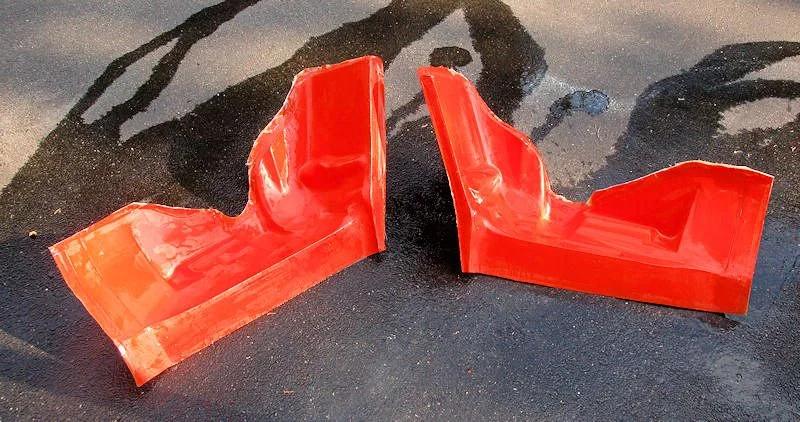

When I made the molds for the inner fenders I added an extra high margin at the top so that the outer fenders could be made in a highline version and still mate with the inner fenders properly. These are the inner fender molds, they're sitting upside down but you can see there's a taller flange on the top (the bottom in this photo).
This is a photo-edit mockup I did at the time showing what the CJ-style fenders would look like in a highline version.
I also made provisions in the CJ-style hood mold so it could be made in a highline version as well.
Making a highline version of either the flat fenders or the CJ-style fenders was part of the original design; I just never had the need to do the highline outer fender molds because I made standard-height fenders on my LJ. I've still got the highline inner fender molds; if I decided to continue this project making the highline outers would be straightforward.
Following. I really like the upper right picture, personally (wider grill slats, TJ turn signals in stock location) and would definitely be interested if, the price point was there. My suggestion would be to mark the back sides of the grill to guide folks who want to move the turn signals, but leave the grill whole as delivered. (or would that be hole-less??)

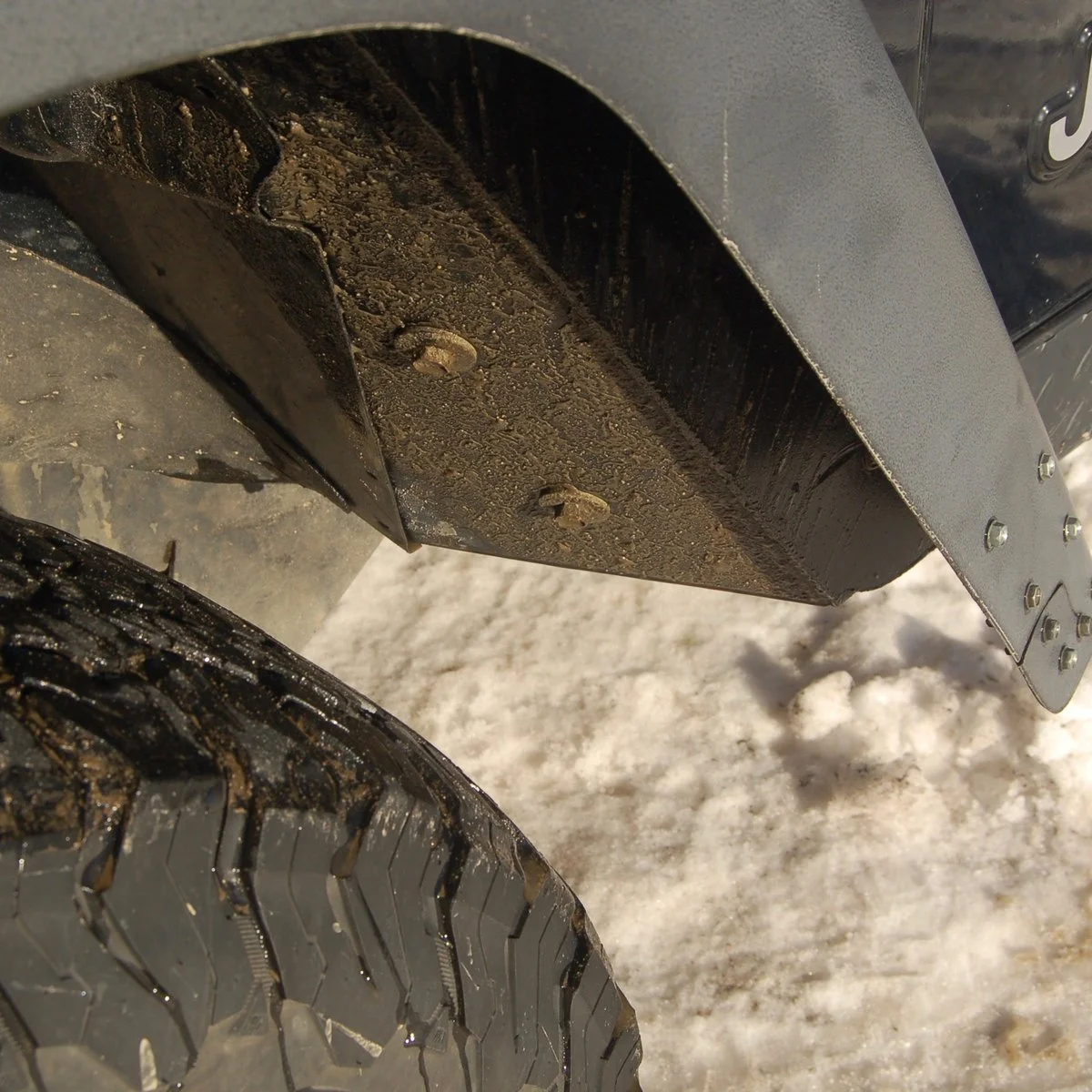

Maybe @jjvw could work with you on figuring out a solution for the rear wall of the front inner fender and tire clearances. I know he’s been thinking about how to modify his to fit 35s.
We'll see how far I need to go, but my intention would be to copy the AEV corner cut into the wall. But that might be easier said than done.
X2 on all of that. For the turn signal enclosures you added to the lower-right grill (my favorite) the OE JK turn signal enclosures are ideal. They have the right proportions and accept the factory turn signal bulb enclosures without any modification.

Any way to make the turn signals a little bit larger like the original CJ? I'd be all over it if it were. I like the CJ look on the TJ, been wanting to do something like this for a long time and then fill in the signals on the fenders.
