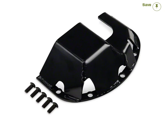

You mean like differential skid plates? I'd skip those and do the cover of your choosing.
Diff skid plates? Yeah, don't waste the money.
I think that's what he meant but I just wanted to clarify lol. I don't think I've ever seen them for smaller axle's. I've seen the yoke skid plates for 14 bolts and such..
Here's a pic.
Screenshot 2021-07-11 at 08-17-22 Rugged Ridge Jeep Wrangler Dana 30 Differential Skid Plate; ...png

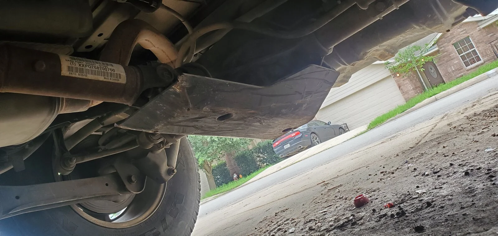

I have them but whe I took it in for the tummy tuck I was told they might interfere with the gas tank armor. So bigger is not always better. Still waiting for the install so we will see what happens.
Cycling the axle without springs will tell you if there is interference. Whoever is installing the tummy tuck should be doing this. Also, remember that a tummy tuck raises the pinion which also rolls the cover down lower.

The JK44 skid fits the TJ dana 44 as well. Didn't have any problem bolting right up.
Some say don't worry, but at $70ish, why not put one of these on the front? It helps protect the stock cover and doesn't cause interference issues. It will also give you peace of mind for denting the front cover.
For the rear, any HD cover's primary purpose is to reduce the risk of the cover from peeling back, and leaking, when drug across rocks. FWIW, I've seen the rear covers peeled back and leaking more than I've seen a front cover pushed into the ring gear.
As an alternative on the front, Alloy USA makes a 5/16 HD Dana 30 cover. They're not as thick as other covers, but plenty strong.
