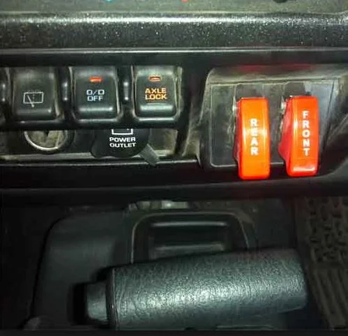

I'm getting to the point of frustration with the single switch controlling both lockers....I'm thinking on how to change the set-up to front and rear with dash illumination (cuz its neat, not because I need it to know I'm locked). I think Sri did it, and posted it somewhere...
I can't imagine not being able to lock either independently. That's some nanny state stuff right there.
'Course, even the standard wiring setup on the ARB switches won't let you lock the front without locking the rear. So, it's not just Jeep I guess...:rolleyes:
I can't imagine not being able to lock either independently. That's some nanny state stuff right there .
Yeah, both my jeep and my truck (both with factory lockers front and rear) require locking the rear before the front...also slow speeds (25 mph or less, IIRC) and T-case in 4-low.
We did Chris's that way. The dash light was harder than I expected. The only issue with it is using the switches that plug into the dash bezel. The ones from Golden State while they do work, are a bit cheesy for what they cost. They don't have that positive snap feel that a quality switch does.
They are a bummer. I bought one for my "locker enable" switch. It sucks. It works, but its not the same as the factory. I wish the hardrop switch set (with wiper and defrost) were not so complicated. I'd replace the whole lot with Carling rockers.
I figured out double switches a couple years ago. I like it. Just don't ask me how I did it. Pure trial and error. Sri wrote it all down and also made the dash lights work.
The aftermarket switches look decent but no where close to feel of the factory one. Not sure if either switch comes apart without too much trouble, but I wonder if we can get spare factory rocker switches and move the plastic internals over?

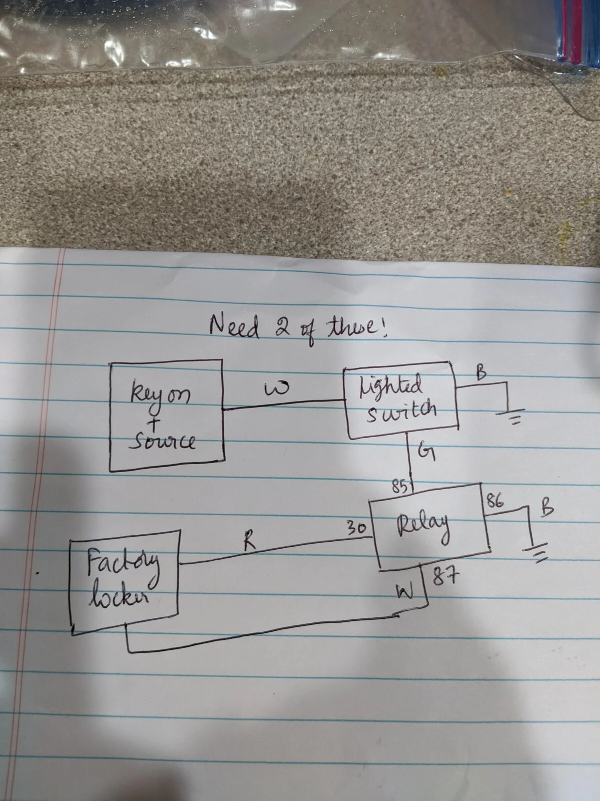

Figuring out the dash lights took me a very long time and I need to find my notes to recall why I did what I did. I was trying to help @mvigo with this last year, and we looked at the wiring diagrams together and it made sense at the time but I've forgotten the details.
@Mike_H , here is a diagram of what I did. The idea is to insert a relay to interrupt the momentary ground that the pcm needs to enable both the lockers and the dash light circuits. If you wanted to enable lockers on all tcase positions, you have to do the wandering trail mod on top of this.
@mrblaine is your implementation anything similar to below?
@ElectricWizard went one step further and found a way to make even the switches Illuminated. I decided I don't do anything that needs lockers at night time so did not do it, but if you are bored ...

Perfect. I remember we had a discussion about it, but don't remember where (through PM or in the open forum). I am going to try getting a couple factory switches and move the "covers" over from some aftermarket ones. See if I can get the feel of factory with the new pictures.

What I did, and what I have recommended many times, is to bypass the Rubicon's locker wiring and switch and install your own. If you can wire a light bulb so it turns on & off with an on-off switch, you can do the same with the Rubicon lockers that are no harder to control than a light bulb is.
All that is needed is wire, two simple on-off (SPST) switches, and a 5 amp fuse for each of the two locker compressors.
This is where I mounted my locker switches. I totally do NOT miss that effed-up factory locker switch and its engagement order.
The factory setup, though complicated, is elegant.
Your setup will not light the gauge cluster locker indicator switches like the factory switch does. Not everyone wants two bright red switches in the dash switch pod.
