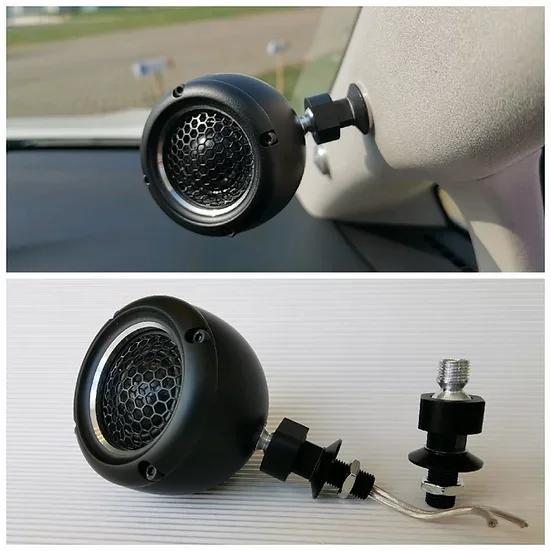

For mounting the tweeters you will need a good spot, there are a couple ways, mainly personal preference. I put mine in the a-pillar trim, others mounted to the dash with a pod. These would be the two methods I would choose between.
View attachment 180516View attachment 180517

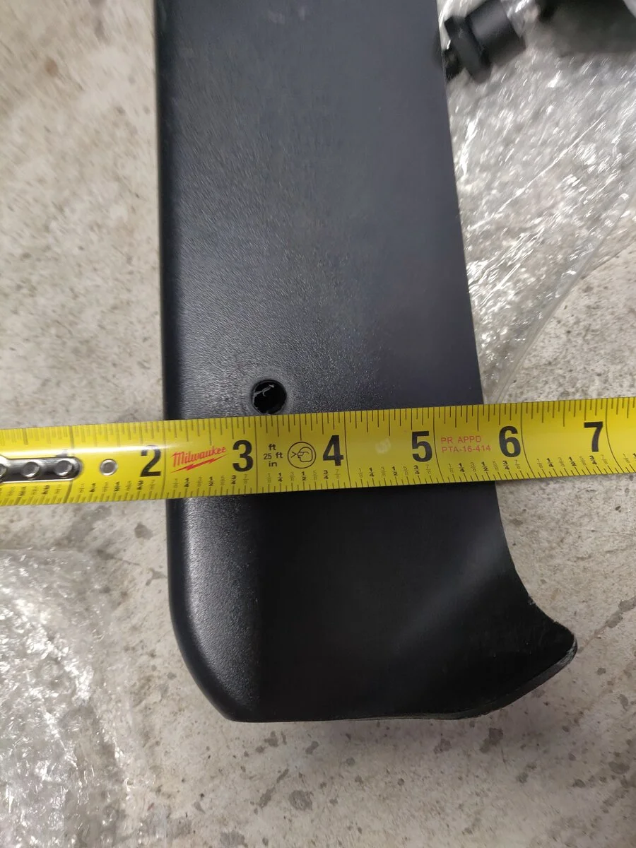

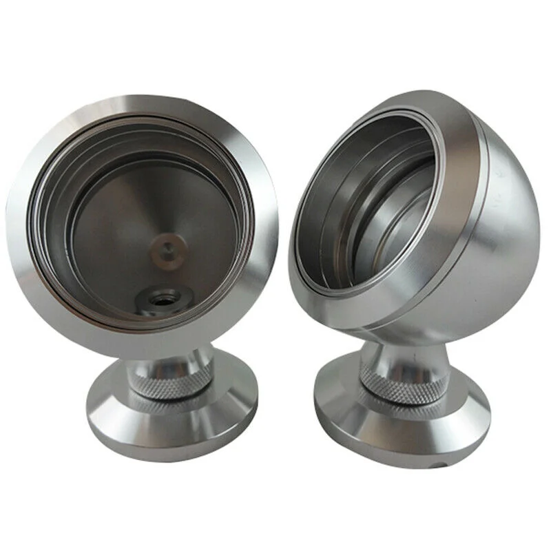

It appears all these pods are $69+....I'm really surprised at that. I thought they would be more like half that. If I use what the tweeters come with they are more flat with maybe a little angle but certainly the $69 pods that actually direct them at the listener will be far better.....but $69!?....that is as much as the entire front component speaker system! Seems ridiculous that tweeter pods would double the cost of the front system.
Half the price but check the size of your tweeters vs these.

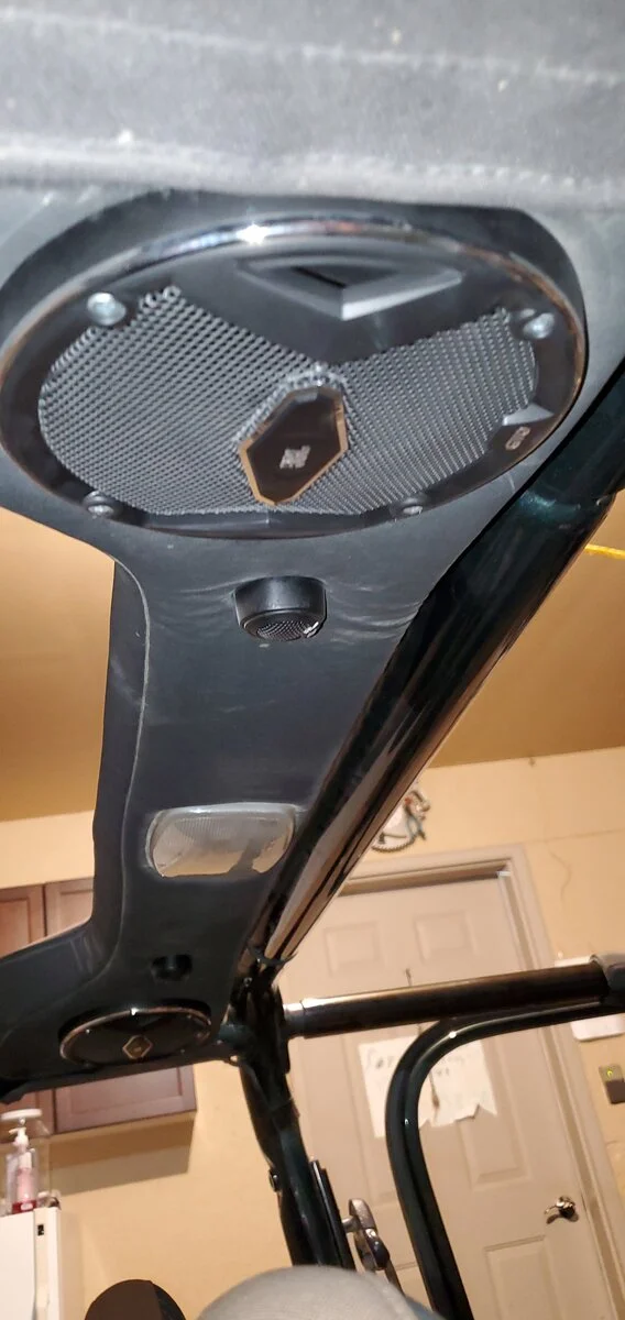

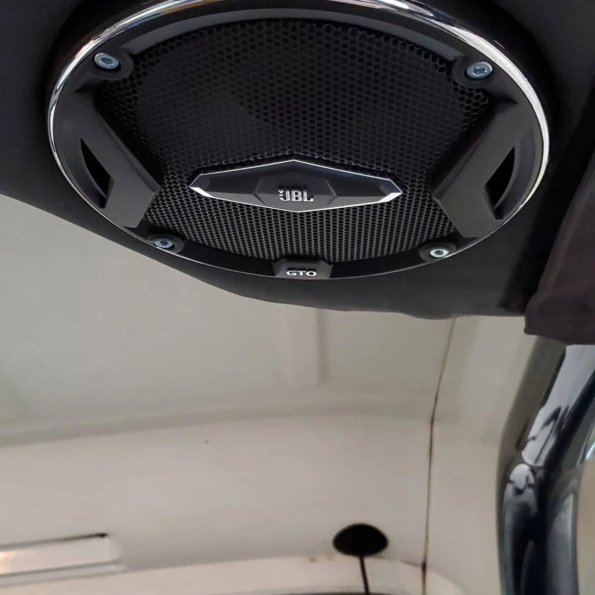

When I purchased my Tj I dropped 1k (this is cad) into a new system. I use a cheap Sony DSX A415BT head unit to power to sets of JBL 9 series 5.25" component speakers which are now discontinued. ( i bought the last 2 off Amazon.ca ) the filters are sitting loosely in the speaker cavities.

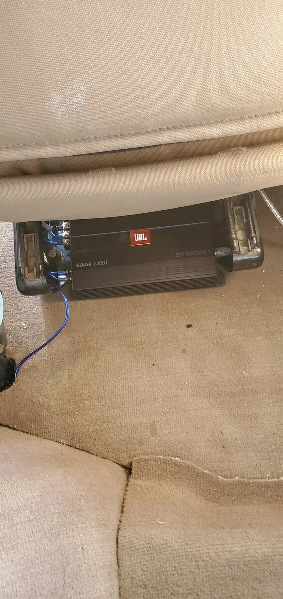

Finishing this off i have a shallow JBL 10 in the back which doesn't take up too much space. The sub is powered by a JBL stage amp sitting under the drivers seat.

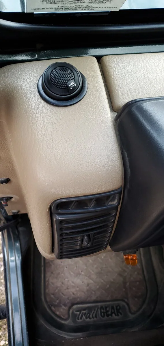

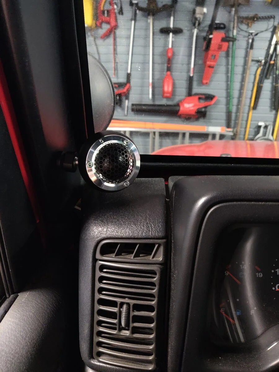

I have the tweeters sitting in the dash like so.
In the sound bare i used boom mat speaker cups and have not yet placed the tweets.
Overall I am super impressed with the sound. It is super high quality and im not sure how much better it can get in a jeep lol.

What all did you have to do to mount the tweeters there? Was it just a small hole for the speaker wire or did you need to make a hole the size of the tweeter?

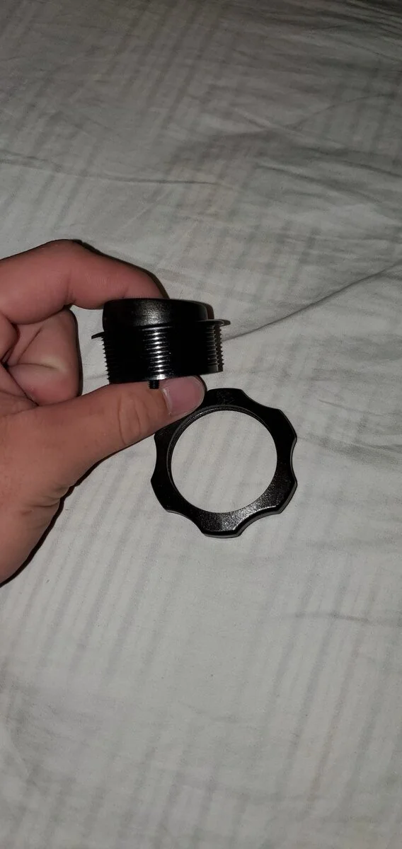

This is what the tweeter mount looked like
I used a hole saw to cut a hole the sam size are the bottom part of the mount. After crimping and dropping the wires through I filed just enough off the edges of the hole that I could just barely force the threads in. I was gonna fasten it with a little glue around the rim but its not gonna come out without damaging the dash.
For the rear I just flush mounted

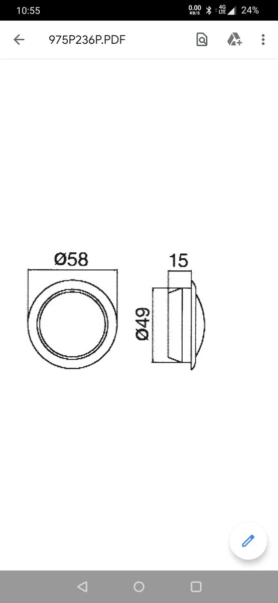

I believe the tweeter is 25mm but I'm not sure if that includes the plastic surround or just the actual tweeter. Looks like these pods need at least 40mm.
You need to check the owners manual for the specs, like these are tweeters I have

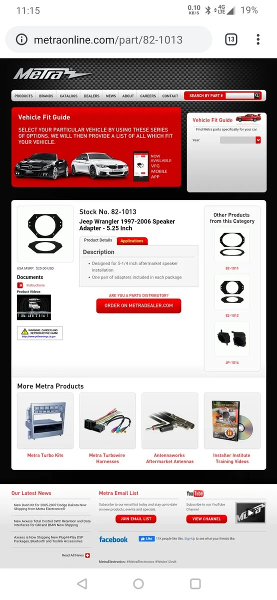

I suppose I will need a mounting bracket to use a 5.25 up front....I knew what I needed for various 4x6 speakers but not sure which bracket will work for the 5.25.
What did you guys use?
Thanks SO much for all the direction! It's been a HUGE help! I've got goodies on the way! :)
You seem to like Amazon so Amazon this part number.
http://metraonline.com/part/82-1013

To make sure I am following you correctly....are you saying you didnt need to use the threaded ring on the bottom side of the dash? You basically made your hole snug enough that you threaded the mount through the dash plastic and it is tight and secure.
Thanks
Thanks
Thats exactly what I did
