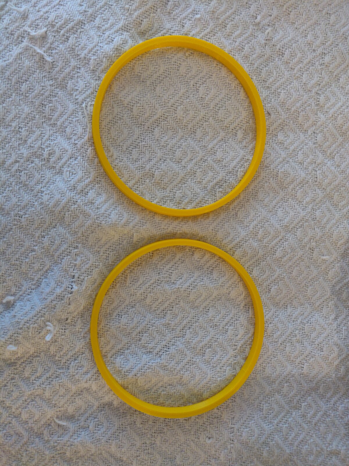

Here is the spacer ring. Make sure you expand by 1% if printing with PLA. It's not just a simple ring - the outer edge is angled to perfectly match the contour of the speaker pod.
https://www.thingiverse.com/thing:4617429
I didn't 3d print the speaker pod for the Signature TS20 - the pod was included with the tweeter. But the design is stupid - the screw leaves the pod at a 30 degree angle so when screwing it into the platic trim it isn't very secure. I created a backing plate to match the angle. Here it is:
https://www.thingiverse.com/thing:4617443
Mine arrived today. Thank you so much LJGreg! These look and feel amazing. I will hopefully install over the weekend and snap some more pics.
Will I need these for my new Blams?
You will not. I currently have nothing in that space and it has been fine. This is just reassuring, and reducing the chance of a vibration. I previously stuck rubber weather stripping in that slot if you choose to do so.
@Rooscooter or @Ocho - did you use any mounting rings when you installed your BLAMs?
I'll report back how these work out, but they look awesome.
I cut and stacked some foam flooring insulation to fill the gap which created a nice seal around the speakers, while reducing possible vibrations and got grilles from amazon for them since they mount to the surface. I also added dynamat to the inside of the pods and fabbed up a holder for the crossover, with a light amount of poly fill.. they sound bitchin!
Thanks for uploading the files (although looks like there is an issue with the tweeter mount upload).
