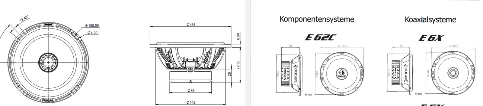

So I am looking at Focal PC165F for rollbar pods. They say 2 15/16th inches to mount. Anyone running these? They look a bit deep, but I am getting close to ordering my system, so help is appreciated.

Could be a little too deep. These are the Focal PC165F's specs (left side) next to my Helix E6X speakers (right side). The mounting depth is 7mm longer on the Focals, which I THINK, could make them too deep.
