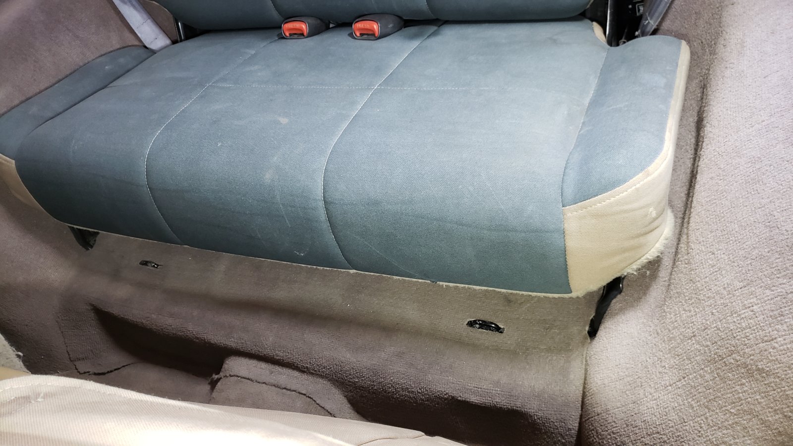

Okay, my sub is a powered sub, Rockford Fosgate PS-8. I did not mount it in the console because I wanted to use my console for other stuff and maybe even a cooler one day. So, what I did was mount it on the bottom of the rear seat. NOT on the floor under the rear seat, on the bottom of the seat itself. These are slimline self-powered subs that fit there well and don't take up any useable space in our tiny TJ's. I can take pics if someone wants, but I think you're looking for a console solution. But mine's better! LOL I get a console AND a sub and nobody even knows where it is, except you guys!

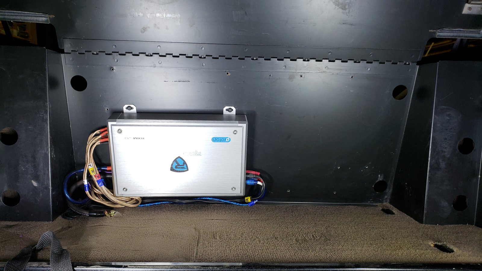

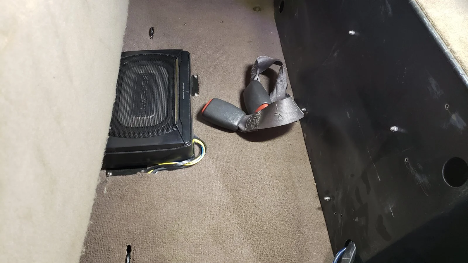

I have a 1999 Sahara and rewired and replaced the entire sound system a couple of months ago. I mounted my Kenwood powered sub on the floor under the rear seat. If I decided to take the seat out the sub would stay. I can easily put a box over sub so it won't get smashed while loading gear. Amp mounted on trunk enclosure. Very clean looking and you wouldn't know it was there as I have a soft top and don't lock doors. I do still have carpet so that helps with hiding wires. My components are listed in my profile. All are marine rated except sub. I think I paid $500 for everything on amazon. I did need new circular front mounting brackets for speakers but that was an easy modification.
I like Chris's set up also but instead of the separate amp & sub go with the powered sub and do like Sloguy, mount it on the floor under rear seat. I normally have the back seat out for the dogs and what not and will just have to have a durable cover.

Here are a few pictures of what I did. I haven't installed an audio system since the 80s and this was much easier than I remember. I just took my time and with the money I saved doing it myself I bought some quality crimpers and connectors. The learning curve was figuring out the proper use of the crimpers. I rewired everything that the previous installer did. They had the wires run under the carpet on driver floor pan and rear seat. I found this out when I took the carpet out to clean when I got a little too deep and water got into the cab. If you use the factory wiring you don't need to do much. I ran new 14 guage wire for the speakers. Also ran the power along the passenger side and speaker and RCA wire on the drivers side to keep them separate. Make sure you have a good ground to the amp and sub if you go that direction. Photos show how circular 5 1/4 fronts look behind the cover. Sound bar has 6 1/2. Sub with seat folded up and seat folded down. Amp mounted to the trunk enclosure (be sure to use acorn nuts so you don't cut yourself reaching in the back, found that out with the previous self tapping screws the other guy installed)

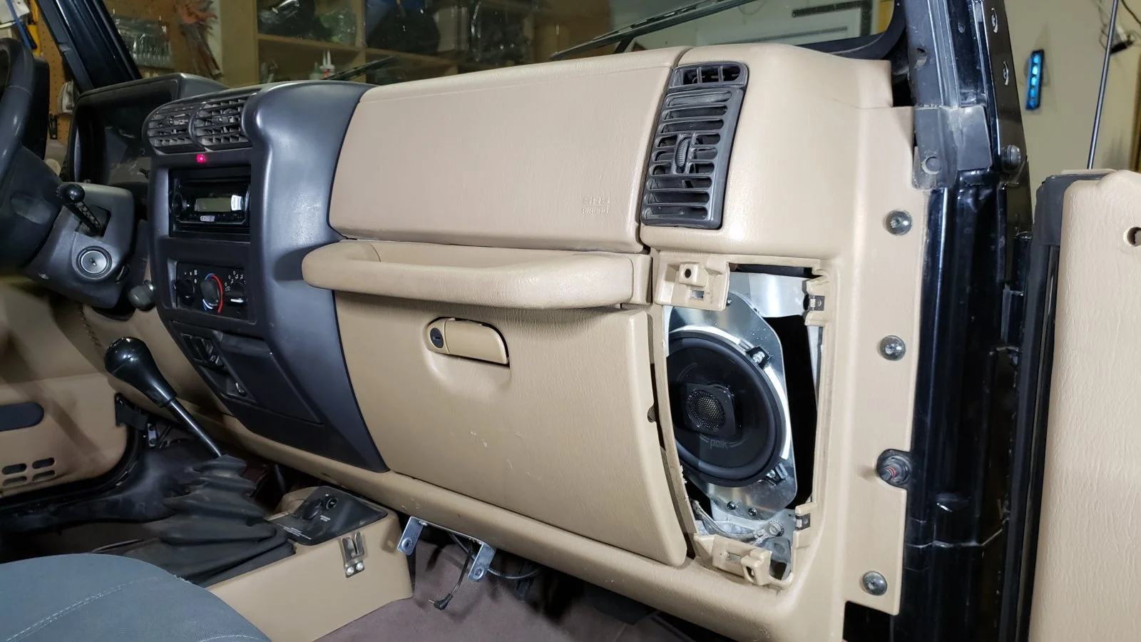

The polks fit the factory location dash+sound bar (in the dash with the dash pod addition, otherwise you need 4x6 or an adapter plate, but really you want the dash pod) and the sub replaced the center console one by just sitting in there where the factory box would have been once I removed it.

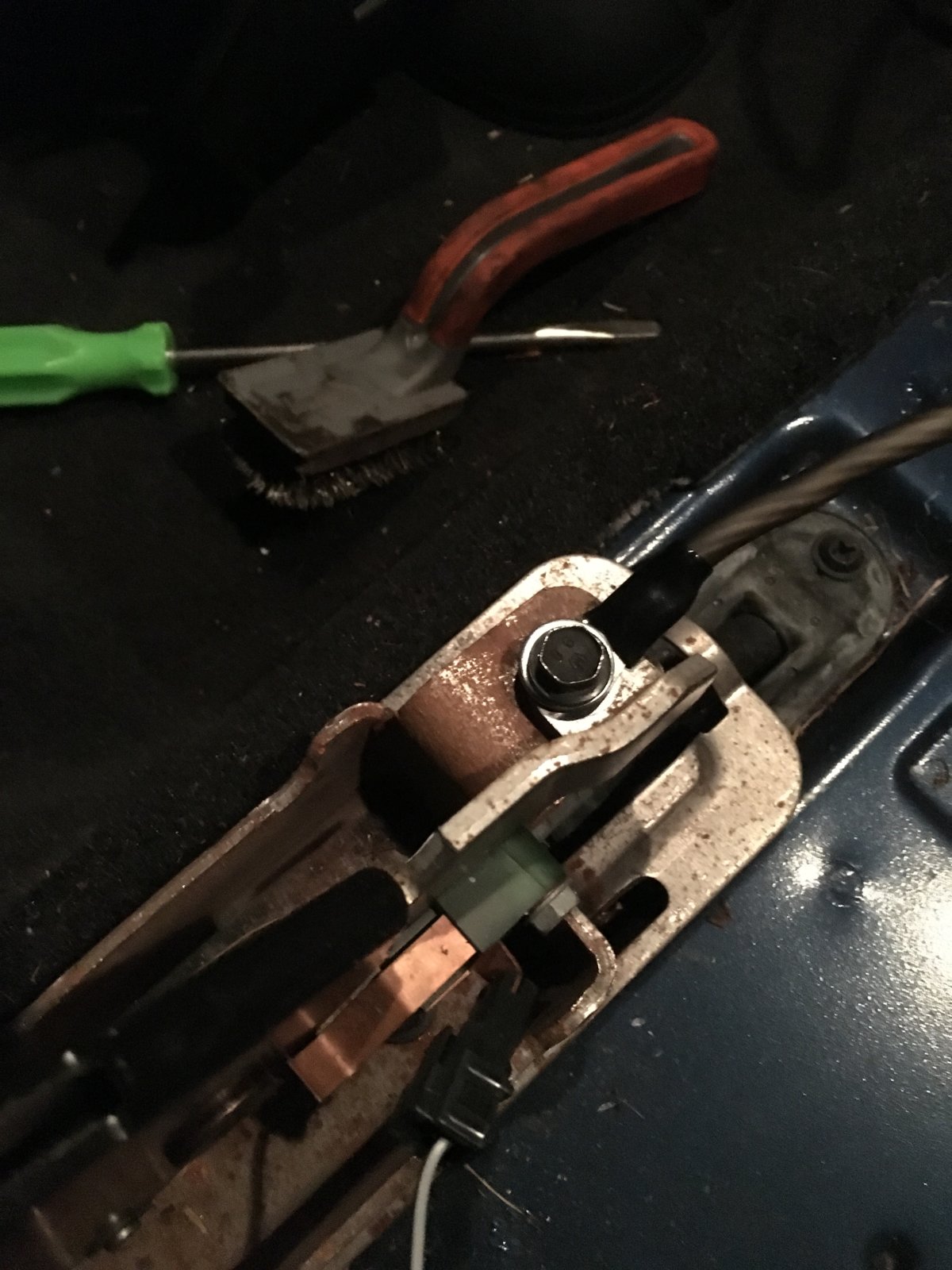

Looking for some help....hooked up my kicker amp and sub and I’m not getting power to the amp. Checked all the connections and fuse and headunit working but amp not turning on. Any suggestions? I’m thinking maybe it’s my ground connection? Would this ground work? Or does it have to be directly to the tub? That’s connected to the parking brake assembly.

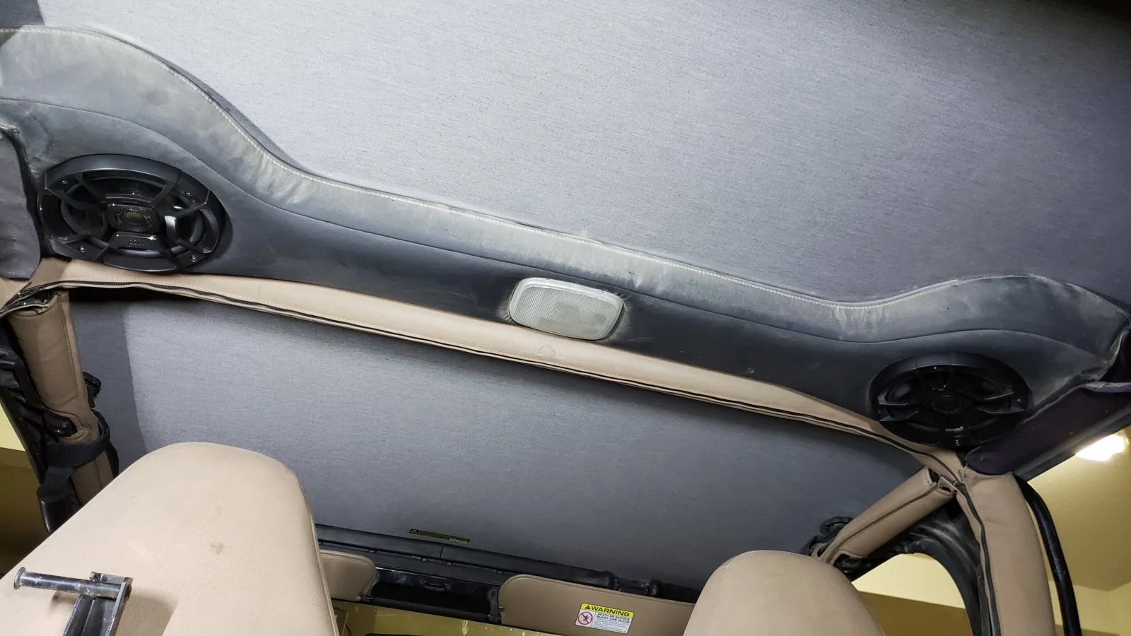

So I went with the Infinity Basslink SM powered sub under the rear seat. Front and rear speakers powered from head unit via stock wiring provides 14 watts RMS (50 peak) to the 4 channels. Sounds good but I’m still dialing it in as I never have messed with crossovers and the sub with the gain and loudness and all that.
PIONEER DEH-S5000BT stereo ($80)
PIONEER TS-G1345R 5-1/4” round 2-way speakers for the dash ($30) (w/adaptor plates ($12)
PIONEER TS-A1676R 6-1/2” 3-way speakers for the sound bar ($80)
Infinity BassLink SM powered 8” slimline subwoofer ($200)

jazngab, looks like a solid ground to me...just make sure that ridged support piece is bolted directly to the tub and/or frame with no insulating washers or something similar...also I would suggest a test. run a wire with some alligator clips from the battery to that ground connection. it doesn't have to a large wire cause you wont be amping up. all our looking for is the power light on the amp to go on.
