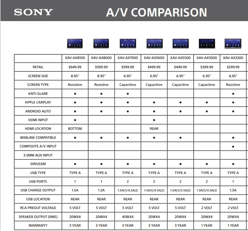

Considered the Sony 3200, but was worried by some reviews that mentioned the screen brightness. May compromise to the ILX-407 for wired CarPlay and a good screen, but wireless of the 507 is very tempting!
I am an owner of the 3200 but in a different vehicle, and I can confirm the screen brightness is greatly reduce when sun hits the screen. This 3200 is a resistive touchscreen, which causes that, and also keeps the price down. So it really comes down to budget and personal tolerances. I am okay savning a few hundred as I do not use my 3200 for like offroading, or NAV. SO for me, this was a great choice, but for an offroader, this is not the best choice.
The Alpine you are looking at is capacitive and why it cost a little more. Here is a chart of that SONY XAV line-up[ in case you want to look at others with a capacitive screen, like the XAV5500 would be a good comparison to that Alpine.

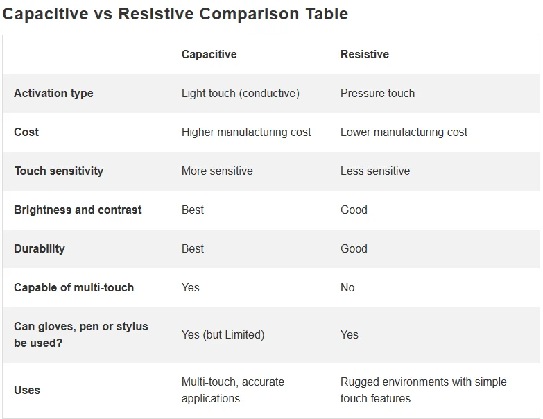

Here is a simple chart of pros and cons of resistive touchscreens vs capacitive touchscreens:
