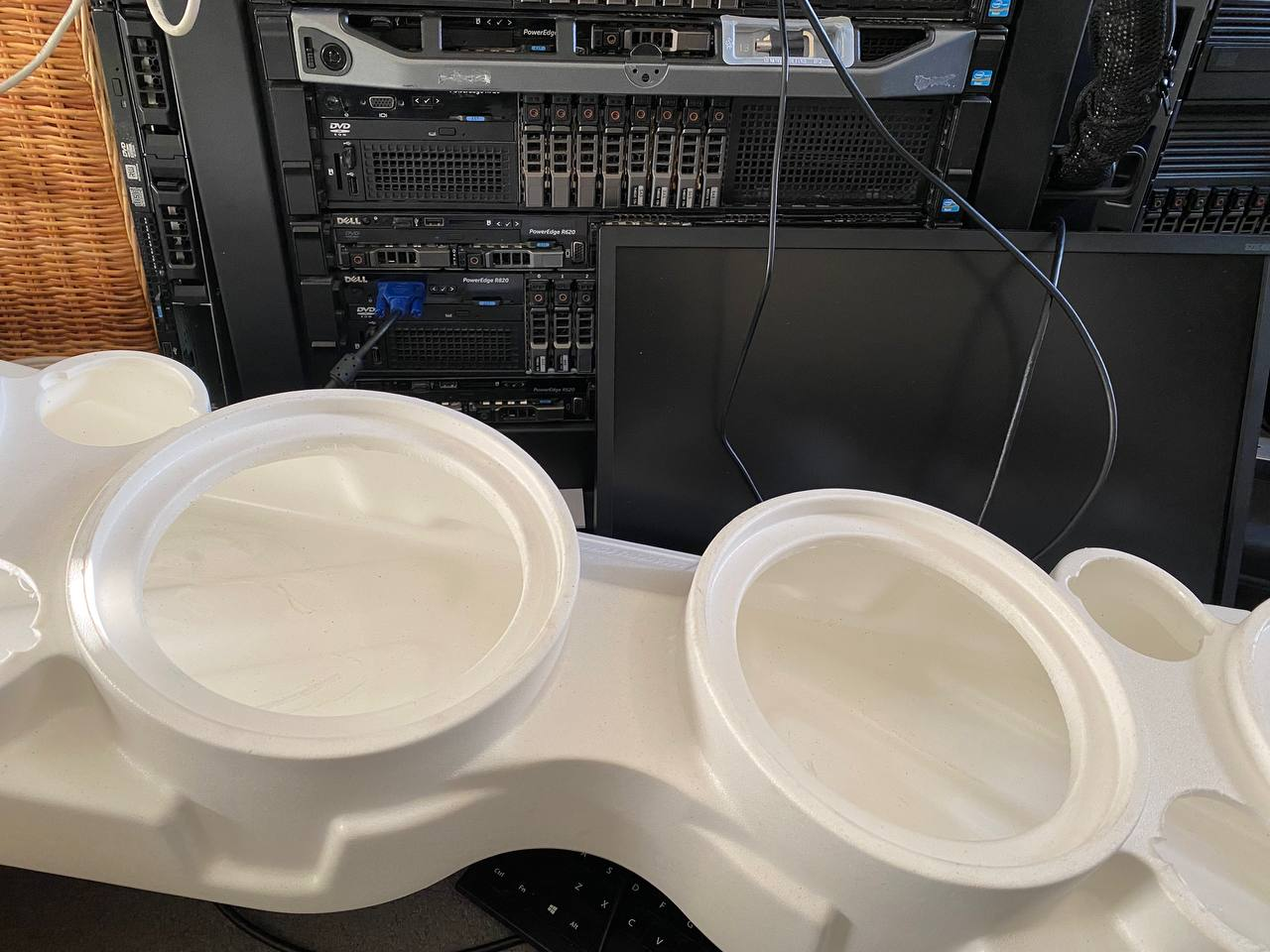

It arrived today so faster than I expected, build quality is solid, maybe design has change as I cant see a set of speaker making this flex or bow, I could confidently stand on it without it breaking, not that I weight much, the material is pretty dense and 5mm thick at its thinnest points, the bar does need a bit of a clean though assuming its been in store for some time. think I'm going to leave it in this colour instead of raptor lining it

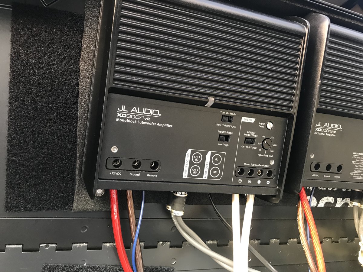

the amps I currently use are
XD800/8v2 8 Ch. Class D Full-Range Amplifier, 800 W
XD300/1v2 Monoblock Class D Subwoofer Amplifier
Will run 2x 8inch mids (coming off channel 5 and 6 on the XD800)
2 x 8inch subs. comming off the XD300 and replace the rear mono block with an XD600 for the bass behind my rear seats.

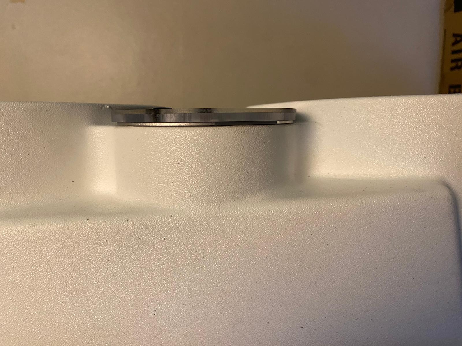

I hate that all 4 "tweeter" holes were pre-cut; they are 75mm diameter but need a 95mm bezel to cover them fully, two of them will be used to run LED dome lights and the other two will either be capped off with blanking plates (or tweeters to make it look clean) or I will add grilles if the sound bar needs porting for the speakers to breath. There is around 95mm of depth to play with to fit speakers and the volume for the enclosure could be around 2.1* cu feet sealed.

I hate that all 4 "tweeter" holes were pre-cut; they are 75mm diameter but need a 95mm bezel to cover them fully, two of them will be used to run LED dome lights and the other two will either be capped off with blanking plates (or tweeters to make it look clean) or I will add grilles if the sound bar needs porting for the speakers to breath. There is around 95mm of depth to play with to fit speakers and the volume for the enclosure could be around 0.8 cu feet sealed.

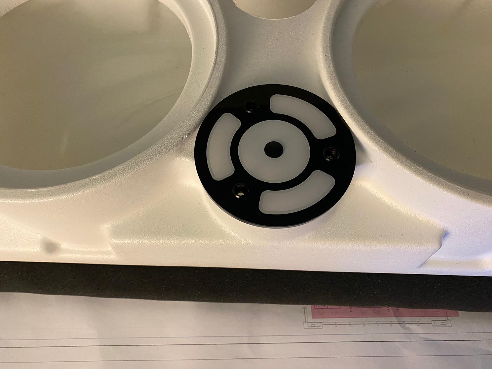

Maybe just two tweeters in the forward holes, and two lights in the rear ones. These are hideous but look like they’d fit.

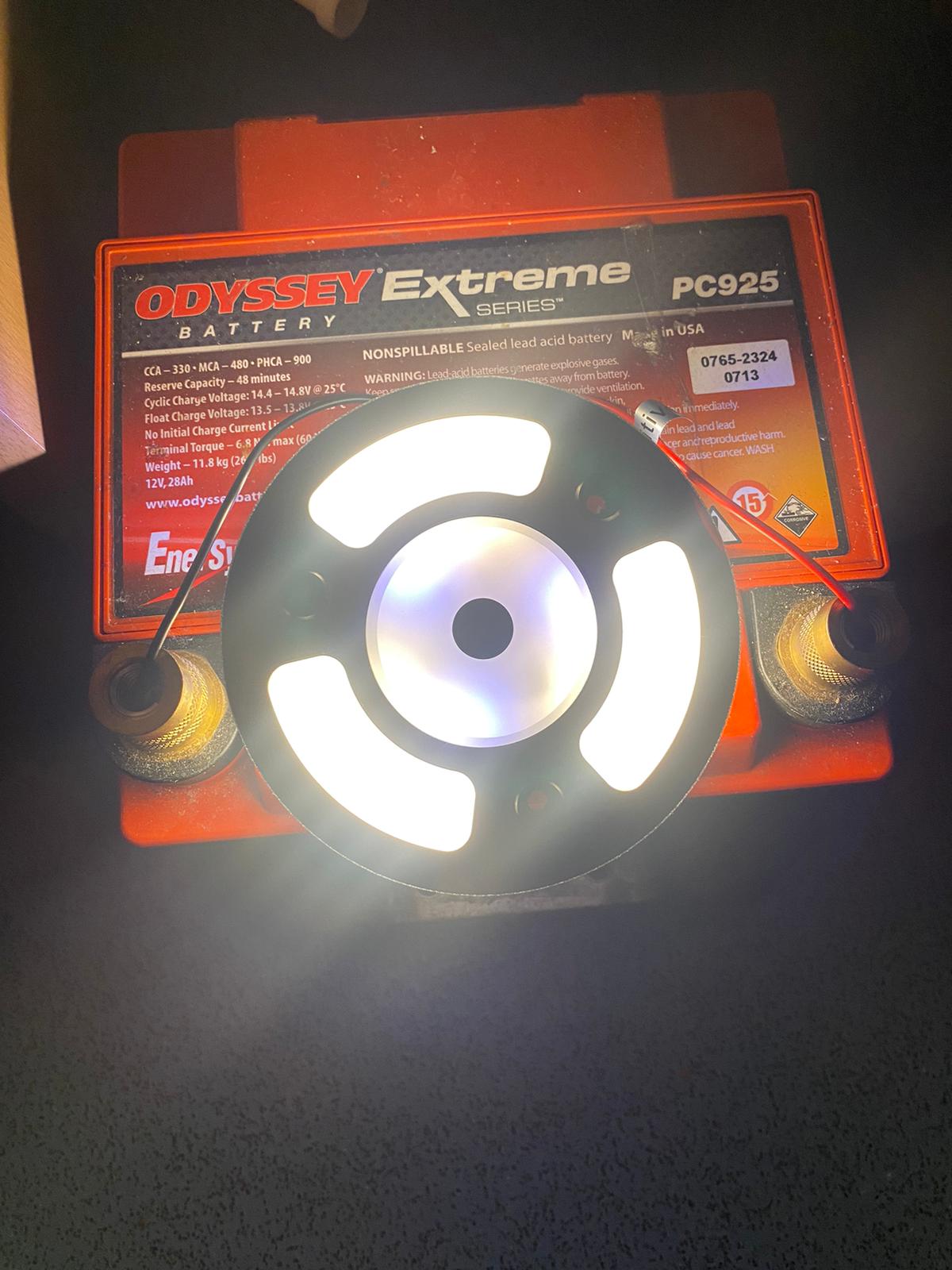

I couldn't get that link to work but I ordered these lights, they are a perfect fit, the round circle in the middle is touch sensitive switch, I have ordered some Dupli-Color HVP113 Medium Beige Vinyl and Fabric spray to change the colour of the sound bar, so wont be doing any prep until those cans arrive.
Are those 95mm lights? Looks like a good fit. Did you say what amp and speakers you are using?
