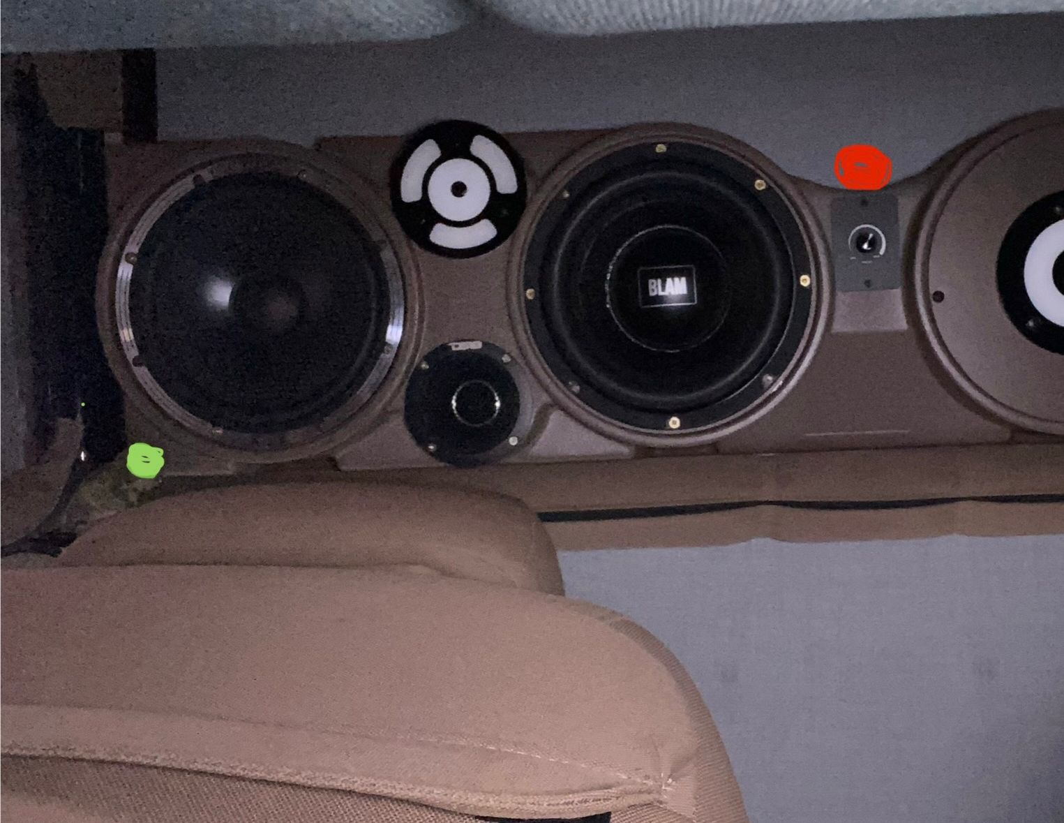

I completed mine over the weekend and plan to install next weekend, time permitting. I was thinking of installing by sliding onto the rear of the roll bar and then sliding forward towards the front. Without taking the top off I cannot think of another way to get it on. Will need to put some protection on the soundbar to prevent scuffing it up. My soundbar only had two slots for 4" speakers so that is why mine is a little different. Not the best pics...

why are you running the cables out the middle of the back like that ?
Easier access when it's installed? I couldn't take my top off (it was an aftermarket that had shrunk) so when I ran bigger wire to mine I had to drill in the side.

I cut the same size access hole on mine to the side near the pillar where the green dot is, @skrelnik cut his in the middle where the red dot is, those cables will just dangle ?
I just the same size access hole on my to the side near the pillar where the green dot is, @skrelnik cut his in the middle where the red dot is, those cables will just dangle ?
Ahhhh, I'm tracking. Then the wires are run down the roll bar on that side.
Hmmm. I imagine he could tuck the wire between the sound bar and the top. A little Tessa tape on the exposed parts would hire the wires pretty well.
take the top off
Taking the top off is a small project as I have a gr8tops hardtop, but I was able to test fit the soundbar by sliding onto the rear of the roll bar and sliding it forward.
I did that and then also though that the back side could be used as the front side and the wires could come out through that inward curve. The hardtop has a light right above that space so I can tap into that wire.

I Intend to install the soundbar with the inward curve facing the rollbar, so different than how it was intended to be installed. I don't see any issue installing in either direction. @Reign Mack do you see any issues there?
Since my hardtop already has an exposed light/wires right above the inward curve, the wires will sit in between the soundbar and rollbar and then connect to the already exposed hardtop light wire, which has a quick disconnect for when the top is removed. When the top is removed I can then stuff the soundbar light wires inside the rollbar padding, like the audio wires.

That's where I was, couldn't take the top off to access the roll bar properly. I mean, worst case scenario, if you don't like how the wiring is, you can drill a new hole for the wire and plug up the old one.
understand, no issues flipping the sound bar around, that makes sense now.

Well putting a subwoofer in the soundbar turned out to be a bad idea lol, some frequencies were creating some really strange vibrations through the sports bar beyond certain db levels, I have removed the BLAM R8 EL and placed it in my Kicker bass tube , replacing he Alpine R2-W8D4, the R8 blows the R2-W8D4 away, maybe the enclosure is just more ideal size. Im going to put to passive radiators in the remaining 8inch holes in the soundbar. not had tine to sort out the light issue yet, due to other projects.
Do you know what frequencies were causing the issue? I just wonder if you could use the sound bar for midbass instead of sub bass.
not sure I didnt bother it just wasnt a good location compared to having the basetube in the back which practically turns back into a large sub.
