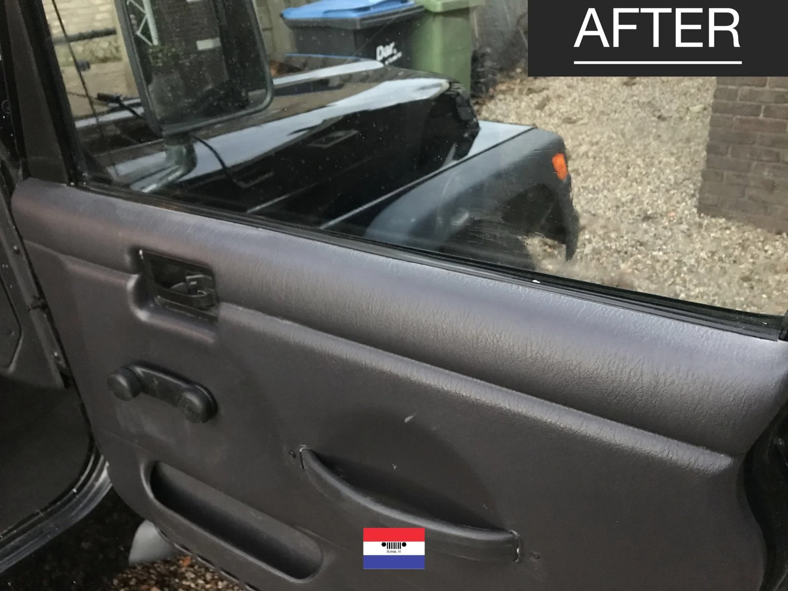

2 weeks later.
I did it.
Here are a few tips and how to :
Tools :
1. Brush.
2. Pure baking soda.
3. A bucket ( or what you like ).
4. Water.
5. Microfiber towel.
How to :
1. Make a 1:3 ( water : soda ) mix.
2. Put it in a bucket.
3. Dip your brush in the mix.
4. Scrub it with pressure on the plastic and repeat that a few times.
5. Clean it off with a wet towel.
6. Dry it with a dry towel.
Results:
I am surprised, it came out so good!
After a few years the plastic will turn cheap looking (my opinion) shiny. But the mix made the plastic back to factory ‘matte looking’.
The white/grey (was my target) is also gone!
