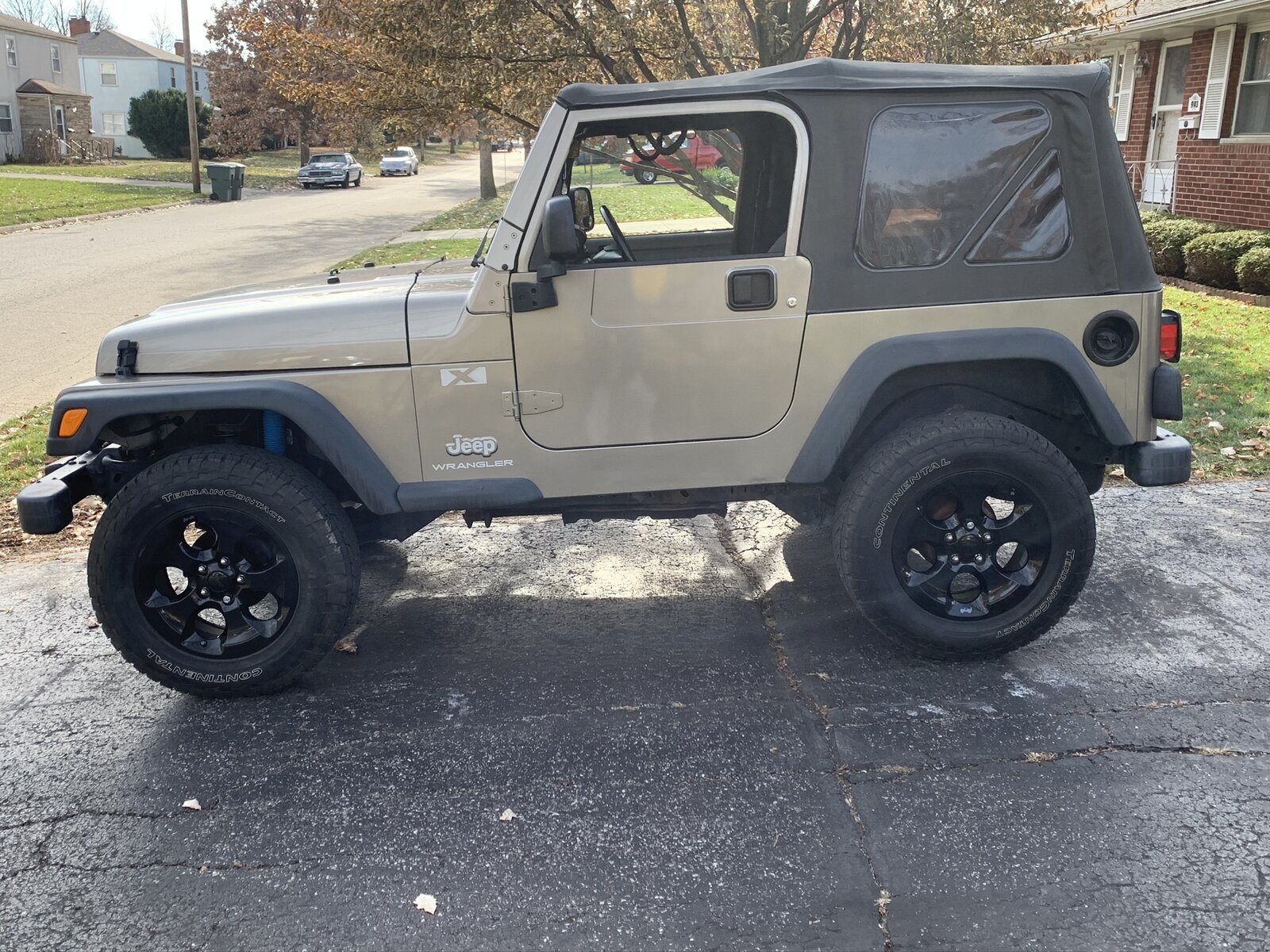

Thank you for the post! I was looking all over the Internet to take try to find help people solved the issue that I ran into getting wheels/tires off a 2020 gladiator to put on my 2000 TJ. I first grabbed the standard inch and a quarter wheel adapter off Amazon and went to install it and realized the thread pattern was different on the 2020 wheels. I looked for a larger half inch lug nut but could not find any. Went to my local Les Schwab and talk to somebody there and he said half inch Lugnuts would be fine....I talked to my mechanic while he was doing my lift and he wasn’t super comfortable with that either. Thanks to you I have some proper wheel spacers/adapters coming in the mail this weekend! Thanks for your time creating this post.

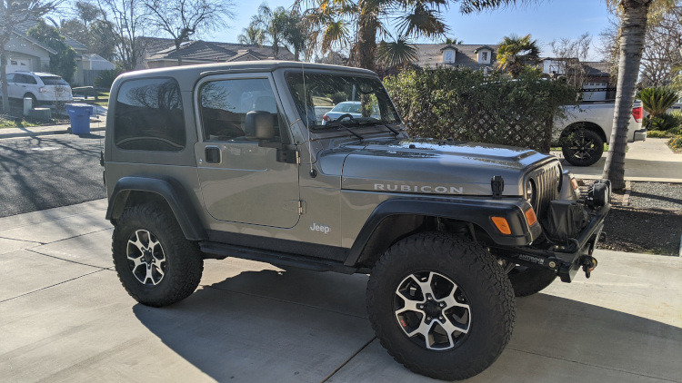

I put 2020 Gladiator Rubi takeoffs on my TJ using standard JK adapters. The Internet opinion majority at the time I did my research is on the side of having used JK adapter plates without failures.

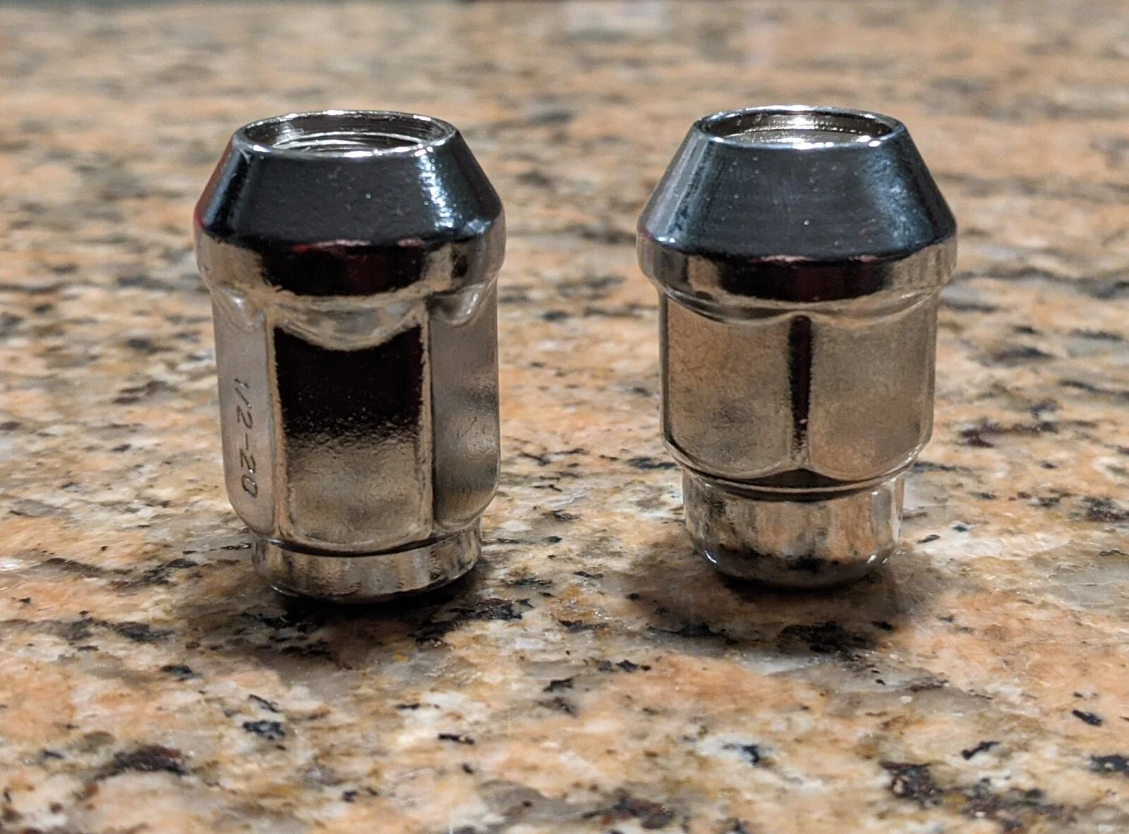

I wanted to revive this thread since I just put JL Rubicon wheels on my TJ. My concern was, as mentioned above, the JL uses M14-1.5 (13/16" hex) wheel studs vice the 1/2-20 (3/4" hex) for the TJ. With the JL wheels using a larger diameter stud it also means the wheels have a larger hole for the lugs and finding an adapter with M14x1.5 studs that are hub-centric is about impossible unless you want to have them custom made for around $500.
What I did was purchase readily available hub-centric 5x4.5 to 5x5 adapters with 1/2" studs for $60 a pair. I used the OEM lug nuts to check the fit. I felt that there wasn't enough of the conical portion of the lug contacting the wheel, so I put a little grease on the lug, hand tightened it, removed it and looked for grease marks. My feelings were confirmed.
I went on the hunt for larger lug nuts and found 1/2-20 (13/16" hex) lug nuts on Amazon. Purchased a set and took some measurements. The diameter of the conical portion of 3/4 hex lug nut measured 22.75 mm and the 13/16 hex lug nut measured 23.85 mm, plus the conical portion was noticeably larger and deeper (see picture). I installed one with the grease test and found that the entire wheel had lug nut contact. These will work just fine.
Here are the lug nuts I used: https://www.amazon.com/gp/product/B07QM9WD6B/?tag=wranglerorg-20

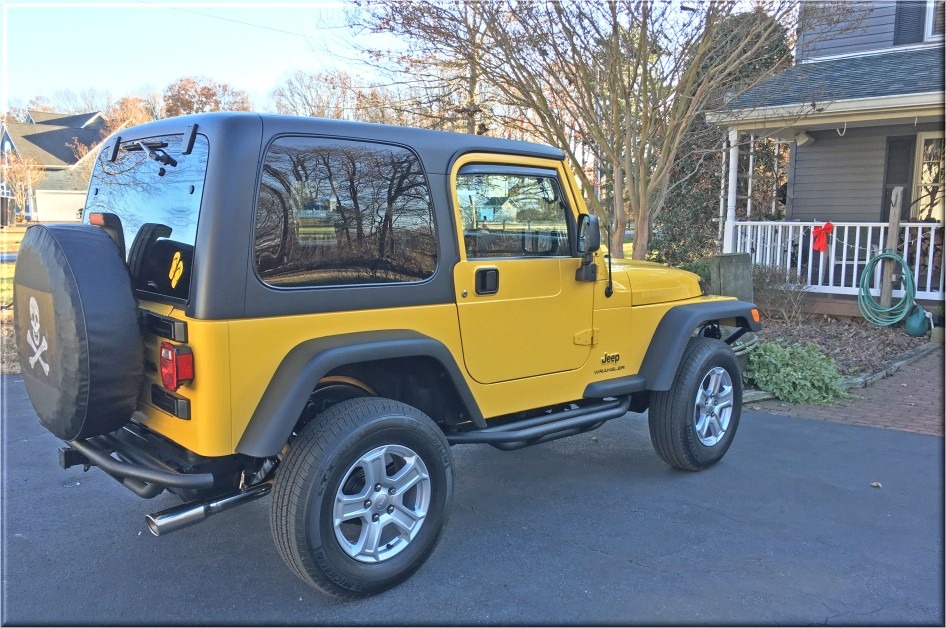

Thanks for posting this Codaman :) I am putting the same wheels on my TJ and was curious about the lugs. I will order these.
I was really commenting more on the wanting to leave. I'm not a California native, but lived there. Very happy to leave. We were 117 in Chandler yesterday.
Love the color of your TJ. I am going to order from Amazon today to see how they work!!

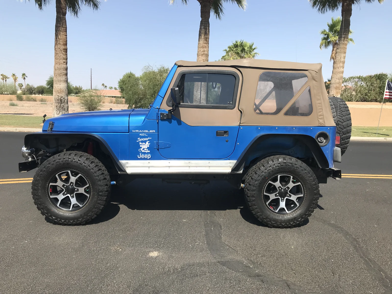

From a different perspective, I am intending to change back from my 17 inch JK wheels to TJ 15 inch wheels - the reasoning is; firstly when I am off road (in sand where I live), the spreading effect on my 17's is minimal vs. would I could achieve with 15's, therefore I should get better grip when deflated, secondly cost as locally 15's are cheaper than 17's (even with an overall diameter of 31).
I do like the look of the 17's and the ride is mostly smooth although at 110 km/h (68 mph) I have a slight vibration in the whel and through the pedal so assume that is a drivetrain issue rather than a pedal issue.
However, I did encounter an issue with the length of the wheel studs, they were too short for the adapters for the 17's and one worked its way loos which destroyed the front right hub and disc rotar which on the highway, lucky that i heard the noise (but did not feel anything in the steering) and pulled over immediately. Was informed that if the front hub and axle had separated at speed on the highway I would have flipped several times - so whilst all is repaired, tight and inspected now I am still mindful about messing with the geometry.

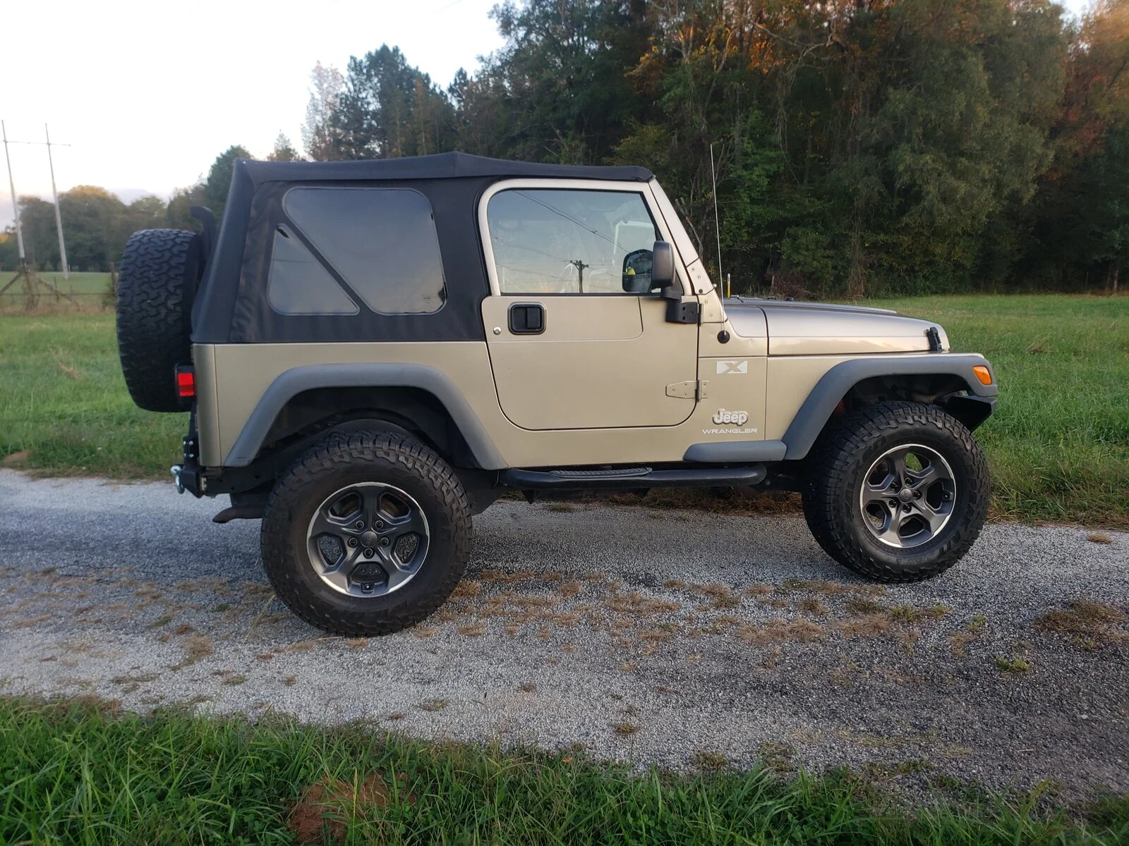

A bad alignment on my new to me 04 ruined a front tire being pulled behind my motorhome. It was a perfect time for wheel change. There are lots of new takeoffs for sale in Atlanta. I got these for just a few dollars more than two 33/12.5/15 would have cost.
