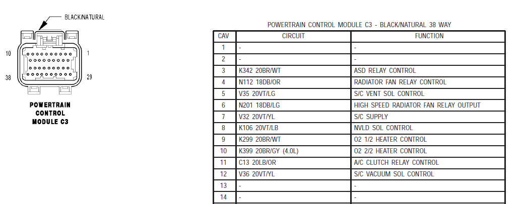

According to the FSM, all TJs have pinouts on the PCM for a low speed fan module and a high speed fan control.
But my PCM is for a 4.0! Surely it doesn't have any programming for an electric fan.

My best guess on how to make this work would be to add two pin receivers to the OEM PCM wiring harness (the slots for the 4.0 are empty, but the pins are there on the PCM). The high speed wire (Pin 6) goes to a large relay that turns the fan on, and the low speed wire (Pin 4) goes to a large relay with some sort of speed reducer, maybe a large resistor. Perhaps one of the unlabeled pins is for the 3rd fan speed.
So has anyone ever tried something like this? Thoughts?
