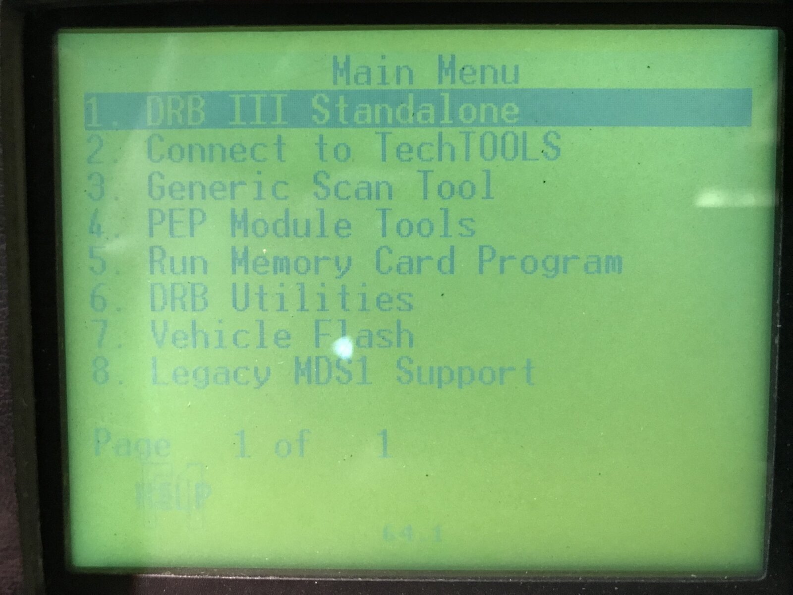

First, select Option 1 – “DRB III Standalone” from the Main Menu:

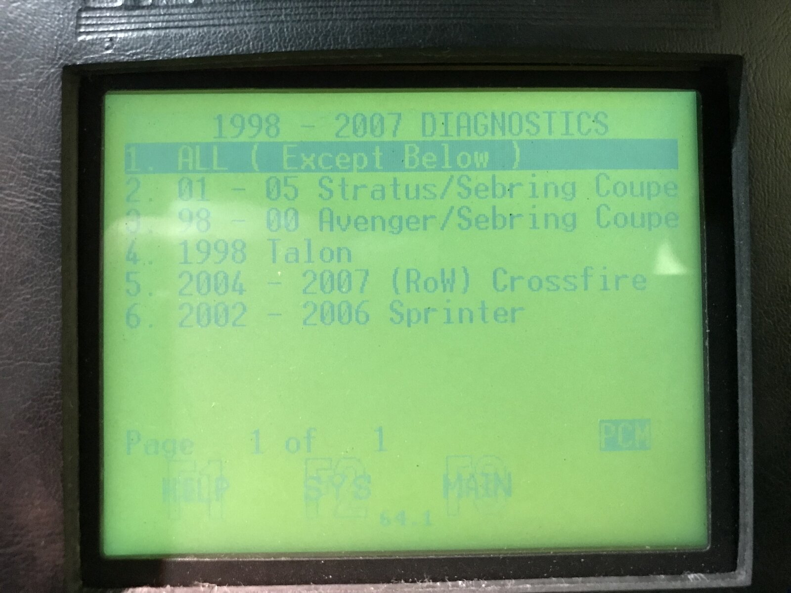

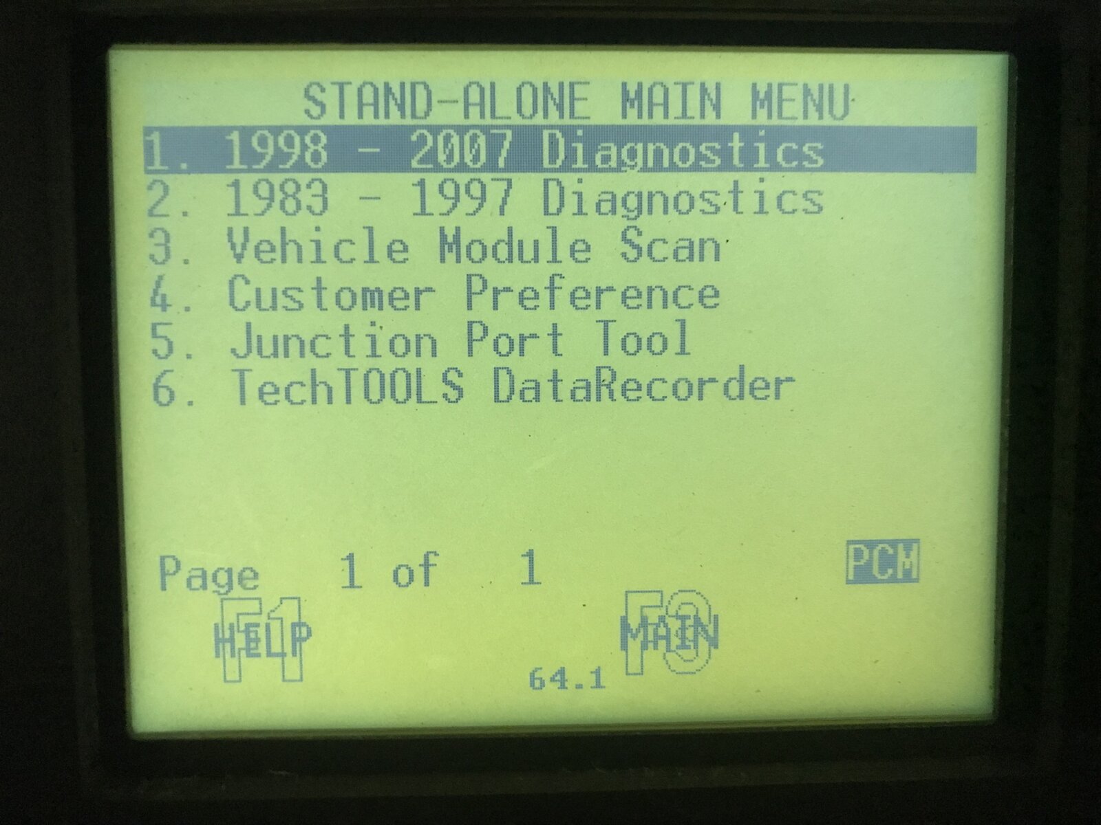

Next, select Option 1 – “1998 – 2007 Diagnostics” from the Stand-Alone Main Menu:

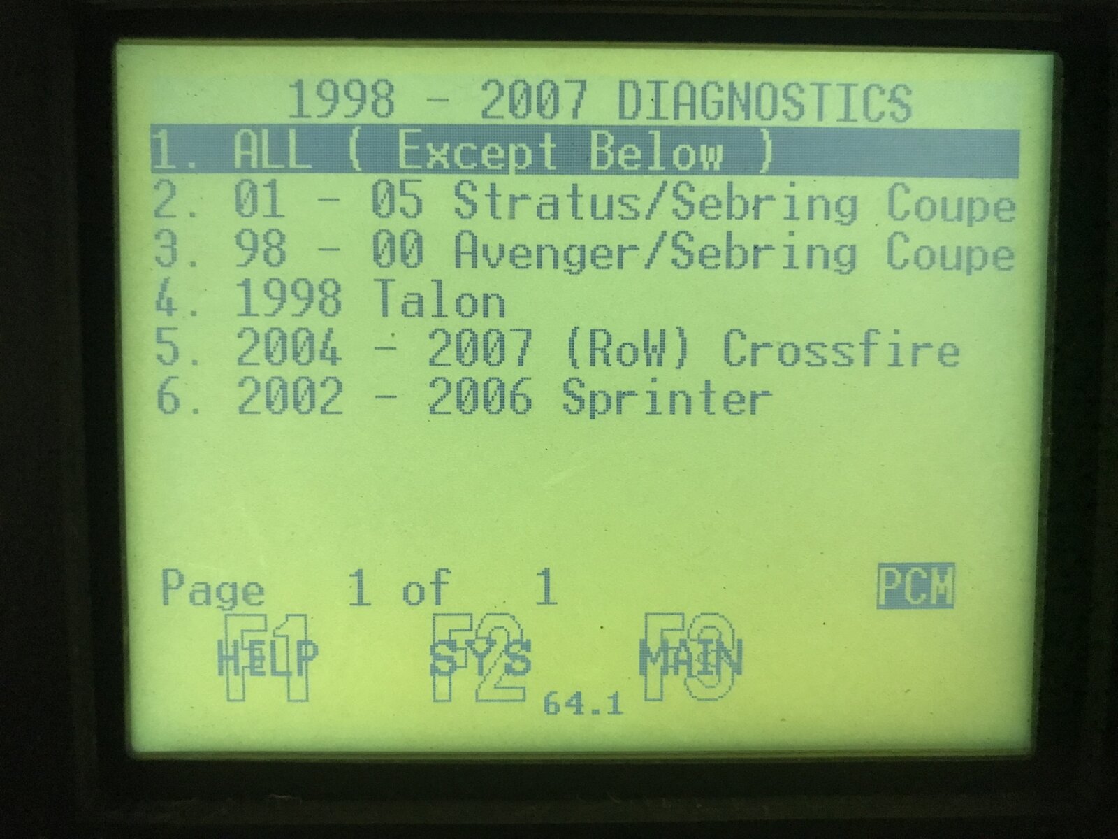

Now, select Option 1 – “All ( Except Below )” from the 1998 – 2007 Diagnostics Menu:

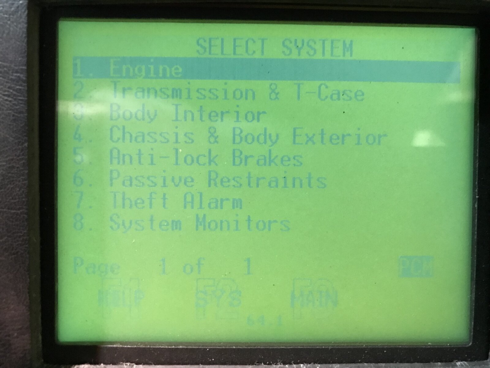

Next, select Option 1 – “Engine” from the Select System Menu:

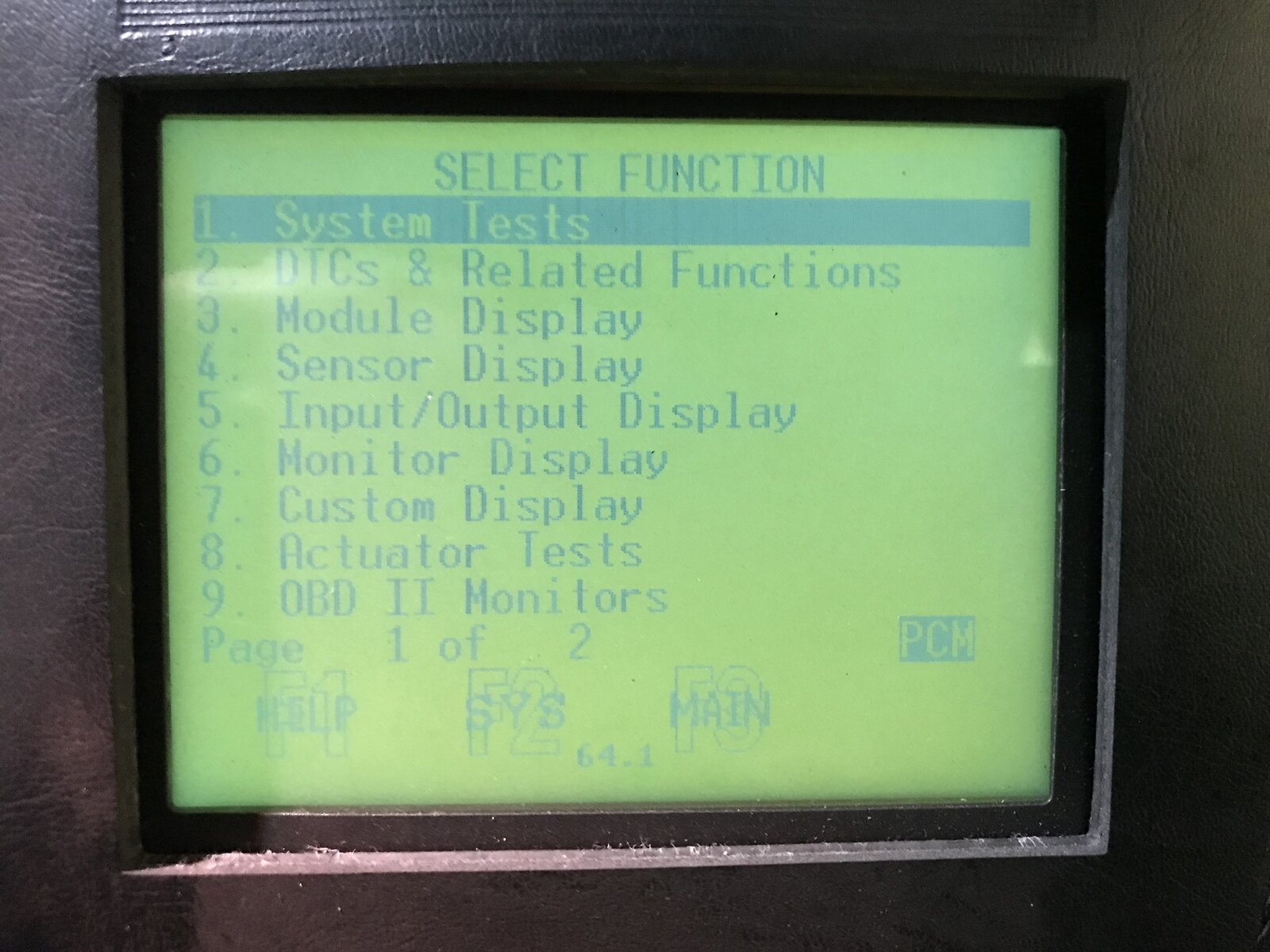

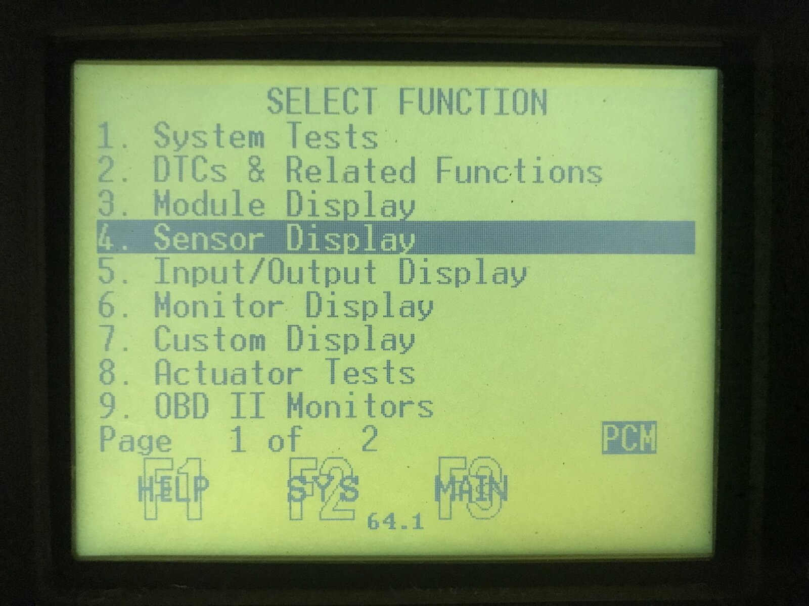

The next menu – Select Function – is actually two pages:

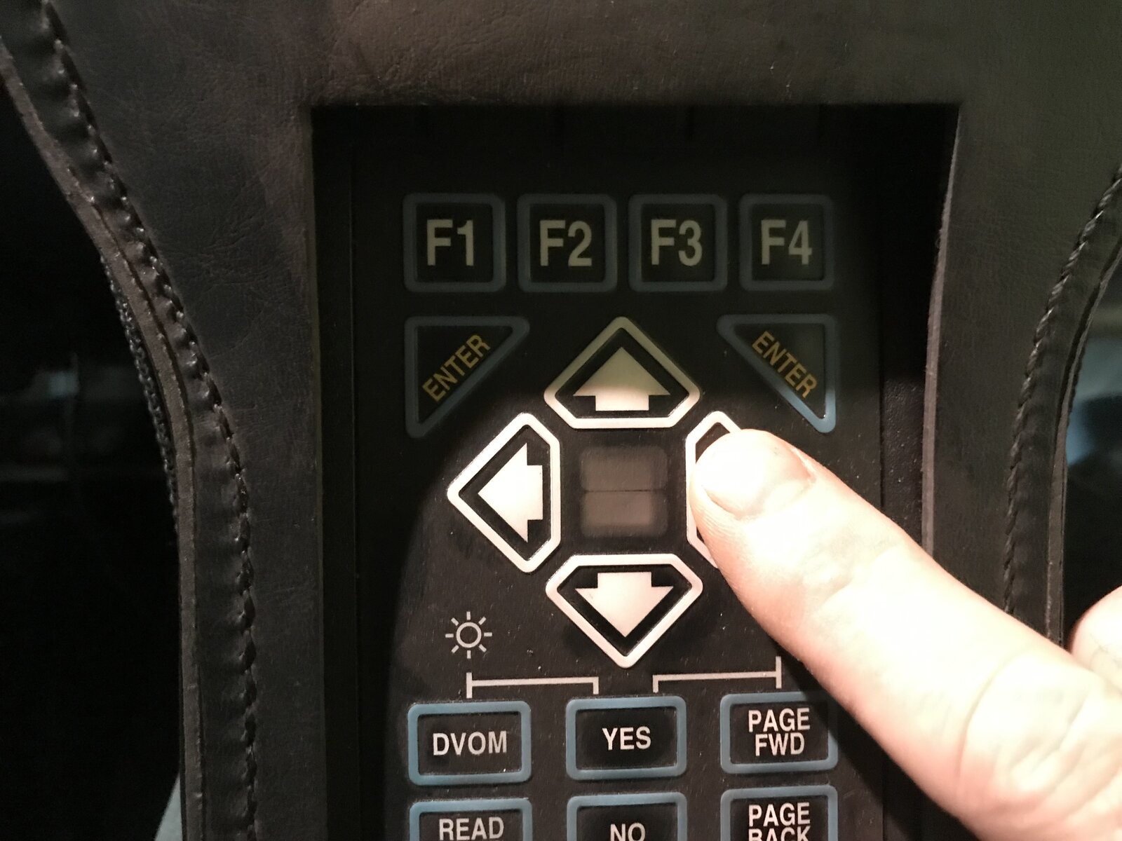

You need to press the right arrow key (shown below) to get to the second page for the next selection:

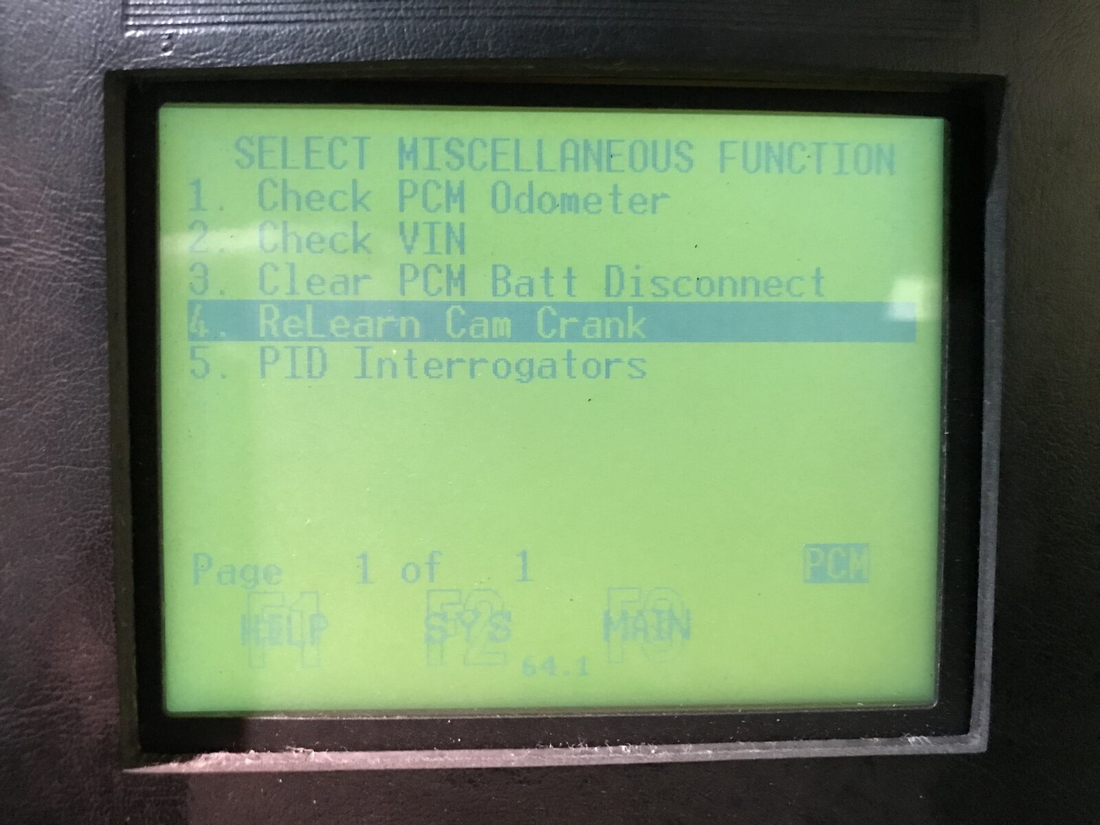

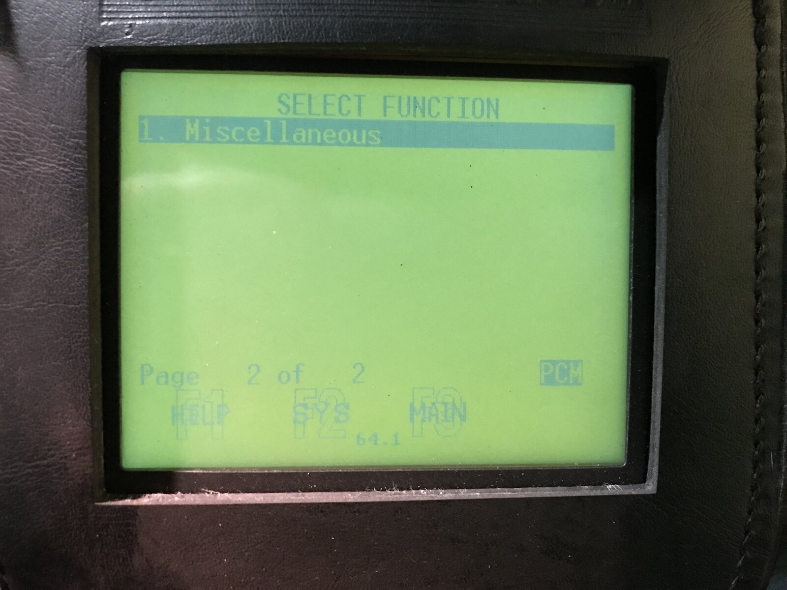

On the second page of the Select Function Menu, select Option 1 – “Miscellaneous”:
And on the Select Miscellaneous Function Menu, you’ll finally see the “ReLearn Cam Crank” function as Option Number 4. Select it:
After this, you can exit all menus (use the “Page Back” button) and just drive your TJ. The PCM will automatically do its thing.

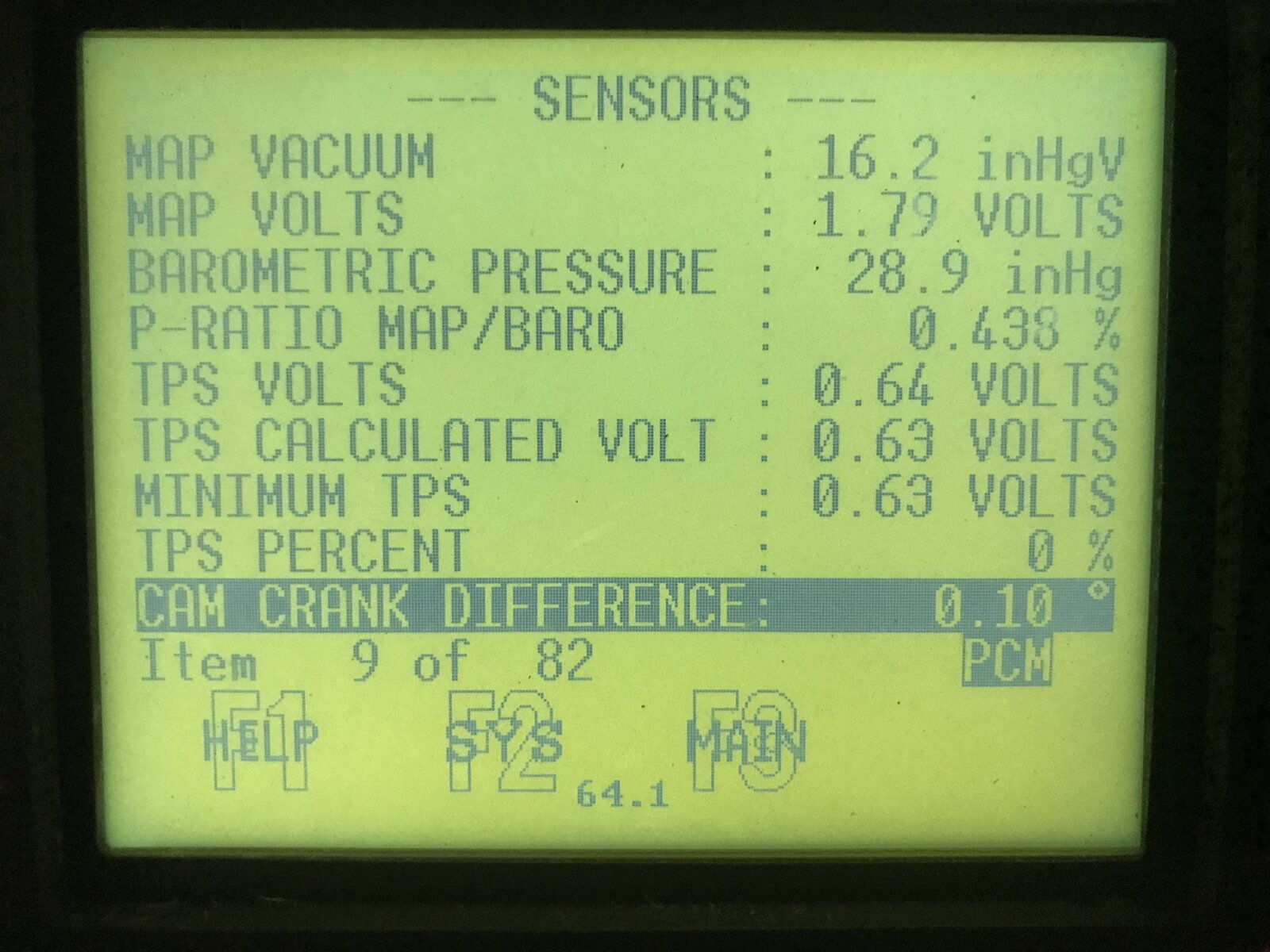

Instead of just doing it blindly, there is an output in the diagnostic data stream that may be helpful. It’s called “Cam Crank Difference,” and it’s measured in crankshaft degrees. As with the JTEC+ PCM’s “SET SYNC” procedure, this value should be set to zero (or as close to it as possible). Again, I have not tried this myself, but I suspect that monitoring this value while rotating the OPDA (with the engine running and in closed loop mode), with the goal of getting it to be zero, will get your TJ running properly.

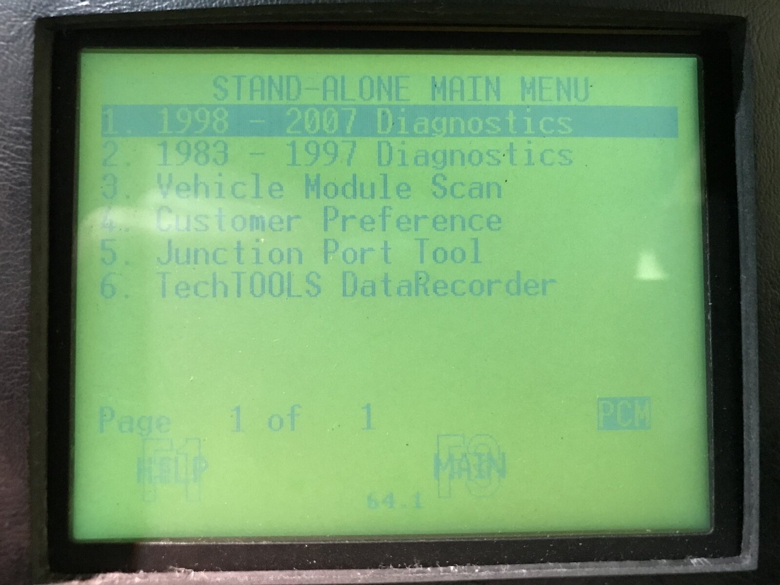

Here are the screen shots showing how to monitor this value, starting at the Main Menu (the highlighted menu item in each screen is the one to select in order to proceed):

... and one of the first things I did was check the cam/crank orientation and found it was 08°. The Autel scanner does also have Cam Crank Relearn in Special functions.
Are you saying that the Cam Crank Difference was 8°? Did you perform a ReLearn after reading that, and if so, did that value change?
That's a typo... It was 0.8°. Yes, I was able to rotate the OPDA and adjust orientation and the scanner then indicated the new cam/crank difference.

Long story short, I blindly turned the OPDA until I got into a workable range, then turned it in each direction to find the limits. I then adjusted the OPDA between the limits and have been driving it that way for two years. I don't recommend that method to anyone, but I was backed into a corner.
I'd like to further dial things in.
@AjRagno, it sounds like the bidirectional information allowed you to rotate manually closer to 0*.
Does the relearn process allow the PCM to view the -.05* difference as 0* (synched) instead?

Yes, rotating the OPDA will change the cam/crank orientation and the new orientation will be displayed in Live data. Live data also indicates whether or not the cam/crank are in sync and separately indicates the difference in degrees.
