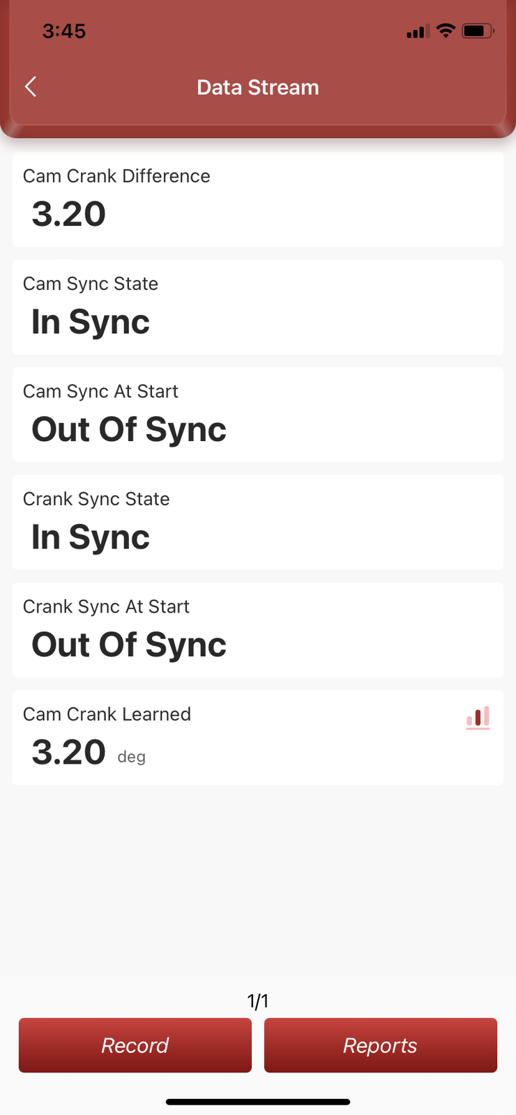

Hooked up the Thinkdiag2 to my 2005.
I’m not sure what to make of the following info.

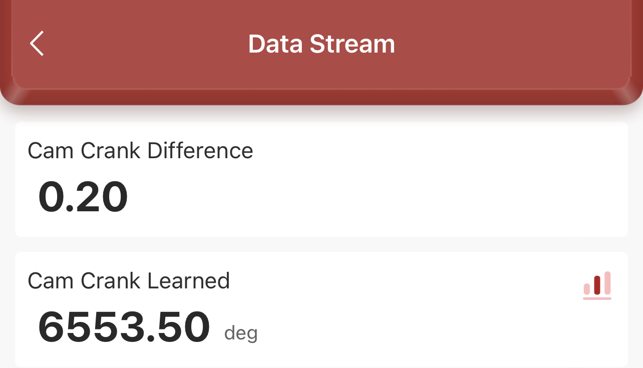

Hmmm. I suspect it's got the wrong equation to decode from hex.
6553.5 just happens to be what you get from a maxed out 16 bit data type scaled by 0.1x. That's a pretty damn big coincidence.

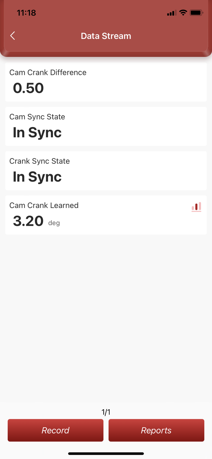

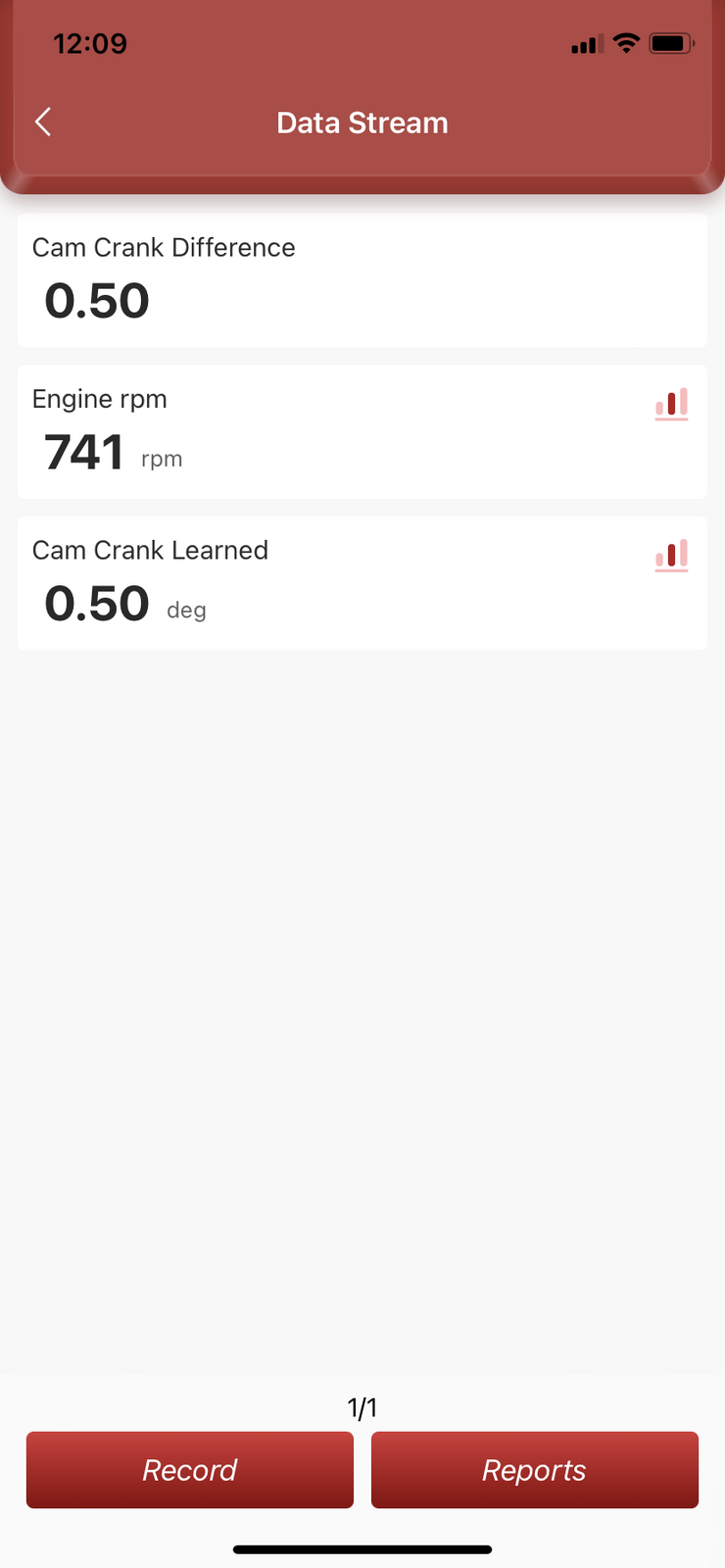

I think freedom_in_4low is on the right track. When I was fiddling around with mine I was trying to get the Cam/Crank Difference as close to zero as possible. I had the engine running and was monitoring the Cam/Crank Difference and delicately rotating the OPDA. I got down to a difference of 0.5 and thought I could better. I rotated it just a little bit more and the number changed to a 65xx.xx number (sorry I didn't take of pic of what the actual number was). So I realized I went the other side of zero......I rotated the OPDA back the other direction until I got back to the 0.5 degree difference and locked it down there.
Hope that makes sense.

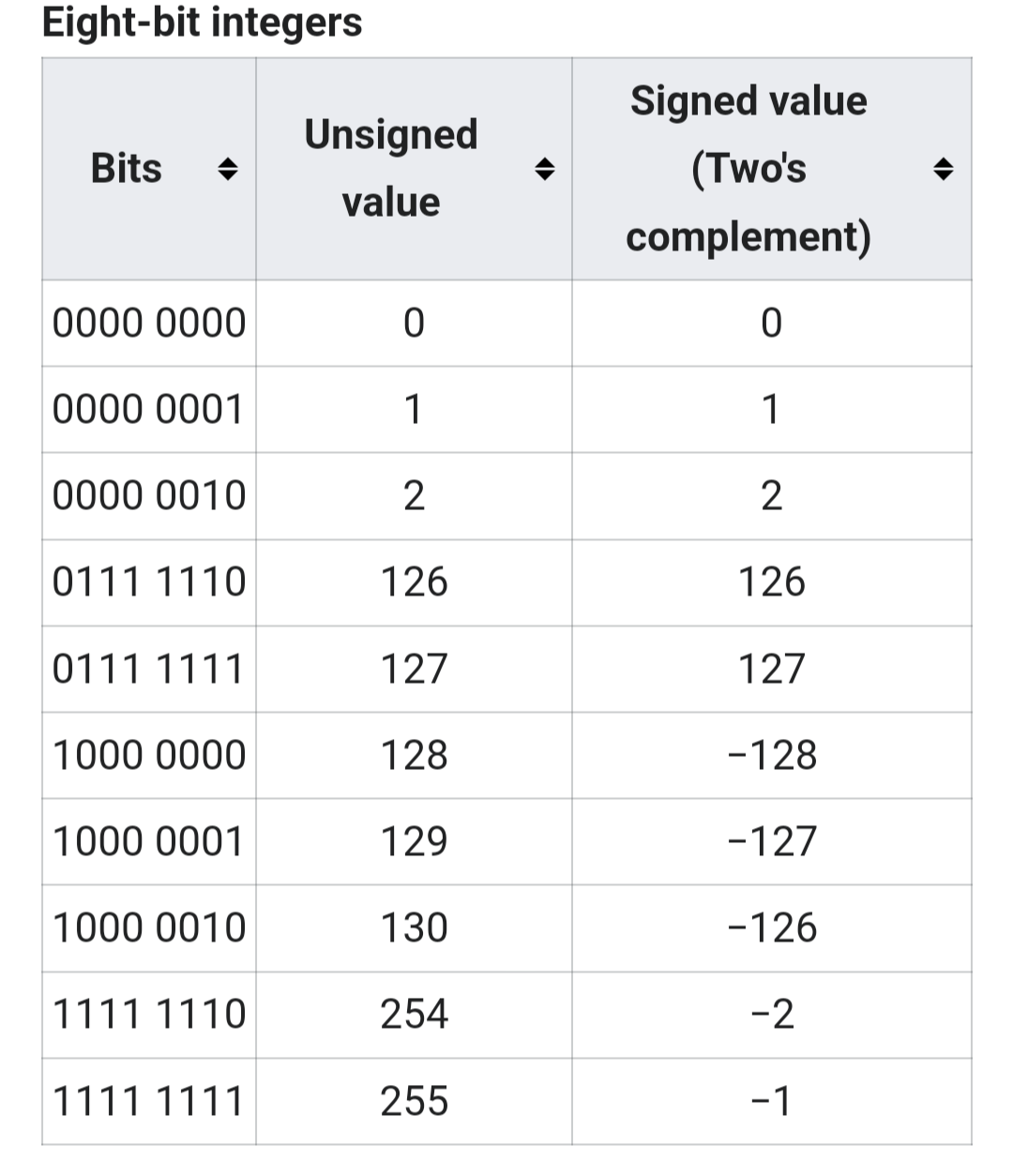

Very interesting. It's behaving exactly like a signed/unsigned data type mismatch.
"Two's complement" is an encoding method that allows for a signed (positive or negative) integer to be represented by an unsigned (always positive) integer. Basically the bottom half of the number space is unchanged, but the top half is for the negatives. When you go from zero to -1 it wraps around to the max value.
This is an example of how it works with 8 bits, but extending it to 16 bit, 1 through 32767 = 1 through 32767, 32768 = -32768, and 65535 = -1
So it looks to me like the PCM is providing a two's complement signed value that thinkdiag2 is interpreting as an unsigned integer, causing negative values to wrap back into the top end of the space.

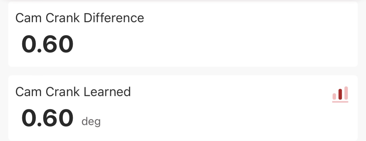

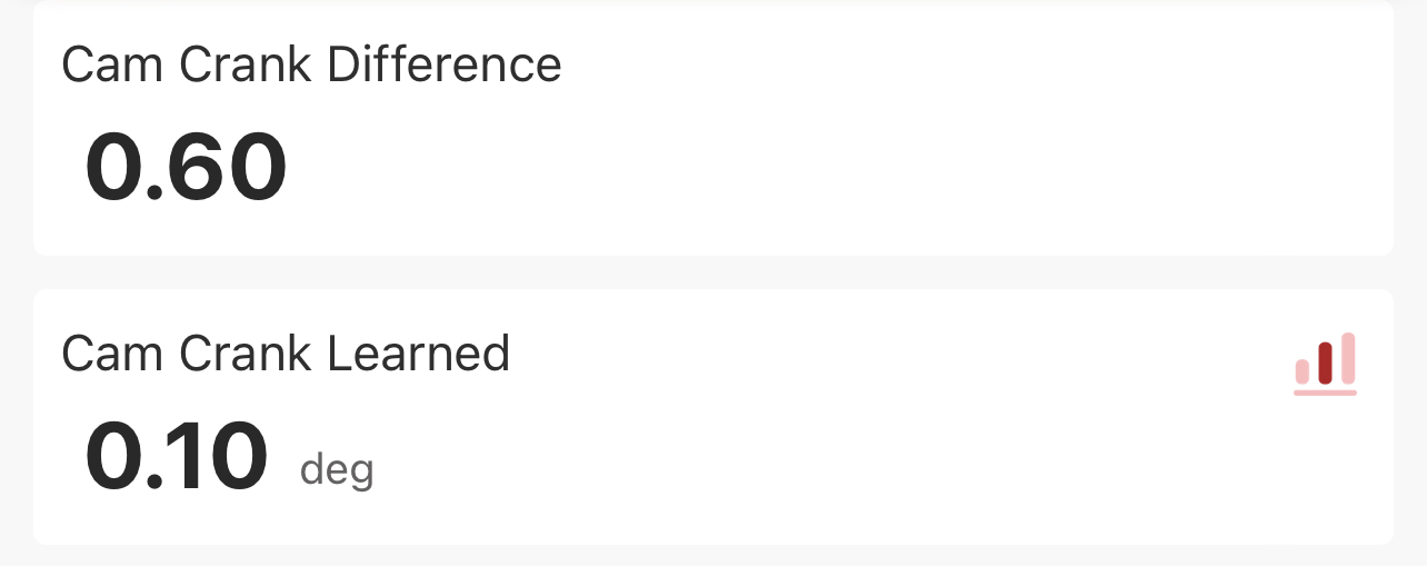

I adjusted my difference to .20 but the relearn would not budge from 6553.5 using the device or touching the cables.
I then adjusted the difference out to .70. At first, I couldn’t get the relearn to budge with the device or by touching the cables.
After multiple tries, the relearn changed to .10 degrees.
Thanks for helping me get things dialed in.

I dialed in the difference so that it was less than than 0.8* but at least 0.5*…by turning the loosened OPDA and watching the difference using the device app on my phone. After tightening the OPDA back down with a reading of 0.7*, I did the manual relearn.
