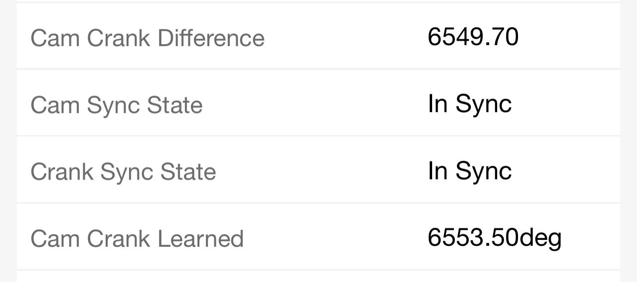

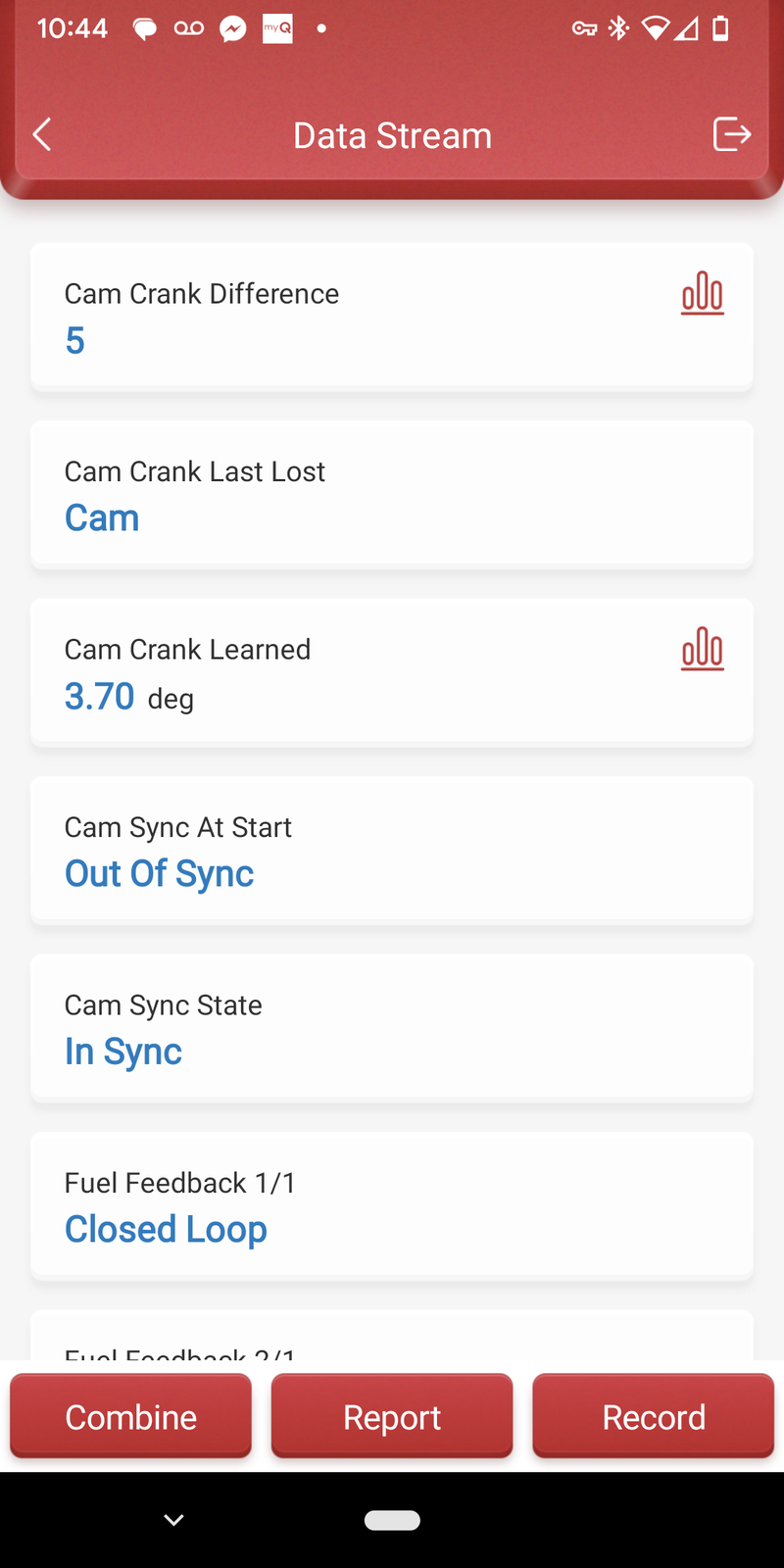

Hooked up the Thinkdiag2 to my 2005.
I’m not sure what to make of the following info.

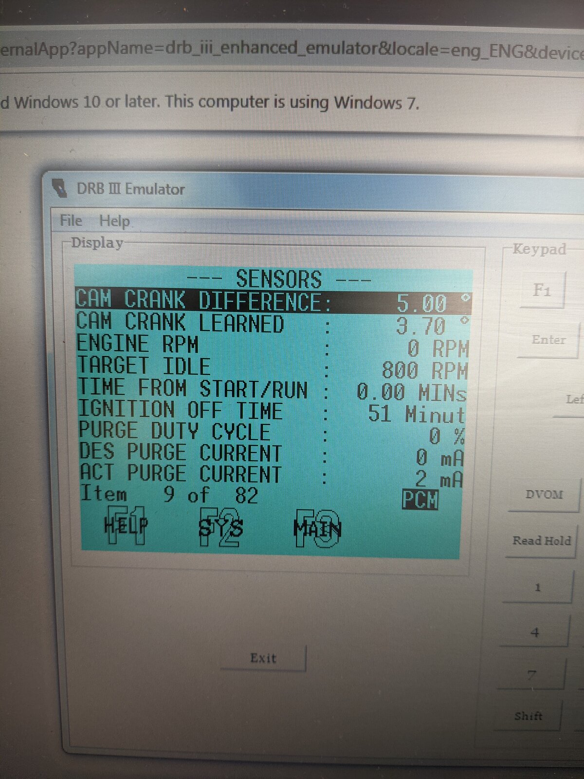

So because this called the entire thing into question for me, I wanted to compare it to a known-good reader.
My micropod2 and my $35 eBay windows 7 laptop arrived late this week I got that set up this morning.
Thinkdiag2:
So the values match. (I ran the DRB3 with engine off so 5.0 is the last stored value, and the thinkdiag2 was wobbling between 4.9 and 5).
So the only issue is that the thinkdiag2 isn't programmed to correctly interpret negatives. I might submit a bug report and maybe they'll fix that in a future version.
Thinkdiag2:
Thanks for confirming the readings. My Thinkgiag2 also bounces back and forth by 0.1 on the cam/crank difference, so I assume it’s pretty sensitive (which I consider a good thing).
I forgot to mention that I briefly reported the negative values (coding) issue to the seller on Amazon and sent them a couple of screenshots.
It might be worth reporting it as well so they take it serious.

6553.5 would be -0.1, 6553.4 would be -0.2, 6552.5 would be -1, and so on. I'm not sure there's any downside to the difference being negative, but it would definitely be easier to keep it positive so you're not having to convert it in your head in real time. If you have it synced as close as you can to 6553.5 and your DTC is gone, I would leave it be.

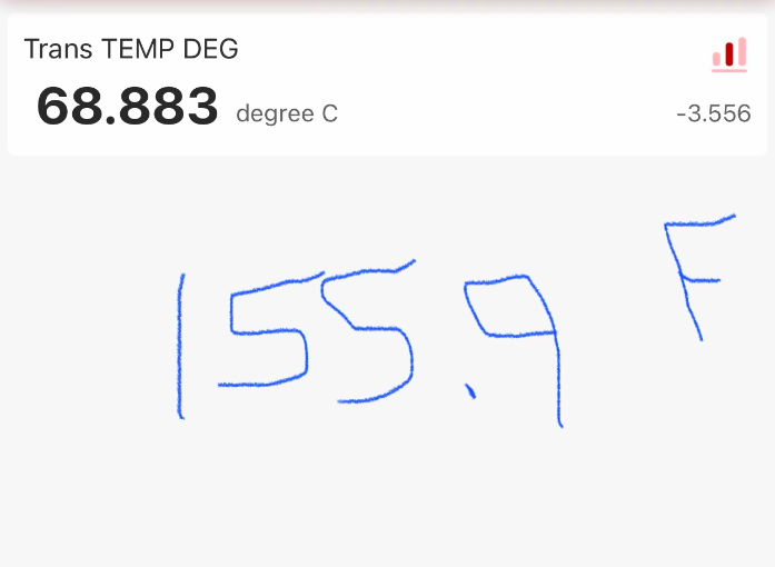

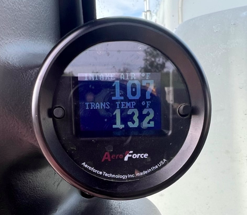

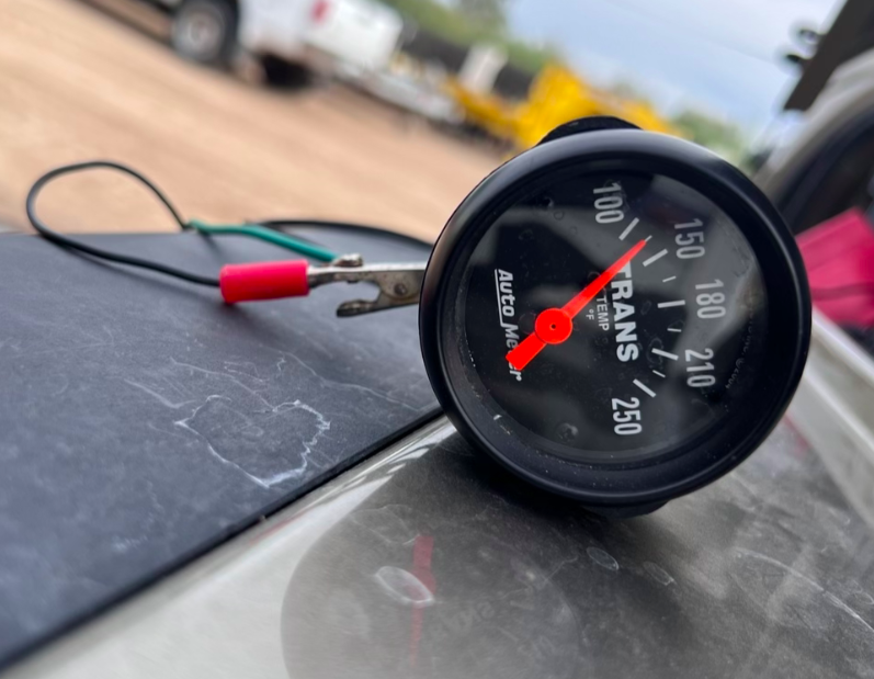

If anyone else has a thinkdiag2 and a separate temp gauge for their 42RLE, I'm curious how your trans temp readings compare.
The TCM data stream function of my thinkdiag2 reads high by about 20* when compared to my aeroforce gauge (reads off the PCM) and my analog Autometer gauge that I hooked up to verify which gauge was correct.

Edit: I let the thinkdiag2 folks know that their trans temp reading is incorrect.

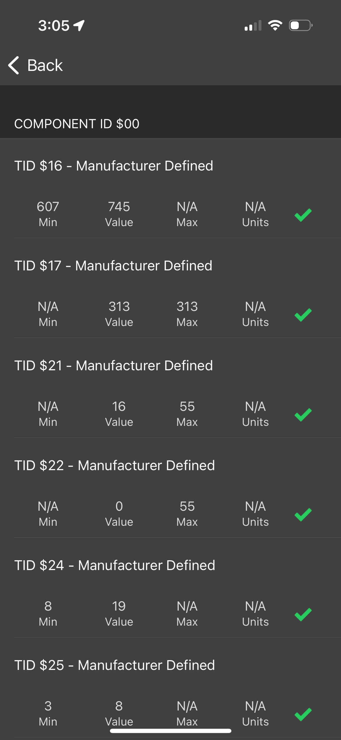

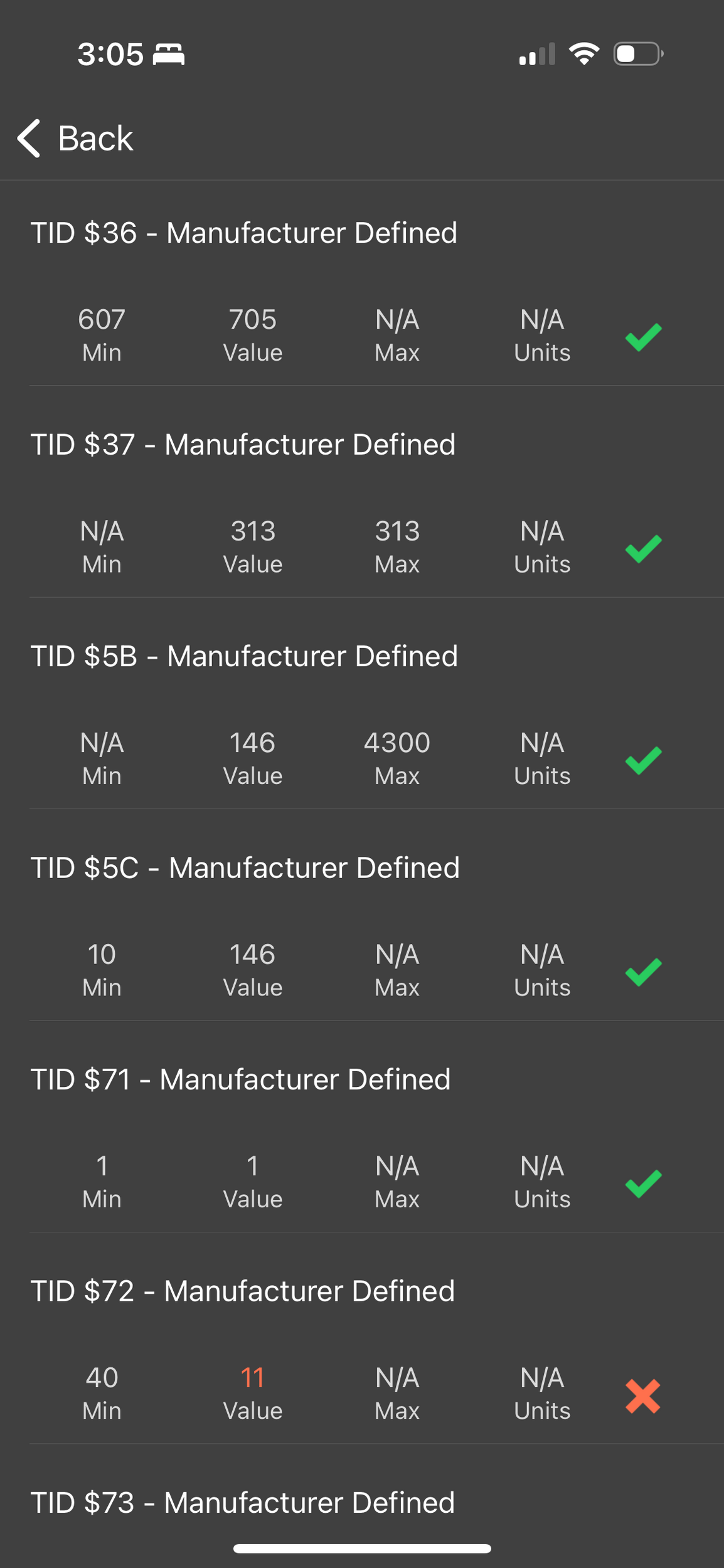

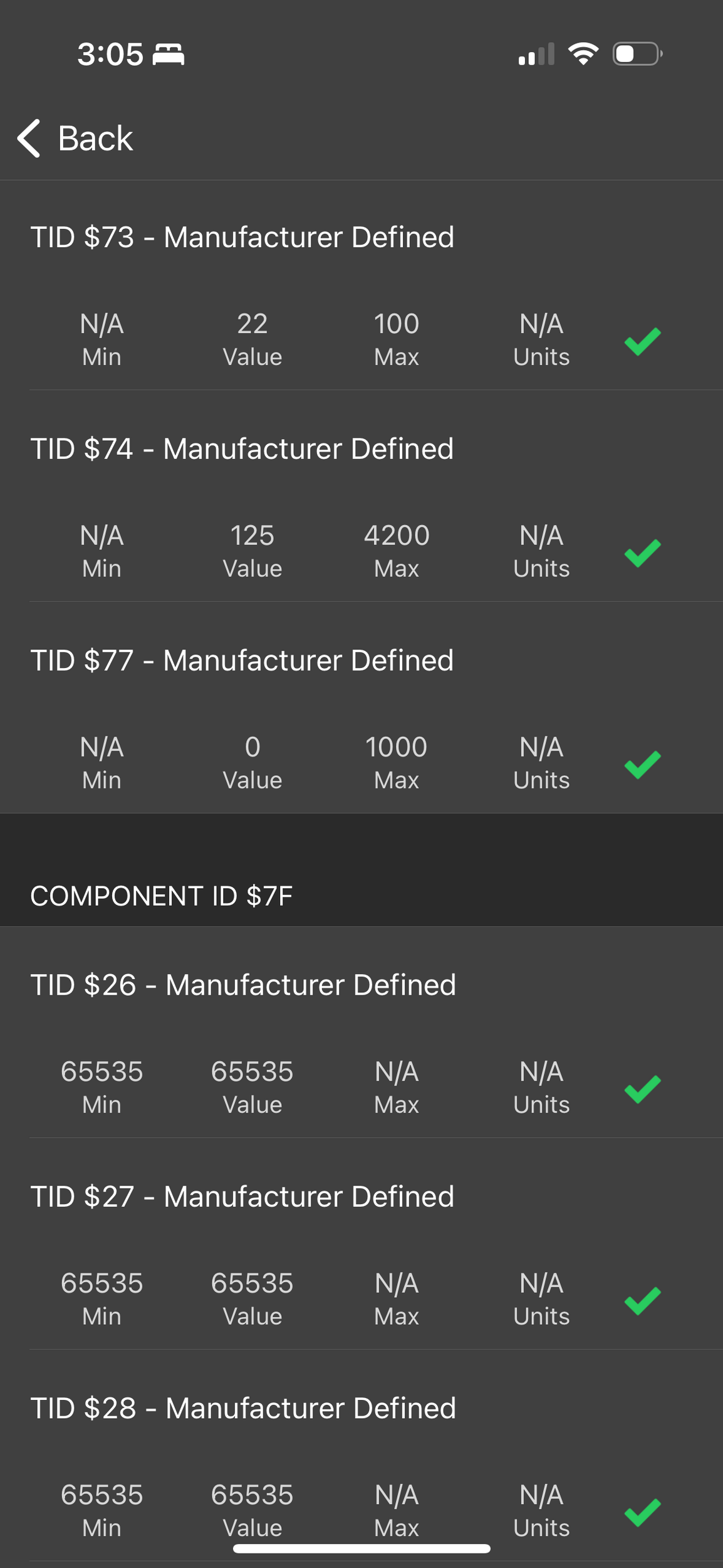

Could the Cam Crank values be shown in the Mode $06 data on OBD2? I see around 15 values, but they're all integers. Maybe the scan tools scale them somehow?
Definitely could be. All the values come through in binary, so if they're 16 bit their decimal equivalents will be 0-65535 and it's up to the tool to correctly interpret that into a number that makes sense to humans.
I looked into this a bit last year but never was about to find the definitions for the mode 6 values.
I was hoping one of the non-Jeep tools let the TIDs slip somehow.
