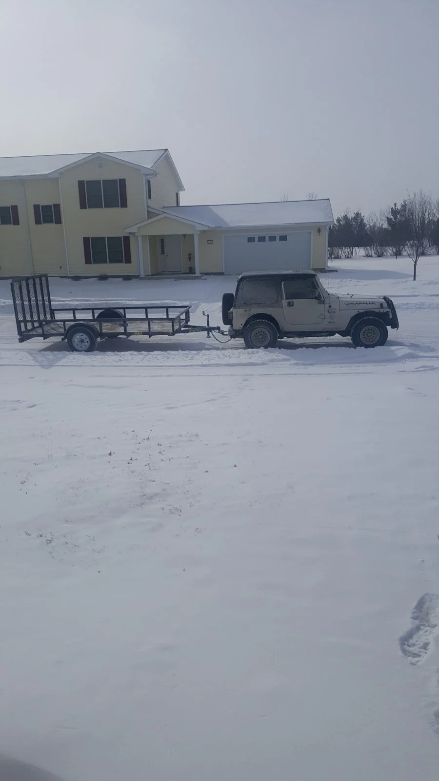

    In about 3 and a half weeks I'll be towing a decent sized trailer 1000 miles with my jeep. Guessing the weight will be around 1500. Does anyone have any experience with this? How much slower do I need to drive on the freeway? Jeep is running great and I have brand new BF Goodrich Ko2 31's on it. Jeep is an 05 4.0 sport 2 door. I towed the trailer empty when I bought it and it towed just fine even at highway speeds. Trailer is a 12'x77" single axle open trailer. 20180220_122757.jpg

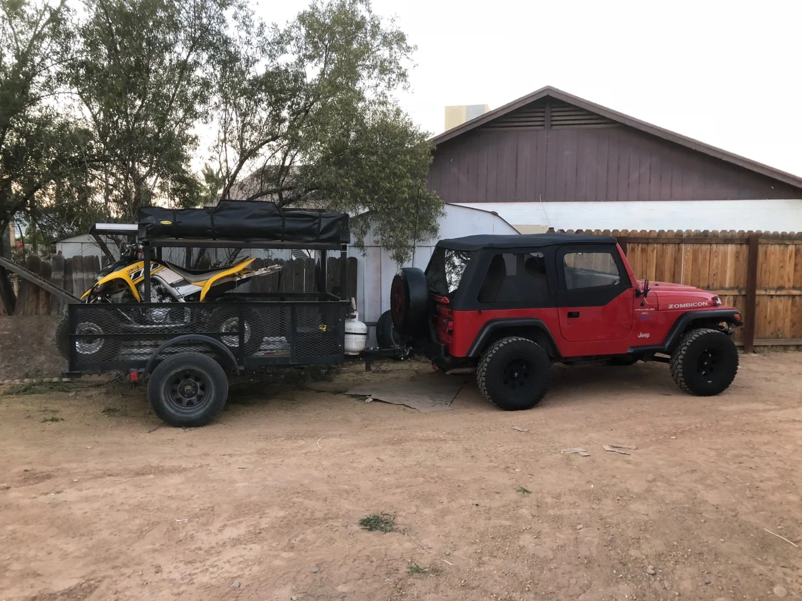

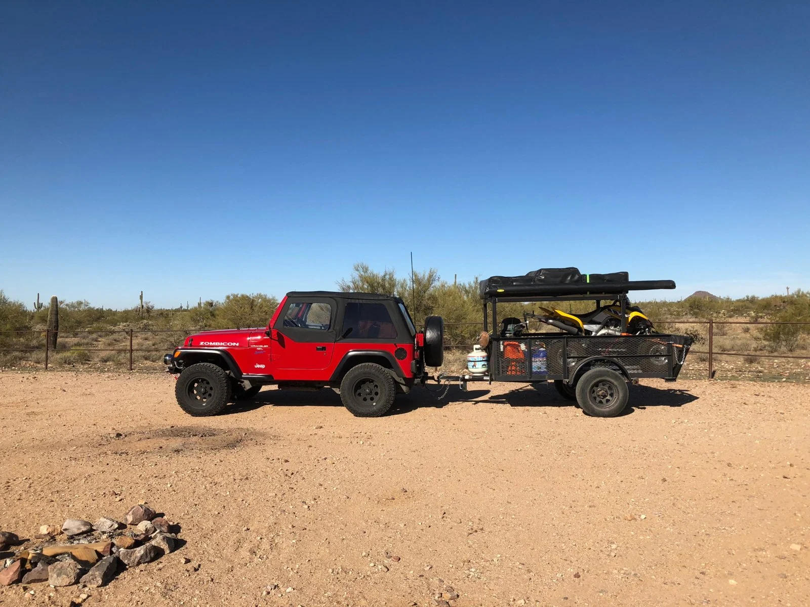

    I just towed this about 120 miles with no issues a couple of weeks ago. I think it is about the same weight as you are saying. I would give myself more room to stop, and all of the other stuff, but the TJ took it like a champ!

    How's the gas mileage with the 4.0 and a trailer?

    I can not lie it is pretty horrific. I didn't actually calculate it, but normally I get about 13 with the A/C on, and it was considerably less than that.

    Assuming your trailer has electric brakes, check them and make sure they're working properly. The biggest problem you can encounter is slamming on brakes and then the trailer becomes the "tail wagging the dog".

    Max tow is 2000lbs for the TJ; 200lb on the Hitch. Load 60% weight I n front of axle and 40% behind. Leave room for braking. Should be no problem!

    Doesn't have trailer brakes but I'll definitely be taking it slow.
