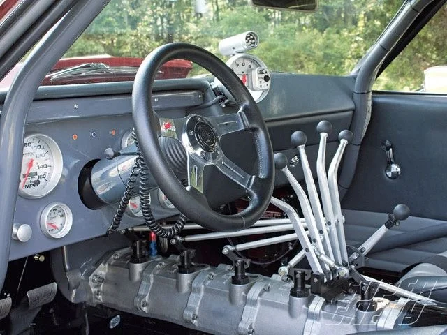

You mean like one of these 10 speeds with 10:1 first?
They're only 5-600lbs....

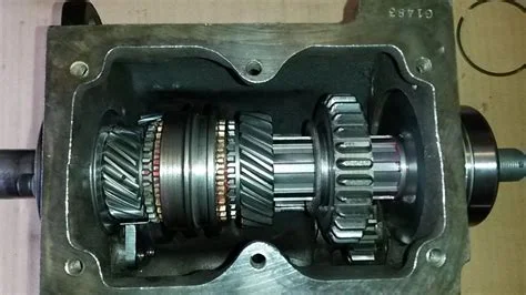

Or go old school and install a T-90 , the weight is only 64 lbs. ;)

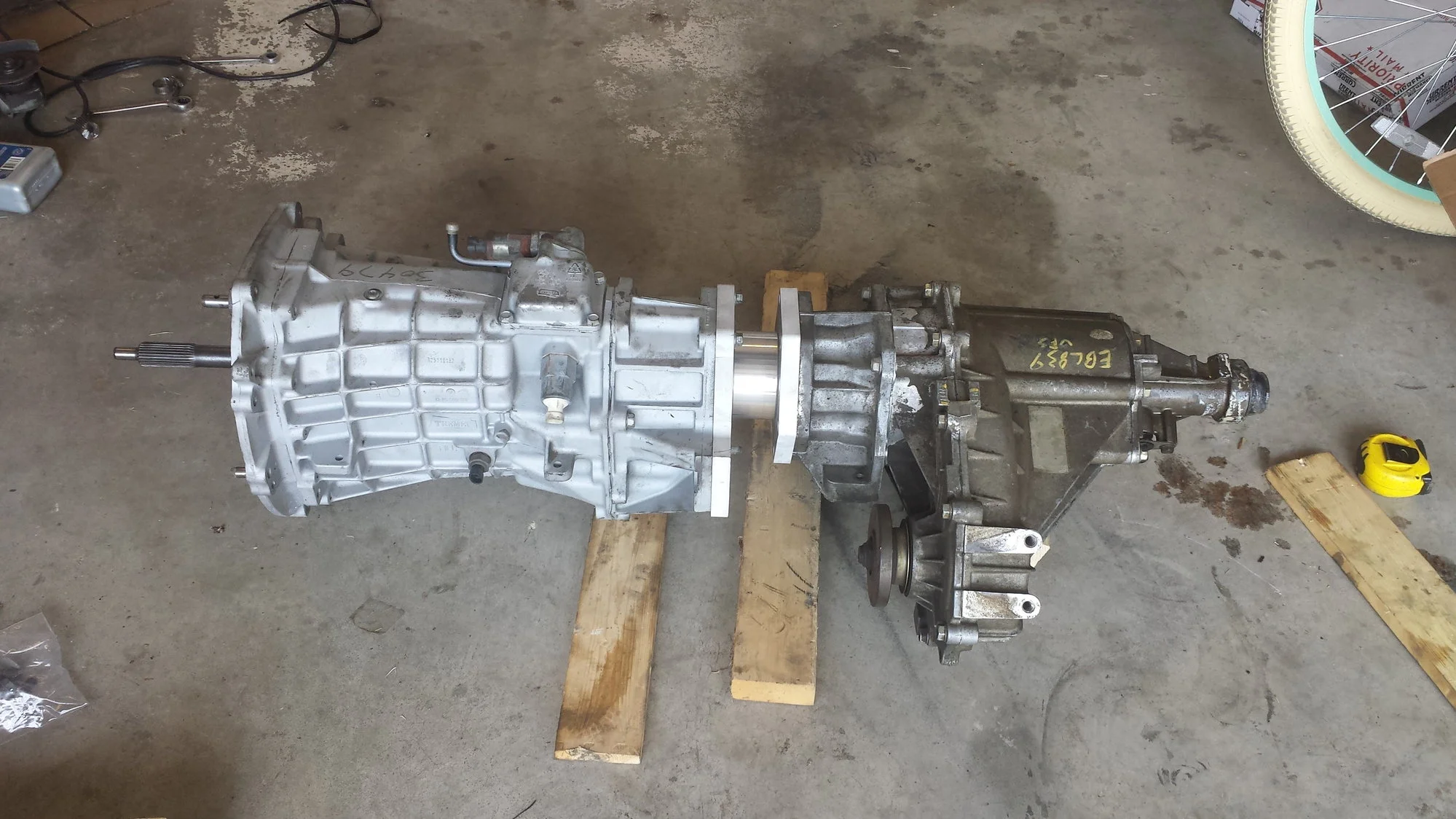

Stumbled across this thread picking up the research for my own LS/manual swap. I will not be doing any serious offroading (mostly sand and silty mud here) and will have a max 33" tire but will have a bit more power with a mild heads/cam LS1 (5.7L). I have had a NV3500 in my '95 C1500. It was not the best shifting transmission but didn't give me any issues regardless of how hard I was on it. Still, it shifted as well or better than the current AX5 in the jeep which acceptable so it is currently the front runner in my choices, mainly due to cost. I have a line on a 2wd from a C1500 so the hybrid NV35xx may be the route I go. I have also considered the full drive train from a K1500 with the NP241 case since it is also a driver side drop. However, I have not been able to find a good measurement of the total length to see if it will fit.
Base on how I plan to use this jeep and the way I drive, the TR4050 is really the route I would like to go. I could get over the high initial cost of the unit but the seemingly proprietary clutch from SST are swaying me against it.
I am also intrigued by the 4x4 T56/TR6060 but in talking to a few conversion shops at shows, it seems to be too long of an assembly for a TJ. If anyone here knows other wise, I would love to hear it.
.I am also intrigued by the 4x4 T56/TR6060 but in talking to a few conversion shops at shows, it seems to be too long of an assembly for a TJ. If anyone here knows other wise, I would love to hear it.
TR6060 puts the shifter a bit further back Vs a T56
For a visual reference go here
https://www.bowlertransmissions.com/which-6-speed-is-the-best-for-my-project/
