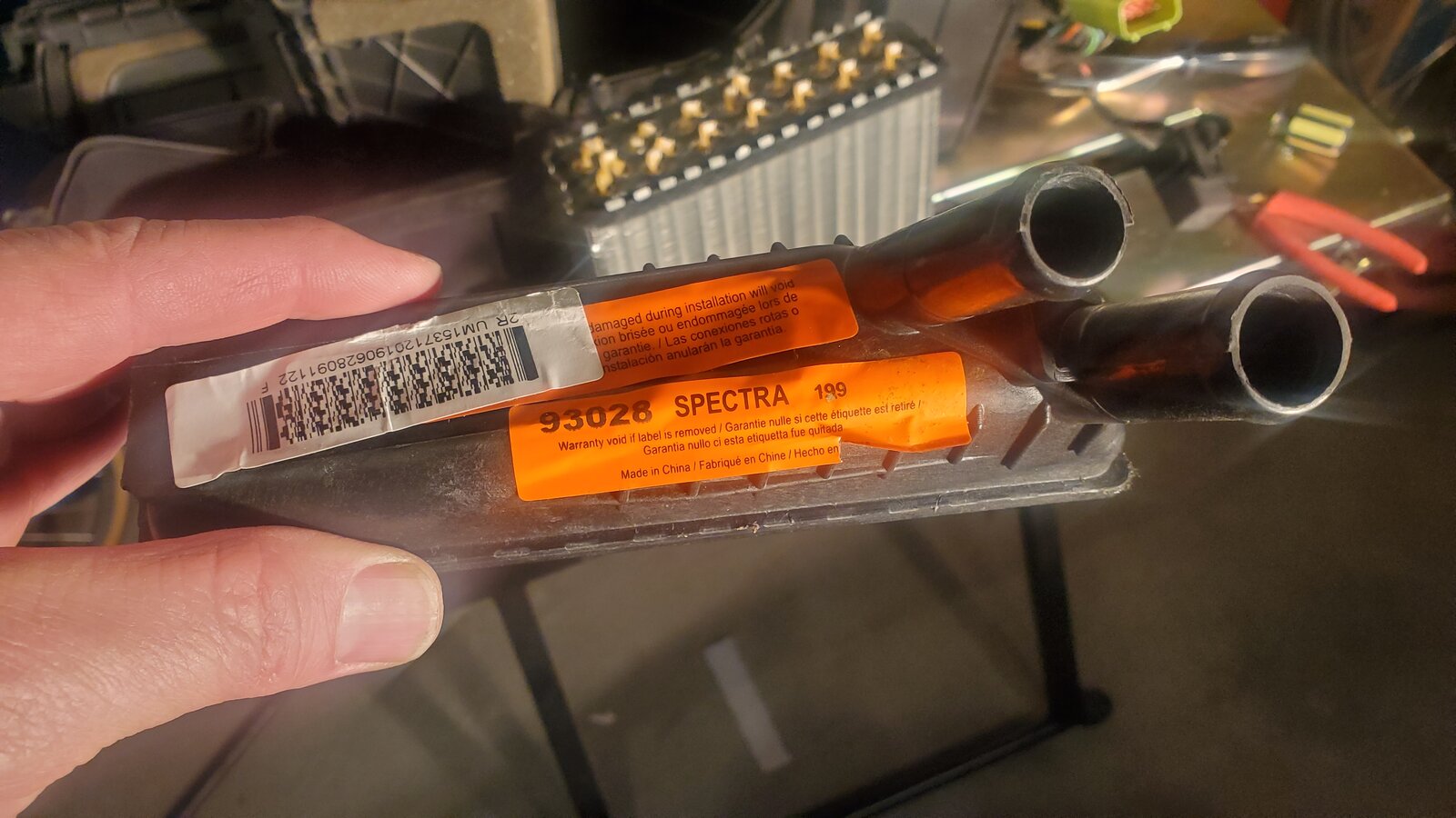

Final (hopefully) update: So I got another heater core from Rock Auto. I tried a couple small experiments to try to see if there was any significant difference between new heater core #1 and new heater core #2, but I didn't see anything that made me sure that new core #1 was defective. I decided to just dive back in and swap it. Getting the dash off and HVAC unit out is much quicker the 2nd time! With the new heater core in, and the HVAC unit back in the Jeep, but not even fully bolted in, and the dash just moved close enough to make all the connections to run the heat, I started the Jeep and bled the cooling system again. And the heat immediately went right to 160 degrees (my thermometer was closer to the heater core at that point) So, I reassembled everything and ran the Jeep again and I have 140 degrees at the vents. So, it was new core #1 all along. I don't know whether I want to return it to get my 36 bucks back, or disassemble it to find out what is wrong with it.

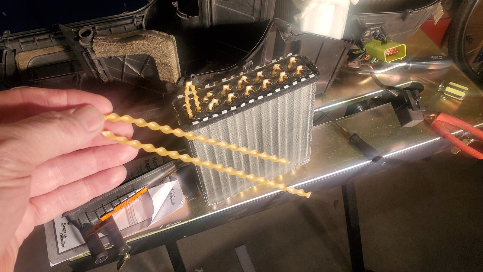

Do it for science! If for nothing else so they won’t sell it to someone else.
There are plastic corkscrews inside the passages. Maybe one of them is wonky?
