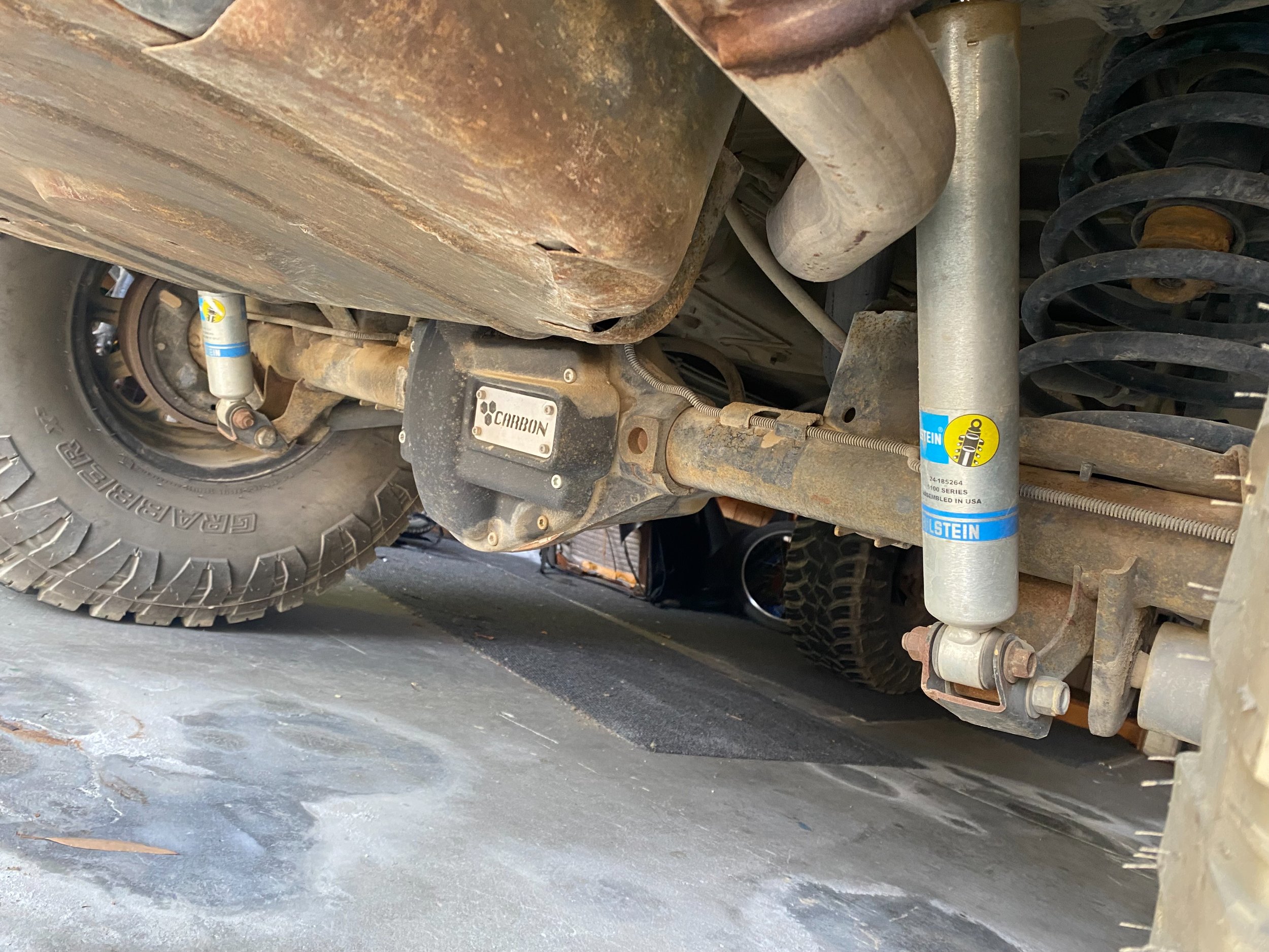

Does anyone think these Bilstein rear shocks are making the ride more stiff? The front end - with sway bar disconnected - definitely feels more supple and loose than the rear end. Maybe I should take the bilstein's off?
You most certainly have an issue with the shocks.
You think the expensive fancy shocks make the ride worse, or better?
Most definitely better, but you don’t need 600 dollar a corner shocks to have a good ride. You do need to pay attention to your build though, and get it set up correctly.

I guess this is all mostly stock, huh? Not very good for comfort? What do people suggest? I am not a jeep expert, I am a weekend warrior looking to have some fun without breaking my back. What shock setup would be best for comfort without concern for "maximum" capability and performance?

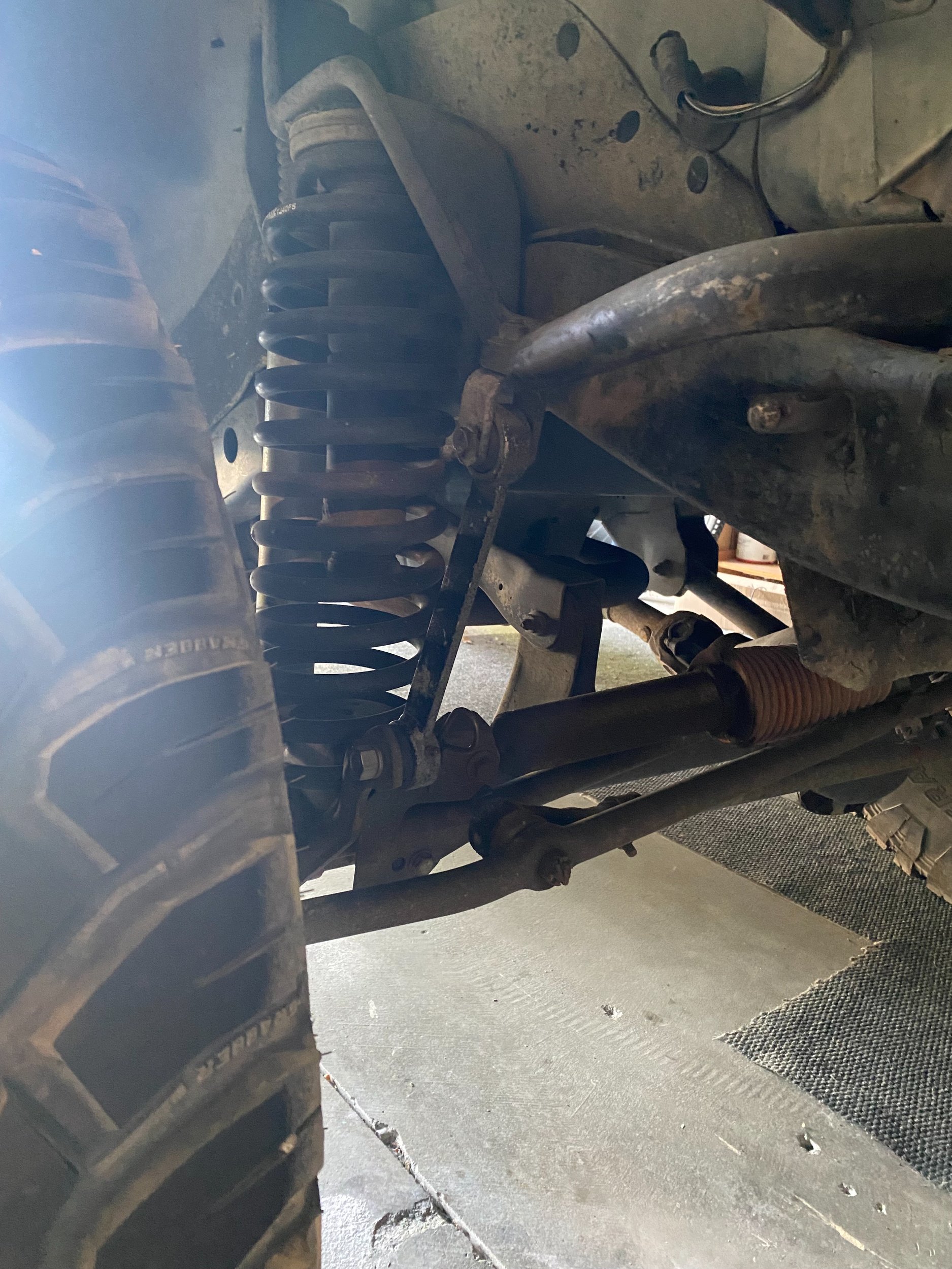

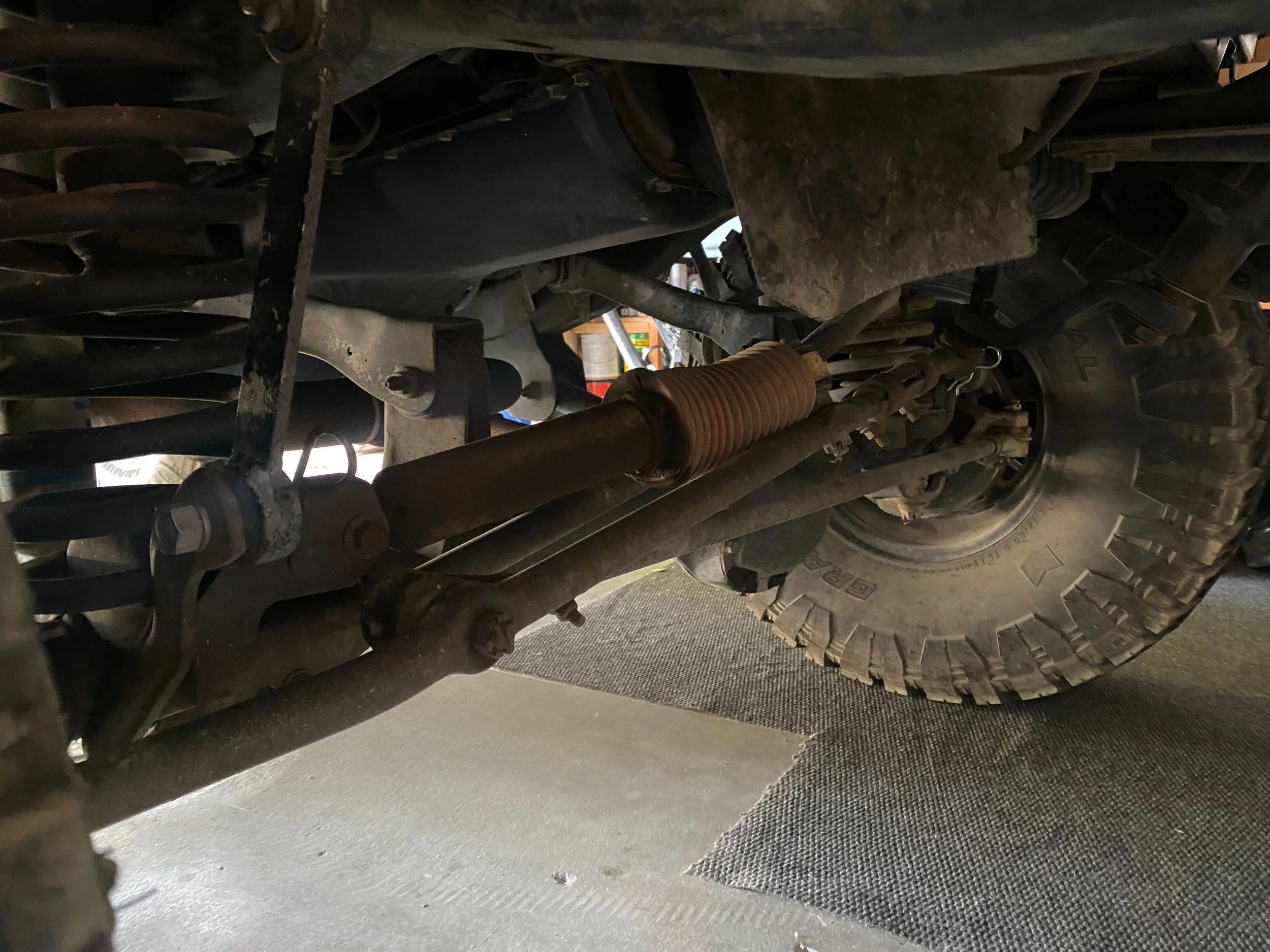

An important question that none of your pictures show is how much shiny shock shaft is sticking out of the larger cylinder.
Reactions: StG58
About 5 inches.
On both the front and rear?
With the assumption that the remaining shaft inside the cylinder is about the same, that is a good start.
Your Bilsteins have a long reputation for transmitting small event harshness into the frame/body.

My jeep doesn't seem to have bilstein's on the front, only the rear, but I might need to look again.
and I dont think the small events is what is killing my back, I think it is more of larger rolling obstacles, let's say 8 inch rollers and ditches, feels very bouncy and like a yo-yo, especially the rear end, incidentally the rear end is where the bilesteins are...
