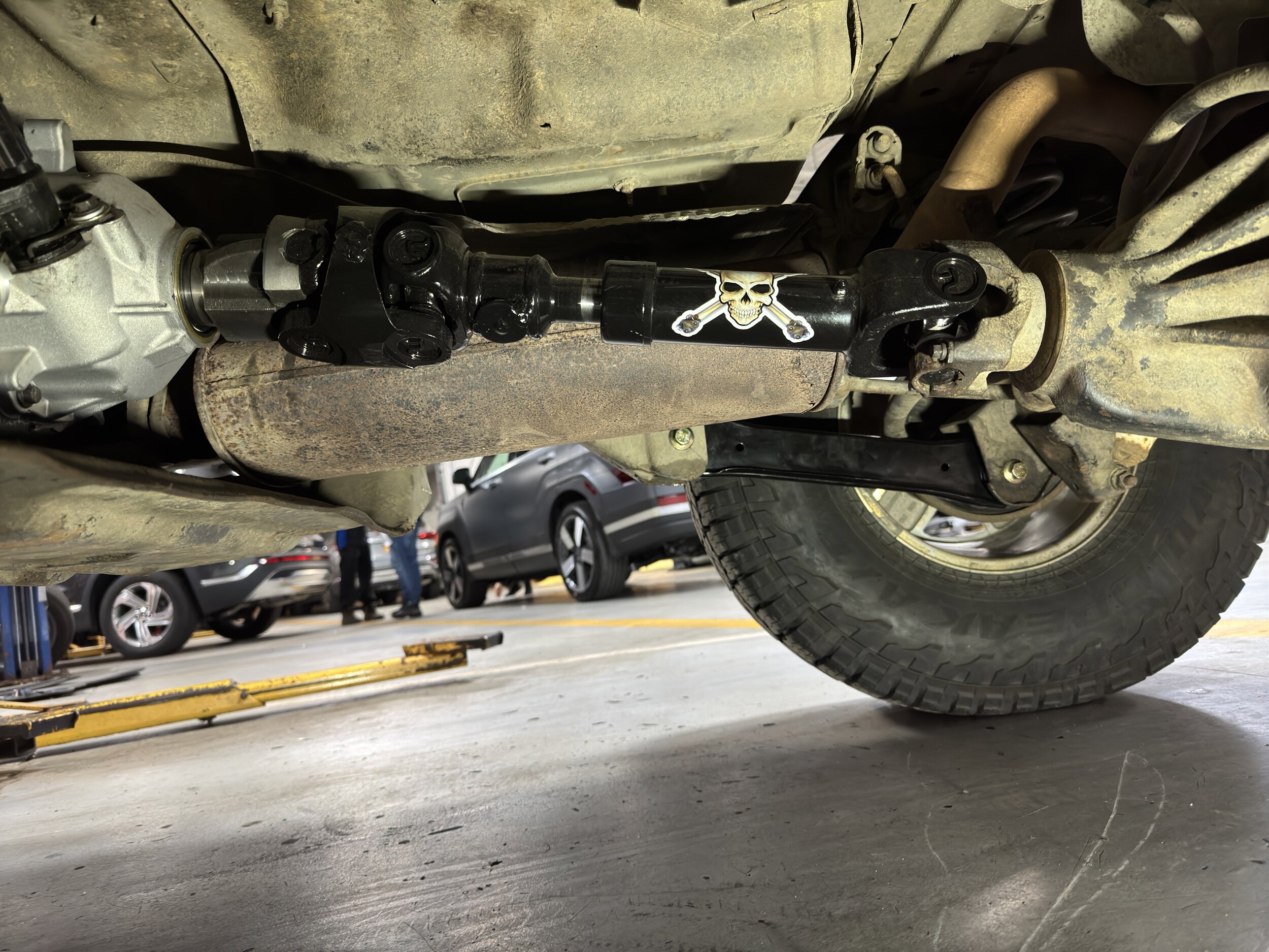

thanks Mac. I replaced the rear lowers with OEM. Greatly improved the ride except didnt effect the vibration. Also i replaced the track bars to center the axel a while ago. The shop is recommending JKS adjustable rear uppers. I assume because of the cost. i get some photos up too.

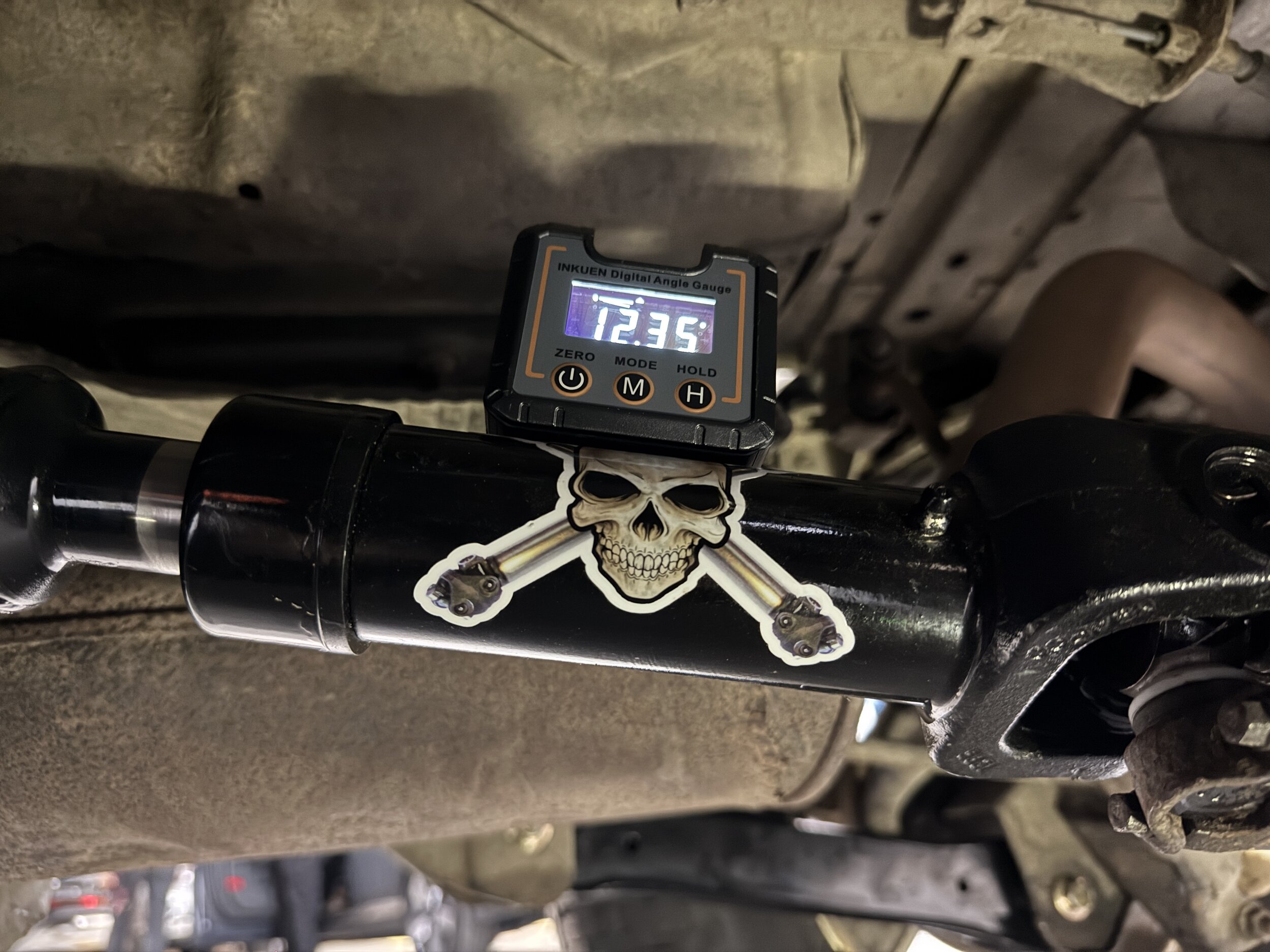

couldnt get the angle off the TC or the pinon tonight. i'll try tomorrow.
