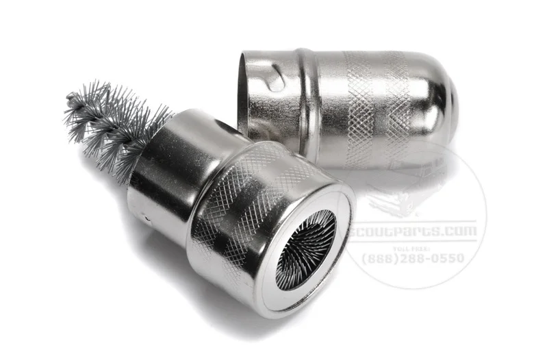

Remove both battery connections and clean the battery posts and the inside of the battery connectors with a wire brush. A battery brush like this sells for $4 or so and makes the job easy.
