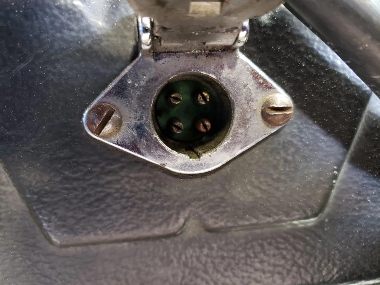

Does anyone have a working Warn 4-pin remote laying around they no longer need? I picked up a Warn 8274 a while back and it doesn't have the remote.

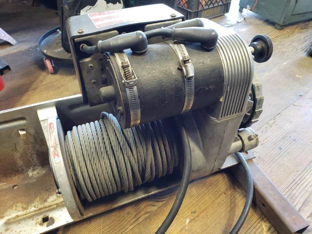

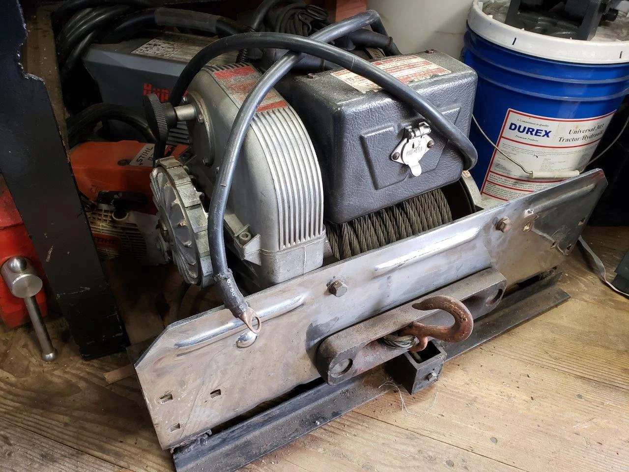

This is outside of my original thread title but what the heck, I'm here now. :)
I added a couple pictures that shows some kind of mount that makes removing the winch easier. Maybe for farm use or something like it?
I've never used the winch and bought it at a machinist equipment auction of all places. Since I don't know any history of use, I assume I should pull it apart, inspect and possibly re-grease.

Only real difference is the receptacle at the control pack. The newest remote that Warn uses has a D shaped plug and a rocker switch versus a toggle but they had the foresight enough to make sure it would work on the older round plug. That does give you the advantage of being able to use any newer remote if you have a problem with yours.

That is an interesting mount for sure. Couple things to check before you put it into service would be to make sure the brake is not stuck by holding the inner plate and rotating the outer which should move .75" or so. I would also pull the top housing and change the oil. Warn calls for SAE30 but if you have a Truck repair shop near by see if they would give you some Synthetic 50. You only need 8oz.
Your motor cables look a bit old so I will see if I can dig some newer ones up for you. Since @Wildman has a bag of terminal boots hit him up for some.
