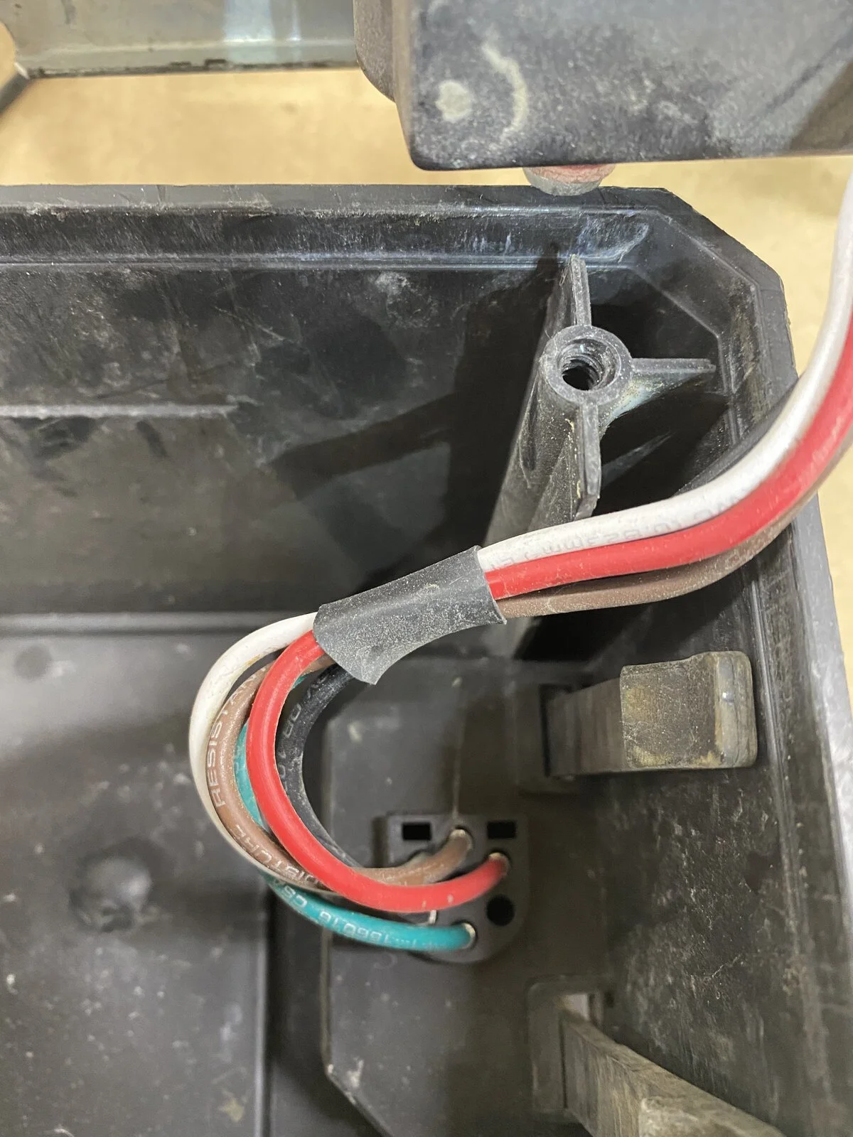

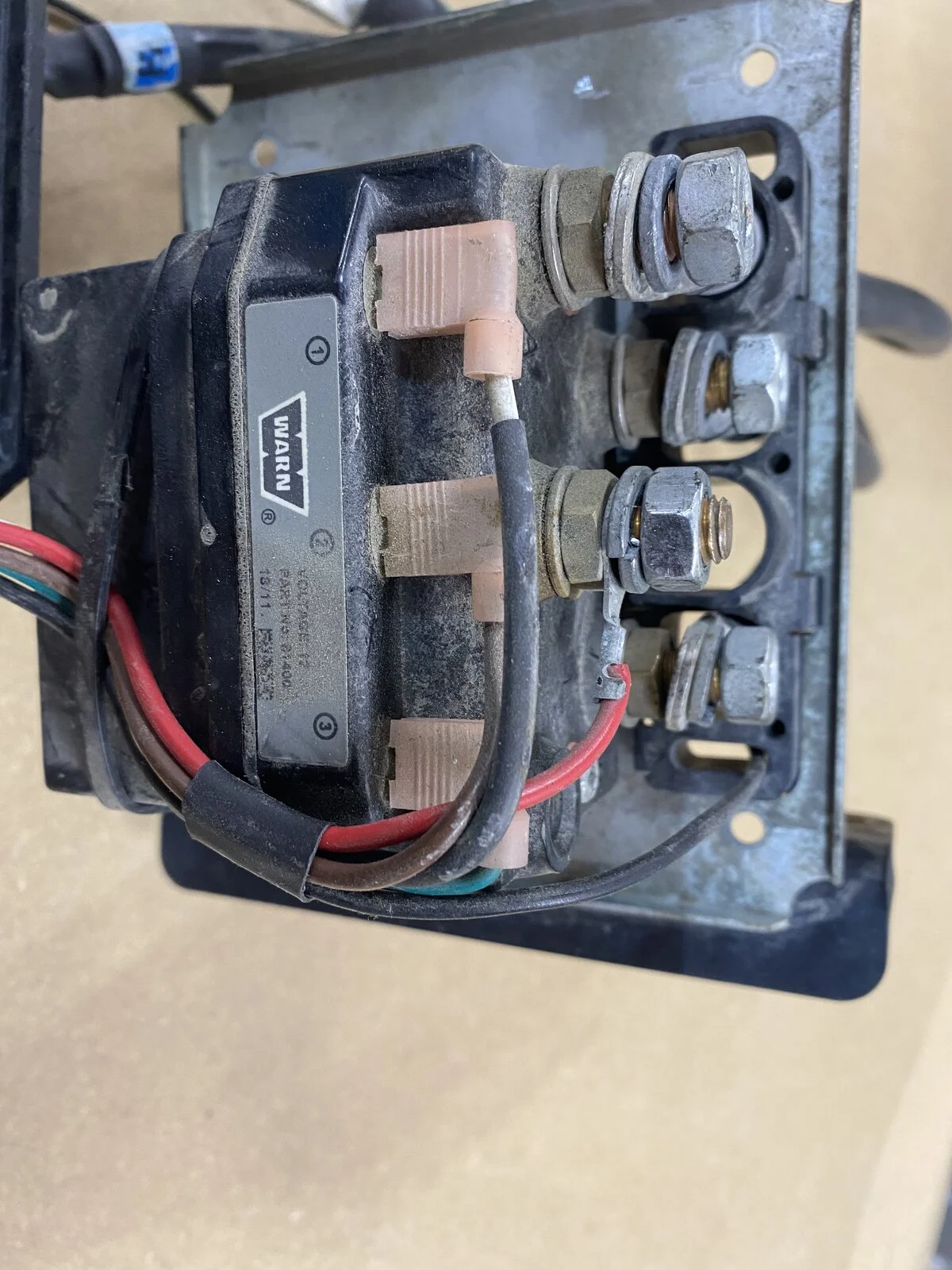

Your diagram looks good. Only thing you may have to do is switch the green and black so the winch direction matches the remote. I will take a pic of a Warn contactor harness tonight so you can see how they currently wire them up.
Reactions: DougyintheBushies
So I couldn’t get it to work with the 5 wire setup so I swapped to 4 wires. I capped off the red wire/motor ground and spliced in the switch ground/ brown wire into the ground coming off bottom of the motor. Now it works as it should.
