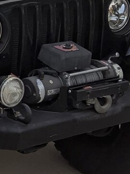

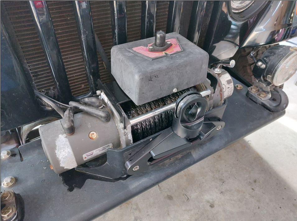

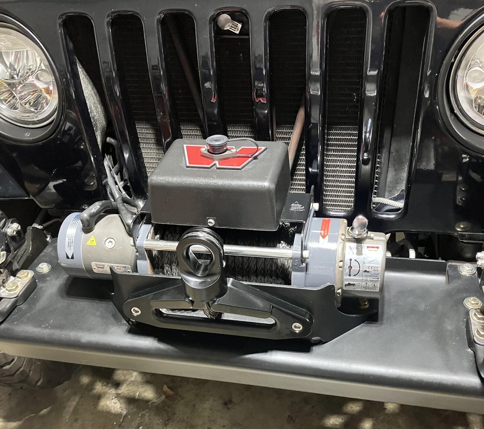

I have that same winch. Yours actually looks a bit better than mine did when I got it. If what Blackjack says checks out, then making it pretty again is not difficult. Here are a few pics of mine.
The first one is what it looked like on the Jeep when I got it.
The second picture is after Blaine installed new synthetic rope, a WRG fairlead and thimble and a new solenoid bracket from Searcher's 4WD.
The third pic is after I sanded down and primed and painted the corroded areas. I mixed my own color of gray oil based paint. I applied new stickers, which Warn sent to me for free along with a free plug cap. Next, I removed the old solenoid cover and installed a new one and re-wired the solenoids.
Thanks to Blackjack also who helped me troubleshoot why the winch wasn't retracting. It turned out to be some corrosion on the pins on the remote that just needed to be cleaned. I love the look of the old M8000.

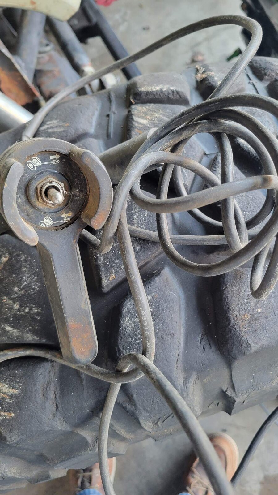

Here is the controller. I’m assuming there’s no adding a wireless, ha?
Not sure I want to trust a wireless connection or any delay when I’m winching anyway.

Sounds great. Again, I just emailed Warn and a gal there sent me a decal pack for the M8000 and a new cap that covers the plug at the top of the solenoid cover, all for free. I bought the new cover off of Amazon. I debated painting the "W" on the old solenoid cover red, but it looked like crap.
