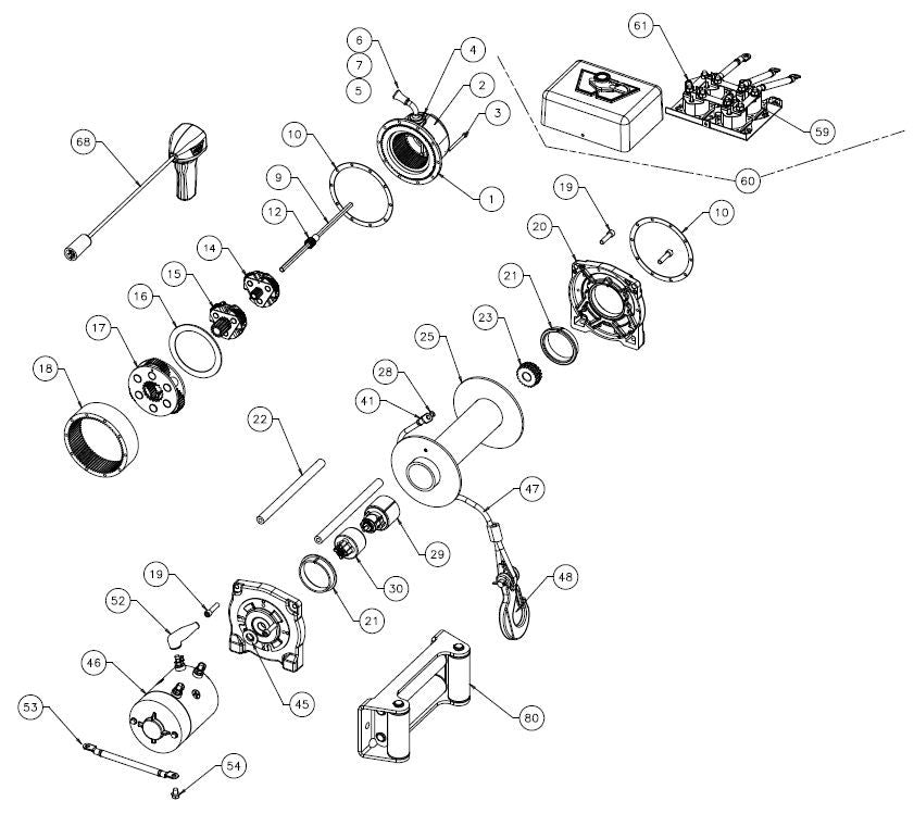

Layout of the majority of Midframes are pretty basic, a drum, two drum supports with the motor on one and the gear train on the opposite. Drivetrain consists of three planetary gears, a sliding ring gear for free spooling, and a brake. The electrical side of things consist of a motor, control pack and a pendant (remote). Motors varied over the years from 1.9 hp permanent magnet to the now famous 6 hp XP notor. Control packs are basic consisting of solenoids or a contactor. Lubrication from the early years up to a few years ago was Aeroshell #17 but Shell discontinued it so Warn now specs Philips Moly Low Temp #1.

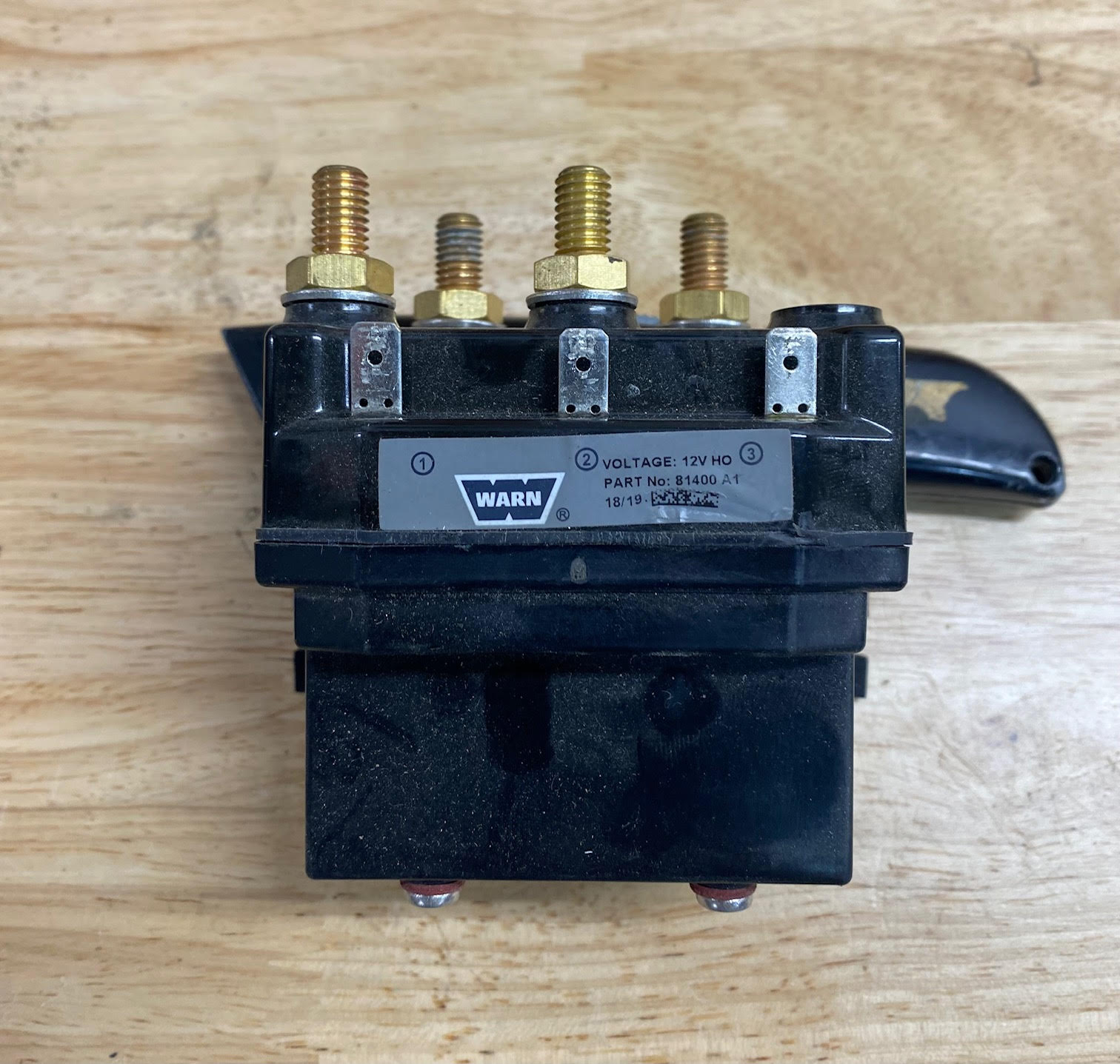

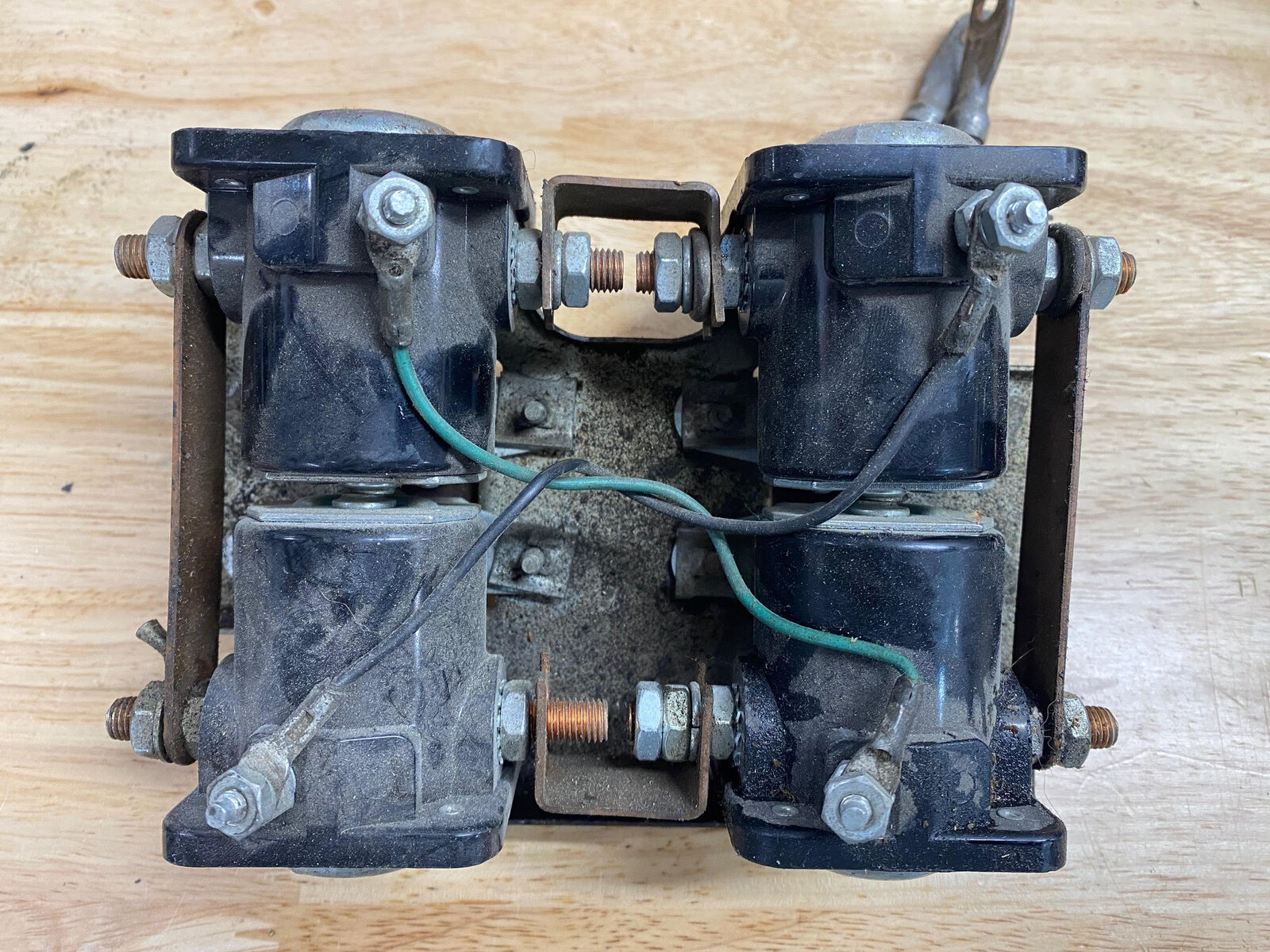

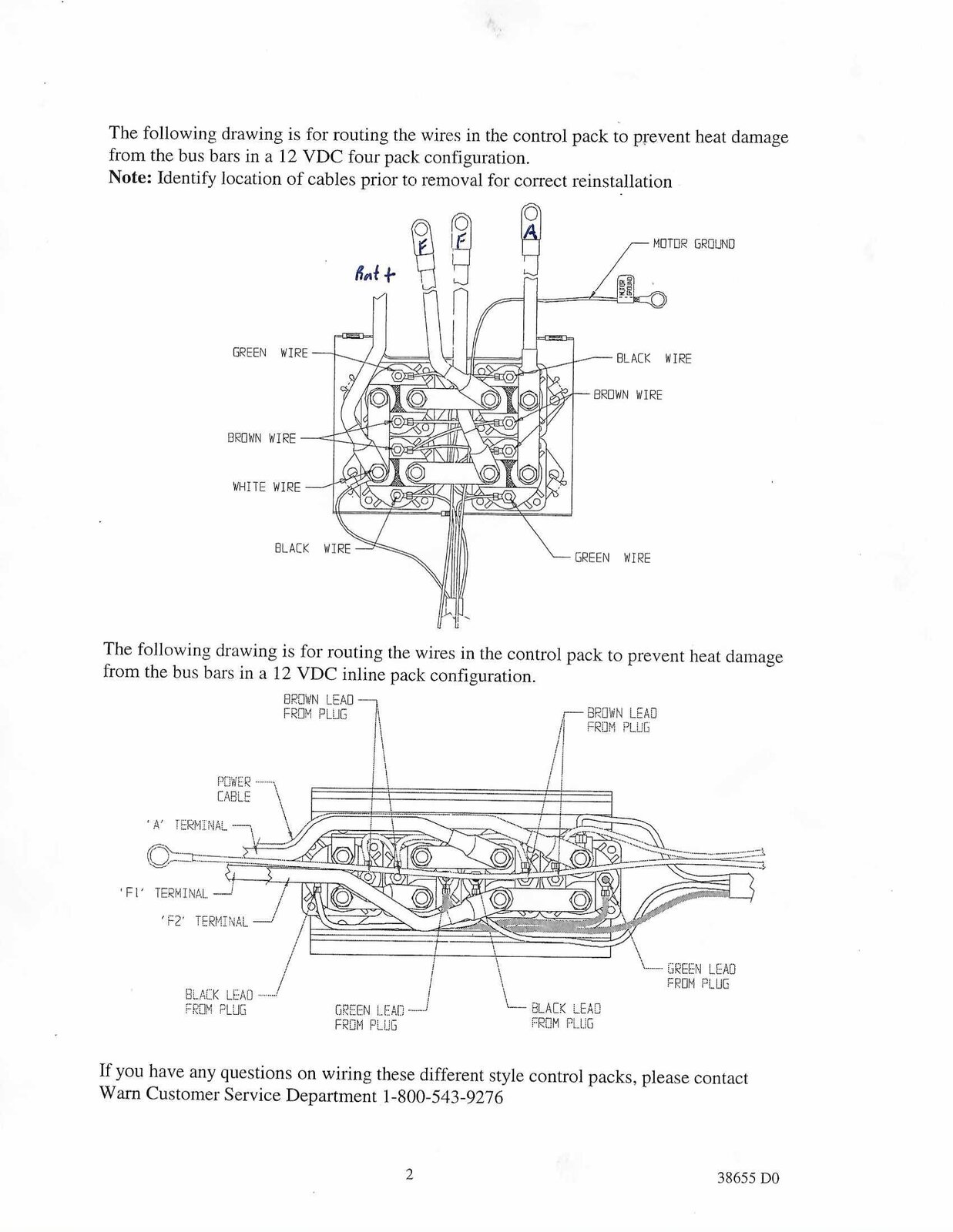

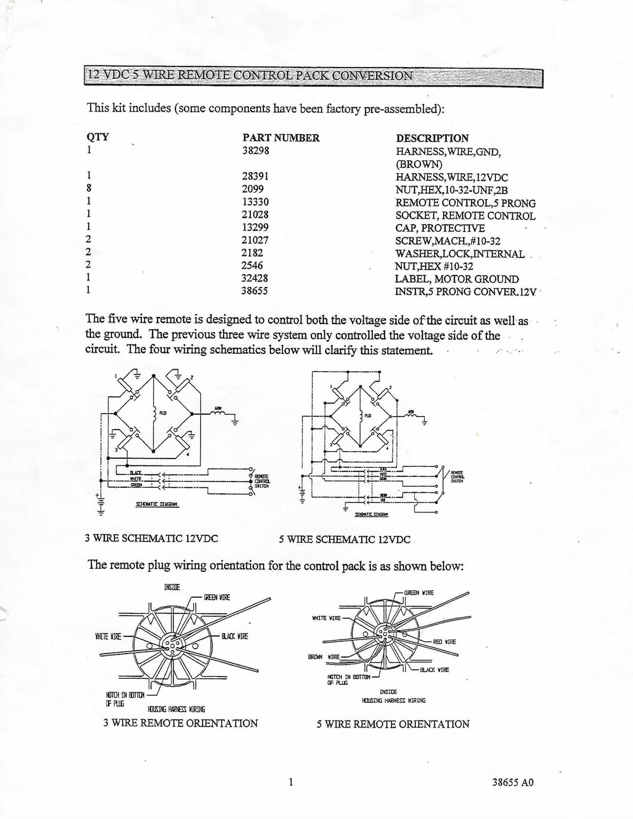

Electrically things are pretty basic. Early winches used "old Ford style" solenoids and a three wire control system. Those were changed in the late 90s to "new Ford style" and for a short time the three wire control. That was later changed to a five wire control where both the hot and ground both as a safety issue and increased solenoid durabilty. I have added some wiring diagrams and my own notes on switch and plug pinouts.

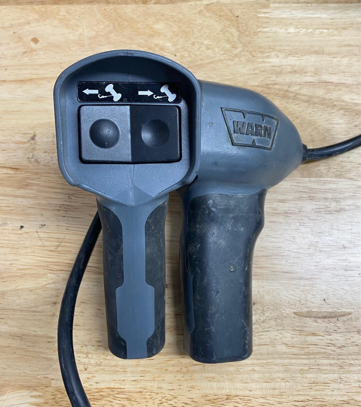

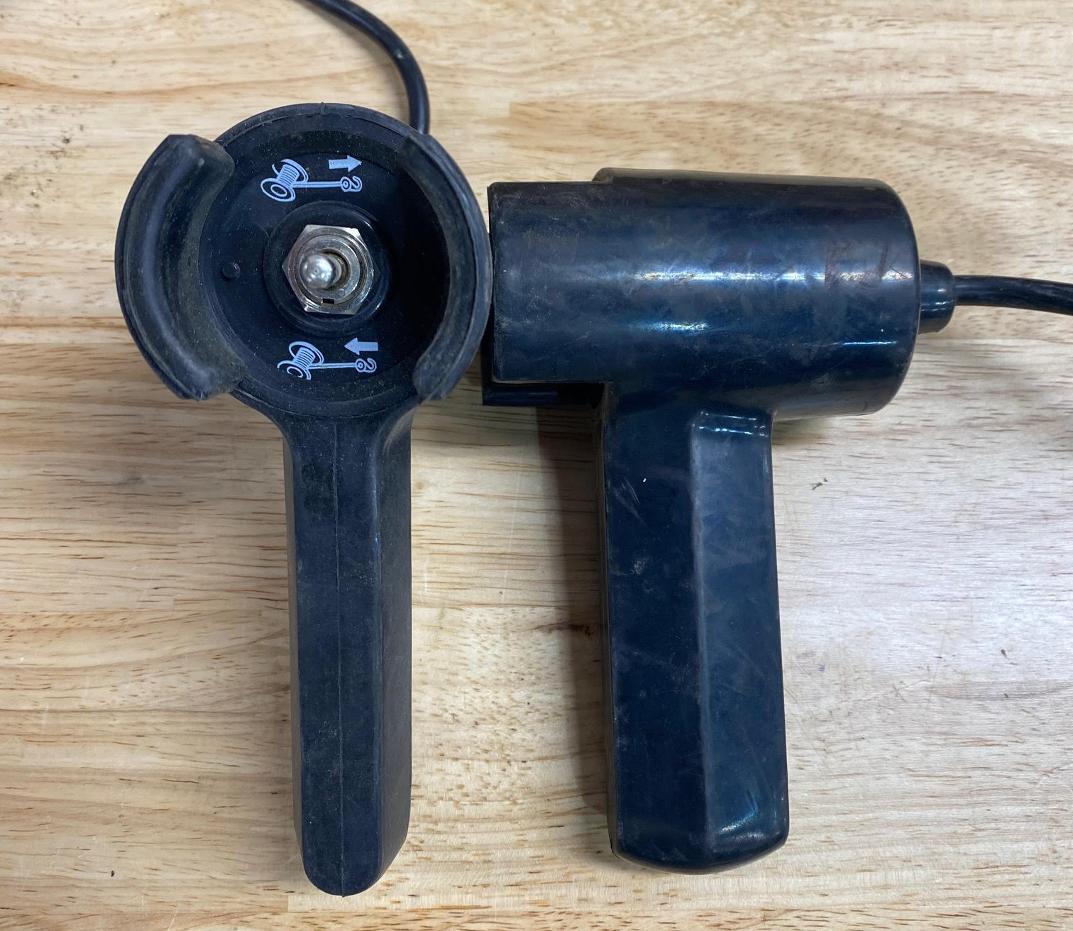

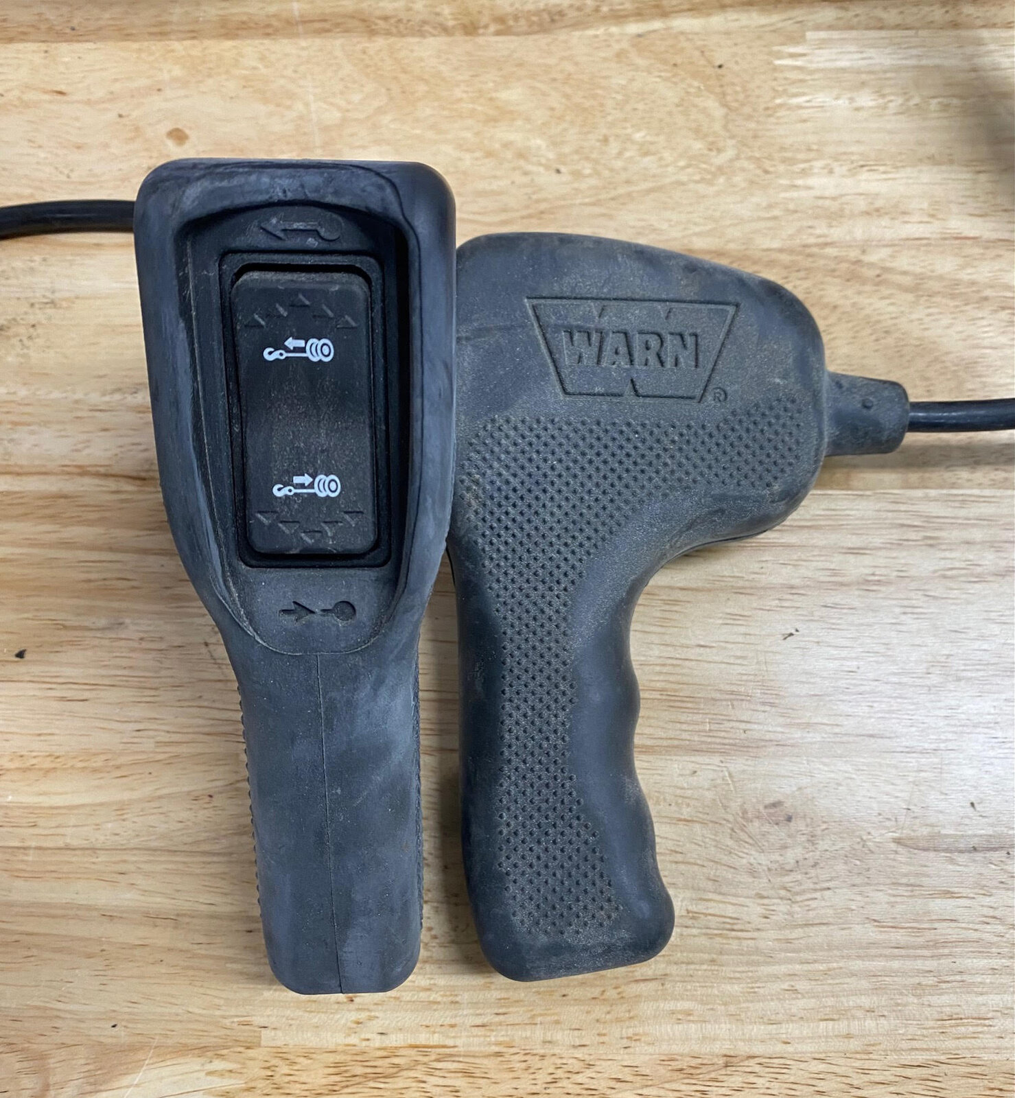

There are three different styles of pendant (remote) that have been used:
The classic
2nd gen. This was Warns first attempt to update the classic and in my opinion was not their best work. After decades of teaching people that up was out and down was in they decided to put a sideways switch in. Now Warn will tell you it is supposed to be intuitive since the rocker cover has a bump and a dimple to indicate the in and out modes. Bigger problem with this remote is a serious lack of durability and they cannot be repaired.
3rd gen. This is the current generation of remote and is everything I like in a remote. They went with a much more robust switch and oriented it the correct way. They did keep the braille although I am not sure how that works when you are wearing gloves. Ergos are good and they are just solid all the way around.

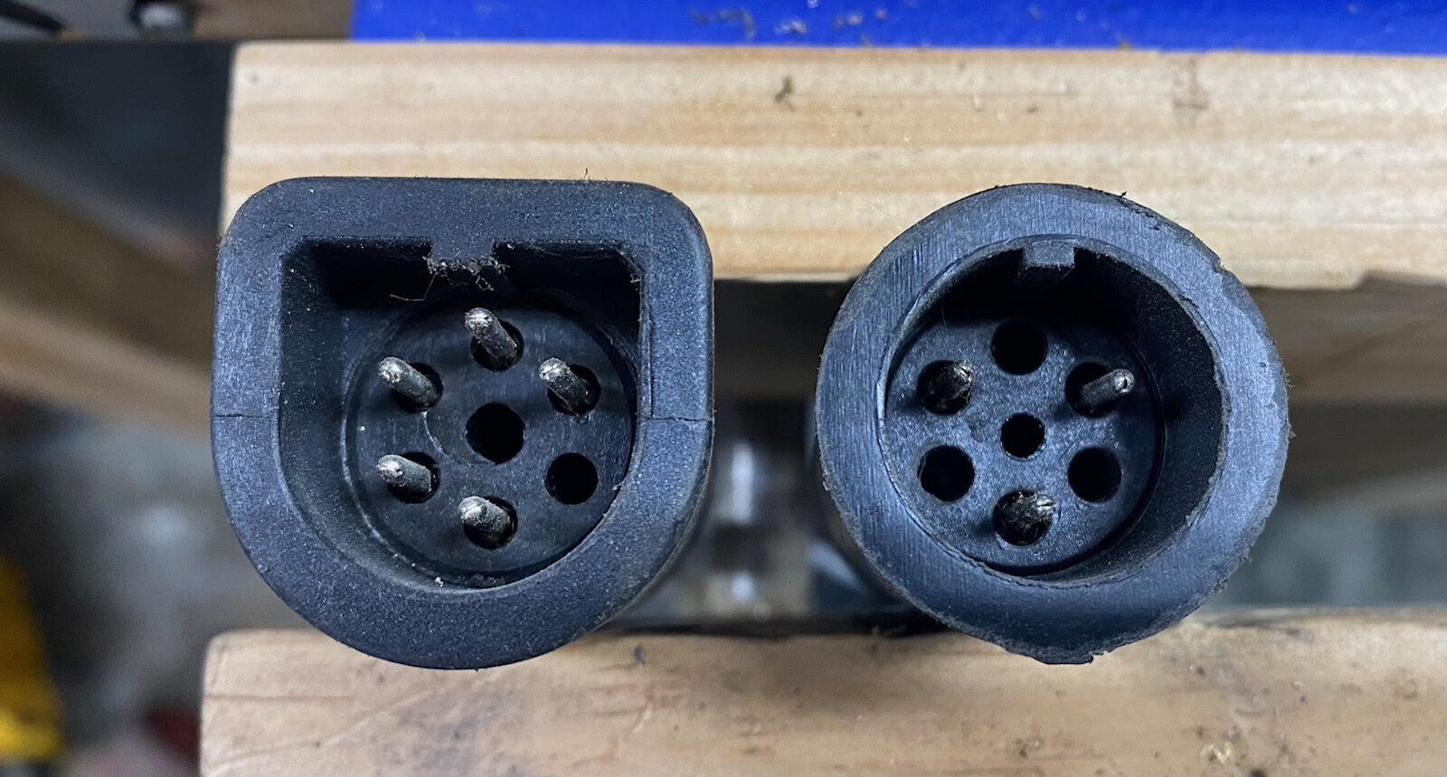

The socket that connects the remote to the control pack is a Warn proprietary design with two generations. First gen is round and started with three pins and later five. Current winches use a "D" plug that is backwards compatible with the round remote.

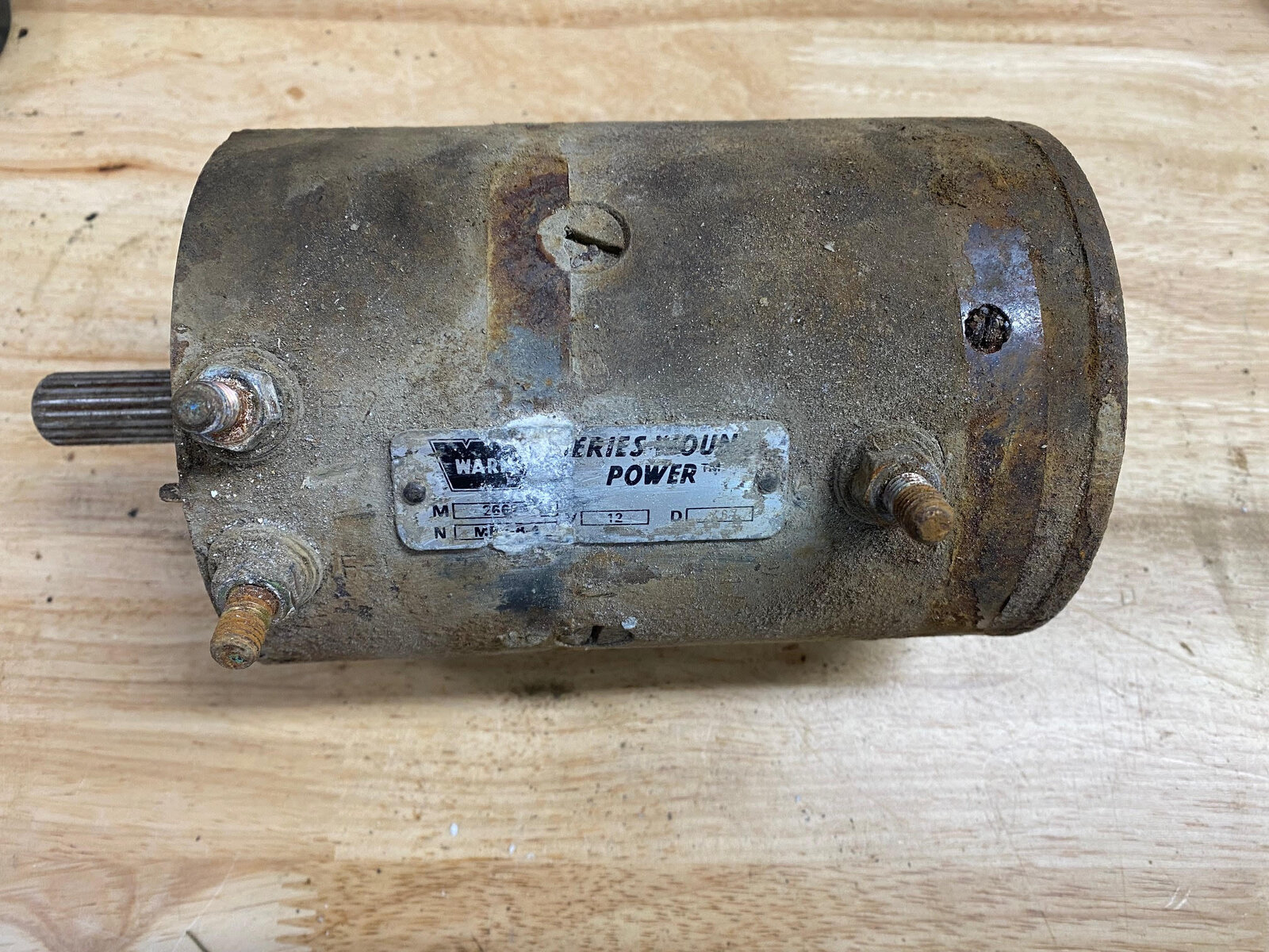

First is the Wapsa used from late 80s until 1999 and were produced by Bosch of Brazil. The short version is 2.0 hp and was used on 6k, 8k and first gen xd9000 (more on this later). Long motors are 2.5 hp and were used on second gen xd9000/i (these were more common on large frame winches). These motors are pretty typical series wound motors for the time.

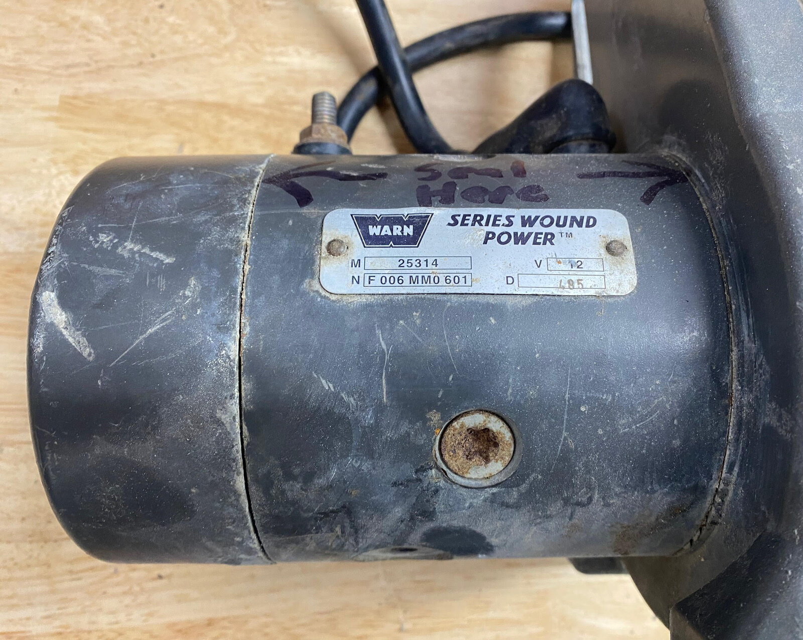

Next up is the BIC or Best In Class. This in a way was Warn trying to make lemonade from the big fat lemon Bosch of Brazil handed them. Bosch basically forced Warn to use this motor. They did at least get to have some control in its design and after a few wrinkles came up with a decent motor but not without some flaws I will cover later. Compared to the mule that is the Wapsa this motor is a thoroughbred horse. Where the Wapsa when you are abusing it will start sending up smoke signals to let you know you are being bad the BIC will give you every thing it has until it just drops. It does has a higher free rev speed than the Wapsa so they give better no load line speed and it is a bit more efficient in the amp draw department. Short motor has 4.8 hp (not a typo) and was used on M6, M8 and 9.0Rc. Long motors are 4.6 hp and used on xd9000/i, hs9500/i (with a special armature shaft), 9.5ti and 9.5cti.

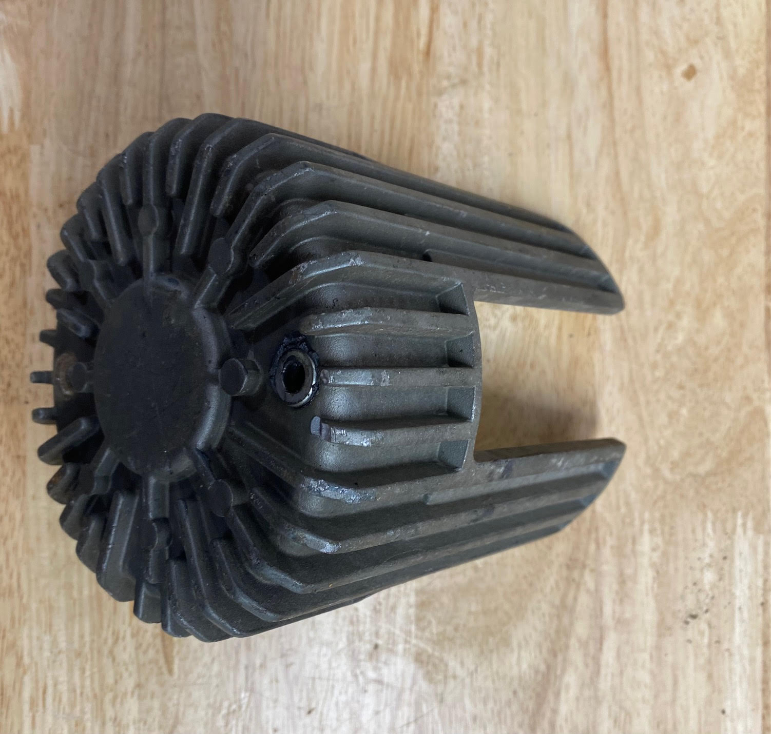

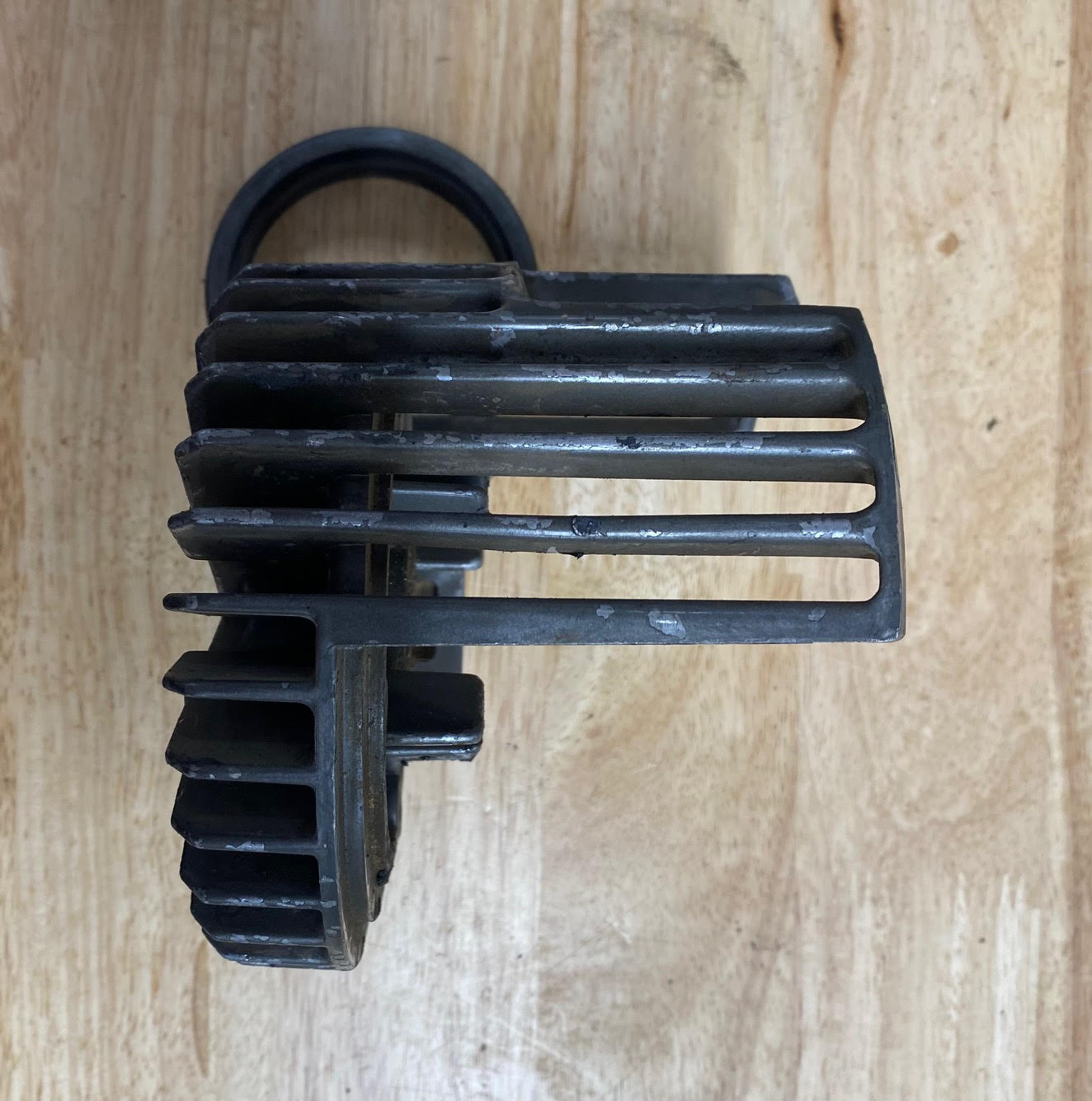

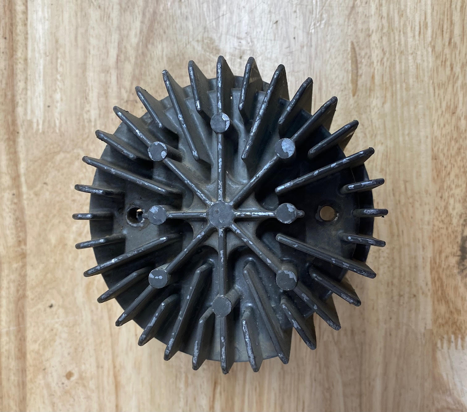

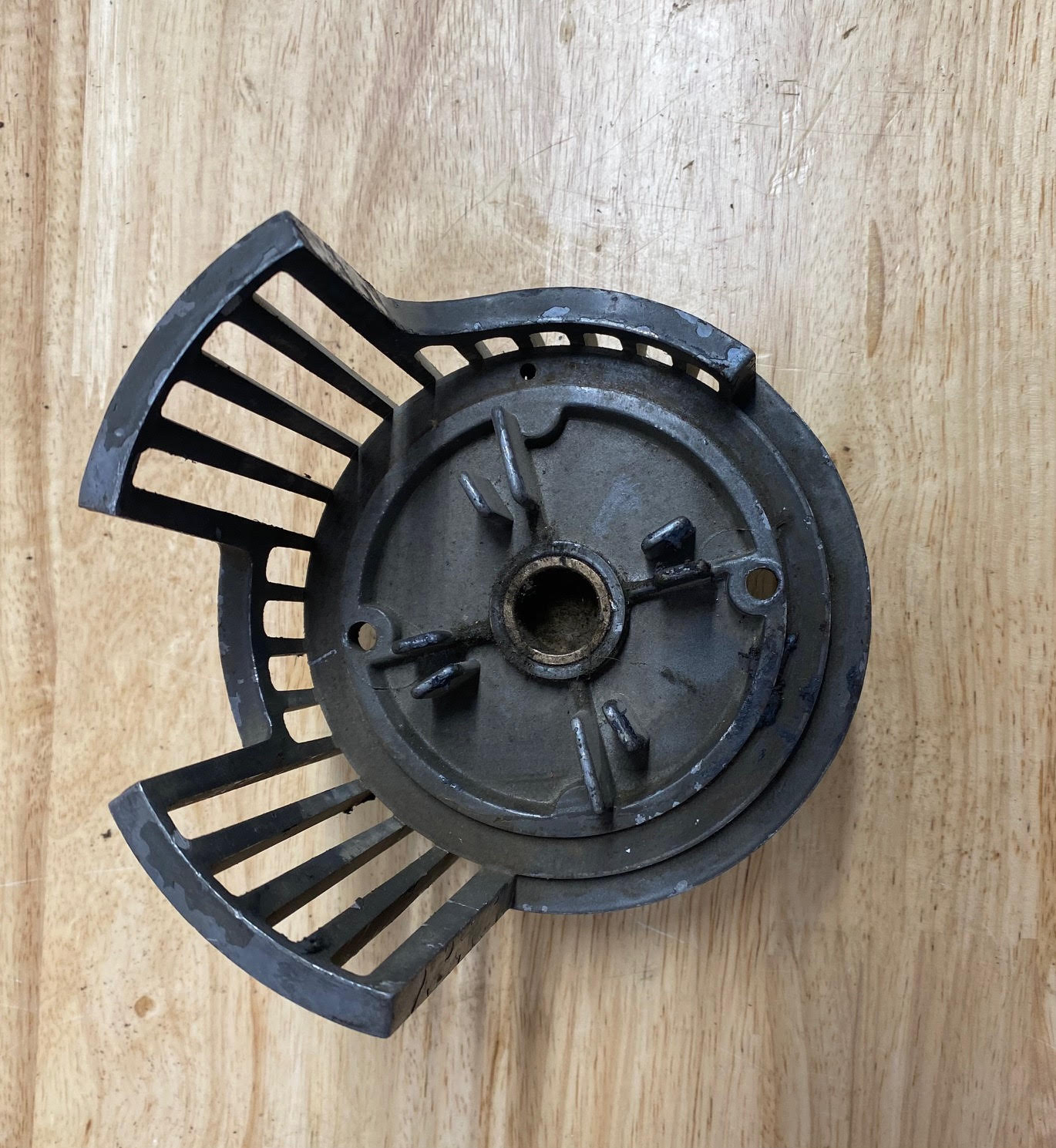

In the early 90s the xd9000 (eXtreme Duty 9000) was introduced. To the astute observer it was hard not to notice that it shared almost the exact same specs as the M8000. The same motor hp and gear ratio (check out the 9.0Rc) so what was the deal you ask? Two things, first is that Warn like they did with the 8274 had sandbagged the specs which was not uncommon years ago. Now days it is pretty common to advertise a winches rating as the maximum that was achieved in the lab. But the innovation that gave the xd its extreme duty was the special end cap they developed to help cool both the brushes and the armature bushing of the Wapsa motor.

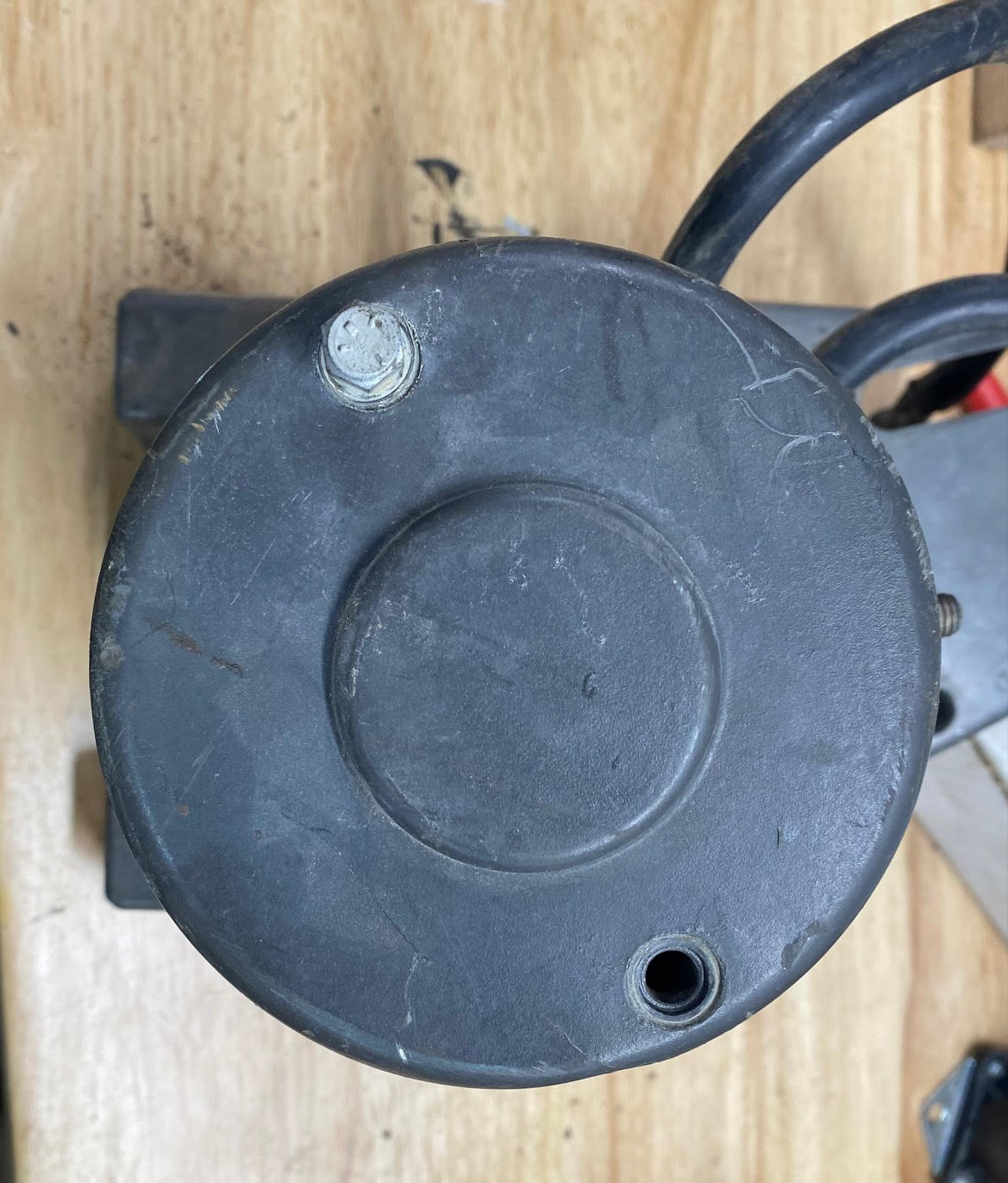

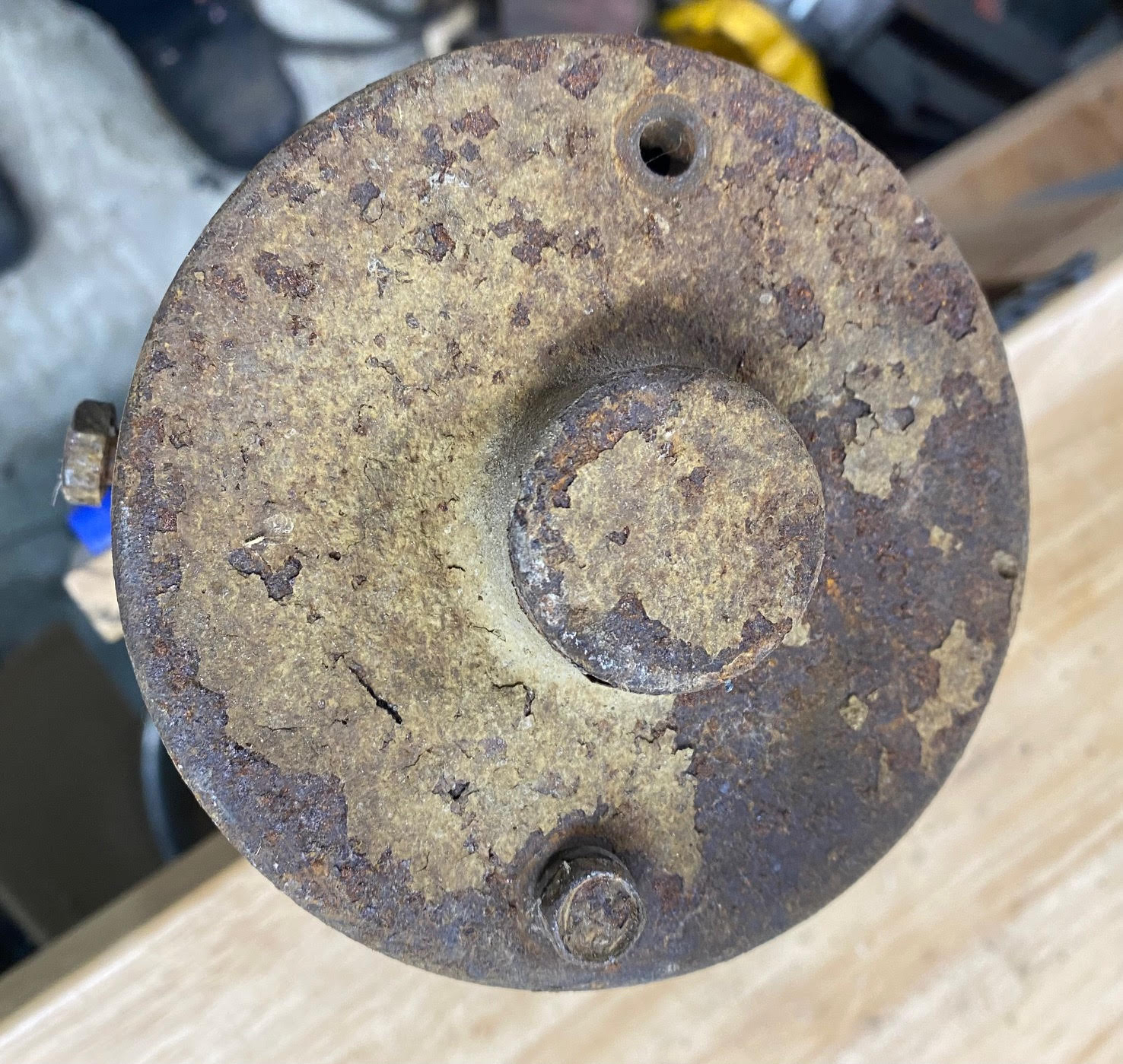

A few years later the xd9000/i was changed to give an increase in line speed by going to the long Wapsa motor and 156:1 gear ratio. The change also saw a change to the motor end cap. Gone with the innovative brush cooling cap for something a bit more mundane. It still at least helped with cooling the armature bushing but that is about it.

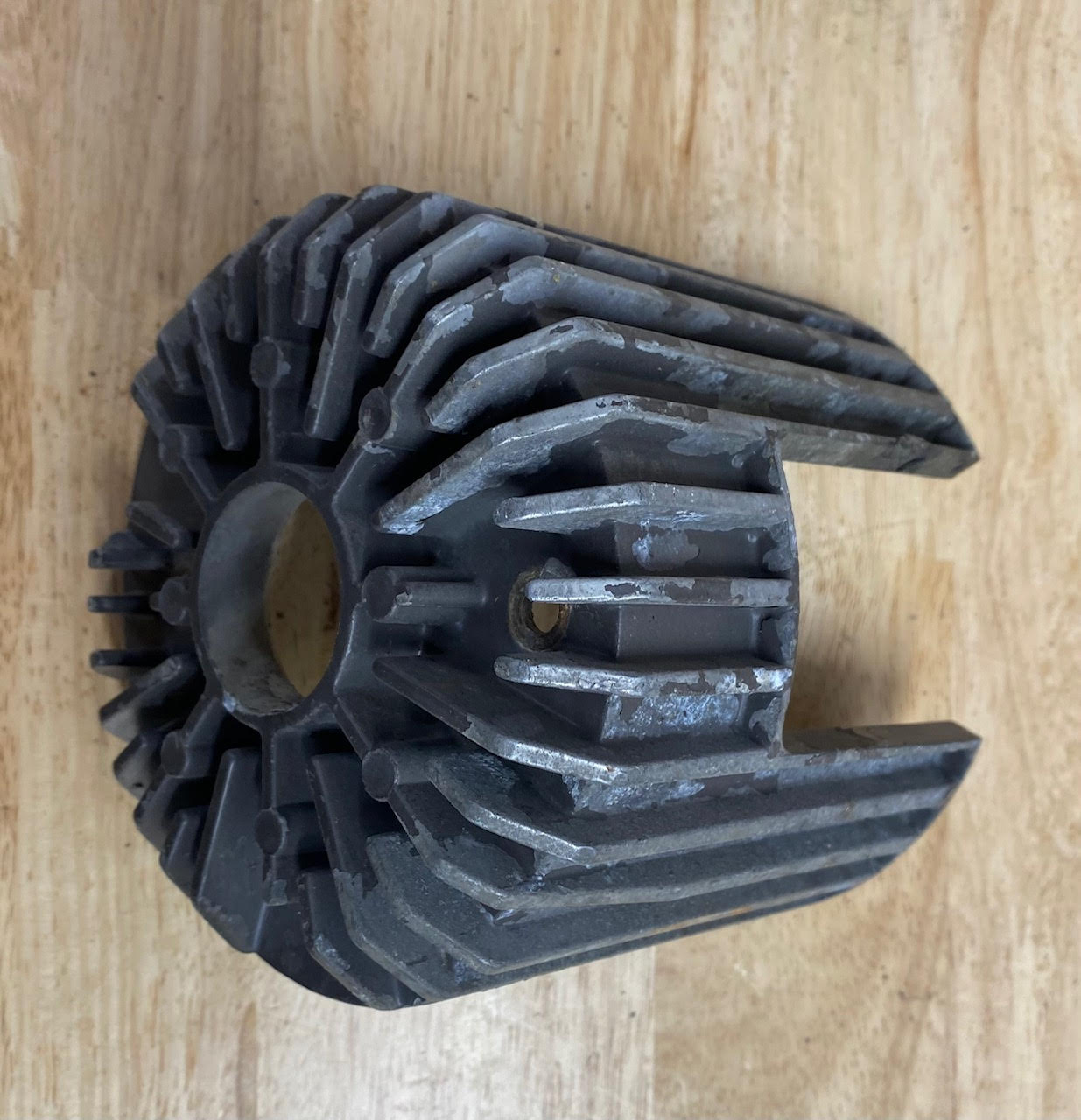

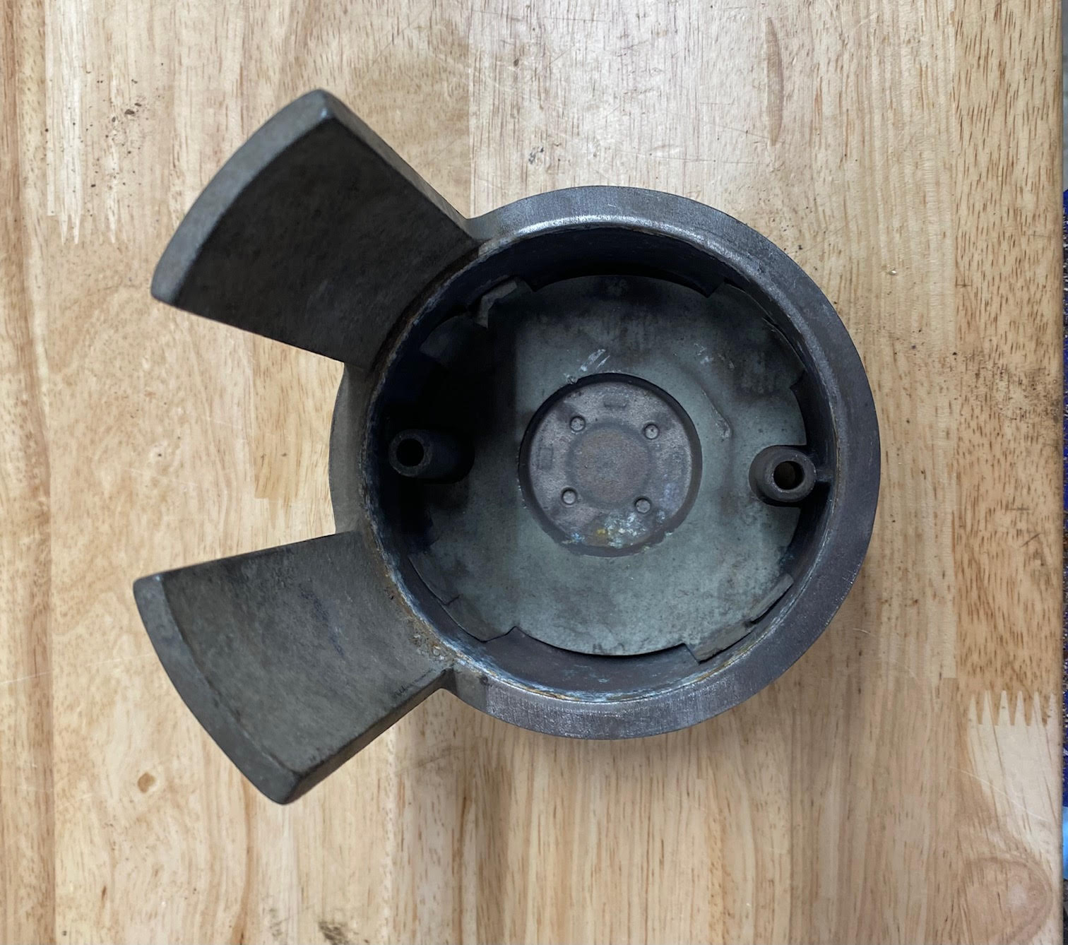

When the BIC motor came out the finned cap was marketing decoration and little else. It was only used on a limited number of winches before it was finally phased out.

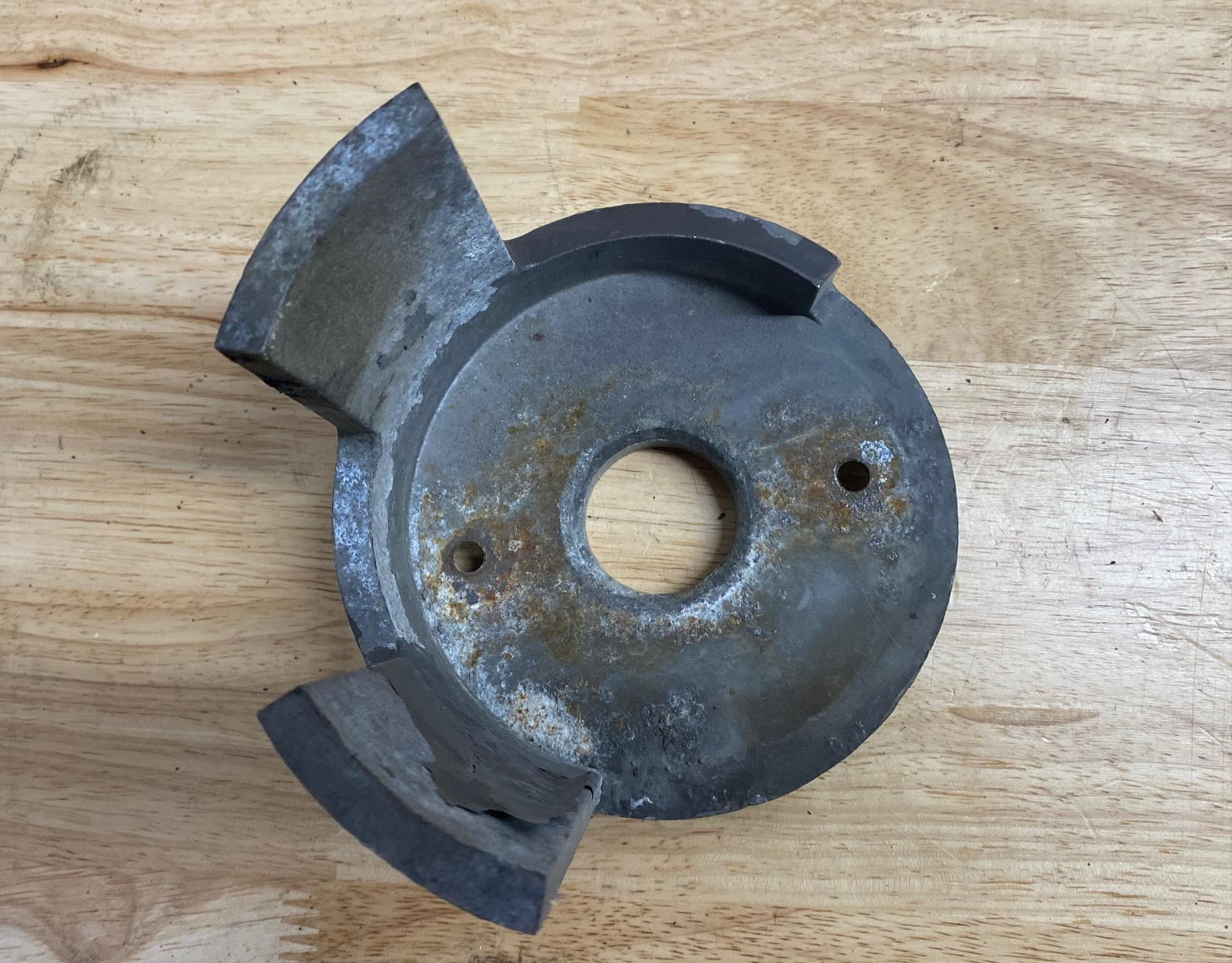

So in November of 2003 the 9.5xp (hey look here https://www.pirate4x4.com/threads/new-warn-9-5xp.193180/ ) was released and IMO Warns ultimate workhorse was born. Updated frame with actual drum sealing and of course the 6.0hp parallel series wound motor. Yes the brush cap has what kinda looks like fins but the cap was improved to prevent water incursion unlike the cap on the BIC motors.

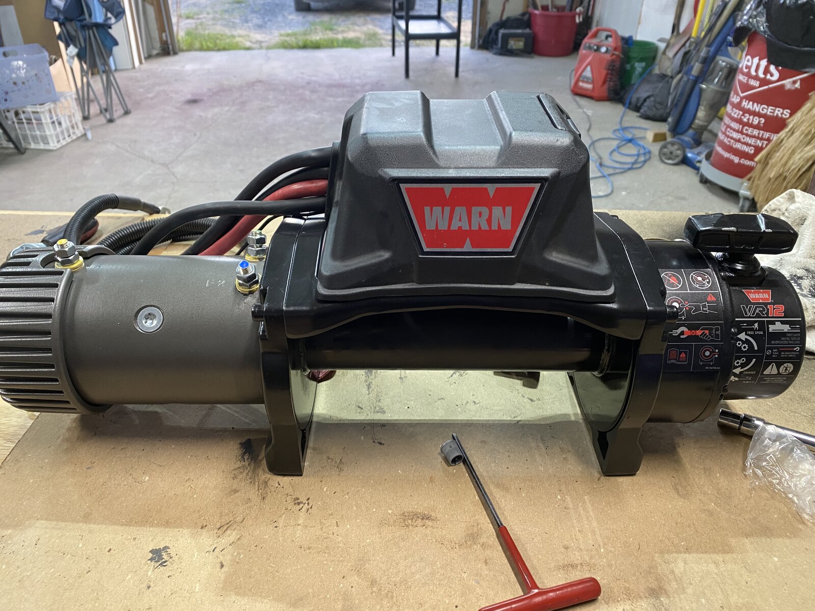

This has become the motor of choice for a lot of modders and I have use them to mod 8274s, a Frankenstein M12, and this wolf in sheep's clothing.
When the BIC motor came out the finned cap was marketing decoration and little else. It was only used on a limited number of winches before it was finally phased out. View attachment 399075
What was needed to put that 6hp motor and vr12 together?
It is a 9.5xp made to look like a vr12. It is a joke for the client I put it together for. If you put a 6hp motor in a vr12 it would pull itself apart.
