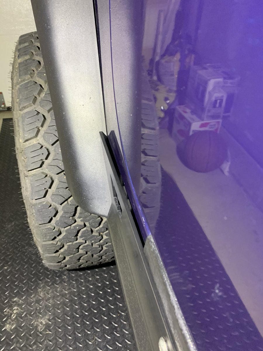

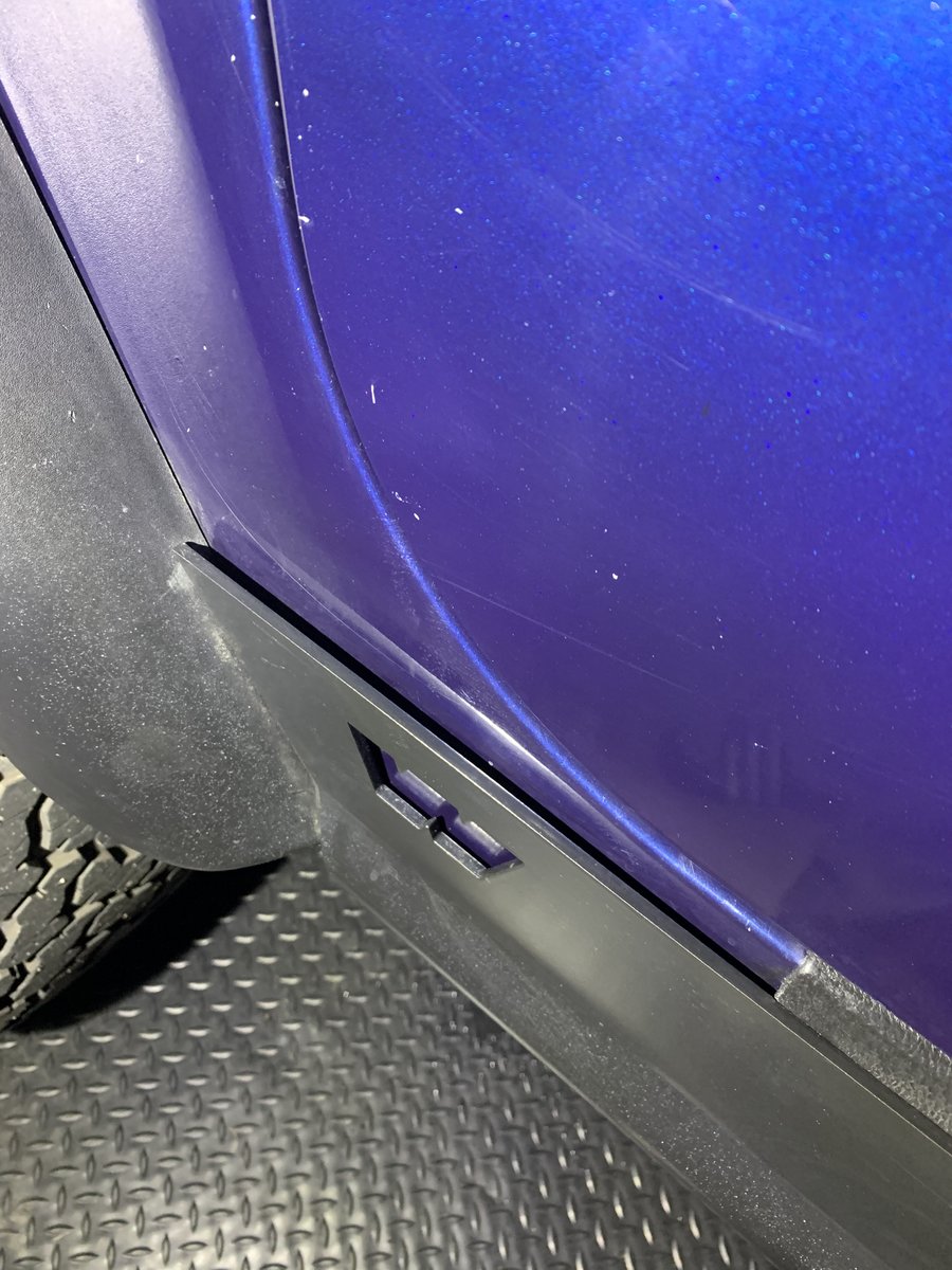

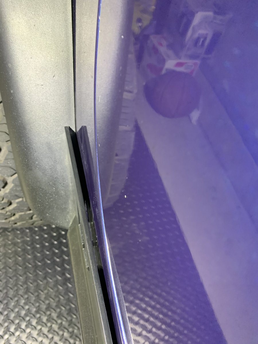

I have the warn sliders on my TJ. Mine doesn’t have that bowing issue but I do have an area on my passenger rear area where the slider has a fair gap from the body. My driver side was perfect. Not sure if I rushed the passenger side install and drilled the holes slightly off but I haven’t gotten back to try and correct it. It does collect dirt and grime in that gap. I will say I rinse that gap out the best I can. I did fluid film the body prior to tightening down the bolts. I also caulked the seam between the slider and body. Every spring I do loosen the body bolts and separate the slider from the body enough to get a good rinse and reapplication of fluid film as well as to ensure no rust is brewing underneath. I will say I do like these sliders. Here are pics of that spot.

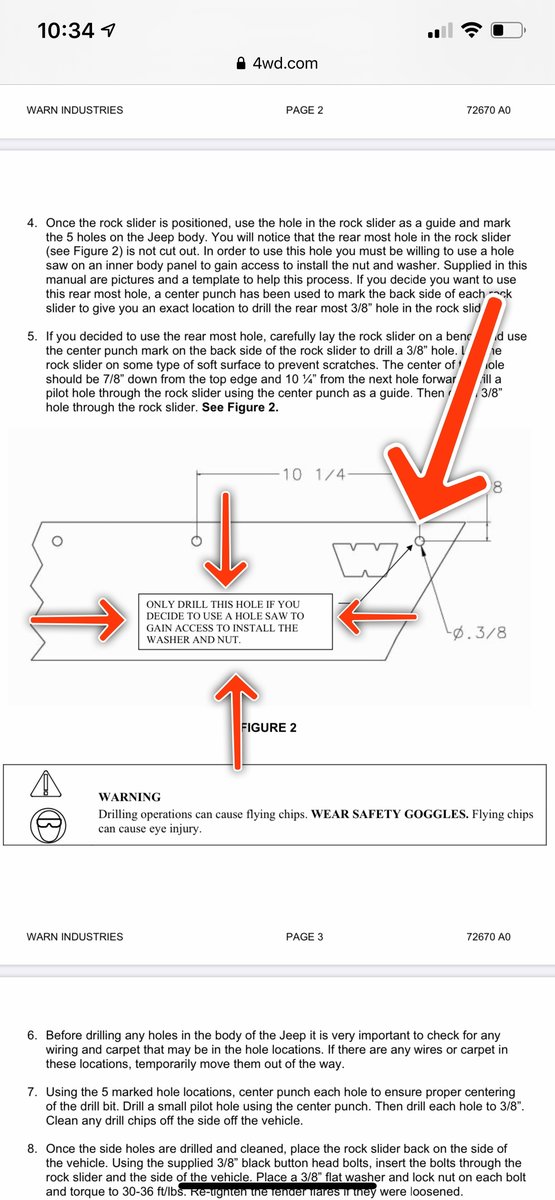

https://www.4wd.com/sku/Warn/standard/71500.pdfLooking at the instructions, seems as if you elected to not drill the sugguested mounting hole that might have resolved this issue.
The Warn suggested hole is actually drilled above the “W” in each rock slider. Which leads me to believe me that this issue would be non existent under light to mediocre offroading.
There's just a few bolts and washers to resist that pulling force, so that force gets concentrated at those bolts and deforms the sheet metal.
They also have a long plate that gets sandwiched on the inside of the tub just below the door which spreads out that pulling force and stops the bolts from trying to pull through the sheet metal.
Which can be purchaed from Genright. An even better set could easily be made/fabbed by a reputable fabricator. But it does require added work to make it work.
Yes, they will bend and pull the ends out, if you hit them hard. I used them for years with pretty mild wheeling, but when I started getting into them pretty hard they bent, pulling the fenders. I've even removed them, sliced and rewelded them flat. Still bent. I would avoid.

If the rocker isn't secured in two axis then there is nothing really to keep it from bending the sheet metal.

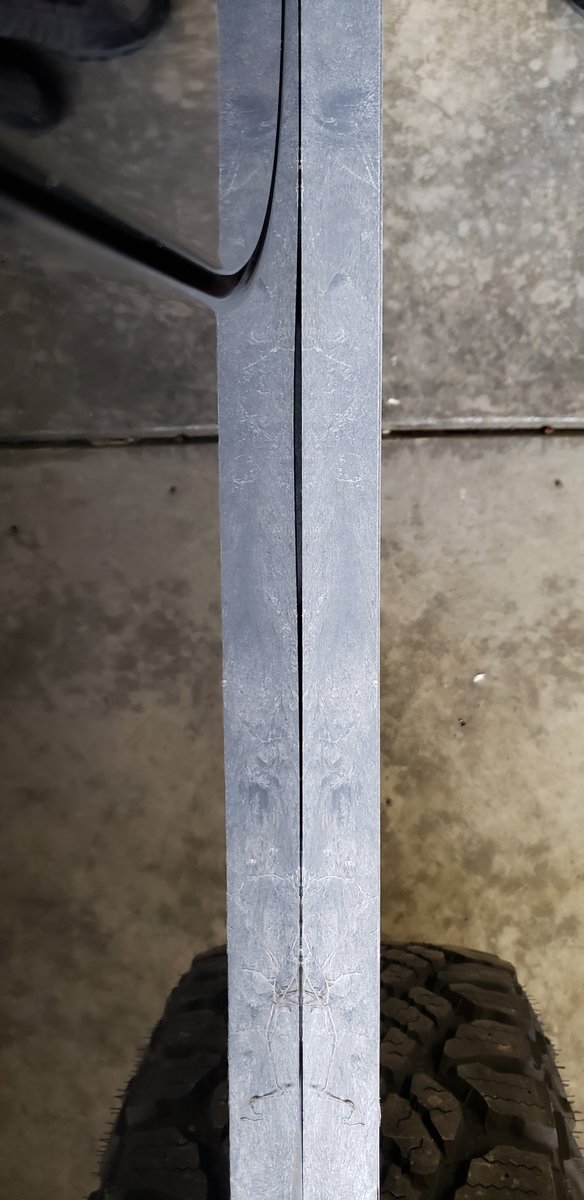

1. I used a 4’ level to determine how straight both the sliders are and the body of my Jeep. The sliders were perfectly straight. My Jeep body was straight, but not perfectly straight. There were areas of the slightest bowing that created tiny gaps between the level and the Jeep.
2. Loosely screwing all the bolts, the slider would be flush with the body except for areas where there were small gaps as the same when I used the level. Tightening down on the bolts would cause the sheet metal to contort a tiny bit causing the small gaps to become slightly wider.
3. I do believe drilling the extra hole behind the seatbelt base would help.
