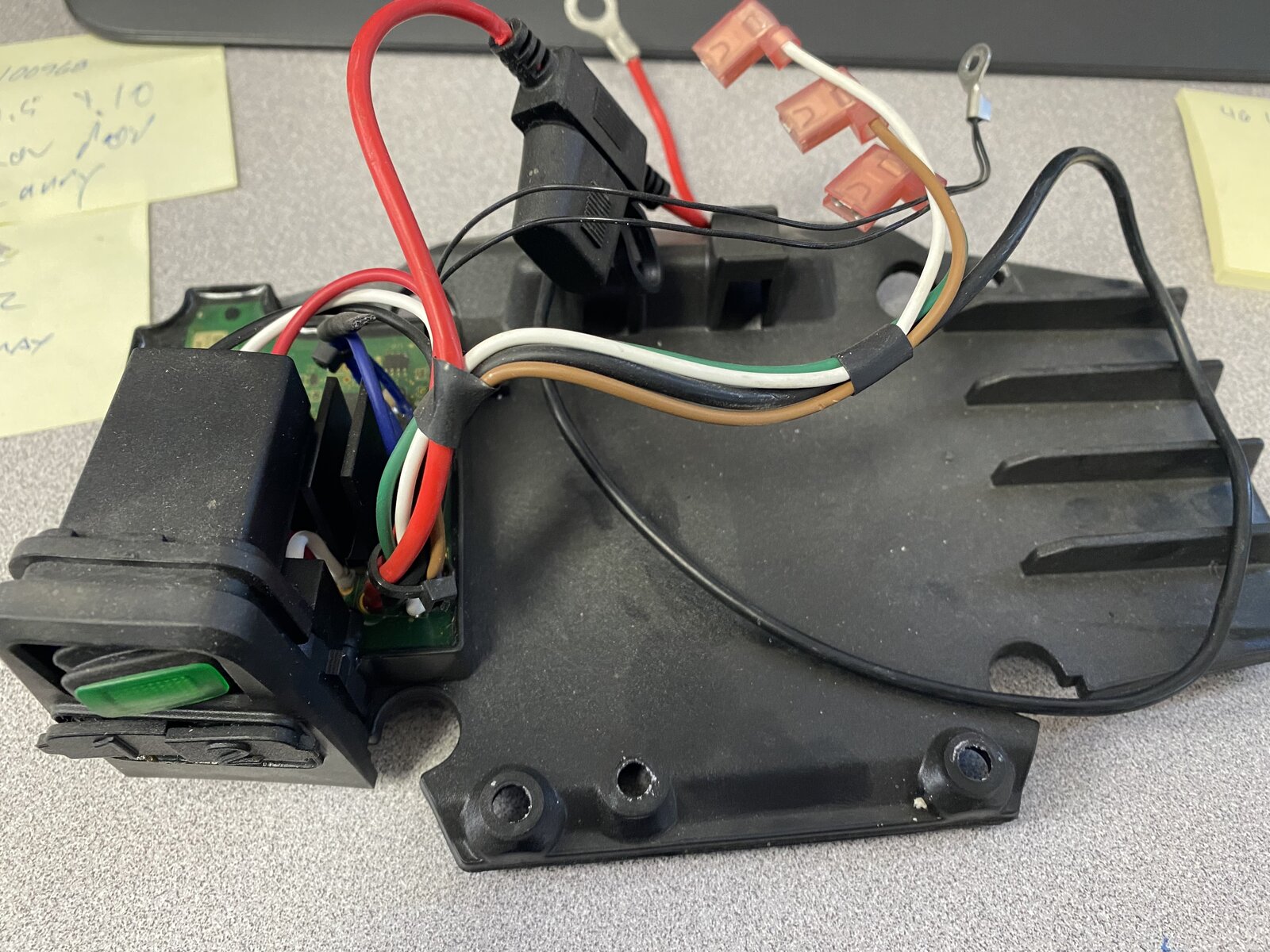

So I got a killer deal on what I thought was going to be a great new winch upgrade from my old and well used warn xd9000i. It was a new winch from the shop display. Remote and winch line etc all still in the box. Body had just been bolted on a stand for a year. Turns out I can’t stand this dang thing. Wish I had gotten a standard zeon and not the platinum series. This problem is the that the wireless remote never stays charged. I’ve replaced the battery pack in it from Warn twice in a little over a year and a half hoping that would cure it. But if I charge it fully today. Make sure the remote control and winch are both turned off and then place the remote it in the glovebox it is dead within a mail of 48 hours. It’s basically gotta stay plugged in so that when you go to use it you can unplug it and use it wirelessly. Now they have Bluetooth modules to use your smartphone on the non platinum versions of the winches but unfortunately they are not compatible with the platinum version. I just don’t get why these stupid remotes can’t seem to hold a charge. My friends does the same thing. Anyone else experienced this problem with the platinum series remote control.

Looks like this guy found a good solution. Just ordered the switches on Amazon. Hopefully this fixes it for good. It’s a great winch otherwise but damn WARN should have come up with a fix by now.

Unfortunately you have to use the winch remote even to lock and freespool it. I do know that it isn’t the same style of contacts or solinoids as a typical winch set up. And the control assembly is all a solid state board and not wired like most other winches. I’m excited to get the remote modded and see how that does for me.

Yeah it works fine while plugged in. But the point of the wireless remote was not to have it connected. I got in the habit of plugging it in on the way to a trail or in the truck while it was on a trailer. But I’ve had to do some emergency use recovery’s with it and had to wait for it to charge up enough to turn on in the past. It’s just always bothered me. So I’m excited to fix the thing.

I called warn to get a replacement battery for mine but the real issue seems to be a small transient power draw that drains the battery in a few weeks. Warn may be able to be fix with a firmware update.

The Platinum does use a contactor and a series wound motor but it is the electric clutch for freespool that makes things a challenge to bypass the wireless unit. In a way Warn did reinvent the series wound motor by integrating the brush holder into the winch frame and using an aluminum drum. This was something they started with on their ATV winches several years ago and it basically turns the winch itself into a heat sink for the motor.
