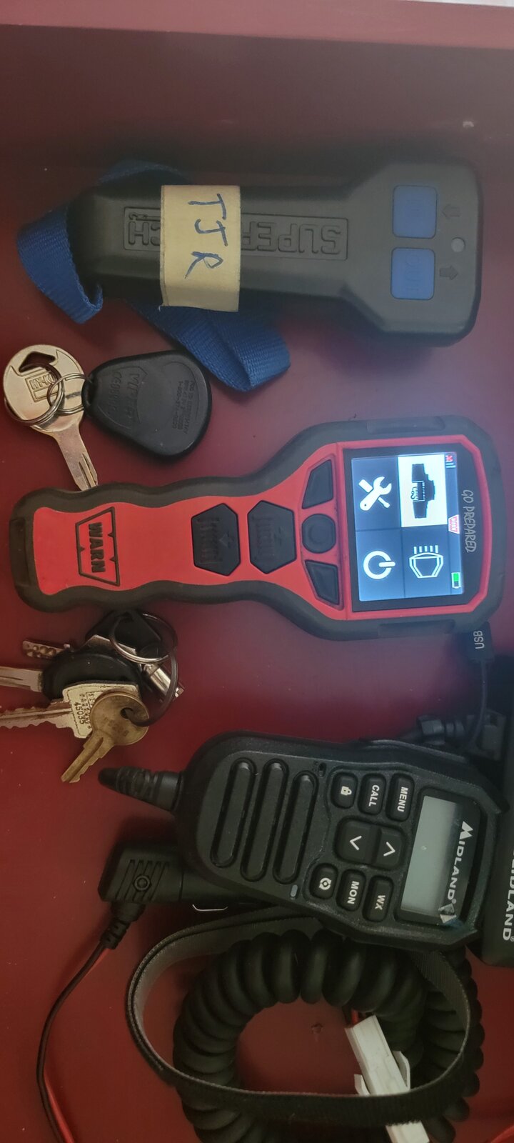

I keep the remote's with the keys so they are never forgotten and easily tested before a ride.
Note the battery indicator is about 75%, which is the optimal level for long battery life. Even so, I top it off just before a ride as Lithium batteries have a very flat curve before they drop off a cliff.
