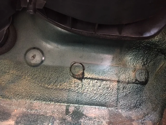

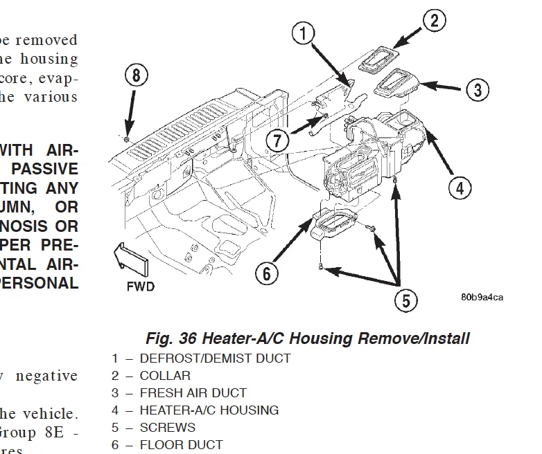

I too find water in the passenger floor board after a hard rain (when parked) and just did the hose test and found water leaking from around the foam gasket at what I think is the a/c-heater housing (#4 in the diagram). If I'm understanding the factory service manual correctly, I will need to remove the dash in order to remove the housing to replace this foam seal. Does anyone know another way? or perhaps an idea for how to address from the engine compartment-side?
thanks

mine too was leaking there as well. as for the replacement foam gasket kit, good luck sourcing one. it is a discontinued item and I was unable to find one after searching and searching. my gasket appeared to have shrunk allowing for a gap.
my undesired solution was to pick up a small tube of clear silicone and thinly bead around everything to seal the gasket to firewall and all the piping through the foam gasket from within the engine bay. I feel like its a half assed job but it stopped the water leaks from the hvac opening through the firewall.
Edit - you may luck out looks like available for up to 2001 4874069AB. I cant imagine any difference for my 03. I may look into testing this if the silicone stops holding up. but all the disassembly doesn't look fun if my silicone holds up.

thank you for both tips. I might try the silicone first and work my up to gasket replacement.
