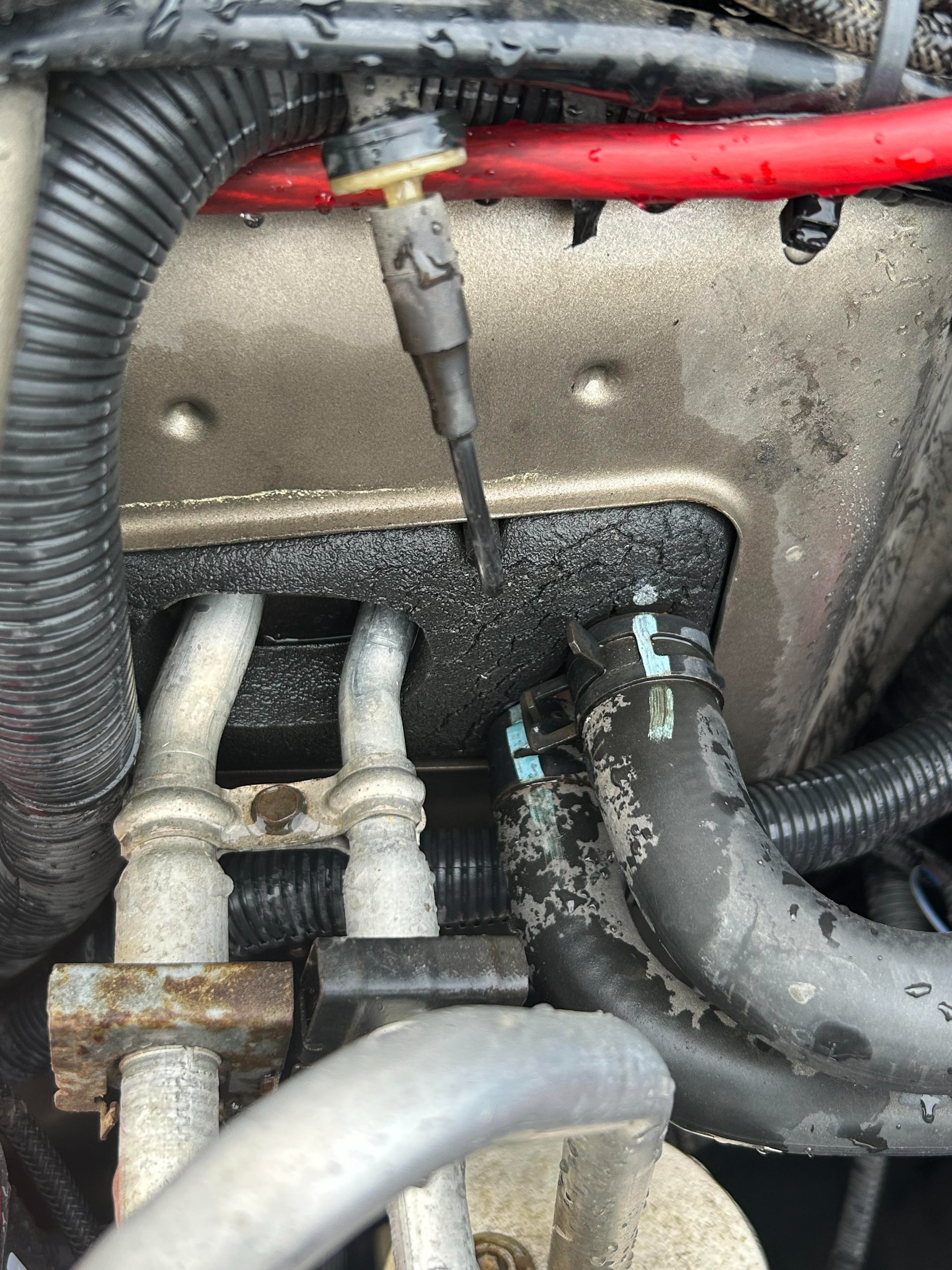

In the latest downpour, I had some standing water in the passenger floor. I thought the fresh air box was the culprit so I pulled the top and made my own gasket.
I checked it again the other day after a good rain, there was a lot less water this time, not standing like before.
FF to today, son reminded me we needed to work on finding the leak. It is coming from the "foam" that surrounds the heater core and a/c lines going into the firewall.
How should I approach this?

I used spray on flex seal.

I sealed off the gaps and am waiting for some spray sealer.

Check the seal along the body at the rear edge of the hood. That should divert water from the firewall area.
Check your cowl drain. That water might not be coming from where you're thinking.
-Mac
I have flooded the cowl drain and can't get it to leak inside.

If it’s intact it should be ok. Water leaks can be tough to find. The way I test them is with someone inside the vehicle checking, then the person outside runs a hose, just water running out not a spray nozzle. Start at the bottom of the vehicle and work your way up. Allow time for water to get inside if leak is present. As you work you way up try to get just the hood, fender area, then antenna area. Then move up to hood seam at rear, then onto the down. This will help you isolate different areas. Check for any add on wires run through the firewall if there are make sure there is a drip loop outside. It is a slow process and takes patience. Another way that may help is have someone inside with a flashlight shining light into different areas and look on the outside for light coming through.
